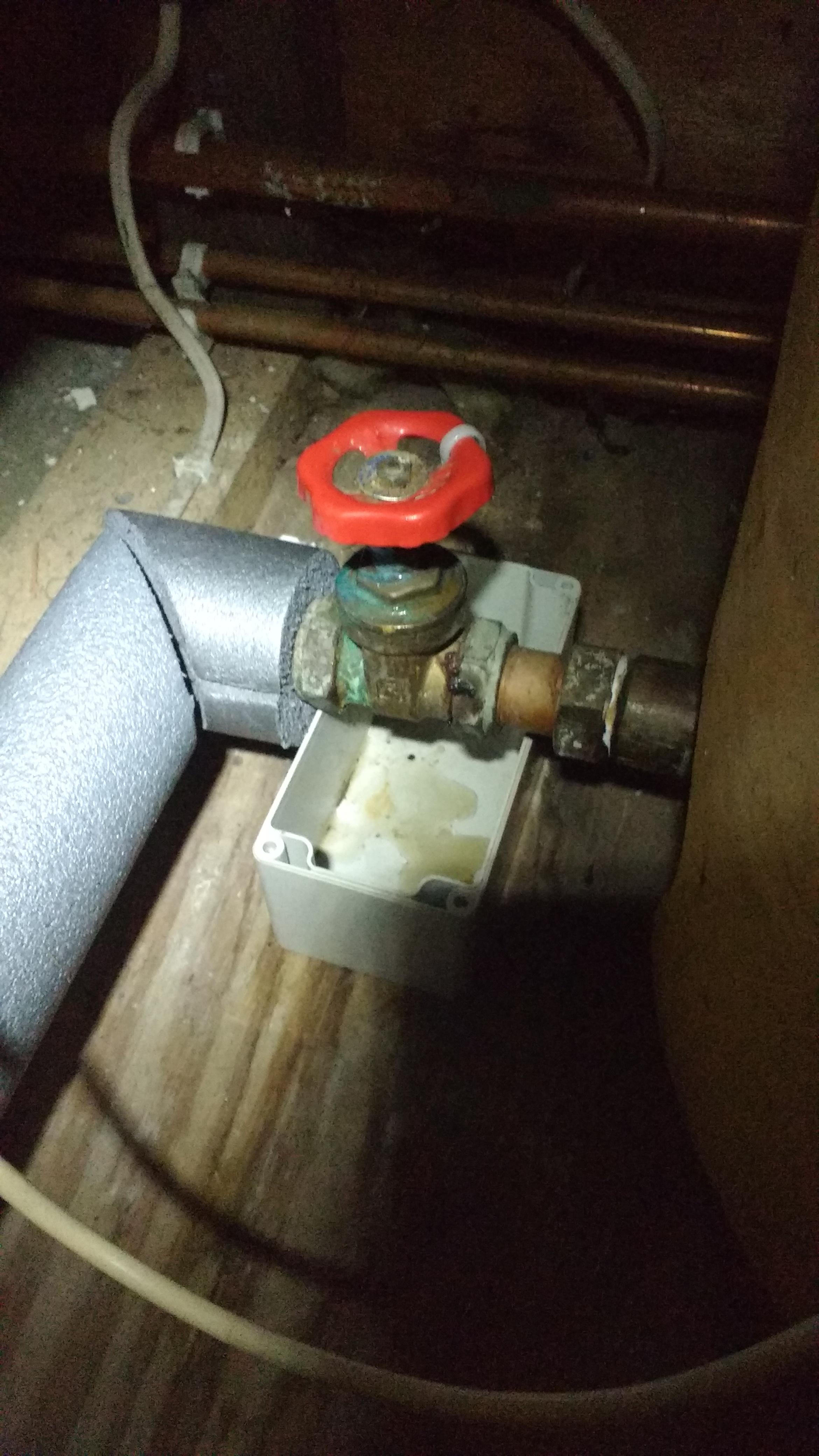

Onoff Posted November 6, 2020 Author Share Posted November 6, 2020 On 02/11/2020 at 16:33, Nickfromwales said: You’ll need to link flow and return at source and fit a gate valve for a manual bypass adjustment. On 02/11/2020 at 16:33, Nickfromwales said: Needs to be across where you link the PFM in ideally. Tomorrow is the day! New rad, new pump valves. Before all that the power flush. I'm still lost as to the why of your two points above. Isn't it a case I'm just aiming to treat the CH pipework as a loop? I force water round one way, then the other a few times then dump the contents to the drain? Can't figure the why of the extra gate valve suggested. Ta. Link to comment Share on other sites More sharing options...
Nickfromwales Posted November 6, 2020 Share Posted November 6, 2020 4 hours ago, Onoff said: Tomorrow is the day! New rad, new pump valves. Before all that the power flush. I'm still lost as to the why of your two points above. Isn't it a case I'm just aiming to treat the CH pipework as a loop? I force water round one way, then the other a few times then dump the contents to the drain? Can't figure the why of the extra gate valve suggested. Ta. If you’re going to open the single pipe at the pump and connect the PFM there, and both / all ZV’s are open ( with gate to HWC closed at first ) then it should be fine without the gate. The gate was just to allow you to take the PFM potential down from 100%. 1 Link to comment Share on other sites More sharing options...
Onoff Posted November 6, 2020 Author Share Posted November 6, 2020 33 minutes ago, Nickfromwales said: If you’re going to open the single pipe at the pump and connect the PFM there, and both / all ZV’s are open ( with gate to HWC closed at first ) then it should be fine without the gate. The gate was just to allow you to take the PFM potential down from 100%. Taking out the magnetic filter on the return 28mm and fitting the PFM there is the plan. It'll be about 1m from the boiler. I'll put all the ZVs to MAN. I'll close the balance valve too. I'll turn off the feed from the header and I'll cap the expansion pipe. Link to comment Share on other sites More sharing options...

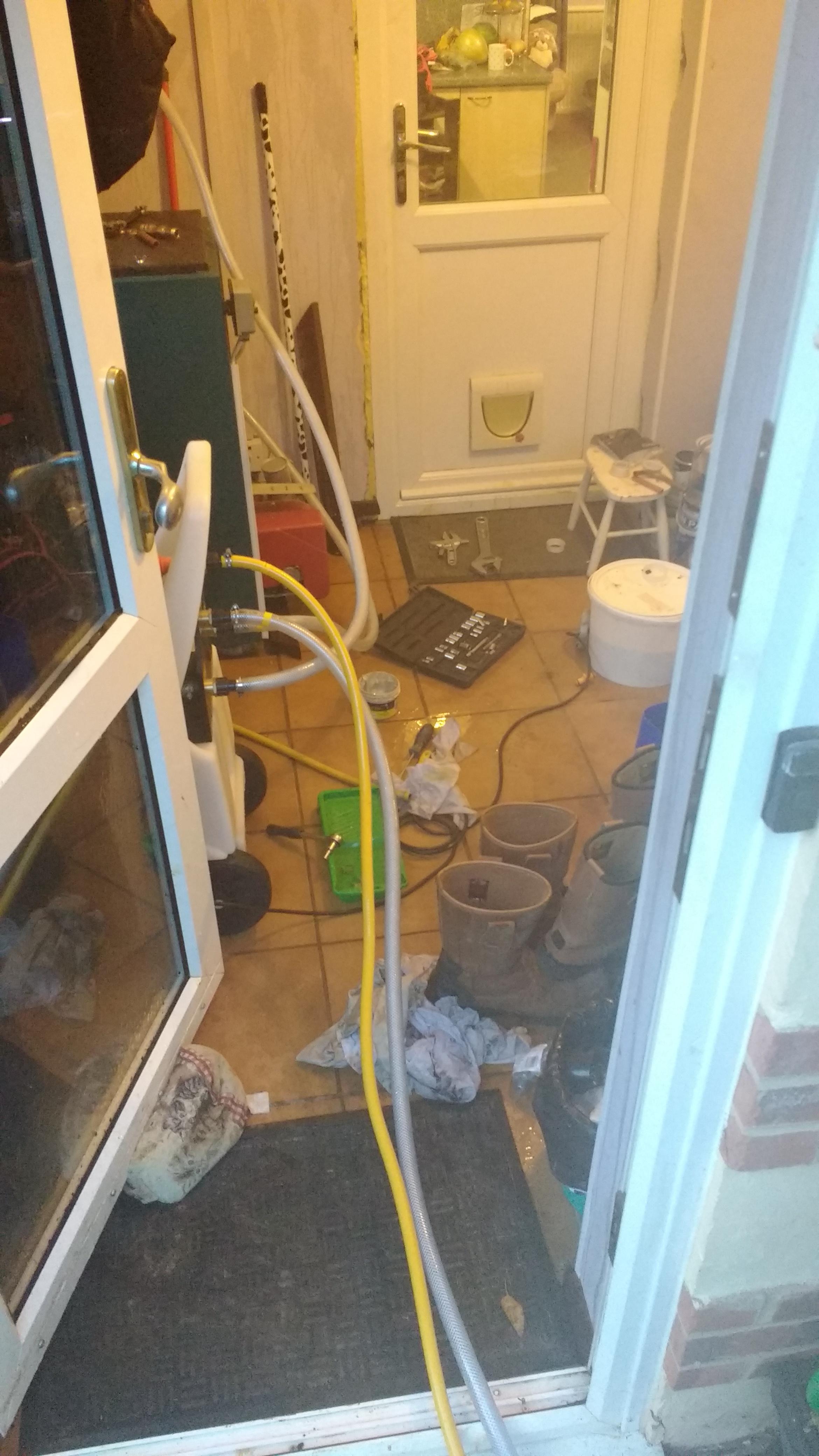

Onoff Posted November 6, 2020 Author Share Posted November 6, 2020 14 minutes ago, Nickfromwales said: Oh, I hope you have long hoses as you cannot even DREAM of having the PFM indoors PFM is going to sit in the boiler room between boiler and back door. Hoses aren't long enough to go outside. Nearest window is fixed glazing. I'll somehow extend the drain to outside though. Link to comment Share on other sites More sharing options...
Nickfromwales Posted November 6, 2020 Share Posted November 6, 2020 6 minutes ago, Onoff said: PFM is going to sit in the boiler room between boiler and back door. Hoses aren't long enough to go outside. Nearest window is fixed glazing. I'll somehow extend the drain to outside though. The machine has an overflow which you are supposed to leave open. Can you extend the hoses? I've never used one indoors...... Link to comment Share on other sites More sharing options...
Nickfromwales Posted November 6, 2020 Share Posted November 6, 2020 Pop some floorboards maybe and hope for the best? Link to comment Share on other sites More sharing options...

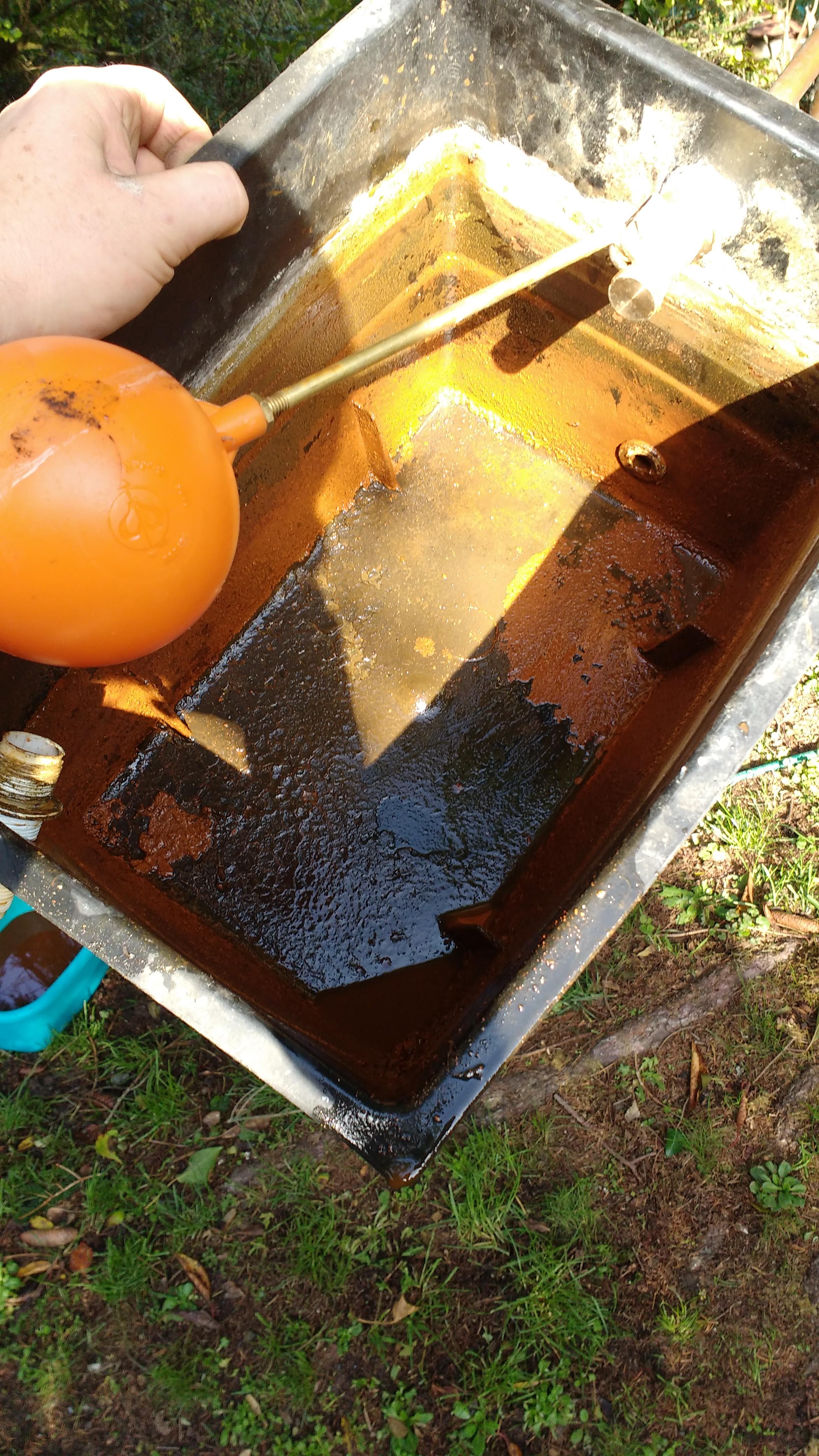

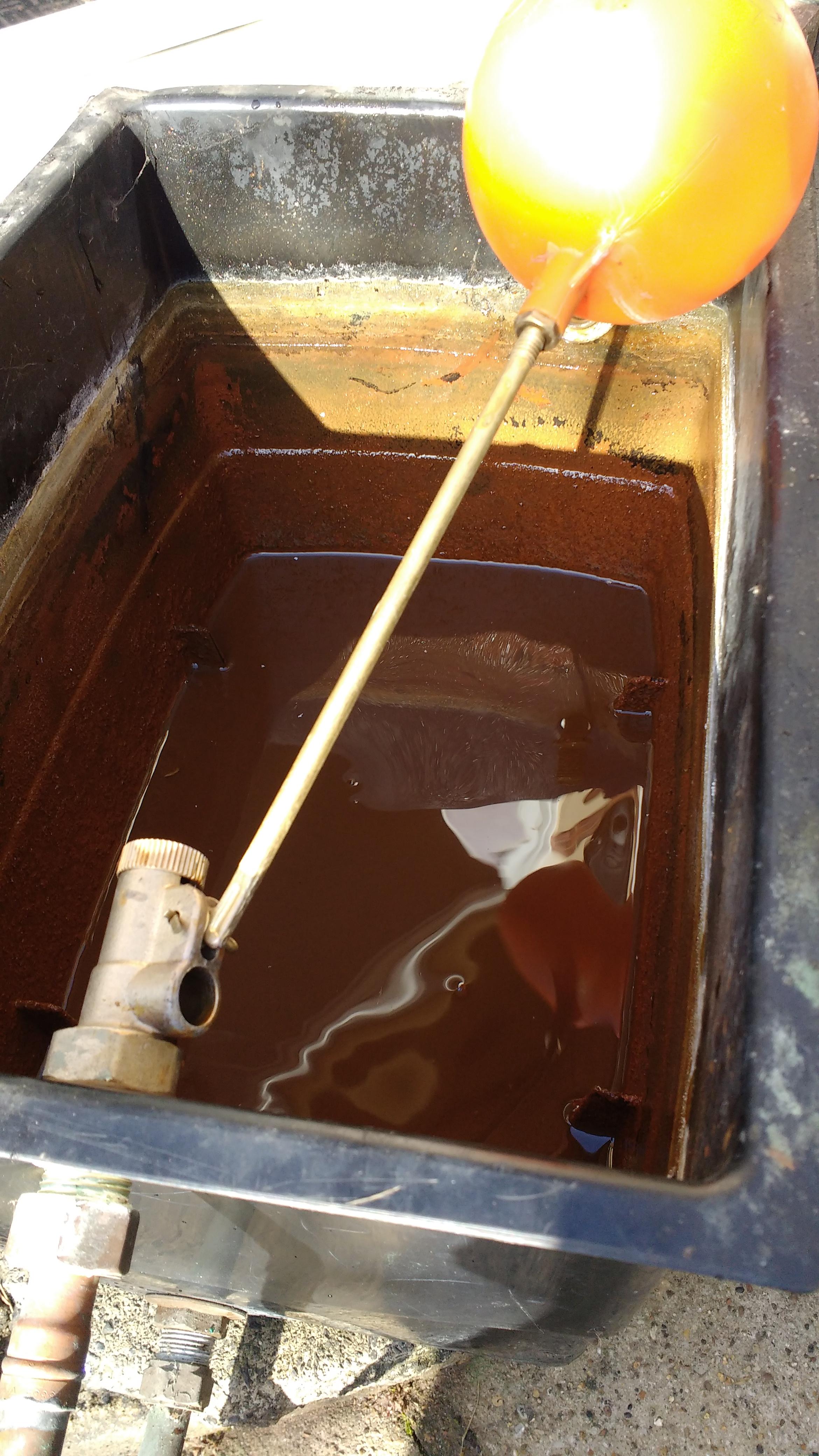

Onoff Posted November 7, 2020 Author Share Posted November 7, 2020 (edited) Damn! I totally forgot about the state of the header tank. Through I guess general crap in the incoming mains water, the occasional pump over in the past coupled with no lid, it's filthy. Full of rust and scale by the looks of things. This shot was taken by holding the phone over the top. Access is appalling as I think previously mentioned. If I'm going to do all this cleaning it's pointless not doing the header tank too. Don't want to be reintroducing unnecessary crap into the system if I can help it. Think I can squeeze it out of where it is if I disconnect mains in, out and the expansion. First problem is the stopcock on the incoming mains is seized solid. At least removing the tank I'll be able to get to the manky end of that expansion pipe to clean it up and fit a temporary stop end. Oh well, nobody's going to sort this but me! ? Edited November 7, 2020 by Onoff Link to comment Share on other sites More sharing options...
Cpd Posted November 7, 2020 Share Posted November 7, 2020 When I installed my new UV and filtration system I needed to do a full chemical flush of the system so that it was starting from clean, I also took the time to empty the header tank which was just like yours but had a very fine layer of silt in the bottom and staining from the peaty water, luckily my access was better and I was able to get in about it without taking it out. That’s one nasty looking job you’ve got there...... Link to comment Share on other sites More sharing options...
Onoff Posted November 7, 2020 Author Share Posted November 7, 2020 Mucky header tank removed after loosening sone associated pipe work. Jet washed and filled with a strong citric acid / hit water solution to get rid of the ingrained rust stains! Found the lid too when I removed it! Pump valves next I think. Not sure when to fit the new rad. Now or after the power flushing and another drain down? @PeterW when I back fill via the boiler drain I presume have the PFM connected up & all zone valves open? Should I also have the feed to the header open? Thinking when the system is "full" I'll see water coming out the overflow. Thanks. Link to comment Share on other sites More sharing options...

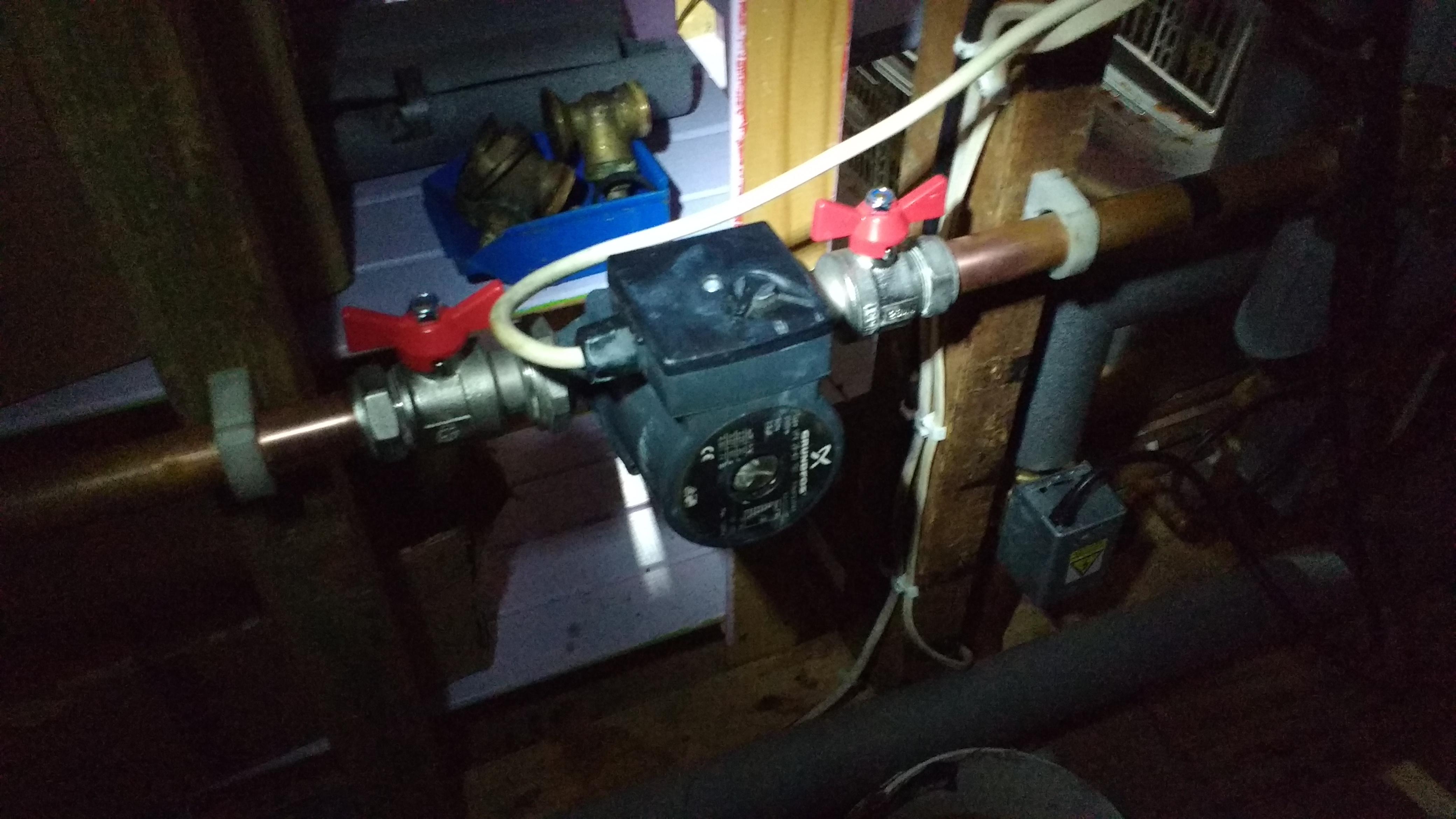

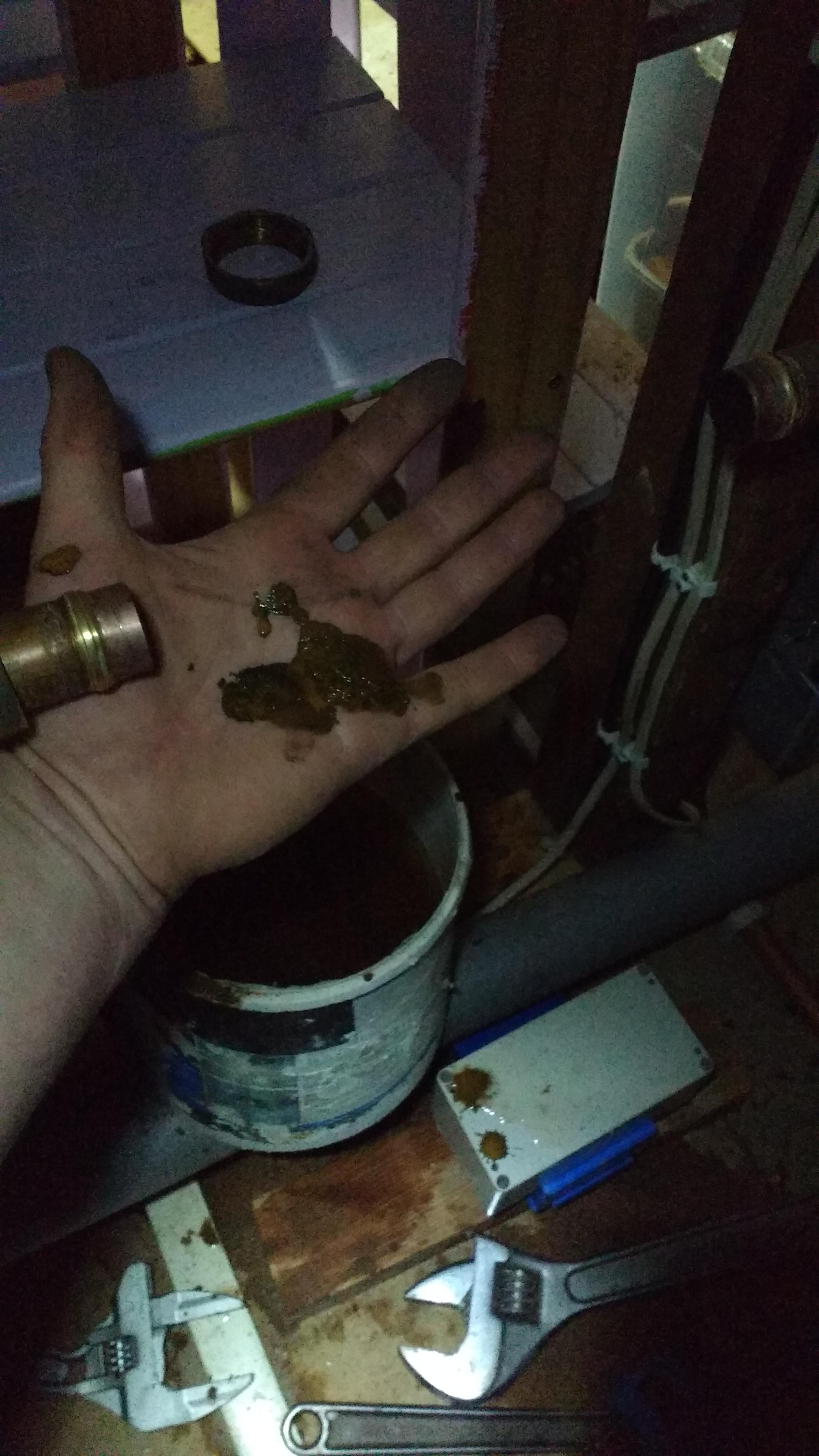

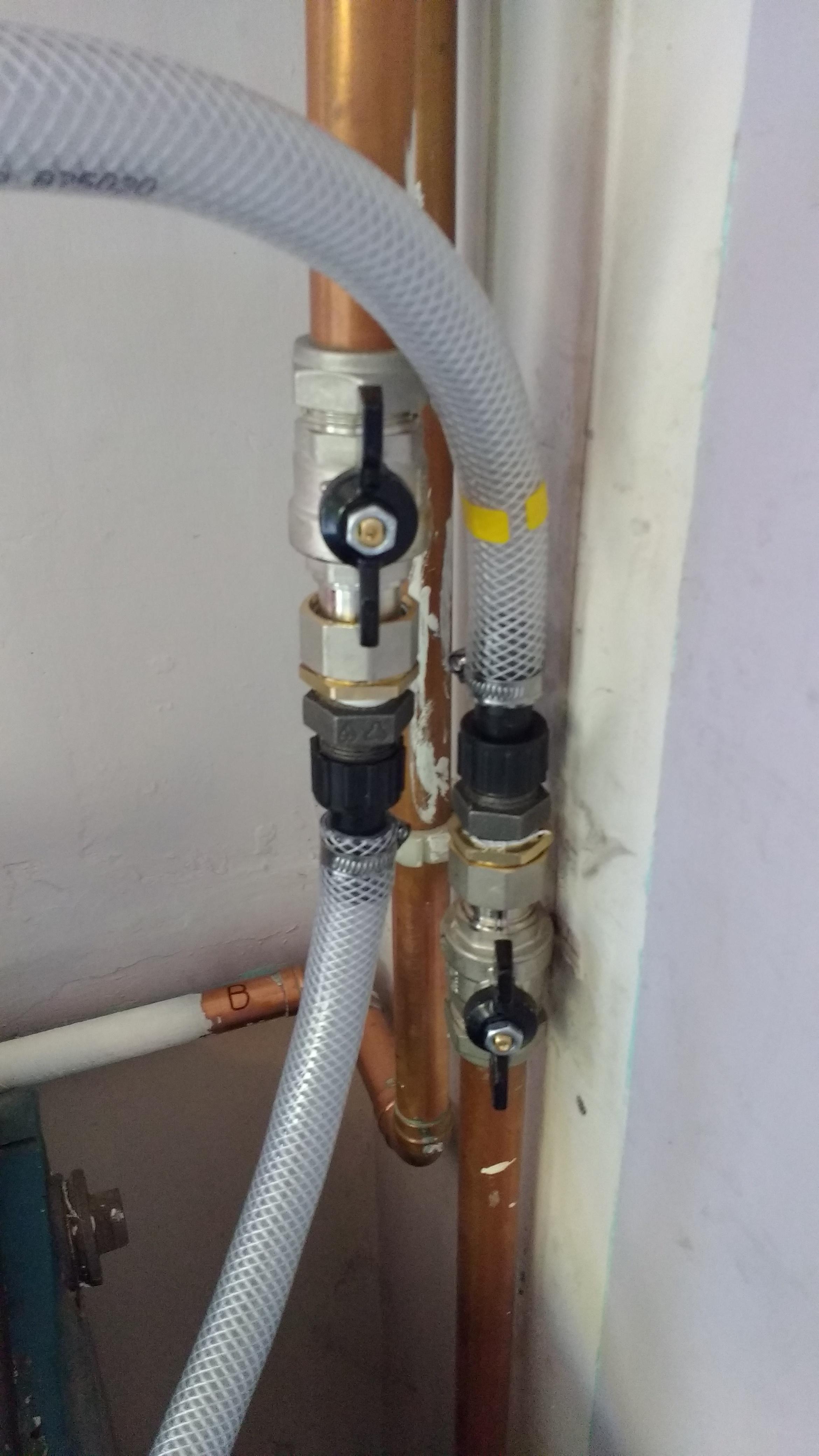

Onoff Posted November 7, 2020 Author Share Posted November 7, 2020 14 minutes ago, PeterW said: Everything open and keep an eye on the level in the header or the expansion. What are you connecting the PFM to..?? Thanks. Connecting the PFM here: A more immediate problem is the pump valves. Got those you recommend. One was a bitch to get off the pipe, I nearly pulled something! ? The 28mm olives have to come off now. Thinking multi tool with a bi-metal blade. Only got a 15mm olive tool. The crud in there but it is at least loose seemingly! Link to comment Share on other sites More sharing options...
Onoff Posted November 7, 2020 Author Share Posted November 7, 2020 Old 28mm pump olives multi tooled off. New valves on. Going to refit the header tank now. Not all going quite as quick as I'd hoped mind! Link to comment Share on other sites More sharing options...

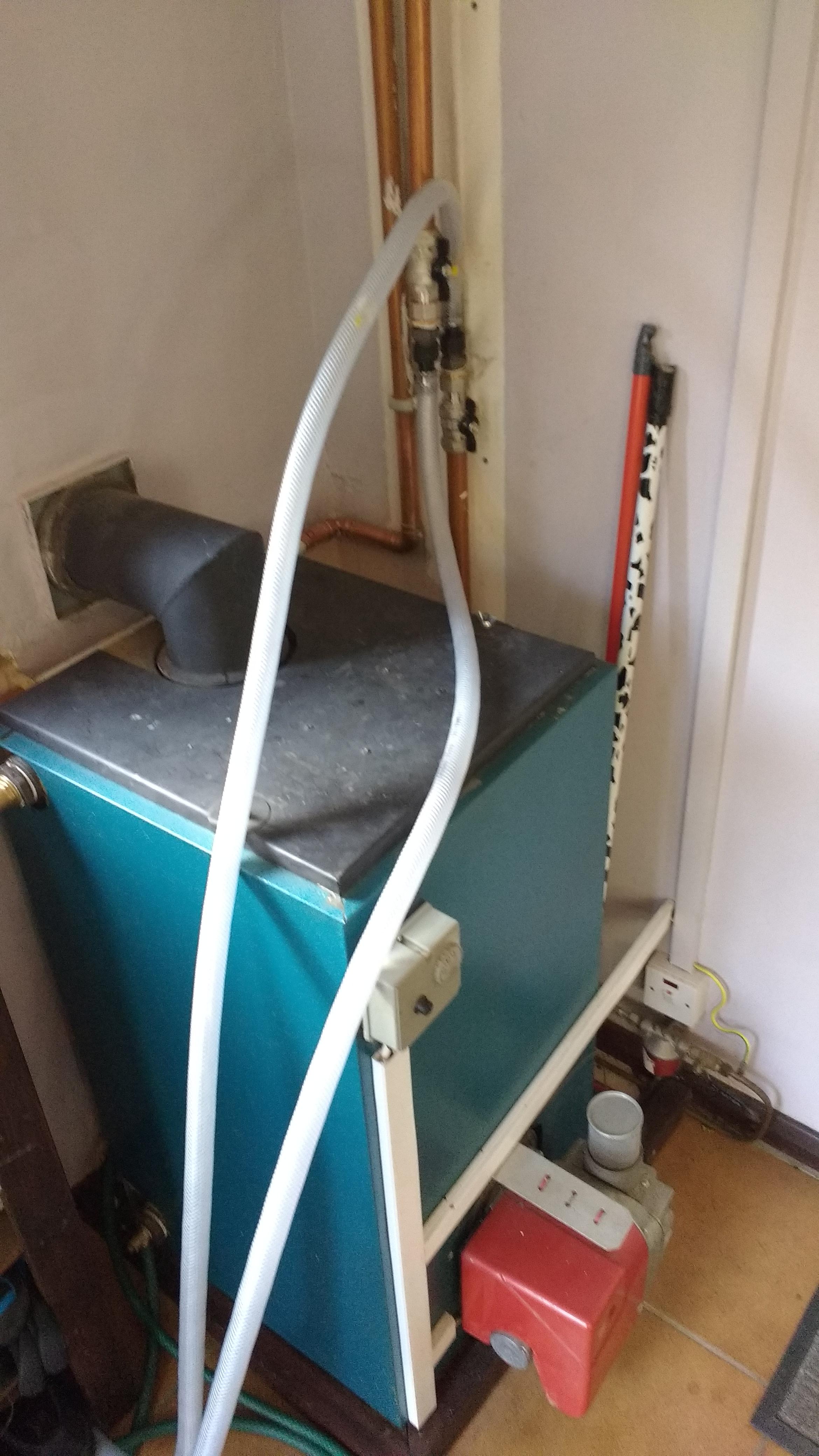

Onoff Posted November 7, 2020 Author Share Posted November 7, 2020 Who's clever f***ing idea was it to fill from the boiler drain off? Hilarious when the hose comes apart at 8bar... indoors... ? I am now wet, cold with obviously no heating or means of having a shower. System is drained down. F*** IT, going to fill the tank of this PFM and switch it on. 1 Link to comment Share on other sites More sharing options...
