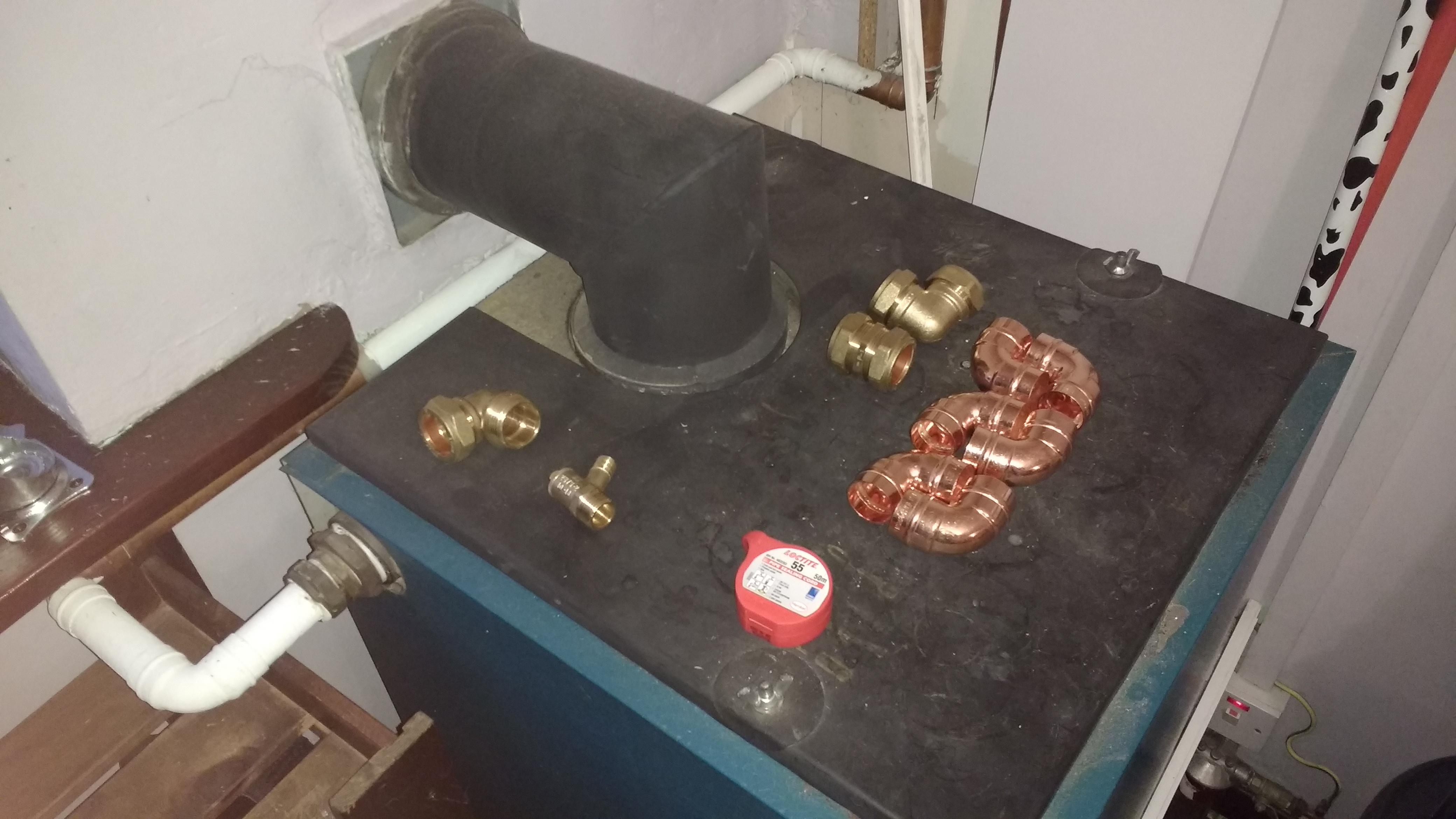

Not sure if it'll save me much in terms of space. I might just get a bit of plasterboard to miss that elbow and be flush with the reveal:
Got a few bits extra, it's not often I treat myself...
Not sure now if I've wrenches big enough to do this!

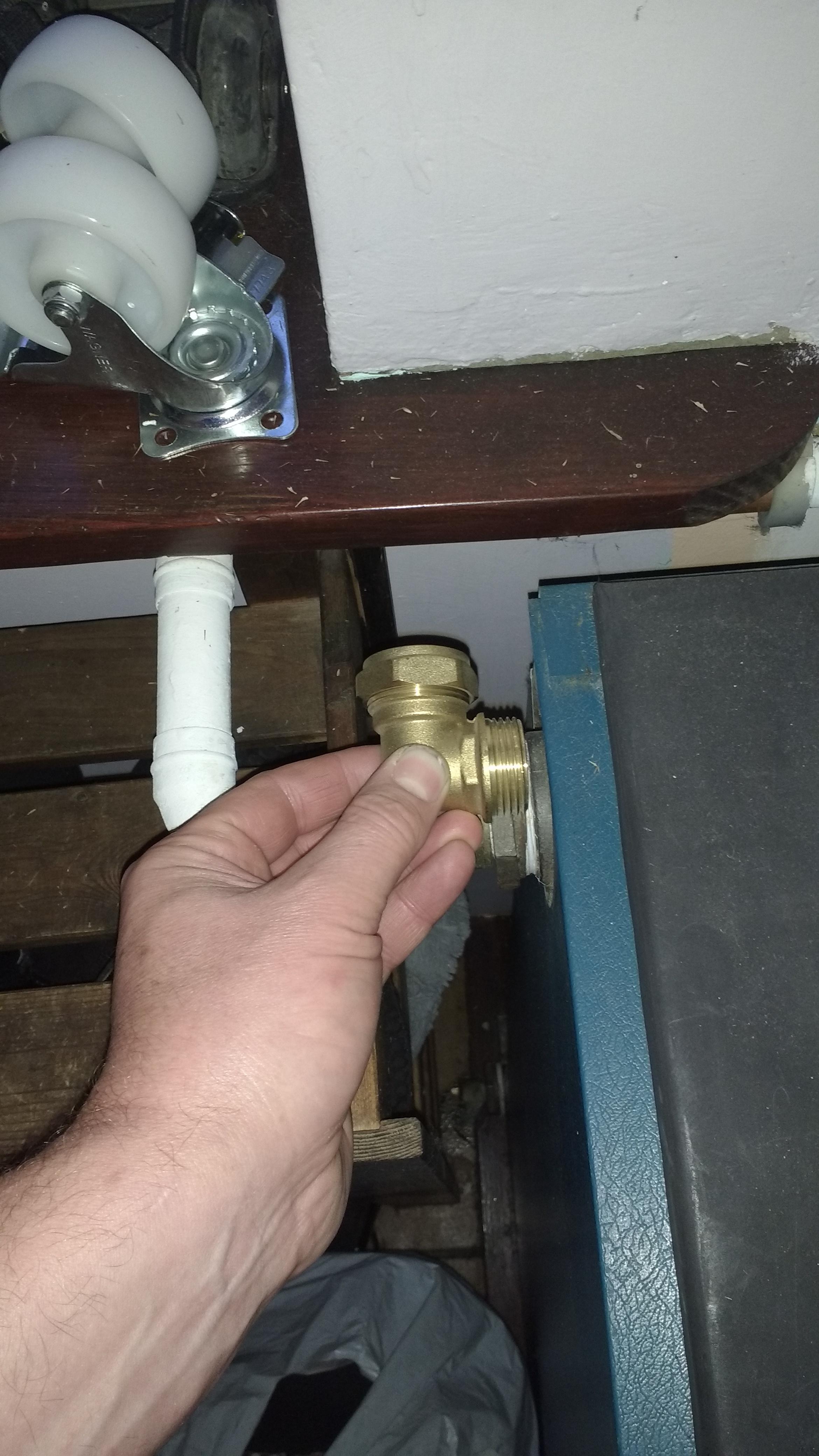

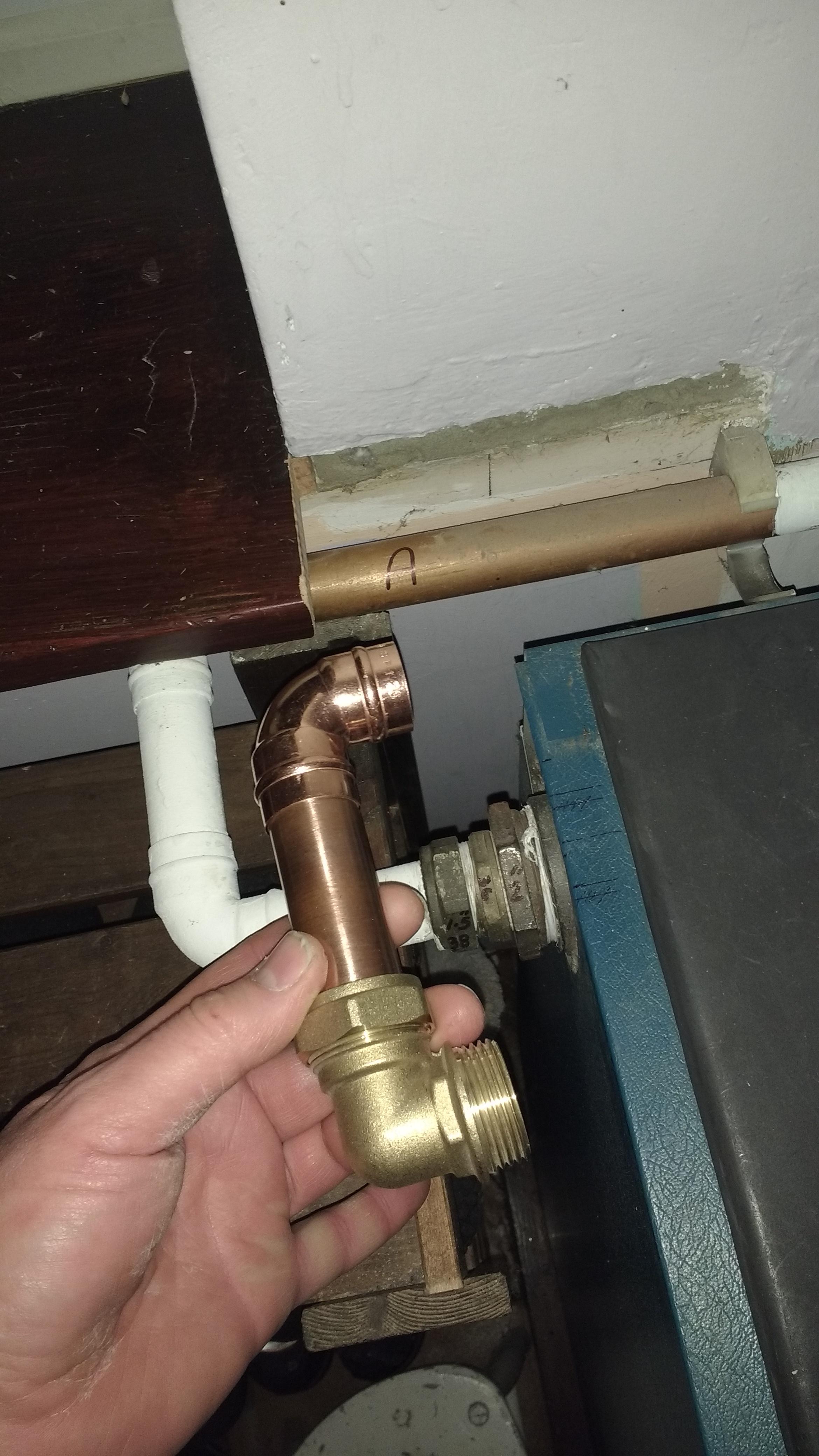

Went to do this and I'm so low on heating oil I'm running on vapours! It can wait until I get the tank filled up. No way am I wasting all that hot water right now.
Anyway, I thought I'd cut the pipes ready. Took the window sill out and offered the various fittings up, measuring and cutting the 28mm copper pipe length.
Question: I need wriggle room to get this all in. How important is it that the pipe goes all the way into the Yorkshire? On the elbows for instance the pipe goes in 24mm. Does it matter if it's only in by say 20/22mm once it's all soldered up?
Cheers

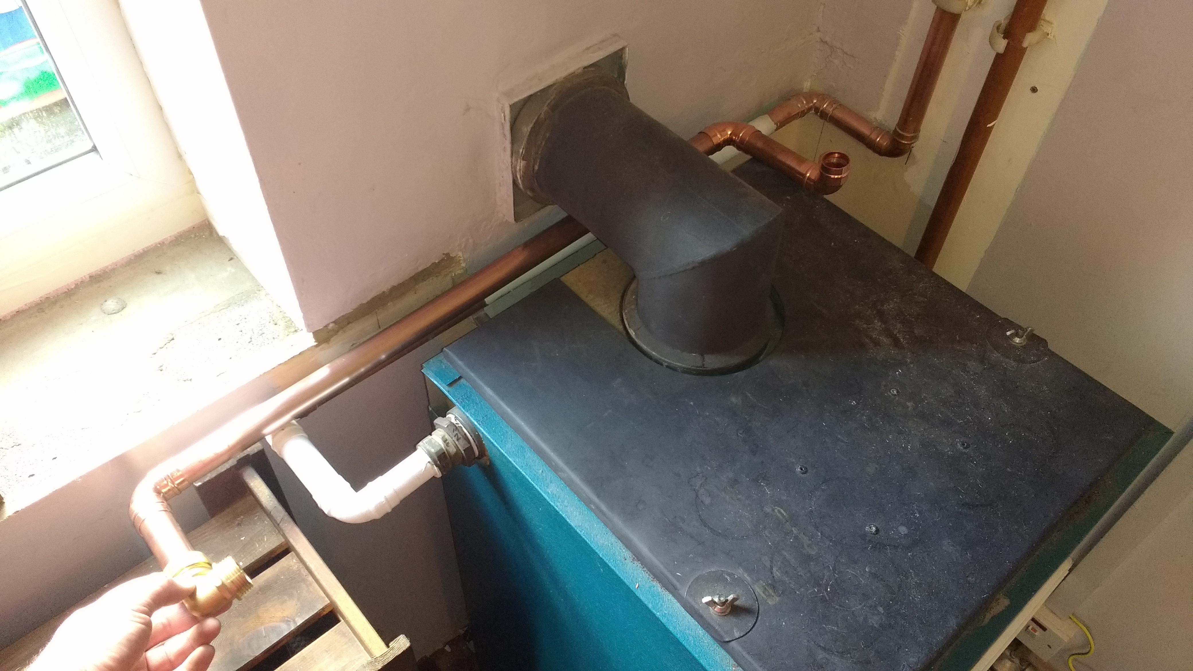

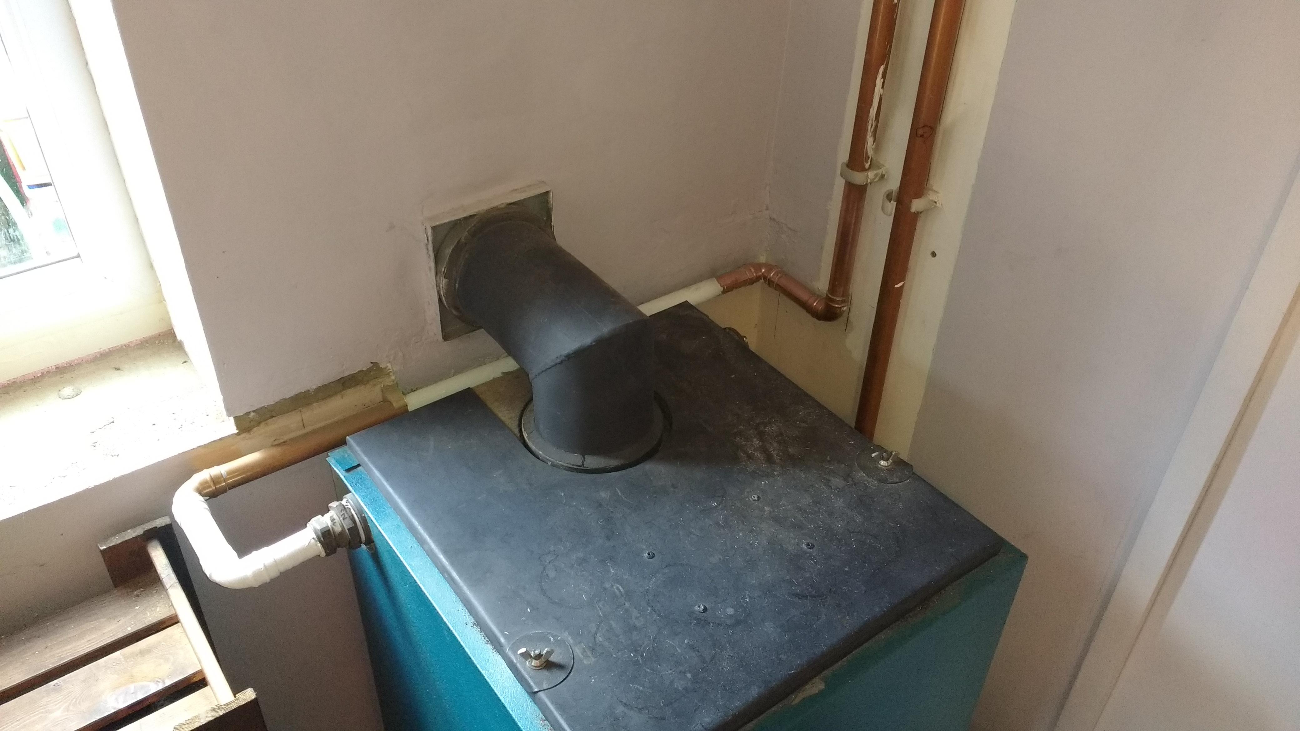

22 hours ago, Nickfromwales said:
A good 4” of space gained?
Just under 3 1/2" to be precise!
Apologies for labouring a point but I can't for the life of me see how this is going to work and keep the two pipe clips on the back wall.
Maybe it'll come right when everything is assembled loose and I can wriggle it into position then solder 3 new elbows.
The 28mm 1" elbow is I guess, going to have to have its short section of pipe on and nutted up as it gets wound into the boiler with Loctite 55 on the threads, until nearly level. Then fit the elbow at A and make level. Then fit the long pipe and swing / swivel B & C into position.
I wonder if I could just cut the long pipe back and solder an elbow on or even put a compression elbow on there and avoid disturbing B & C.
Tricky to know until I do it.

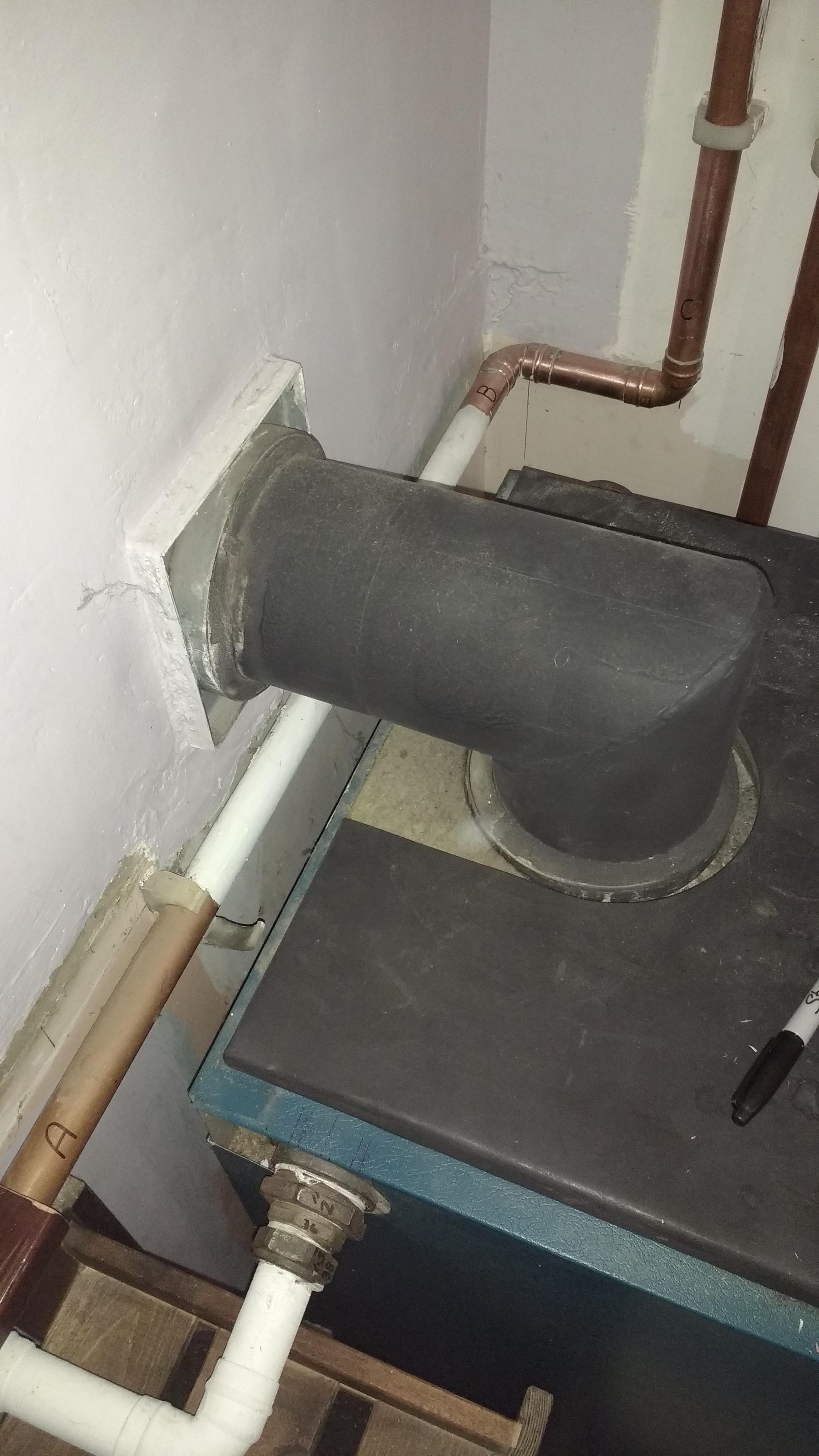

Hopefully fitting the Intaklean, new boiler drain and shifting the boiler pipe this week.

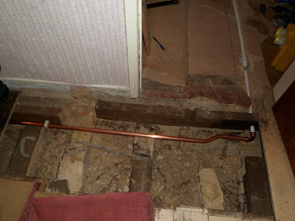

Whilst it's all drained down I'm wondering whether I should fit a 22mm ball valve each end of the white plastic pipe that lies just under the floor and that I'll be tapping off of later. This end and the other is copper.
B@llocks! When the CH is on its like there's a little tune being played in the pipework, a regular tappity tap noise. Guessing the Grundfoss pump? Of course the valves either side are all crudded up! ?

Fitted the IntaKlean.
IMG_20201029_191956959

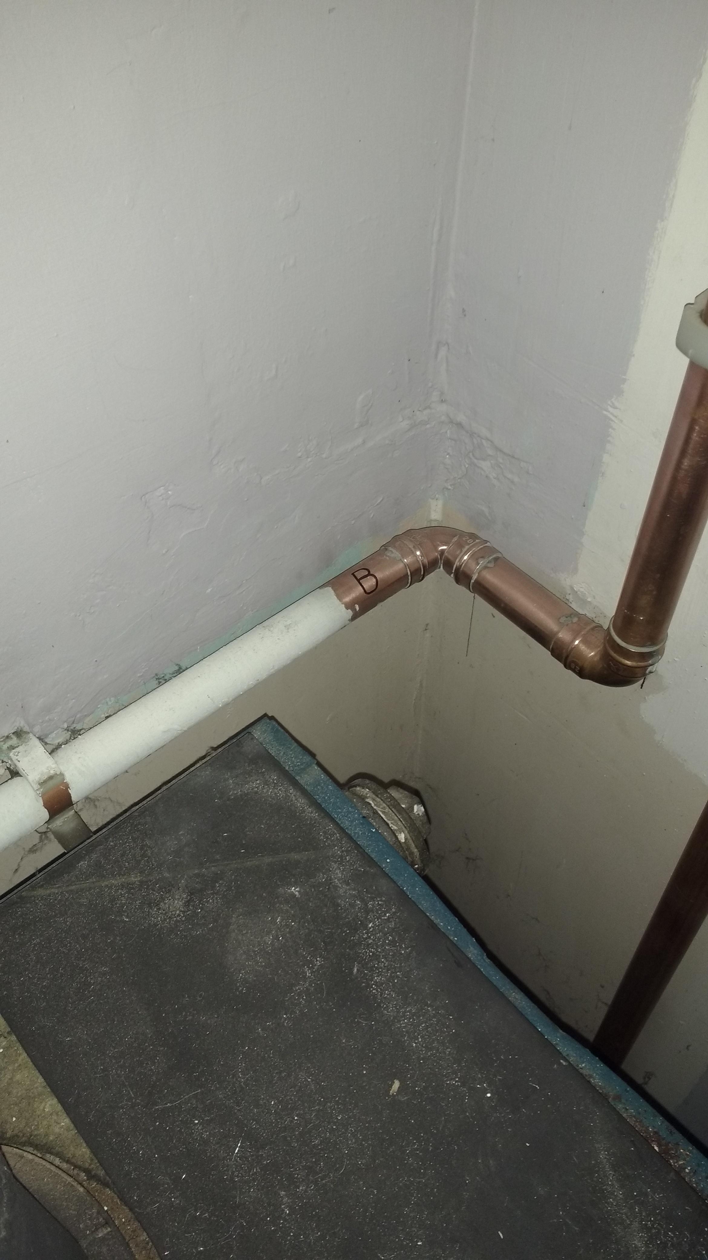

Somehow I managed to get the 28mm / 1" elbow into the boiler and an elbow soldered in situ. I just sort of turned the elbow into it's final position making sure not to turn it back. Tightening that compression and something went "bang". Backed the nut off and found a couple of strands of brass thread. Fingers crossed its OK. Lashings of Jet Blue Plus.
Hoping too my soldering is OK. Used Templars flux, lead free solder and the blue gas bottle not the MAPP:
IMG_20201029_192014501
Should make it easier for boxing in:

The one downstairs drain cock on the old single pipe system under the suspended floor was seized solid. New one fitted. Bit of garden hose runs under the floor and through a hole drilled in the wall onto a flower bed. The two original 22mm compressions, I just backed off, removed the PTFE tape and smeared with Jet Blue Plus then re tightened (same olives).
IMG_20201029_192107640
I then isolated the length of plastic 22mm in the stairs room with a valve either end in the hall/adjacent room. This the pipe I hope to tap off for for my UFH manifold. Water everywhere in the old boot room (now study) despite the downstairs single pipe system being nominally "empty". The pipe runs and floors are at various different levels. Wasn't too fussed about letting it drain under the suspended floors tbh.

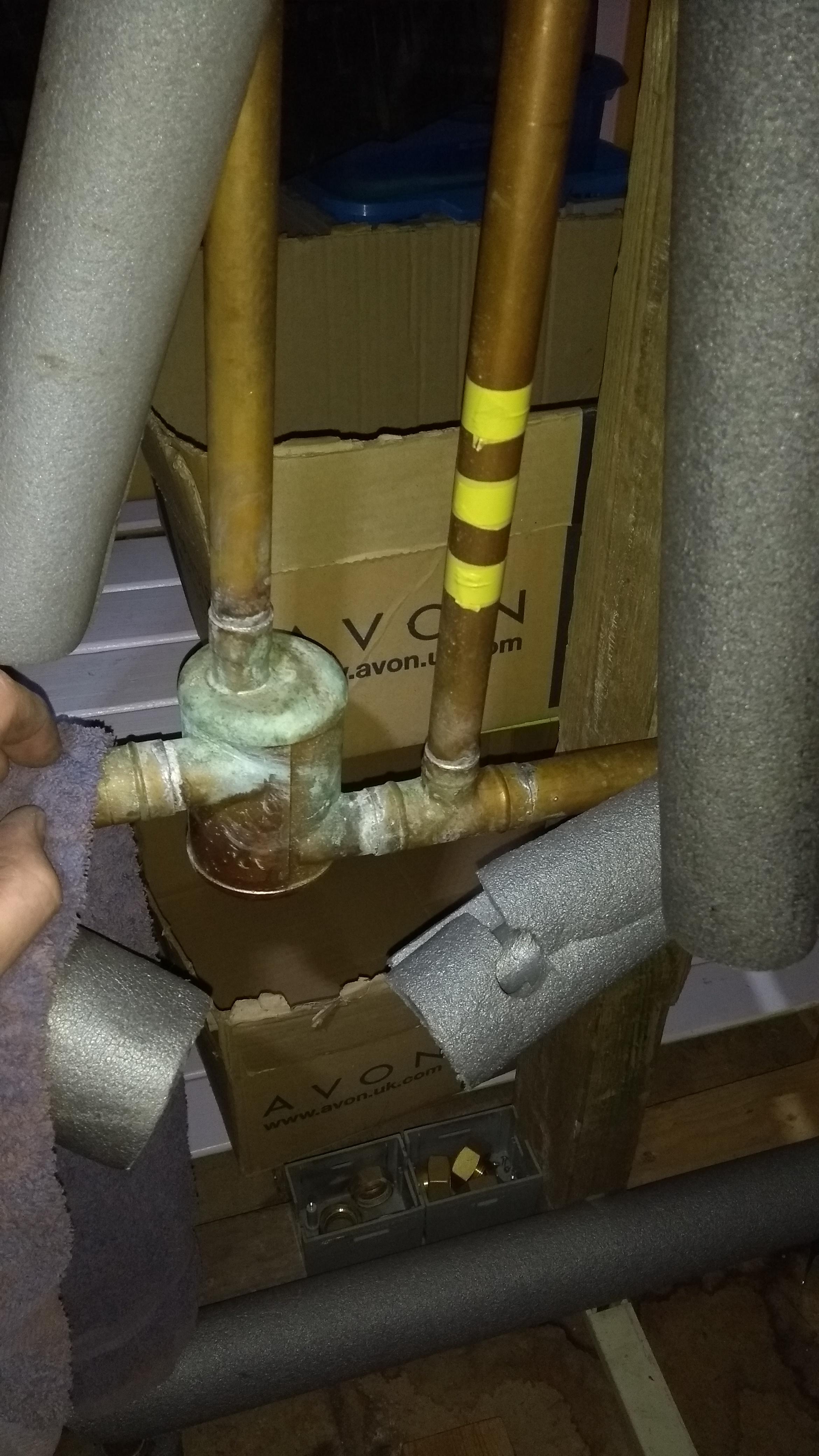

Probably the tee connection where the F&E connects is crudded up. Quicker to backfill through a drain off but without making the F&E tank overflow!!
Edited by Nickfromwales
22mm copper drops vertically from the header tank and tees into the horizontal 28mm after the air separator and before the pump. The pipe from the F&E has the 3 bits if yellow tape on.
Would the 8bar outside tap do? ?
