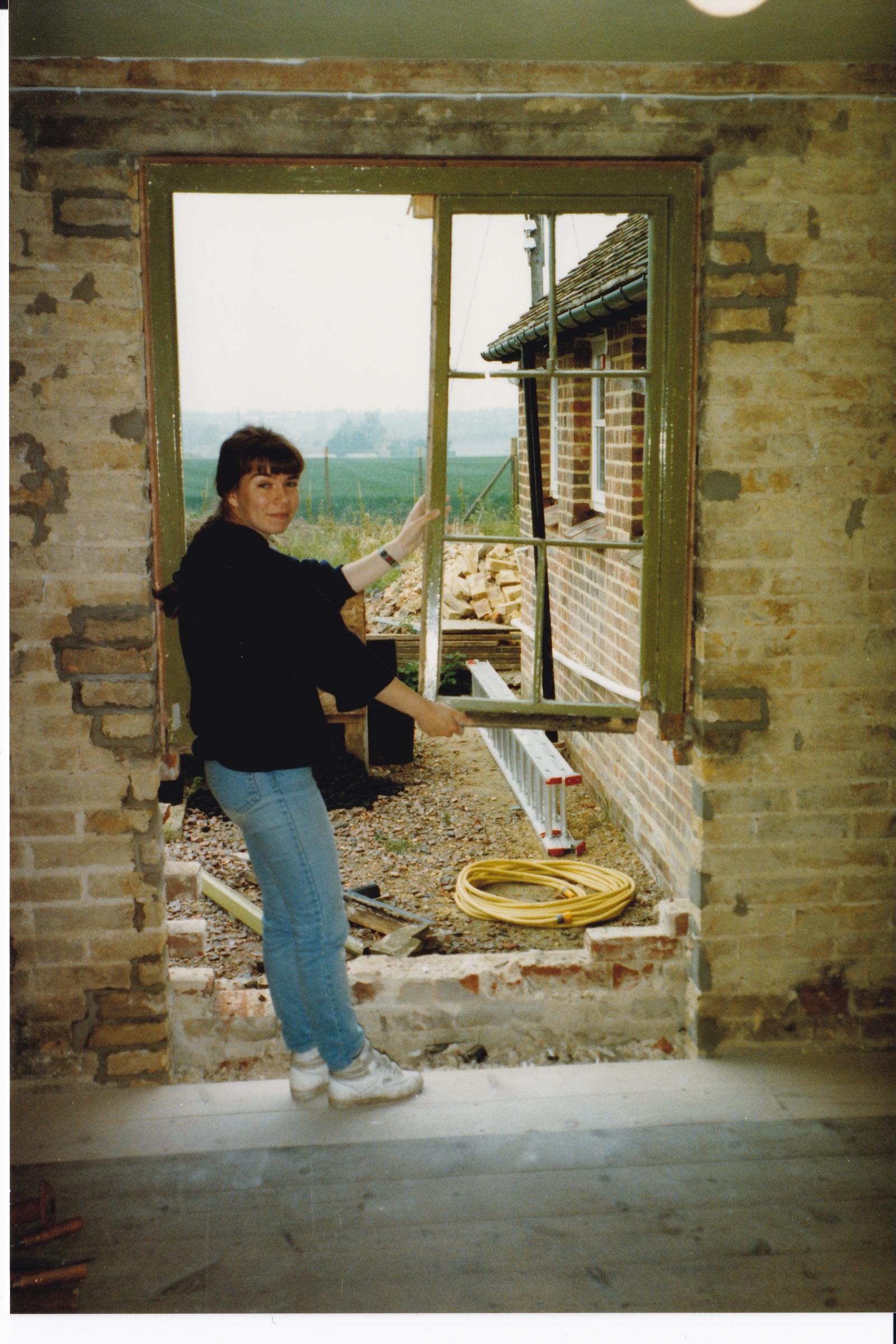

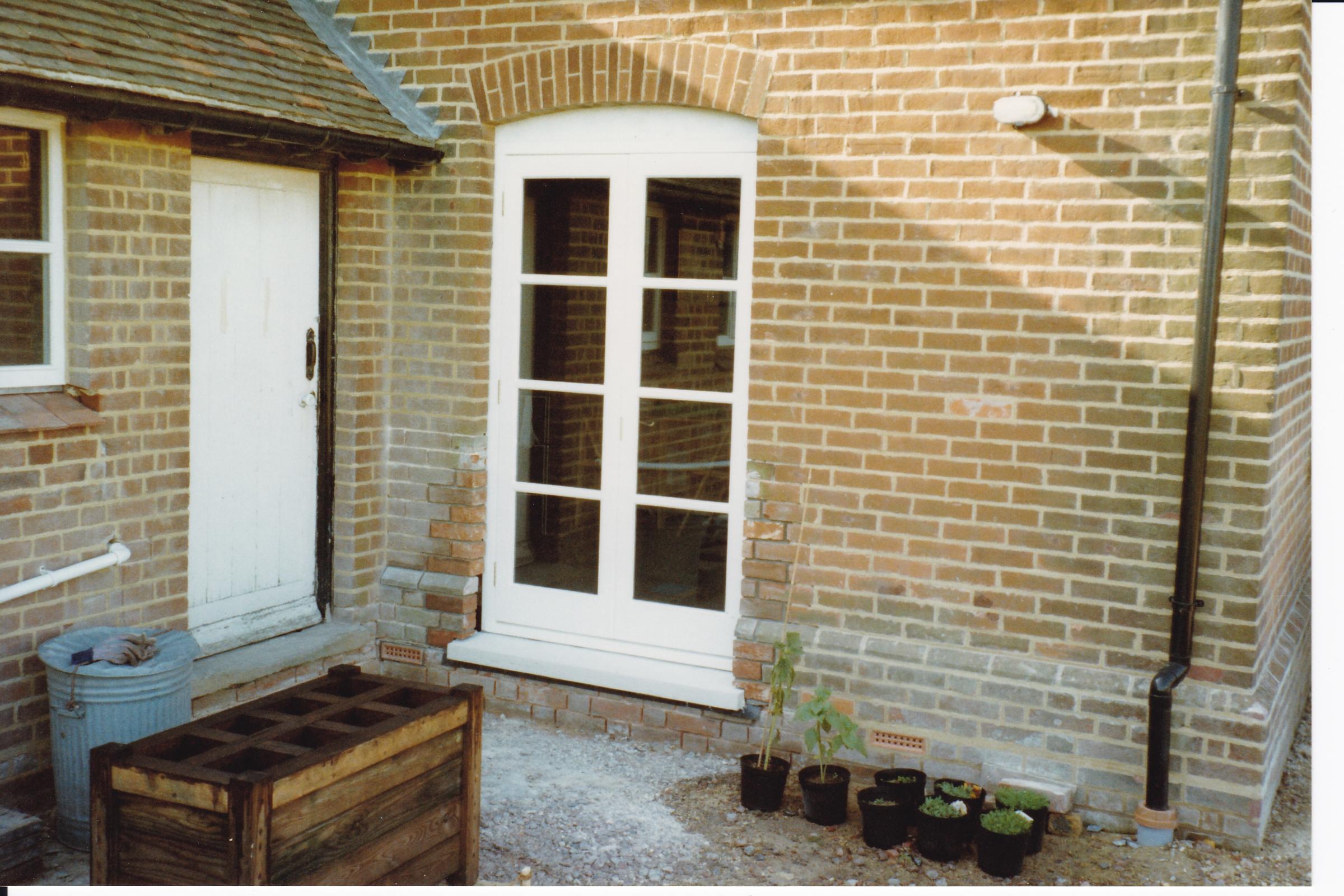

Crofter Posted February 25 Author Share Posted February 25 Wow has this really been five years!? In the end I took off all the surrounds inside and measured up directly. The local joiner who I asked to check my measurements never showed up so I just had to take the plunge. Everything fitted perfectly. Getting the old windows out was by far the hardest part of the job. A recip saw would have been a huge help. I did try using a multi tool but the depth of cut just isn't there and you only get a few nails done with each blade, at about a fiver a go. The most fun part was turning the kitchen window in to French doors. Very satisfying. A few years prior I wouldn't have dreamt of doing all this work myself but it's amazing what you can do when you just roll up your sleeves and get on with it. Link to comment Share on other sites More sharing options...
Gone West Posted February 25 Share Posted February 25 6 hours ago, Crofter said: The most fun part was turning the kitchen window in to French doors. Very satisfying. A few years prior I wouldn't have dreamt of doing all this work myself but it's amazing what you can do when you just roll up your sleeves and get on with it. Very true. The first time I converted a window to French doors, back in the nineties, I was so pleased. I did have my helper. Link to comment Share on other sites More sharing options...
