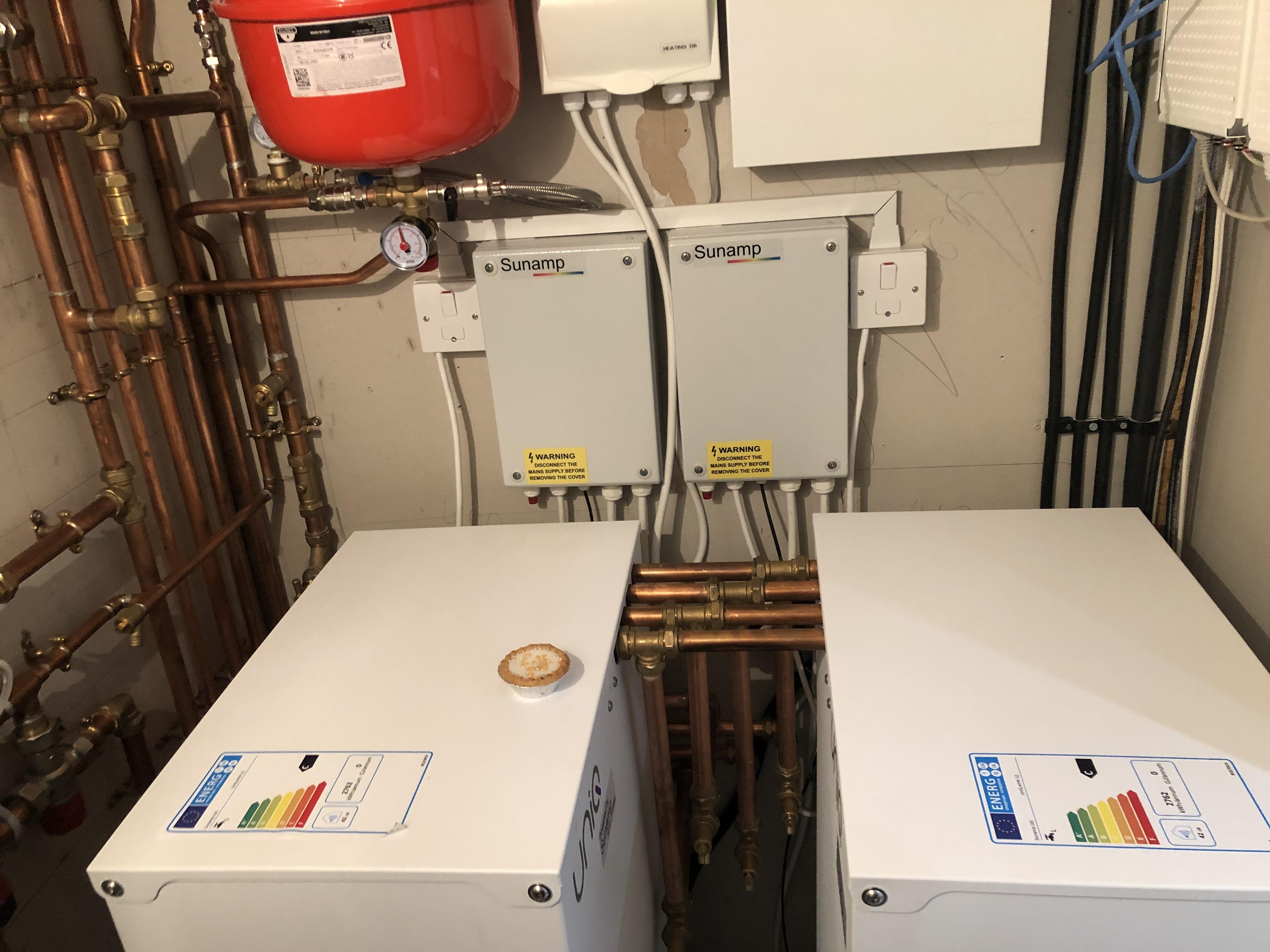

newhome Posted December 15, 2018 Share Posted December 15, 2018 29 minutes ago, PeterW said: He does but loses one point as that back right compression tee isn’t lined up with the one in front of it like the rest .... compression nuts look about 3mm out of line .... He will likely blame Will for that 1 1 Link to comment Share on other sites More sharing options...
Onoff Posted December 15, 2018 Share Posted December 15, 2018 2 hours ago, Barney12 said: Here’s my two side by side after @Nickfromwales and his faithful assistant Will finished their handiwork. All you've got to do now is paint the walls behind to get rid of all those pencil marks and it'll look pucker. Link to comment Share on other sites More sharing options...

Barney12 Posted December 15, 2018 Share Posted December 15, 2018 6 hours ago, Mr Punter said: OK @Barney12 wins the Top Trump Sunamp tidiest install (I assume pipe insulation omitted for clarity) (sorry @JSHarris, runner up) and not a bulge in sight. Best slam dunk since the cat flap. I can’t claim credit for the tidy pipework. That’s all down to @Nickfromwales who is trying hard to acheive my levels of OCD. I've spent the entire afternoon lagging the pipework, crikey what a thankless task. Not quite finished but will be sure to post a photo when I do. It did seem a bit of a shame to cover up all that lovely copper and brass 2 1 Link to comment Share on other sites More sharing options...

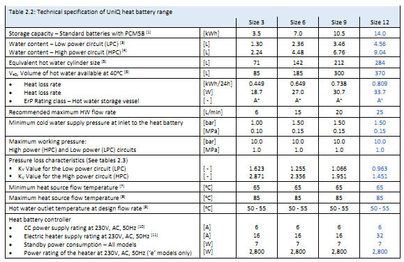

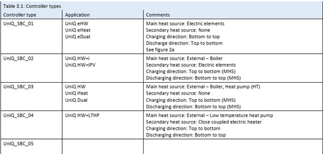

readiescards Posted December 18, 2018 Author Share Posted December 18, 2018 From Sunamp: "We have just received your question regarding the ErP rating of our products. Our UniQ range of thermal stores in all sizes (3, 6, 9 and 12kWh) are A+ rated in terms of heat storage thermal efficiency. This is valid for all units designed to be primarily charged from an external thermal source, whether they have an inbuilt back-up electrical element or not. The “e” range of UniQ products are physically identical to those with a back-up electric element inside, however as they are designed to be primarily charged from an electrical input the ErP rating is automatically downgraded by a couple of classes as the certification system does not distinguish where the electrical power is coming from (excess solar PV for instance). This is a nuance of the current ErP rating system, but please rest assured that your system is still performing from an efficiency and thermal loss point of view in exactly the same manner as the rest of the UniQ range." So A+ if you don't use the inbuilt heater it seems 1 Link to comment Share on other sites More sharing options...

Triassic Posted December 22, 2018 Share Posted December 22, 2018 This statement was posted on the Sunamp FB page yesterday... Sometimes we are asked why our super-efficient Heat Batteries only get a C-rating. We are working to make them even more efficient and to get a B (would be unique for an electric water heater). This was our answer to a direct question on twitter, we think it is worth spreading it here as well. EPC (Energy Performance Certificate) is A+ if just a thermal store. Heat loss just 0.744 kWh/24h. Lowest in the market. Add an element. Heat loss stays the same. But grid electricity gets penalised (EU average emissions factor: 2.5x worse compared with gas). Result: C rated. Is that fair? If you use PV solar to charge it, then the emissions factor should be ... zero? Or close to zero. So in the solar PV charged case maybe it should have a solar thermal type rating (A++ ?). It might be possible to lobby to get this reconfigured but what about UK grid electricity? It’s well known (and @myGridGB is the most accessible and wonderful source for tracking this) that the grid has decarbonised massively over the last 5 years or so. 600 g CO2/kWh down to 250 g CO2/kWh in round number terms. So the 2.5 emissions factor isn’t super-applicable in the UK. If you assume gas (via an efficient gas boiler) charging your UniQ thermal store or you assume electricity via the built-in elements of a UniQ electric, the UK carbon emissions are about equal. An emissions factor of 1 (rather than 2.5) would make sense in UK. This is actually reflected in SAP10 emissions factors that @MayorofLondon has announced GLA will apply from 1 January 2019. (Projects in London from now on will probably disavow gas and use electric heat). To sum up: • Sunamp UniQ Thermal Stores A+ Sunamp UniQ Electric Heated C Actual heat losses EQUAL Penalty for electric energy input applied in the move from A+ to C; • That penalty excessive on either PV charging or UK grid mix; • London leading on recognising this in planning. We see the trend of more renewables making making electricity the heating fuel of choice (dropping below gas emissions soon). So Today we and @OVOEnergy (inc @VCharge) announced our plan to develop mass market electric heating https://www.pbctoday.co.uk/news/energy-news/zero-carbon-home/50394/ . Our joint challenge (supported by @beisgovuk grant) is to develop the heat batteries, system, controls, grid interaction (inc. demand side management) and tariffs to make super-low-carbon electric heating the optimum proposition. Give us a little time. We will succeed! Meanwhile Sunamp UniQ Heat Batteries are available today at prices that are equal or better than hot water tanks. You can run them from solar PV, heat pumps, gas or grid electricity. UniQ Heat Batteries save energy compared with any water tanks so you can save fuel. Choose the type (eg solar) or time (eg economy 7) of charging and even today electric heat and hot water look pretty compelling. They cost less to install than unvented cylinders (no P&T discharge pipework, no G3 ticket). They have no annual maintenance. That alone can save their purchase cost over 10 years (even before thinking of fuel savings). And they are fantastic tech! Interestingly there was a question in the comments about the 50% depletion requirement before the unit starts to recharge. Link to comment Share on other sites More sharing options...

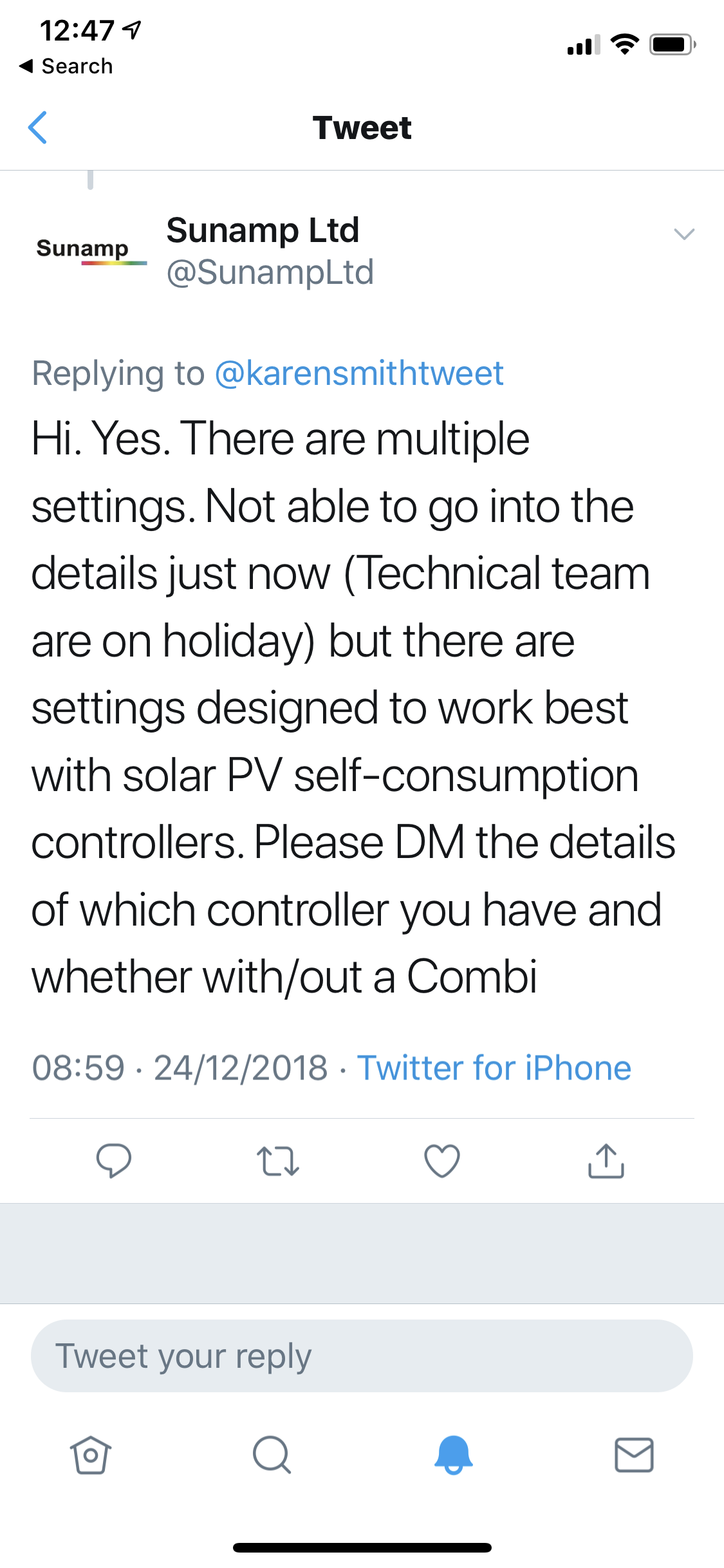

vfrdave Posted December 24, 2018 Share Posted December 24, 2018 (edited) On 22/12/2018 at 11:34, Triassic said: There was no response from Sunamp. Maybe if we all went onto the Sunamp Facebook page and asked similar questions or added comments we might get a response. This is the response to the post on Facebook which was mine, my bad lol:- "There are multiple settings. Not able to go into the details just now (Technical team are on holiday) but there are settings designed to work best with solar PV self-consumption controllers." Edited December 24, 2018 by vfrdave More text Link to comment Share on other sites More sharing options...

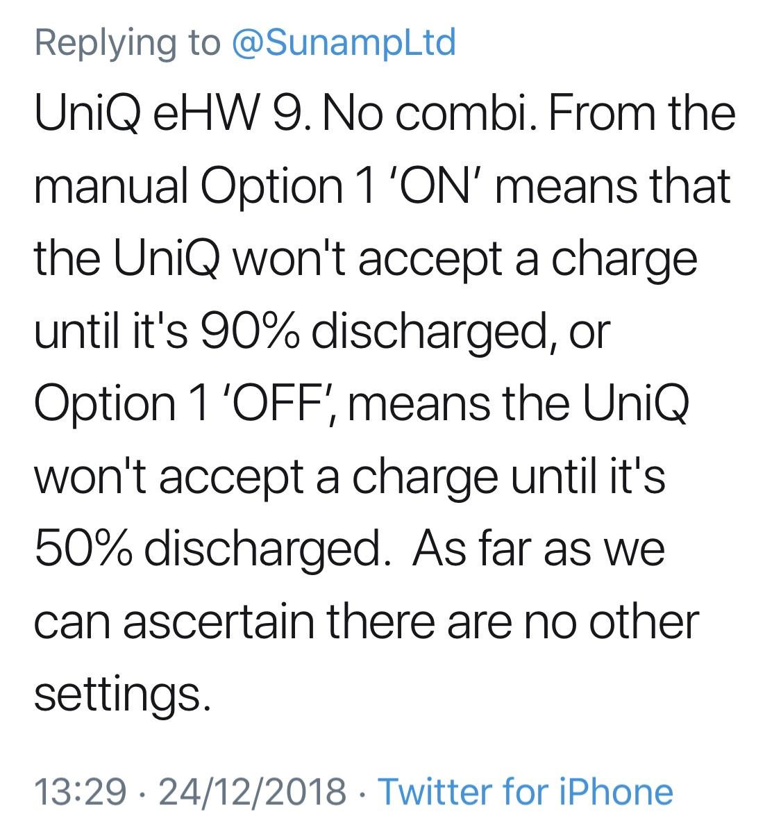

Jeremy Harris Posted December 24, 2018 Share Posted December 24, 2018 10 minutes ago, vfrdave said: This is the response to the post on Facebook which was mine, my bad lol:- "There are multiple settings. Not able to go into the details just now (Technical team are on holiday) but there are settings designed to work best with solar PV self-consumption controllers." Depends on your definition of "multiple". From the manual I have there are two settings. either Option 1 is set to ON, which means that the Sunamp won't accept a charge until it's 90% discharged, or Option 1 is set to OFF, which means the Sunamp won't accept a charge until it's 50% discharged. Neither setting is any damned use at all if you wish to utilise all your excess PV generation (unless you frig around resetting the controller every day by turning it off and then back on again to force it to accept a charge). If you use around 4 kWh worth of hot water a day, from a 9 kWh nominal capacity unit, then there's a fair chance that you will end up with no hot water part way through the second day, even with an early morning boost from a time switch (which wouldn't be accepted if the unit was just over 50% charged at that time), as we found out when the shower ran cold. Link to comment Share on other sites More sharing options...

newhome Posted December 24, 2018 Share Posted December 24, 2018 Here’s my reply (adapted from @JSHarris‘ post above) Link to comment Share on other sites More sharing options...
Ed Davies Posted December 24, 2018 Share Posted December 24, 2018 Beginning to wonder if that 90% setting was originally intended to be when it's discharged to 90% state of charge (i.e., 10% discharged) but it got misinterpreted by the programmer/technical writer and the management at Sunamp haven't yet realised what's happened. 3 1 Link to comment Share on other sites More sharing options...
