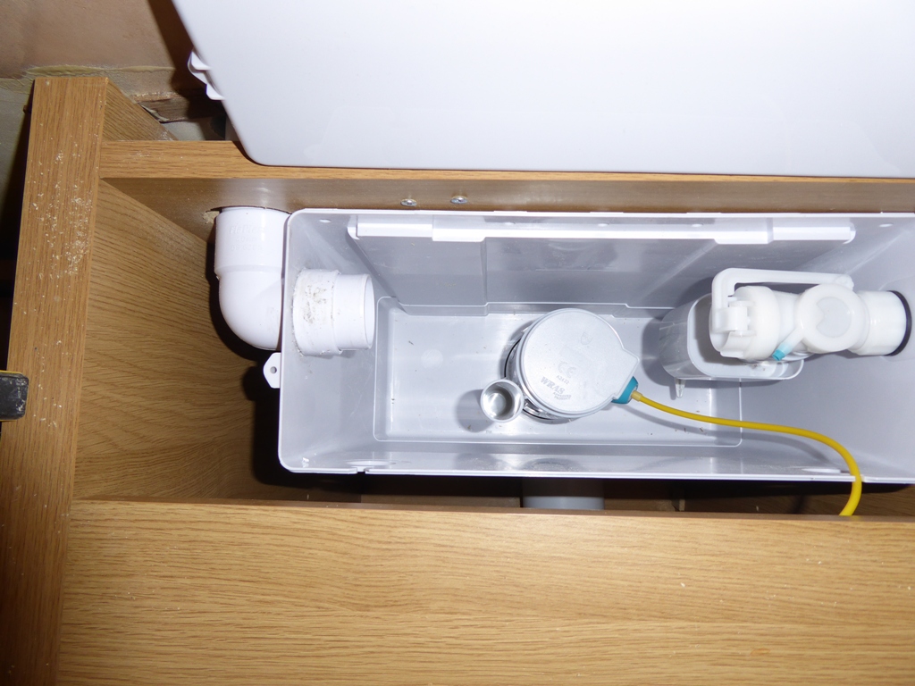

Jeremy Harris Posted December 1, 2018 Share Posted December 1, 2018 Two easy to implement and useful ideas that really work well, both involving MVHR. Firstly, connecting MVHR extract ducts to the toilet cisterns really does remove all odours at source (i.e. in the pan) and is so discreet that it's invisible if you have a built-in cistern, can be done with standard waste pipe fittings and a bit of ingenuity when it comes to adapting these to the MVHR extract ducting. This shows one of our cisterns with the lid off, with the extract pipe on the left: The second idea was to fit an MVHR fresh air supply vent immediately above the kitchen door, on the outside of the kitchen. This acts as a very effective "air curtain" we've found, and is remarkably effective at keeping cooking smells inside the kitchen where they get extracted from the kitchen extract terminal. We're still surprised at how well this works, as you literally take one step through the open doorway and go from cooking smells to no smell at all, and vice versa. 3 Link to comment Share on other sites More sharing options...

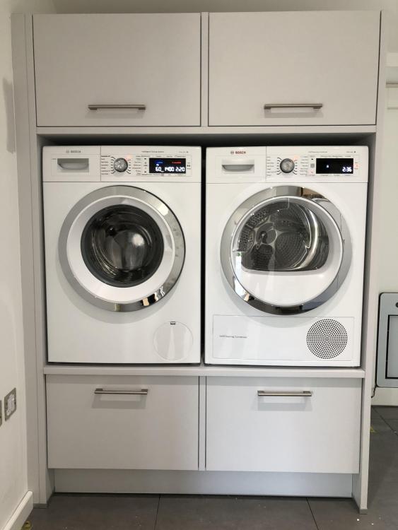

joe90 Posted December 1, 2018 Share Posted December 1, 2018 Just now, Hecateh said: Wouldn't suit everyone but my washing machine is going in the dressing room/ensuite area. It's clothes I wash mostly, then sheets and towels, and didn't see the point of taking them downstairs to wash only to have to bring them back up to put away. I did that in a previous house and it worked well, in our new build i put the washing machine in the plant cupboard in the cloakroom which has enough room for a pulley maid drying thingy (the room has MVHR extract) and room to use an ironing board. 2 Link to comment Share on other sites More sharing options...
Jeremy Harris Posted December 1, 2018 Share Posted December 1, 2018 7 minutes ago, joe90 said: I did that in a previous house and it worked well, in our new build i put the washing machine in the plant cupboard in the cloakroom which has enough room for a pulley maid drying thingy (the room has MVHR extract) and room to use an ironing board. We've found that the pulley maid thing we have in the utility room, with an MVHR extract above, dries everything, even towels, very quickly. The towels still have to go in the tumble dryer for ten minutes to get them fluffy, but that's far better than having them in there for half an hour or more as we used to at the old house. 2 1 Link to comment Share on other sites More sharing options...
