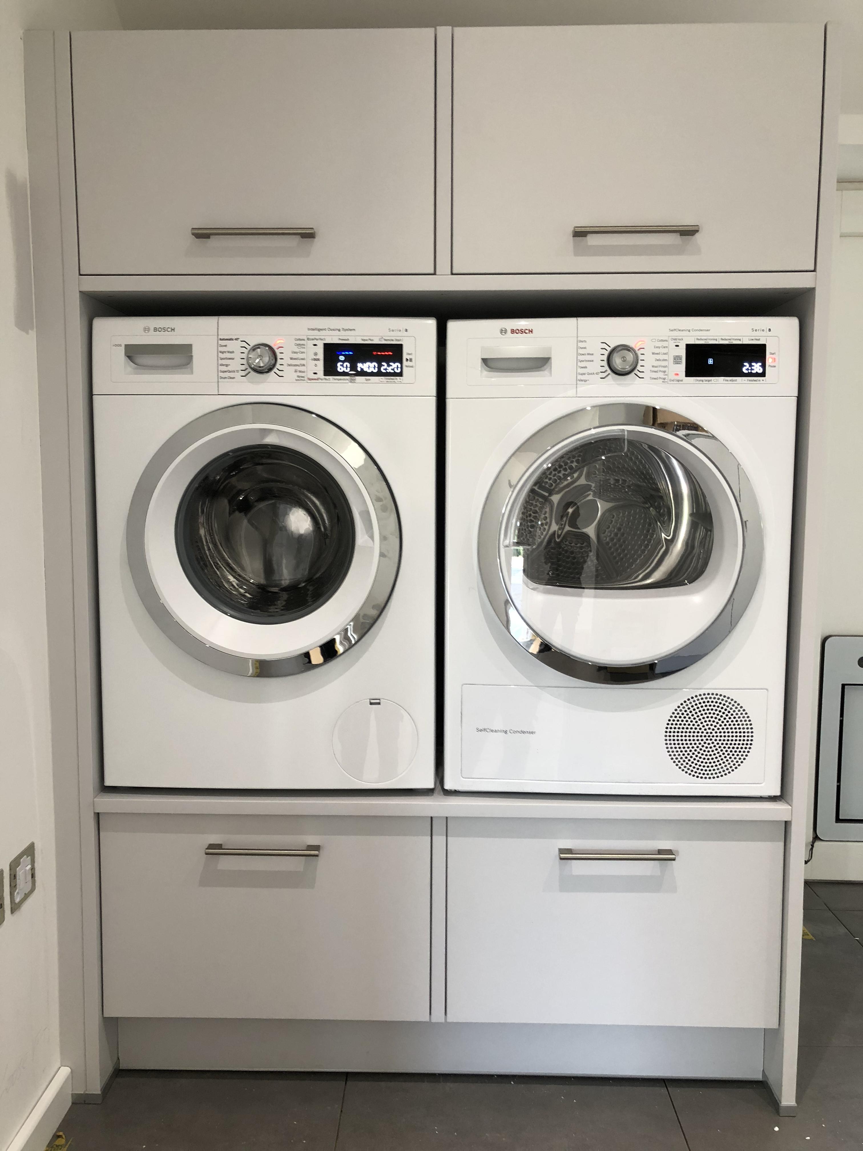

Back on the subject of washing......
Consider mounting your washer and dryer higher up if you have the room.
Makes it so much easier on the back! You need to design the carcass/units well as it’s subject to a fair amount of vibration if you’ve got your big pants on a 1400 spin :)
Heres mine and I don’t think  I could go back to ground mounted.....

2 minutes ago, Barney12 said:
You missed - consider putting in a passive cat flap if you have a passive house (and a cat ...) ;)
Like that idea for the washer / dryer.

Posted
1 minute ago, joe90 said:
@Barney12 cool, must be substantial to deal with a washer on spin tho .
Yes, the design is key. The carcass is 25mm with additional reinforcement in various places with the whole thing bolted to the wall.

Posted
2 minutes ago, PeterW said:
Saw something similar to that and they built a pair of slide out shelves below them for the basket to stand on. Brilliant idea ..!
Yes, exactly that. Well at least it will be when I finish it :/
The bottom draws open to a flat shelf which lifts up for storage.
The only word of caution I'd give relates to the flooding of my late mother's farmhouse.  To make it easier to reach the washer and drier she had a raised plinth built at the end of the kitchen, so they were a foot or so above the tiled floor.  This worked very well, and saved her having to bend down.
However, a few years after having done this, she put a load in the washing machine and went around to see the wife of the farmer "next door" (about half a mile away).  She was gone a long time, and one of the suspension units for the drum failed.  The machine must have started vibrating and shook itself forward until it fell, face down, on the floor, smashing the door.  It went on to try and do a rinse/spin cycle, but the level sensor didn't shut off, as it was trying to fill the whole ground floor of the house.  She came home to find the carpets floating off the floor and pretty much everything on the ground floor soaking wet.
It took around 3 months to dry the place out, rip the plaster off the walls and re-plaster, replace most of her furniture and all the carpets, etc, during which she had to stay in a hotel - not the easiest place to run a farm from. The insurance company paid out for everything, but even so it was a heck of nuisance.
