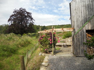

    FYI here is a 2015 image of [very] rough sawn untreated Scottish larch in 3 generations: gable end erected in 2005 logstore erected in 2008 patio pergola erected in 2015 The

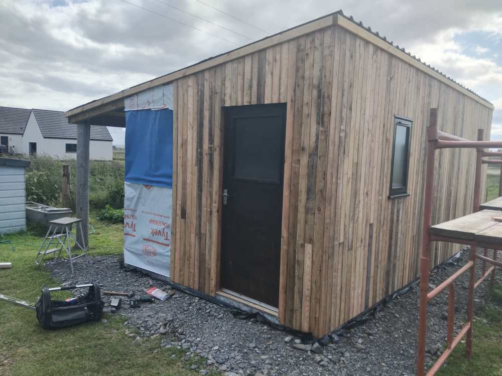

So, my larch is now onsite and I can no longer put off the decision on treatment.
By my estimation, I have 120m2 to treat- this is the front face only of the back layer of boards, and the front plus sides of the boards that will go on the top layer.
I'm getting pretty bewildered by all of the options available. Sioo works out at about £850 which is just too much- about the same as the wood cost itself. It would have to have magical properties for me to justify spending that much. Plus, as has been said, it is an accelerated weathering system and what I really want is to preserve the fresh cut look.
Next in line are Osmo products- either two coats of the UV Oil, or a base coat plus the UV oil on top. Either way works out at about £450. I am inclined to go for the two different products as they have quite different jobs to do and it works out about the same cost.
Then we enter the world of cheaper finishes with more recognisable names, e.g. Ronseal, Barrettine. There are a wide range of products available including ones for log cabins, which sounds fine, but what I need to do is avoid cheap and nasty stuff that might only be suitable for a garden shed. These products would work out around £300-£350.
Comparing the different products is tedious as the coverage and number of coats varies, so you have to be methodical and work out the total cost for each option. I'm starting to see the appeal of leaving it untreated!!
