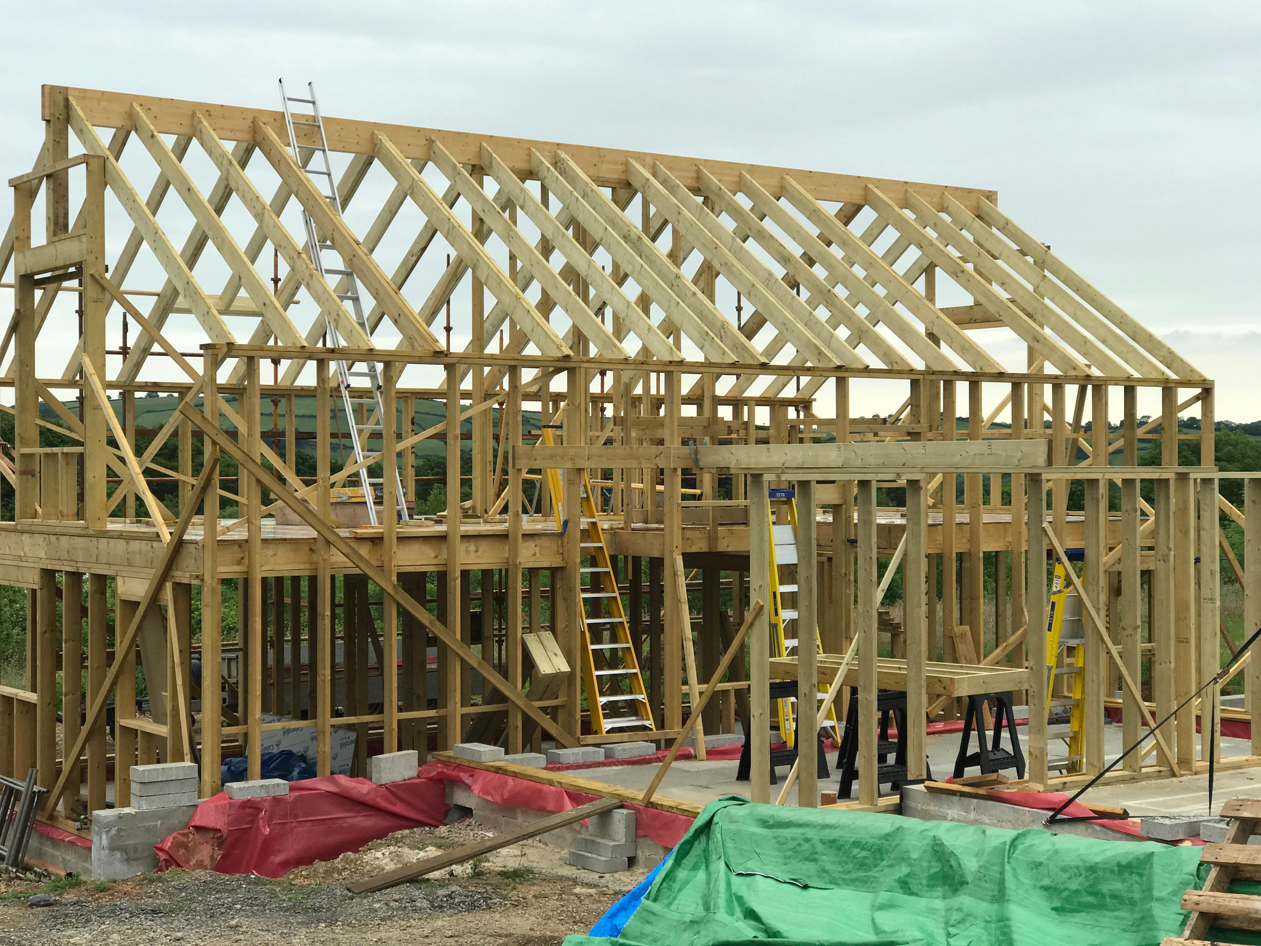

Thedreamer Posted November 6, 2018 Posted November 6, 2018 Hi @Ben100, I'm in the middle of a stick build timber frame self build. I weighted up the options but choose a stick build timber frame because: It was significantly cheaper and it is the opposite for cashflow, instead of paying upfront for a kit package you get building merchant's credit (two months) We have a great joiner We cut and build the kit in June/July so it was great weather. Stick building allows greater control over the quality of the materials and the time when you need them. You can more easily adjust for changes and if for any reason your measurements between your timberframe and foundation are slightly out this is not a problem, but would be disastrous for a manufactured kit. Fitting the insulation and ensuring air tightness will take time but my time is free in the evenings Of course there are plenty of reasons for arguing the opposite. But for me I considered the self builder's triangle (quality, time and cost) and being able to only select two, I was happy to take cost and quality. It also worth considering where a stick build ends and a kit starts. I.e what was done on site could have been built in a factory/large shed and perhaps some would call this an open panel kit? Here is my blog which has a few entries on that part of the build which might be of interest. 2

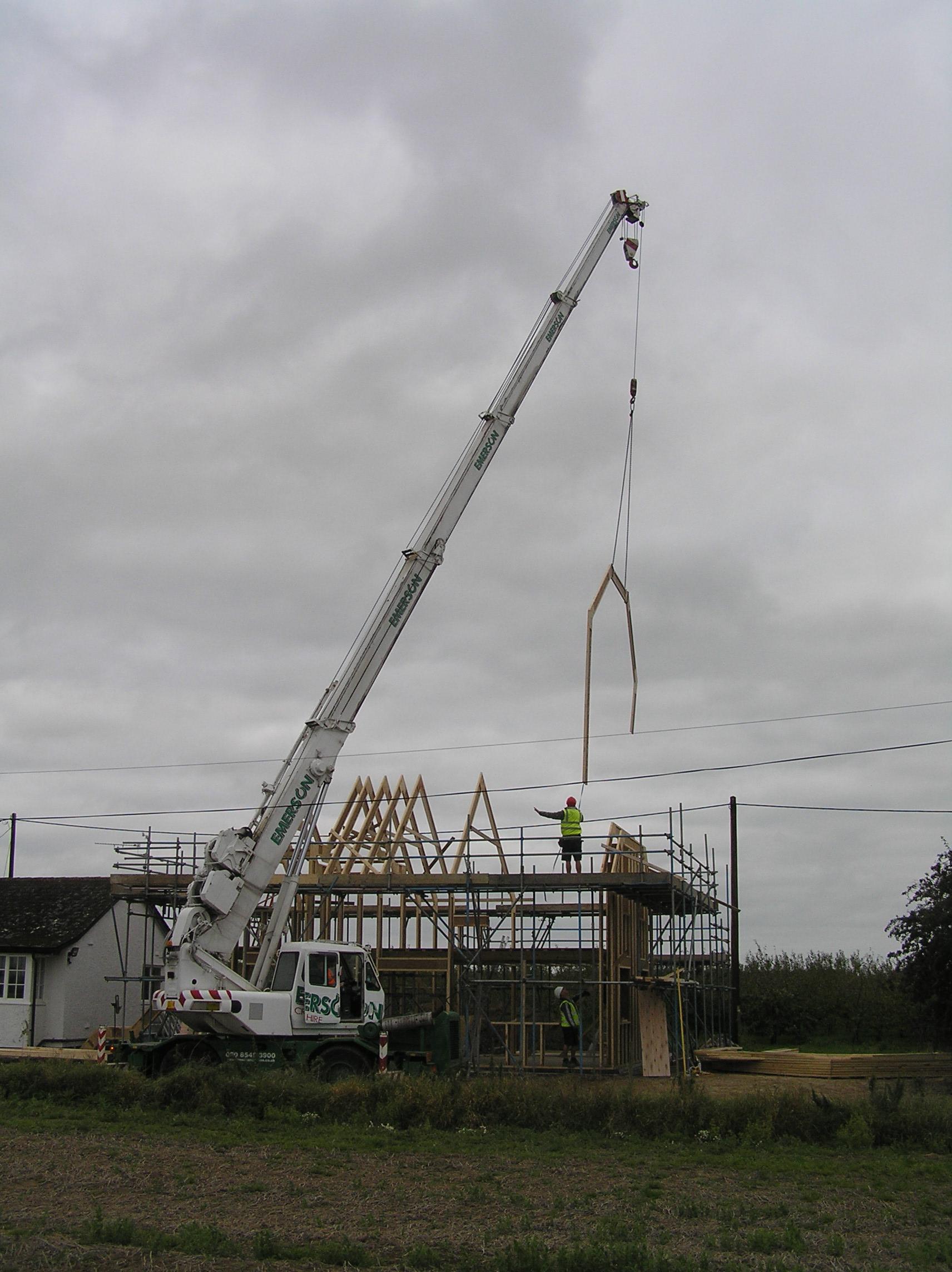

ProDave Posted November 6, 2018 Posted November 6, 2018 It sounds to me like you need to buy yourself a digger. You can get forks to fit on, or in place of a bucket, and a boom extension can make a handy crane, e.g our builder lifting the big ridge beam onto the house 1
