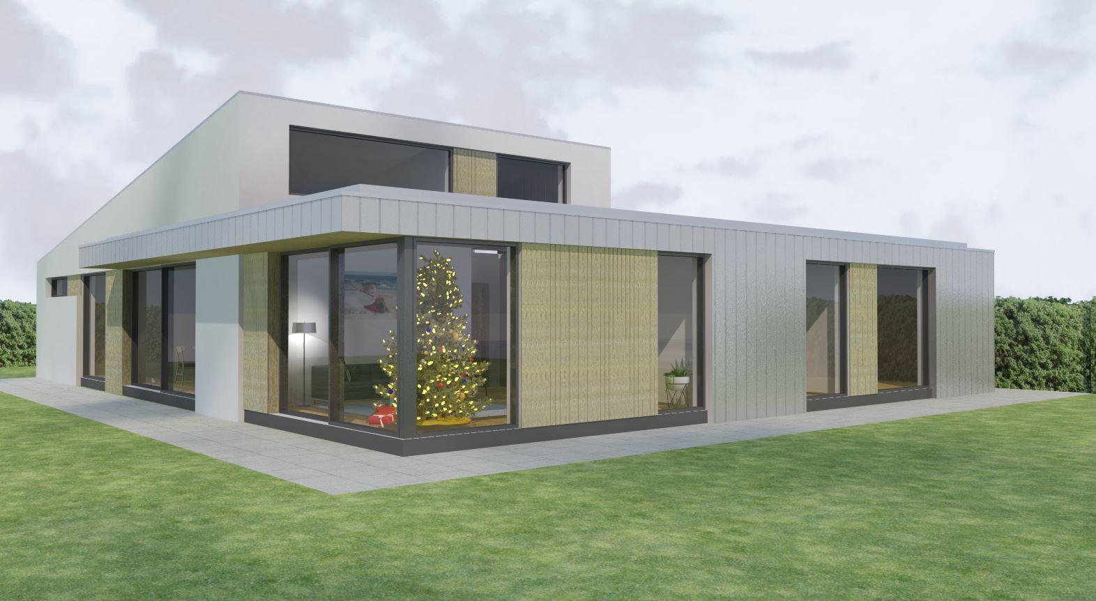

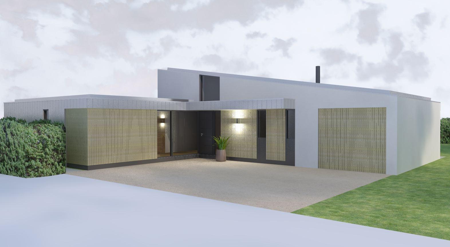

AliG Posted December 19, 2018 Author Share Posted December 19, 2018 (edited) Updated plans and 3D renders. My parents are over the moon. WC adjusted to add a cupboard. We might lose the other hall cupboard for a larger dressing room. Edited December 19, 2018 by AliG 7 Link to comment Share on other sites More sharing options...

AliG Posted December 19, 2018 Author Share Posted December 19, 2018 1 hour ago, bissoejosh said: I really like that, out of interest what sort of width is the overall Southern elevation? 18.75m 1 Link to comment Share on other sites More sharing options...

Ferdinand Posted December 20, 2018 Share Posted December 20, 2018 (edited) 12 hours ago, AliG said: 18.75m I like the design. MOdern and rangey. My comments: - The kitchen feels quite shut away to me. Is there an argument for having it more open to the hall? I would want a view through from outside the front door, which I think can be done by aligning the doors. Or making it wider. - The hall feels quite large .. to me perhaps excessively large, and I am not sure how easy it would be to make alternative use of some of that space should you need. * - If you choose to save your 300mm I would consider putting it in the garage as added width. * - Gut feel but would more sliding doors be appropriate and more streamlined for the design? (*) If this is their potential last house, then perhaps give some thought to frail-old-people paraphernalia. Think, for example, how somebody in a wheelchair adapted vehicle such as a people carrier would approach the house from their vehicle. AT ours, the previous owner used to reverse his 4x4 into the 24ft garage, reverse his powered wheelchair out of the car, then come in via the utility room. AN alternative is to have a future design in your head for a car port or canopy extension to the porch in front of the garage that will prevent them getting wet. In our case, I find that I now have a Sholley and a Folding wheelchair kicking around near the front door all the time. We have enough rooms to keep it all under control but no suitably huge cupboard; that type of use case bears thinking about, and that will probably need to be done by you, Possible solutions are including an area in your porch which could also be your potential bike area, have your hall such that there is an alcove somewhere, or making sure that that hall cupboard is the right shape and easily accessible (full width bifold doors?). Ferdinand Edited December 20, 2018 by Ferdinand 1 Link to comment Share on other sites More sharing options...

AliG Posted December 20, 2018 Author Share Posted December 20, 2018 Thanks for all the comments. I originally drew double doors into the kitchen, the architect has changed it to a single door and glass panel. This is open to being changed depending on what my parents think, but also the issue of whether the doors interfere with where furniture can be put in the kitchen. The hall is deliberately large as I feel it is an important part of making a smaller house feel like a larger house. With the mono pitch roof, the hall will also be higher than normal and I think this adds some good wow factor (people may have seen my own slightly excessive hall). I have only just noticed that the architect turned the kitchen around swapping the table and cabinets around, not sure why. I would have liked the garage a little wider, but this gave a little in the need to keep the size down. I might ask for 100mm to be moved from the house to the garage when I look at the exact sizes. The mobility scooter/wheelchair thing is interesting. We could move the door in the hall cupboard to the other side if a wider cupboard is needed. I think if they got to the point where they needed a scooter they would stop driving. They are 70 and 71 and health wise seem fine, but already my mum hardly ever drives. One of the great things about the area is that there is a small supermarket, post office, coffee shop, pub etc within 6 or 7 minutes walk. Also lots of buses are available close by. They will have walk in showers which I think makes things easier for older people, we might put a seat in their shower, I will ask them. Their current apartment has an expensive steel enamel shower tray, unfortunately this is much more slippery than a plastic tray and I had to buy little dots for grip as my dad literally couldn't stand up in it. We will have some kind of bumpy tiles, when I ordered tiles for our house from Porcelanosa they were extremely good about asking who would use the different rooms and pointing out if they thought the tiles would not have enough grip. Link to comment Share on other sites More sharing options...

Ferdinand Posted December 20, 2018 Share Posted December 20, 2018 (edited) I would move the door in the “shower cupboard” anyway, on the basis that a 2.5m x 1m cupboard is better in wide not deep format. How many people have double wardrobes oriented end-on? For saving space And hence budget without compromising the essential function I think that there is more potential in optimising the master suite to save space rather than the garage. I have not got my head around it yet, but I think I think that the last 3 sqm of the Hall should be better placed inside the master suite, rather than having that door around the corner. The only reason not to do that is to access the big square storage cupboard, which you are talking about abolishing. I think you could get rid of that corridor-like en-suite, and have the en-suite and dressing room orientated north-south, entered off the space where the end of the hall is now, and have the door to the master suite in an end wall level with the wall of the second bedroom. I think the master suite could perhaps lose 0.5m or so off the north end in that configuration, which is worth a number of k on standard area rates. I also wonder about orienting the master bed east-west backing on to the dressing room/ shower, to give a view and direct morning sunlight. Perhaps include 2 sets of double bed sockets. Do you have a plot lined up for your daughter yet? ? F Edited December 20, 2018 by Ferdinand 1 Link to comment Share on other sites More sharing options...
