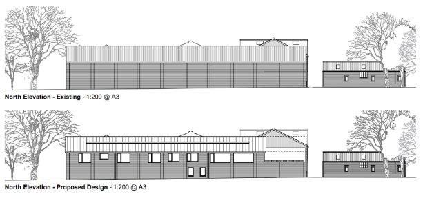

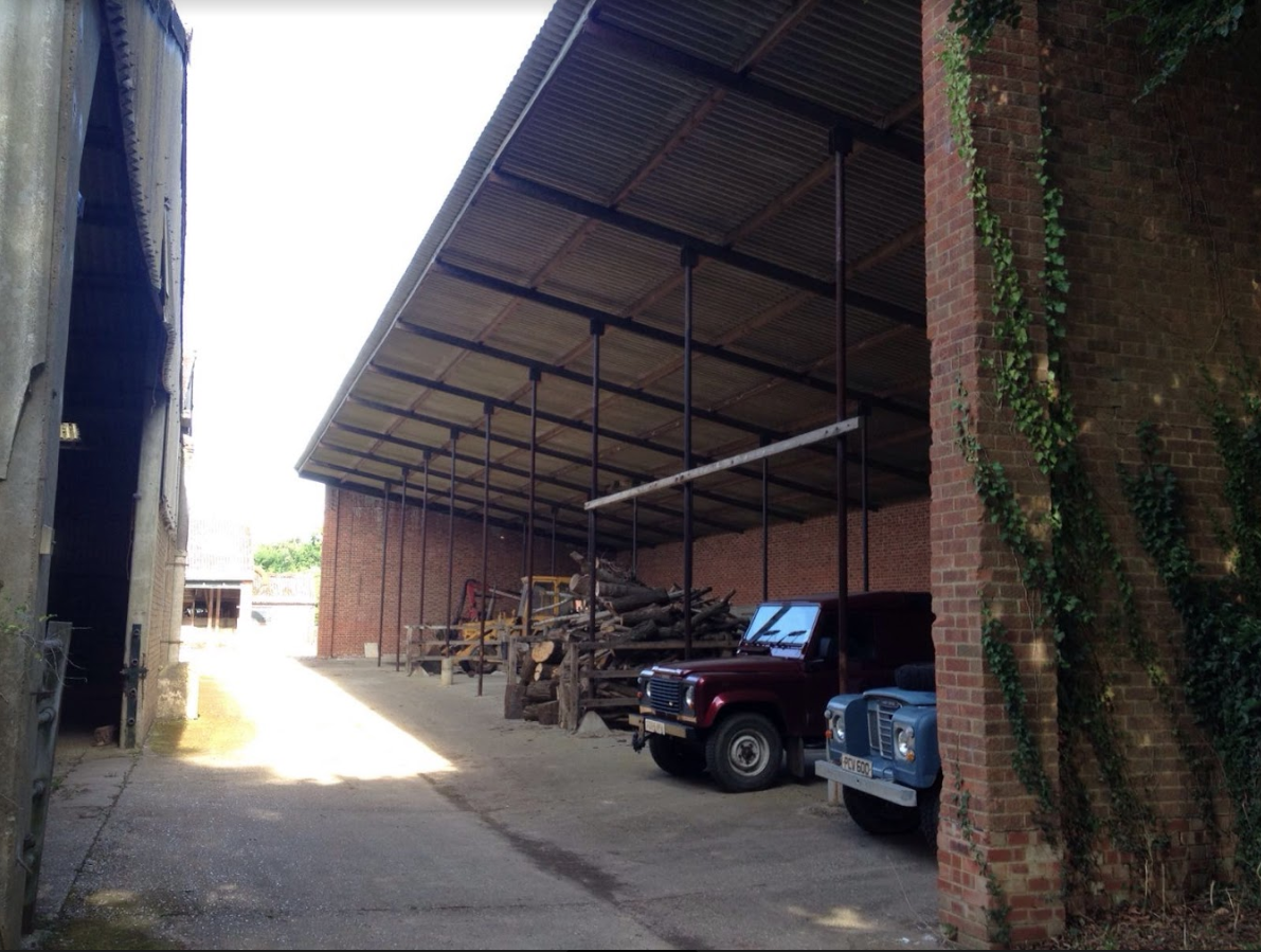

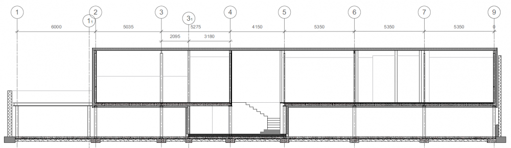

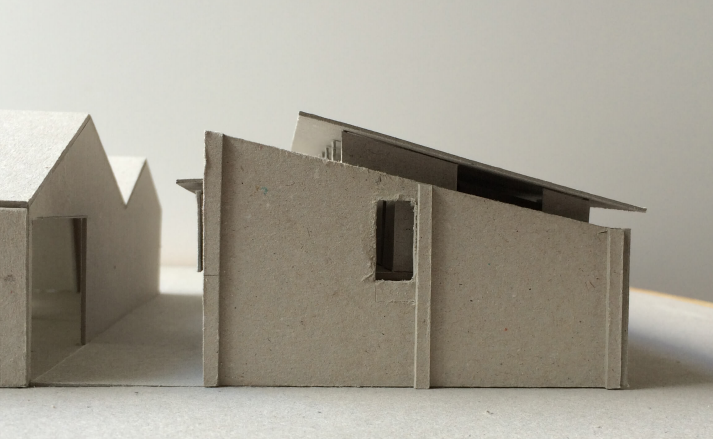

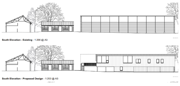

kxi Posted September 28, 2018 Posted September 28, 2018 Hello all We recently got planning for a barn conversion in Berkshire, to be our family home. We've been working on the design & permissions for a couple of years, during which time this forum has been invaluable. The barn is on a small arable farm at the edge of a cluster of in-use agricultural buildings. It was originally built as a cowshed in the mid 60s, brick on 3 sides and open at the south face, with a mono-pitch fibre cement roof. See image below. The open south face looks into large concrete & fibre cement barns about 5m away (i.e. not ideal). The north side looks out to trees then fields beyond. We have class Q permitted development to partially convert the barn to a dwelling. A subsequent full planning application to make changes to the eaves height and roof pitch was rejected and we didn't appeal. The idea is to add a first floor to the existing barn and then the majority of the house be on this first floor, with most of the ground floor remaining in agricultural use. This arrangement is to maximise the available space, gain more south light into the house (as the large sheds to the south block everything at ground floor level), and because we like living off the ground. We're also nicking off the top west corner of the existing shed to make a first-floor terrace at the west end of the house. Diagrams below show model photos and a comparison with the existing barn. The aim is for very good insulation and airtightness, but I don't think we will go for full passivhaus due to the poor form factor and that we want a lot of north-facing glazing. Our architect designed & built their own passivhaus a few years ago, so is familiar with it. The long rooflight running east-west (see model3.png) is to allow light into what might otherwise be a dark central corridor, and allow borrowed light into the north facing rooms via internal clerestory windows off the corridor. The rooflight is north-facing (though on a shallow pitch roof) so less of an overheating risk. There was PHPP modelling of an earlier iteration and the overheating was acceptable, but we'll re-visit this to check. We had originally assumed twin-wall timber frame + cellulose for the build method. However, with some changes in requirements, we are re-assessing this. Keen to get people's view on the alternatives that we'll be considering. TBC. 1

kxi Posted September 28, 2018 Author Posted September 28, 2018 @newhome @JSHarris I'm now curious as to what I might find inside our own models. There are a couple of aspects of the design that I think it would be handy to model life-size, in particular, a sloping roof height issue. Perhaps using some sheets, drawing pins and a wooden frame.

ProDave Posted September 28, 2018 Posted September 28, 2018 Interesting project. but seeing how it sits amongst the other barns I have to question if this was the best one of the barns to convert? Would one of the others not have given a better outlook? At least if the ground floor is staying partly as agricultural use, you can continue keeping the Series 3 under cover.
ToughButterCup Posted September 29, 2018 Posted September 29, 2018 Welcome. I'm with Dave on this one. My major modelling concern is the serious issue of how the Landies are going to fare. Will they be forced out into the harsh, wet cold British winter? I do hope you'll have a risk assessment done for that. Series 3s are delicate beasts. Well, mIne was.
kxi Posted September 29, 2018 Author Posted September 29, 2018 @ProDave The barns to the south are unfortunate, but this barn has by far the best view (to the north) and all the other barns are too small to be used on their own so would require stringing together in an impractical way. Since it's green belt, extensions are limited by planning (we did try). The barns to the south probably had a design life of 50 years and are 55 years old, so it's likely the house will live to see a change to the south. The way we've looked at it is that most houses don't have views on all 4 sides, and 3/4 isn't bad. + @recoveringacademic I see you are both admiring our series 3 sculpture. I have access to a conservator who can advise how we can preserve this for future generations. Having a ground floor that can fit the newer models (+ necessary fire-proofing to the ceiling) is one of the big factors in the build method choice.

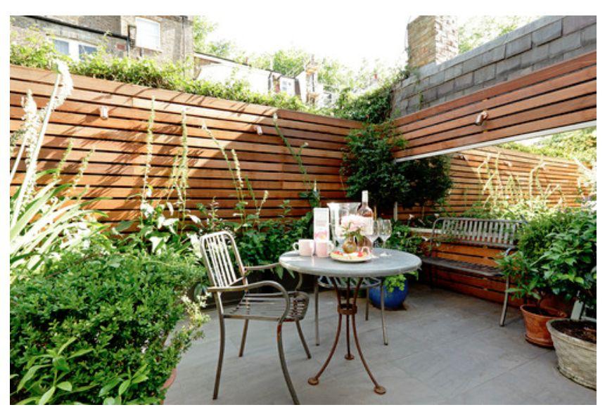

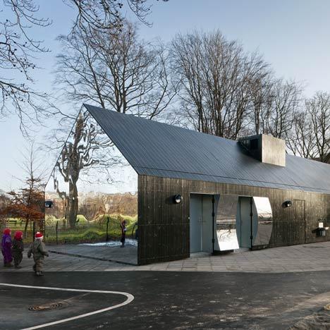

Ferdinand Posted September 30, 2018 Posted September 30, 2018 (edited) Welcome to the forum. An exciting project. Could you do something interesting with the Barn opposite, like paint it in camouflage or a mural of the landscape behind, or put some mirror-type strips on it with climbers in between? Or even something that will break up the shape? Lots of possibilities, perhaps also using lighting from your side. I think I would consider something to break up the monolithic block of ugly, and also something to make people coming in look beyond the wall and imagine that it is not there. This is interesting - put a fence in front that reads like a garden then other side, then a mirror reflecting your side to pretend it is there. You could make it look like another house, or the landscape beyond the end of the alley beyond your house for visitors looking at an acute angle, who then see an image of the side of your house as they walk forward. There are probably lots of good ideas you can borrow from tight urban designs, or other places, for your outside environment too. Here's another I like. >The long rooflight running east-west (see model3.png) is to allow light into what might otherwise be a dark central corridor, and allow borrowed light into the north facing rooms via internal clerestory windows off the corridor. Grand Designs last week had one of those that worked spectacularly well by being aligned carefully with the internal spaces of the room. F Edited September 30, 2018 by Ferdinand

kxi Posted September 30, 2018 Author Posted September 30, 2018 @Ferdinand Regarding the opposite walls, there's definitely some thinking to do here, but I'd mentally put it in a 'once we are finished' box. One idea was to add climbing plants, though the snag is they would be very shaded. This might be partly mitigated by cladding the house south face with stainless steel to reflect light from our south face onto the opposing side. This might not be effective or desirable though. Also the shed walls are made of white & blue asbestos fibre-cement, so I would not want anyone having to interact with them (e.g. for plant pruning), as any contact with the surface could in theory release fibres. The continuing presence of so many of these ageing, potentially lethal panels is something to be reviewed, but it would be a major undertaking to replace them. "Grand Designs last week had one of those that worked spectacularly well by being aligned carefully with the internal spaces of the room." Aha thanks, I'll take a look. It means the north rooms get light from two aspects, which is nice. How to operate the blinds/curtains over the bedroom ones is a slight snag but i'm sure can be solved. "Is there any scope for inside/outside living (eg Franch Doors) on the more attractive North side? I do not see that in the model, or perhaps I missed it." On the west end there is a first floor terrace within the original walls (see 3rd model image) with large doors/windows into the main living area. This terrace looks out over the future garden & trees to the north, then the farmyard & other buildings to the west and south. These last are perhaps not everyone's idea of a good view, but it does get the sun & sunset and various birds like wheeling around the yard at certain times of the day. A north terrace would certainly get a better view, but is currently a no-go from a planning POV as it extends the existing footprint. It would also be shaded all the time as it's north facing (but that might be fine). A deck at the east end also would have a nice view and get the morning sun, but again not allowed under current planning regulations.
Ferdinand Posted October 1, 2018 Posted October 1, 2018 (edited) On 29/09/2018 at 19:51, kxi said: + @recoveringacademic I see you are both admiring our series 3 sculpture. I have access to a conservator who can advise how we can preserve this for future generations. Wouldn't that be to spray with gold paint and bequeathe to Blue Peter as an example of excellence ! 11 hours ago, kxi said: "Is there any scope for inside/outside living (eg Franch Doors) on the more attractive North side? I do not see that in the model, or perhaps I missed it." On the west end there is a first floor terrace within the original walls (see 3rd model image) with large doors/windows into the main living area. This terrace looks out over the future garden & trees to the north, then the farmyard & other buildings to the west and south. These last are perhaps not everyone's idea of a good view, but it does get the sun & sunset and various birds like wheeling around the yard at certain times of the day. A north terrace would certainly get a better view, but is currently a no-go from a planning POV as it extends the existing footprint. It would also be shaded all the time as it's north facing (but that might be fine). A deck at the east end also would have a nice view and get the morning sun, but again not allowed under current planning regulations. I was asking more about ground level, as marked, which I hope is part of the plot for this conversion (even if you own the whole farm) - if not boundary disputes may rear their heads in a generation. I think that I can't comment more without knowing more, which it might not be suitable to post. And then there are the intricacies of Part Q ?, which I will avoid: Quote A little learning is a dangerous thing; drink deep, or taste not the Pierian spring: there shallow draughts intoxicate the brain, and drinking largely sobers us again.” F Edited October 1, 2018 by Ferdinand

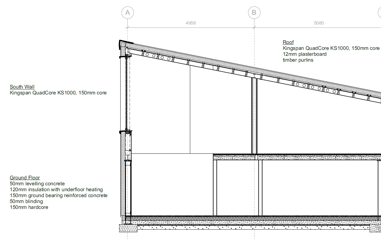

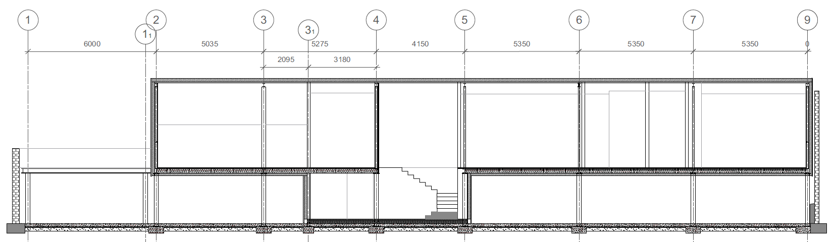

kxi Posted July 8, 2019 Author Posted July 8, 2019 After much consideration, the build method we'll be using for the conversion is 'big shed'. In that we'll be: - Adding a new steel frame internal to the existing walls - Which supports a new precast concrete plank first floor - Then wrapping the roof, new walls, and potentially the underside of the new first floor in Kingspan KS1000rw insulated panels - 150mm quadcore. Bearing in mind the house is mainly single storey up in the air - The panels fixed onto timber purlins for the roof, and off metal inline purlins for the walls - Internally, the external wall panels & purlins hidden by PB/fermacell board covering the 'cavity', also board between the ceiling timber purlins to cover the underside of the roof panels Why this? Naively, it seems like a simple & relatively cheap way to achieve a high-insulation (0.12U), thermal bridge free, airtight shell. Though the idea came about from trying to think of the thinnest roof possible without use of exotics like areogel (which for a 360m2 roof was out of the question) since we are very height constrained on the north side. Decrement delay issue noted. @scottishjohn We also wanted a highly fire resistant first floor (hence the concrete) with large spans, due to the ground floor space underneath being agricultural use. This leads to a steel frame, which the kingspan panels go with. Frame & panels can then be constructed as a single package. In terms of precedent, we have heard of a couple of similar residential examples, and I expect more will appear due to Class Q permitted development, and obviously there are lots of offices & workshops that use this approach, often as part of bigger sheds. Various issues to work through, but making progress. For example we've found the north-south steel roof beams are thick enough to have 100mm holes cut to allow radial MVHR ducting, which gets it out of the way.
