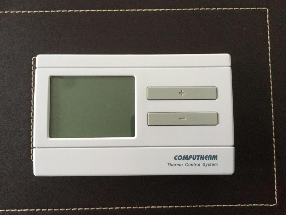

Jeremy Harris Posted October 3, 2018 Posted October 3, 2018 22 minutes ago, Hecateh said: @PeterW On advice from you and Nick I didn't get the stats, will buy those separately. You suggested I got the ones that @JSHarris recommended. Not got them yet. I've found the Computherm Q3RF thermostats to work very well, and can confirm that they definitely have dry contacts on the receivers, so are safe to use with a low voltage DC control system. If you want a programmable thermostat, then the Computherm Q7RF looks pretty good. The main reason I chose the Computherm stats was that they have the option of changing the switching hysteresis to +/- 0.1 deg C, which helps to reduce temperature overshoot in our application. Computherm Q3RF.pdf

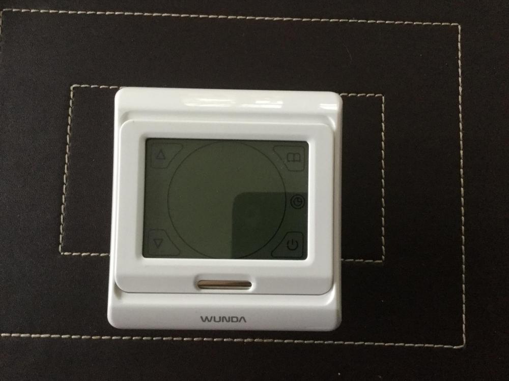

joe90 Posted October 3, 2018 Author Posted October 3, 2018 Right, got a reply from Wunda, they say the stat is clearly marked as switched 240v, 3 amp and they deny they told me it was a volt free contact . My word against theirs I suppose. 1
Jeremy Harris Posted October 3, 2018 Posted October 3, 2018 4 minutes ago, joe90 said: Right, got a reply from Wunda, they say the stat is clearly marked as switched 240v, 3 amp and they deny they told me it was a volt free contact . My word against theirs I suppose. Well, seeing as there is an audit trail as to what you did here, in this thread, I think Wunda are bang out of order. Certainly not a company I'd do business with again, that's for sure. I'm tempted to point them at this thread so they can read for themselves about the way they mislead you and caused you to damage the main board of your ASHP. Hopefully others might read this thread and choose not to deal with Wunda, given that their advice and technical data is so bad. Worth noting that they don't have the technical details for that thermostat on their website, either. The installation instructions I dug out and posted earlier came from TPS, not Wunda.
joe90 Posted October 3, 2018 Author Posted October 3, 2018 Yes, I think @PeterW had the same problem trying to source a TRV for his manifold.
Jeremy Harris Posted October 3, 2018 Posted October 3, 2018 55 minutes ago, joe90 said: Yes, I think @PeterW had the same problem trying to source a TRV for his manifold. IIRC, wasn't that Wunda not knowing anything about a product they were selling? The thing that gets me with them denying what they told you on the phone, is that their plain wrong technical advice could have killed you, rather than just blown the ASHP main board. They told you that the contacts were isolated and that the case of the product had been marked wrongly, so you might have taken them at their word, handled the wiring from the supposedly isolated contacts and been electrocuted because they weren't isolated at all. I bet a court would have taken the advice they gave, and which you relayed here, into account if such a dreadful thing had happened. I think the clear message is to not trust anything they say in future, as trusting their advice might just kill someone. 1
Ed Davies Posted October 3, 2018 Posted October 3, 2018 Also a good reason for dealing by email as much as possible. Partly because you'd have a written record (forgeable, of course, if not digitally signed [¹]) but also possibly avoiding a misunderstanding on the phone and giving the person you communicated with time to check what they were saying. E.g., have another look at the datasheet or talk to a colleague. Or even get a meter out. [¹] But then there are lawyers who think faxes are evidence ?
joe90 Posted October 3, 2018 Author Posted October 3, 2018 10 minutes ago, Ed Davies said: Also a good reason for dealing by email as much as possible. Partly because you'd have a written record (forgeable, of course, if not digitally signed [¹]) but also possibly avoiding a misunderstanding on the phone and giving the person you communicated with time to check what they were saying. E.g., have another look at the datasheet or talk to a colleague. Or even get a meter out. [¹] But then there are lawyers who think faxes are evidence ? Yup, I have 20 20 hindsight ? on another point with this should I use this stat to operate a relay to operate the ASHP (means the relay is always on when heating is required) or should I find room stat that has a dry contact? answers on a postcard to @joe90
