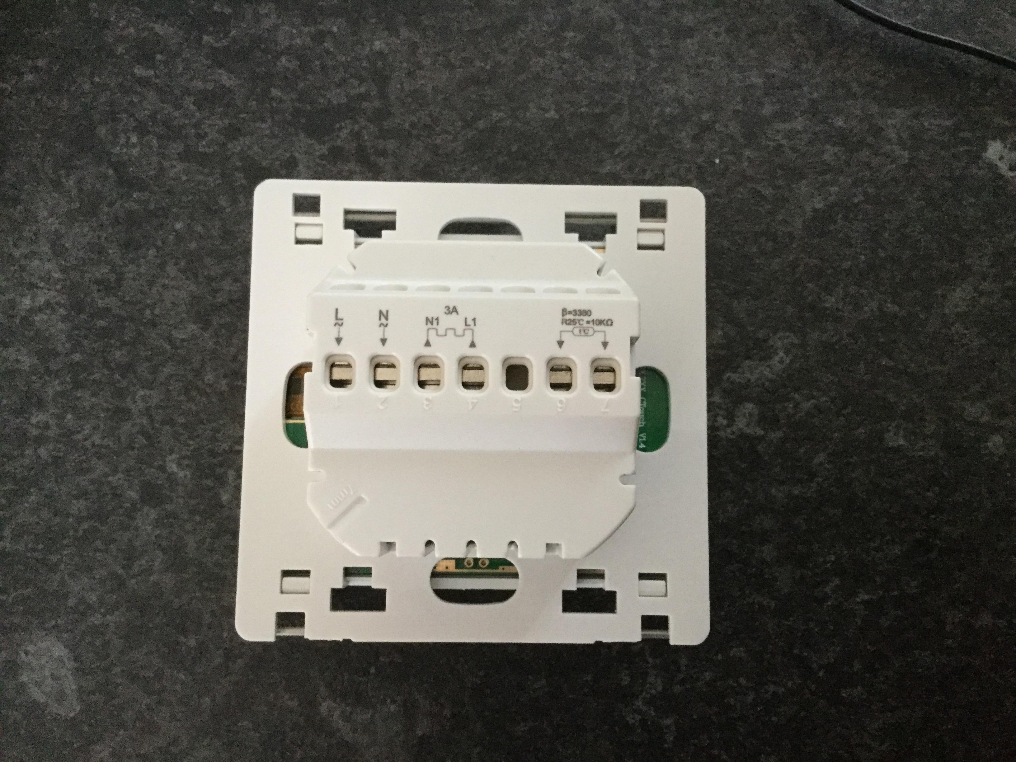

It’s no wonder I get confused, just started to wire the Wunda room stat and thought they had sent the wrong one, should be dry contacts but appears to show electric underfloor heating element (my electric ensuite UFH is like this). Called Wunda technical support and they tell me the manufacturer got it wrong and they assure me it’s dry contacts inside ?
check VERY carefully with a meter BEFORE you connect it.
i.e connect a bit of flex and a plug to provide power to L and N in. Then turn the thermostat up so it calls for heat and measure with a multimeter what comes out of L1 and N1
You don't want to be connecting a switched L to something expecting a dry volt free contact.

Right (big Intake of breath) wired in the Wunda room stat, timer for heating and switched it on, pump ran for a short while then tripped out an adjoining cct ?, tried again, same thing (scratching head). Turns out my builder who is putting up my new conservatory has a faulty chop saw and it’s that tripping out the same cct as the power to the room stat and timer. Perhaps I will provide an additional cct for these later.

AAARRRRGGGGGGGHHHHH. cct still tripping ( ringmain feeding timer and room stat) trips after about 6 seconds, found it’s the Wunda room stat, large spark from inside on tripping. Will be calling them first thing. Need to contact builder and apologies for blaming his chop saw?

Its the Wunda room stat. Just tested it all and no apparent wiring problems. Connected it again and as soon as the stat calls for heat the consumer MCBO for that ring that the room stat and timer are on trips . Fast losing the will to live ?
To test the ASHP, forget the room stat, just link it out so the room calls for heat all the time, and establish that the heat pump works first.  THEN you can look at the thermostat issue.

I will have a look in the morning.     But, when it trips it is the MCBO in the fuse board for the spur that feeds both the room stat and DHW timer. On removing the stat from the wall there is a flash and spark from inside the room stat!!! I am guessing the room stat may be faulty, if I take the switch wires off the stat and short them together there is not a problem (apart from it not doing what it is supposed to. If it was the flow that was a problem I am guessing the ASHP would just shut itself down. Glass of wine ? and TV

Like I say, remove that room stat and just link it our so it is calling for heat all the time and try again.
