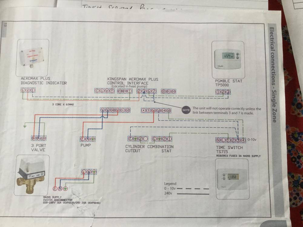

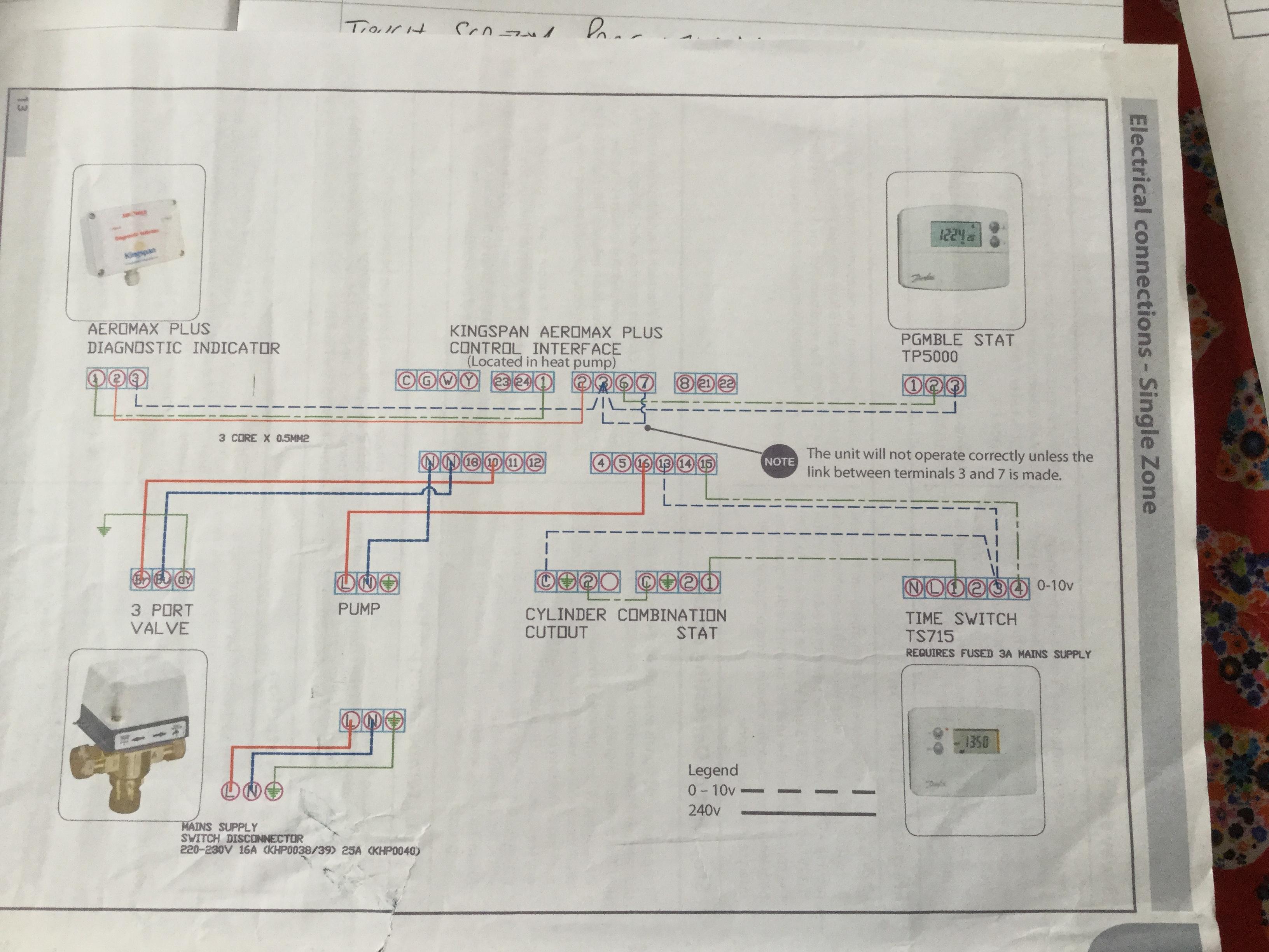

I am stuck regarding my ASHP and getting the UFH to work from it. Below is the wiring diagram for the Aeromax but I cannot see how the UFH pump can be wired to it, also I have a buffer tank for the UFH with a stat and not sure where the stat would be wired too. I bought a command unit which will programme everything (including the heat curves) so I should not need the timer or programmable stat. I am sure I am not the only one with a Kingspan Aeromax (carrier rebadged) ASHP . Ta

I think from reading the manual, the UFH circ pump will need to be triggered from the room stat and the buffer stat will need to trigger the ASHP.
That would mean the connection on 3/6 from the room stat would be the tank, and the programmable stat would just fire the circ pump.
The downside is that it means the UFH could call for heat from a cold buffer, or wipe the buffer out pretty quickly if the ASHP is in DHW mode.
You could use a zone valve with micro switch to trigger the pump too, or make it force the ASHP into HTG mode.
I’m still trying to work out why the Timeswitch connects to 13 on the controller directly and via the stat as the info on the web is less than helpful !!
I would not use a 3 port valve. Work of the devil in my mind. I would use separate 2 port valves, one for hot water and one for heating.  Without seeing the dull description of the valce wiring terminals you might need to add a relay to achieve that.
Once you have separate 2 port valves, it is then a simple matter of connecting the heating 2 port valve's switch contact (orange and grey wires) to turn on the UFH manifold and it's pump whenever the heating is on.

You can’t do that with the Aeromax as it only controls the 3 port. It has no concept of zone valves and it controls the flow temps internally to the two separate circuits.
Looking at he MIs, terminal 3 on the TS715 has no function, they're just using it as a junction.

I suppose you would not want the UFH pump to operate till the buffer was up to temp? I am hoping to not use the programmable stat or timer as I believe the command unit will do all this. ?

Ok so I’d assumed it was a standard 2 channel timer, but looks like they are using it as a single to control the hot water only.
These things must prioritise internally then as that’s a standard diverter valve not a mid position valve !! @joe90 was the 3 port supplied with the pump ..??

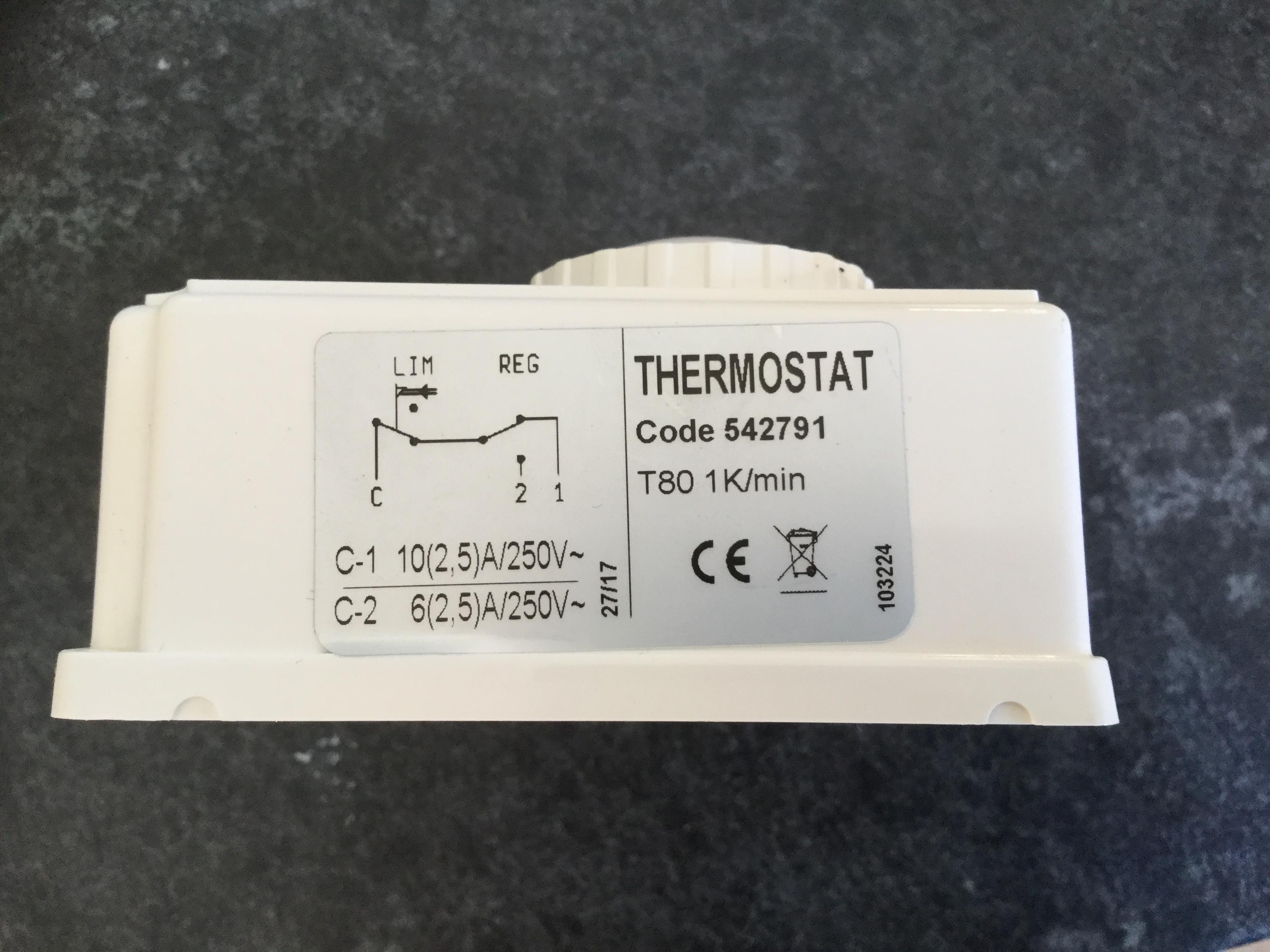

What stat is on the buffer ..?
Here you go

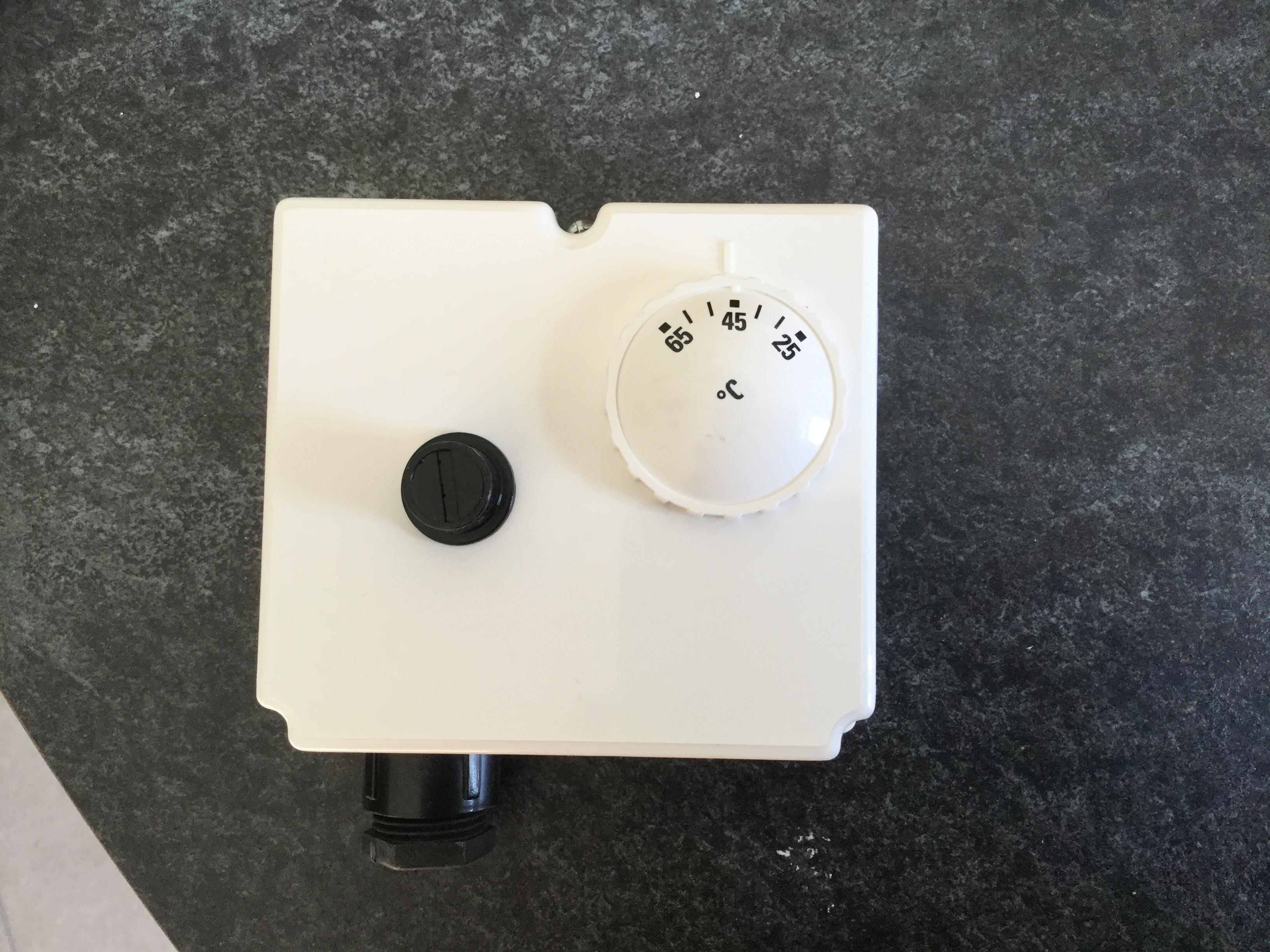

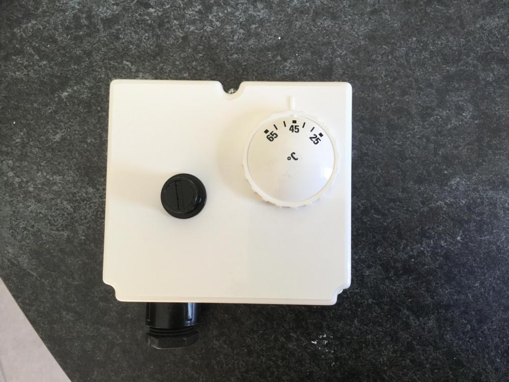

The DHW tank came with two stats, lower and upper, I am thinking that if I wire a changeover switch between them I can control the amount of hot water heated, upper stat for the two of us, lower for a house full of guests!
Is this a good plan or should I go back to woodwork?.

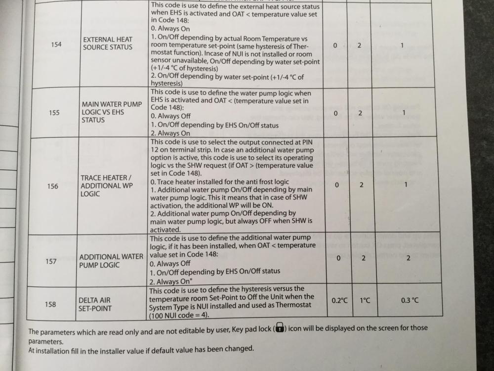

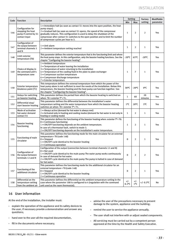

Just had a thought re: turning on the UFH pump.  The ASHP has a relay controlled output to switch an additional circulation pump, between terminals 12 (line) and neutral, all you need to do is wire the pump to this and then set the command unit to operate that relay.  The option for that is to go into the command unit installation menu and scroll to code 156.  There are three options, with the default being 1 normally.  The three options are:
0 - additional circulator remains off
1 - additional circulator ON/OFF cycle identical to the main pump.  The water pump works continuously in case of demand for hot water.
2 - additional circulator  ON/OFF cycle identical to the main pump. The pump is halted in case of demand for hot water.

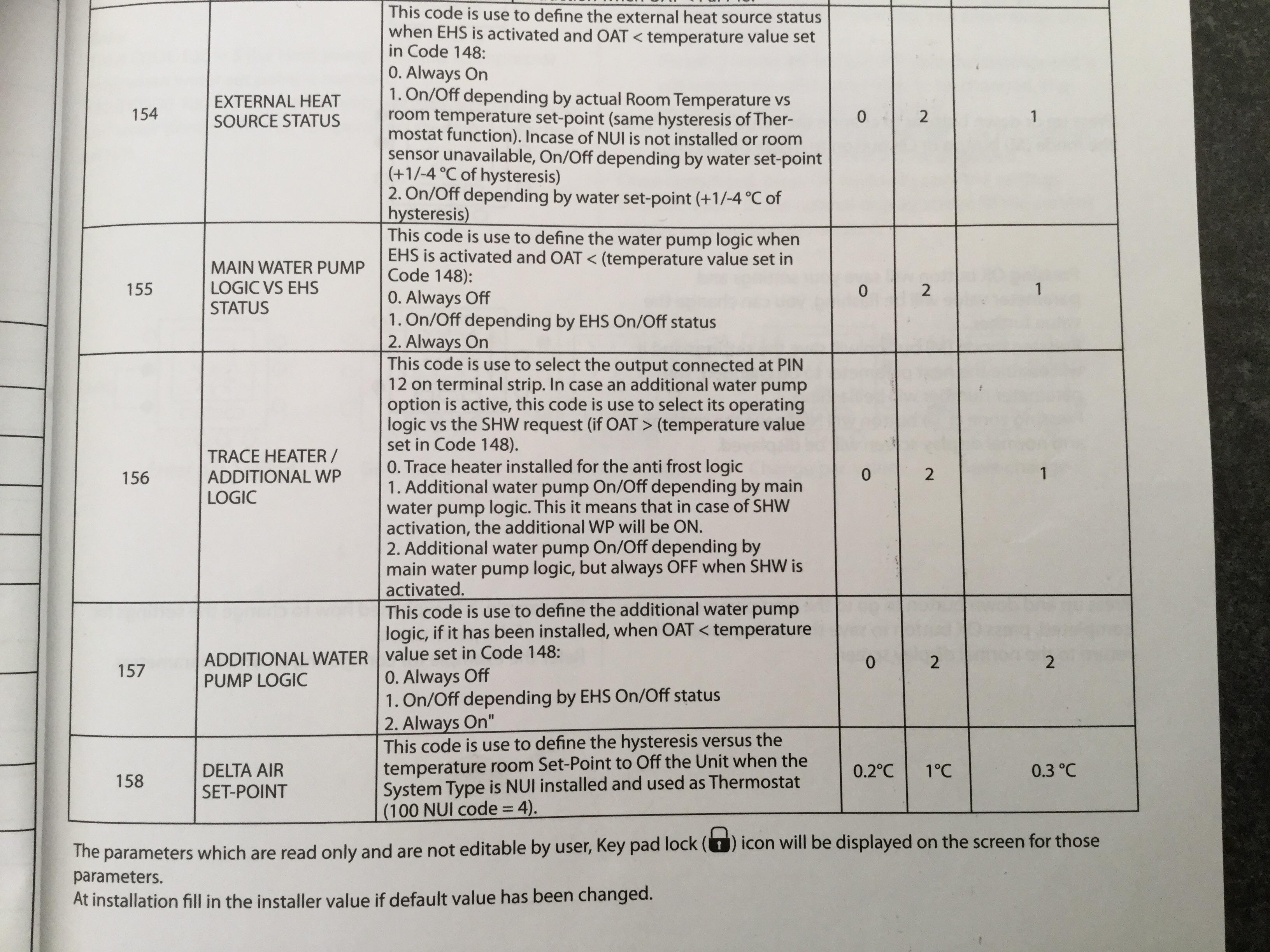

The default setting should supplier power to the UFH circulation pump whenever the ASHP is turned on, which seems a reasonable option to me.  You will need to check that Kingspan have set up the programmed defaults to be the same as my Glowworm badged version of the same Carrier heat pump, but it's just a matter of going into the installation menu on the command unit and scrolling through to see what code 156 is set to and changing it if need be.
Star man, just checked and mine is command 157. Slightly different, 0 = always off. 1 = on/off depending by EHS on/off status. 2 = always on.  I thought the external heat source was to stop defrosting? So perhaps 1 = pump fir external warm water to defrost it?? . So 2 will Work which is the default.
i am confused tho as command 155 indicates the main water pump is set to depend on EHS being on
(I prefer woodwork ?)
Edited by joe90
Looks like it's 156 for yours too, but it has an additional use as a trace heater power source which isn't mentioned in my manual.  This is the section from my manual that shows pretty much the same selections:
Ah yes, oops thanks Jeremy.
