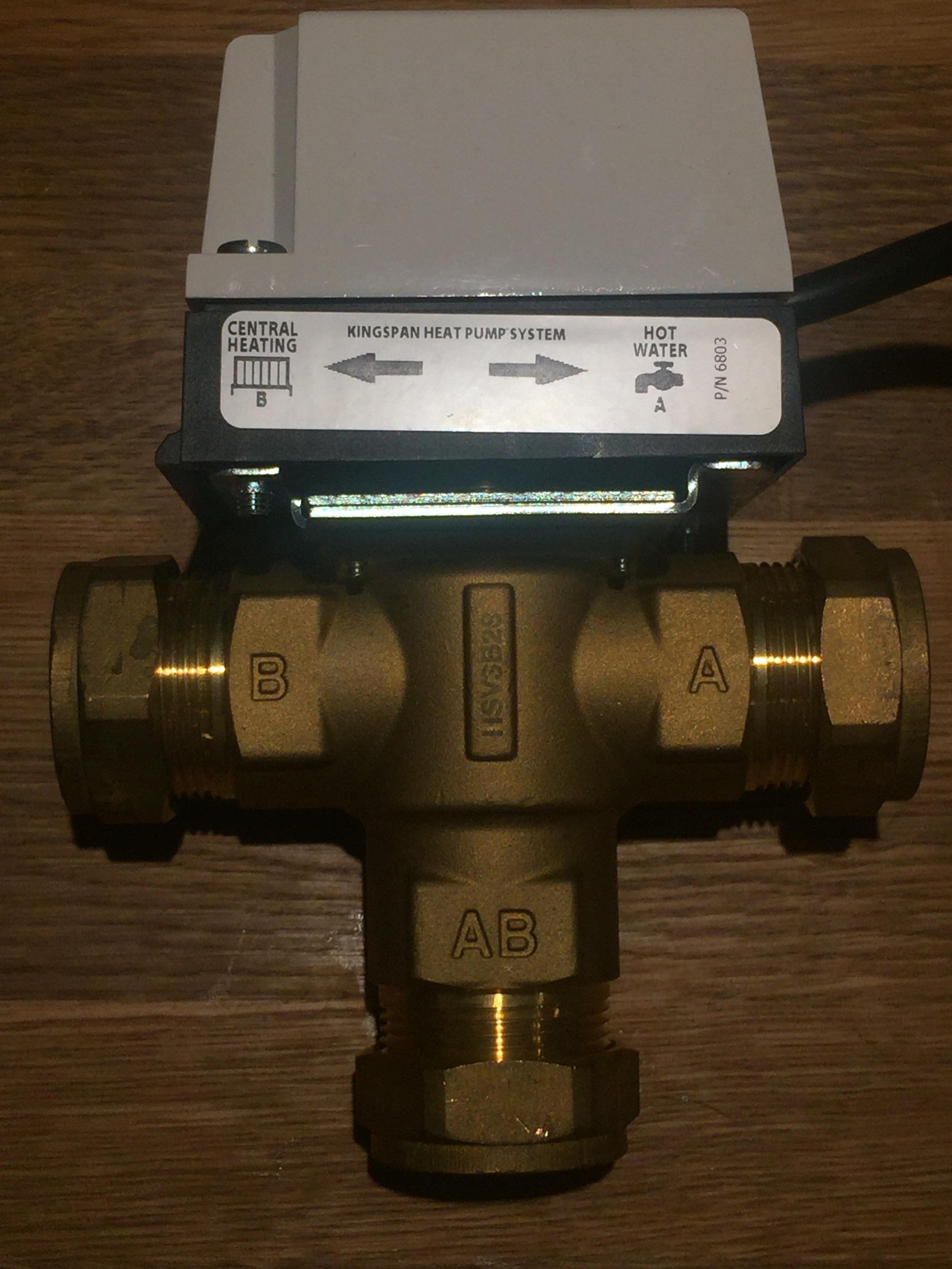

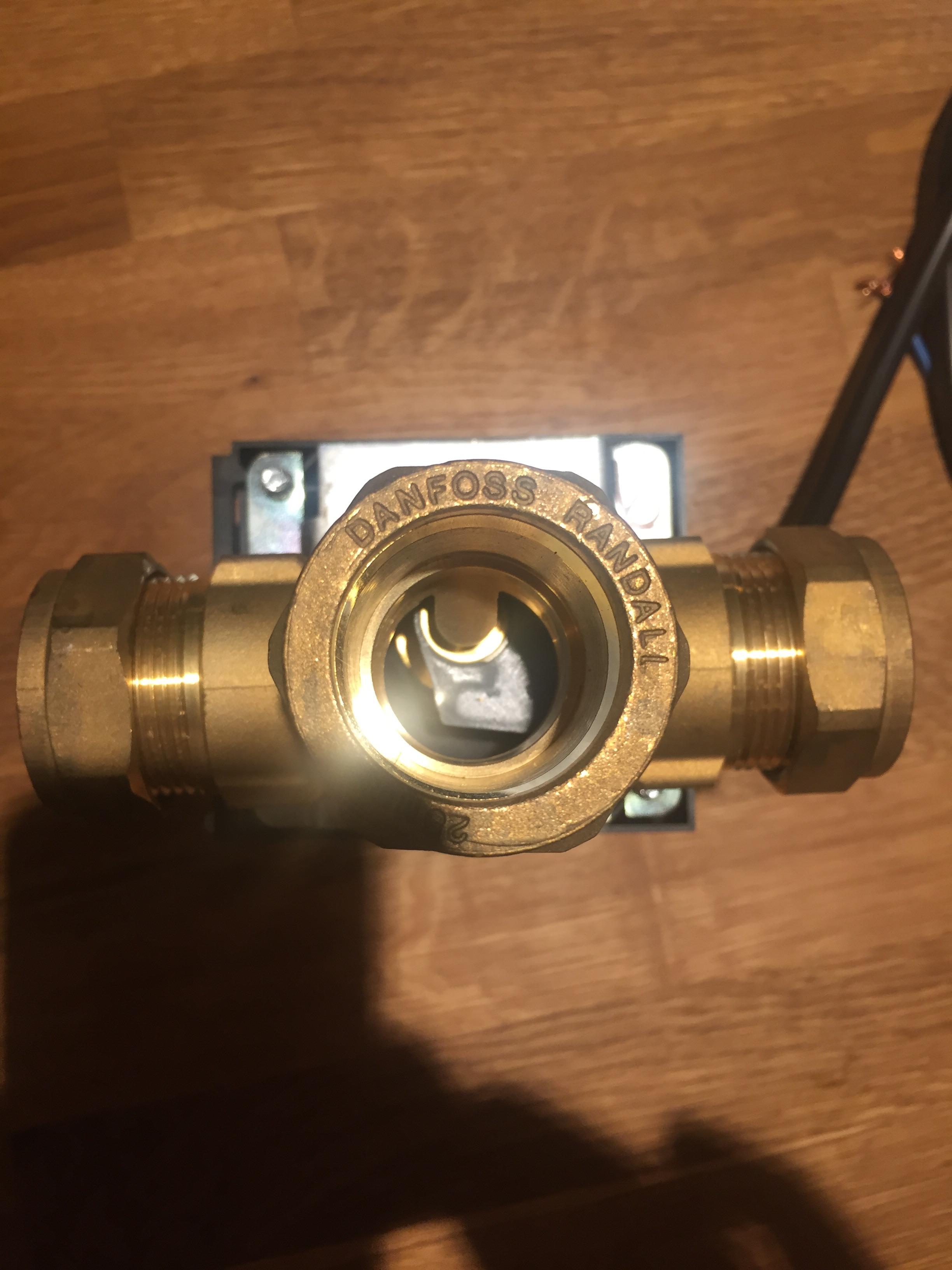

Port A, hot water is closed on my danfoss unit whilst not being powered.. which is what @joe90 was expecting I think.

when in DHW mode the three way valve is energised but hot water goes to A (heating), when in heating mode the three way valve returns and the hot water goes to B (DHW). I can reverse the three way valve but this is not what I should have to do!!!!
Edited by joe90
Ok, so it’s resting position is port B (hot water in installation guide) add power and it switches to port A (heating) in 18 seconds. Returns to port B under spring in 8 seconds.
Is yours plumbed to water on B and heating on A?

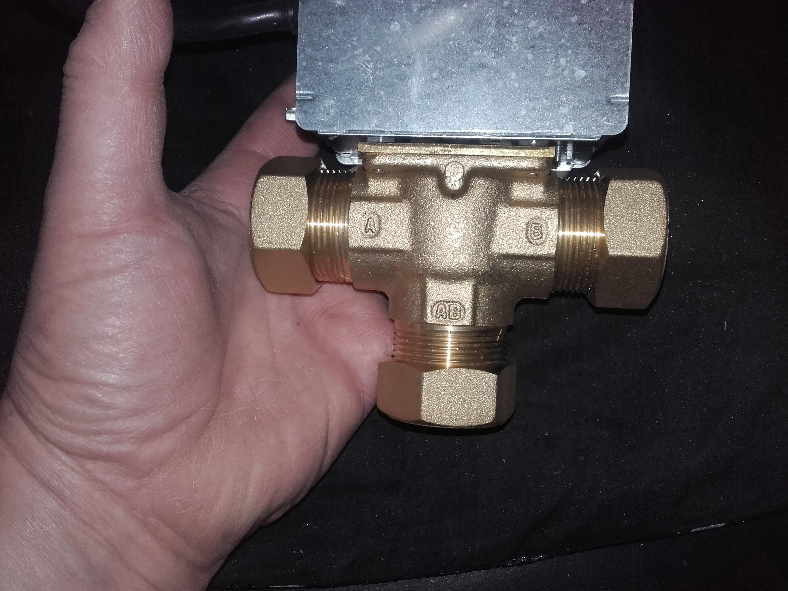

This is the one I have:
Straight out of the box, not wired up and set to Auto it ports to B. Set to Man and it ports to A & B.

I've no probs wiring it up just this thread made me question whether Honeywell is wired/ported different to the Tower one in at the mo. I tell you what you can tell the quality of Honeywell compared to Tower. Streets ahead right down to the tinning on the wires and documentation. I'm a convert!

In a nutshell it’s this, my ASHP delivers power to the three way valve when it goes into DHW mode and no power when in heating mode. The three way valve i have works the other way round . I can get over this by reversing the three way valve but can’t believe I am the only one to have noticed this!!!.

Can only be because the valve is operating the wrong way. The ASHP energises the valve in the DHW state, and de-energises it in the heating state.  This is the normal way diverter valves work, as most of the time they will be de-energised and running the heating.

It may be worth whipping the head off and seeing if the spindle rotates 360 degrees.
If it does, you can turn the head and the spindle 180 degrees and then it will operate correctly. I’ve had this before as I bought a Danfoss mid position that did what you say and it was only when I checked the ports and the head I found it was back to front. The head wasn’t fitted and it looks like someone had reversed the spindle and put it back in the box .... as a matter of course I now blow through them to check ..!!!!

AAAAHHHHHGGGGGRRRR, can’t get the head off, it’s in an awkward position and the back screw didn’t release th e head, having a coffee and calming down.

Two screws and the head comes off. Set the ASHP to come on and rotate the spindle to check you get warm water both sides..... then realign the spindle the way you want and put the head back on !

Just tried this before I leave and I have got it off, the spindle only moves about 30’, yes I can get warm weather both sides, it won’t go on the other way round!. I will have to drain and swop it around.
