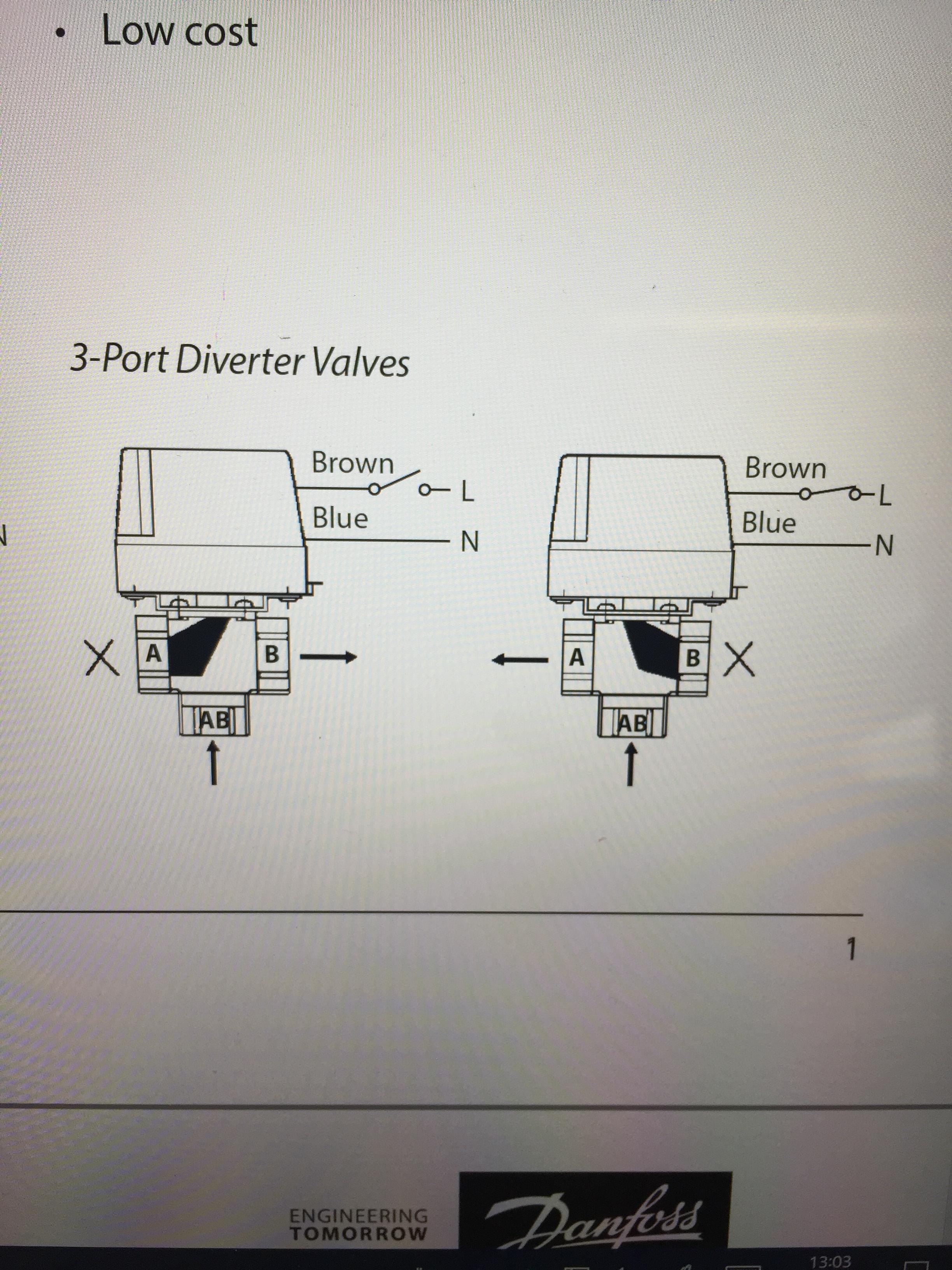

On 02/11/2018 at 09:52, joe90 said:
question. Is the three way valve normally sitting to provide Heating then “on” (powered up) when wanting DHW. (This is what I would have thought).
1/ Can I ask that question again. As mine appears to be working the other way, heating means three way valve is powered to supply water to A
2/ The three way diverter valve IS plumbed the right way round ( A for heating, B for DHW)
I am about to re set all the parameters on the command unit but I am slowly getting my head around this now.
(I am stuck indoors as I have injured my hand ?)
Just took a quick look at the danfoss website and it could be NO=DHW?
i looked only work computer hence the rubbish image....
you don’t have a mid-position valve by any chance do you?
No. Thanks Gav, your diagram shows powering the diverter  valve means hot water to DHW.
Still trying to work out what’s wrong?
Does it? I thought that closing the circuit meant sending water to A (heating), opening the circuit returns it back to B (DHW).
Ah, yes it does (brain freeze, your diagram is opposite to my setup, I.e. my heating is on the right and DHW on the left). That seems counter intuitive as I would have thought heating would be on longer than DHW so 3 way valve would be energised for shorter periods. That will teach me to make assumptions.

Just got back and started again!!!. With the control unit set up I can get it to “deliver DHW” and the pipework gets slightly warm but not as hot as I would expect ? It appears the three way valve works the wrong way round, this from Honeywell installation instructions
“The valve MUST NOT be fitted on the return pipework under any circumtances. Flow from the boiler must be connected to port AB, the radiator circuit to port A and the hot water cylinder circuit to port B.”
however on mine when DHW is called for the three way valve operates but the “warm” water goes to A (heating not DHW) hence the original reason I thought the three way valve was the wrong way round.
am I going mad?
Concentrate first on why the water is "warm" not "hot"  What does the display say? does it say it's heating water or heating?  If it thinks is is doing heating it will only be warm (and the valve will be in the correct position)

To get things “going” I forced it into DHW mode but because the three way valve works backward it successfully charged the UFH buffer tank! And finally appeared to get hot. ?. I have changed the water temp (heating) to 35’ and manually set the three way valve open so will see if it heats the buffer when it’s temp drops. I am leaving the DHW tank on immersions as I will get it in the neck if SWMBO has a cold shower?.
its the three way valve working backward that has foxed me, I have asked my plumber friend if he can spare me an hour next week to get his take on this.
i am relieved however that my Ebay special ASHP is working and it’s just the controls that are playing silly buggers.
As I say concentrate on getting "hot" water regardless.  If as you say the valve is operating the wrong way, then it would heat your heating buffer tank "hot" rather than "warm" when you are demanding "hot" water.  If it does that then you are a step closer and the valve operation is something else to work on later.
am I going mad?
Are you certain that your system is calling for DHW or heating?
If there is any doubt, why not just test where the heat is going by linking out across the terminals in the ASHP for heating (no. 3 and 6 IIRC). And then do the same for heating (no. 13  & 15 possibly).
Also have you got a link between terminals 3 & 7?
am I going mad?
Is that a 3 way diverter valve as opposed to a mid position one?
What model btw?
Edited by Onoff
@Onoff I think @joe90 said it was not a mid position above somewhere. It’s a danfoss valve I believe.. as per the document I linked above.
He says Honeywell above. I'm only asking as I've one (a Honeywell) to fit. I'm going to run it on the bench so I make bloody sure I know how it ports.
