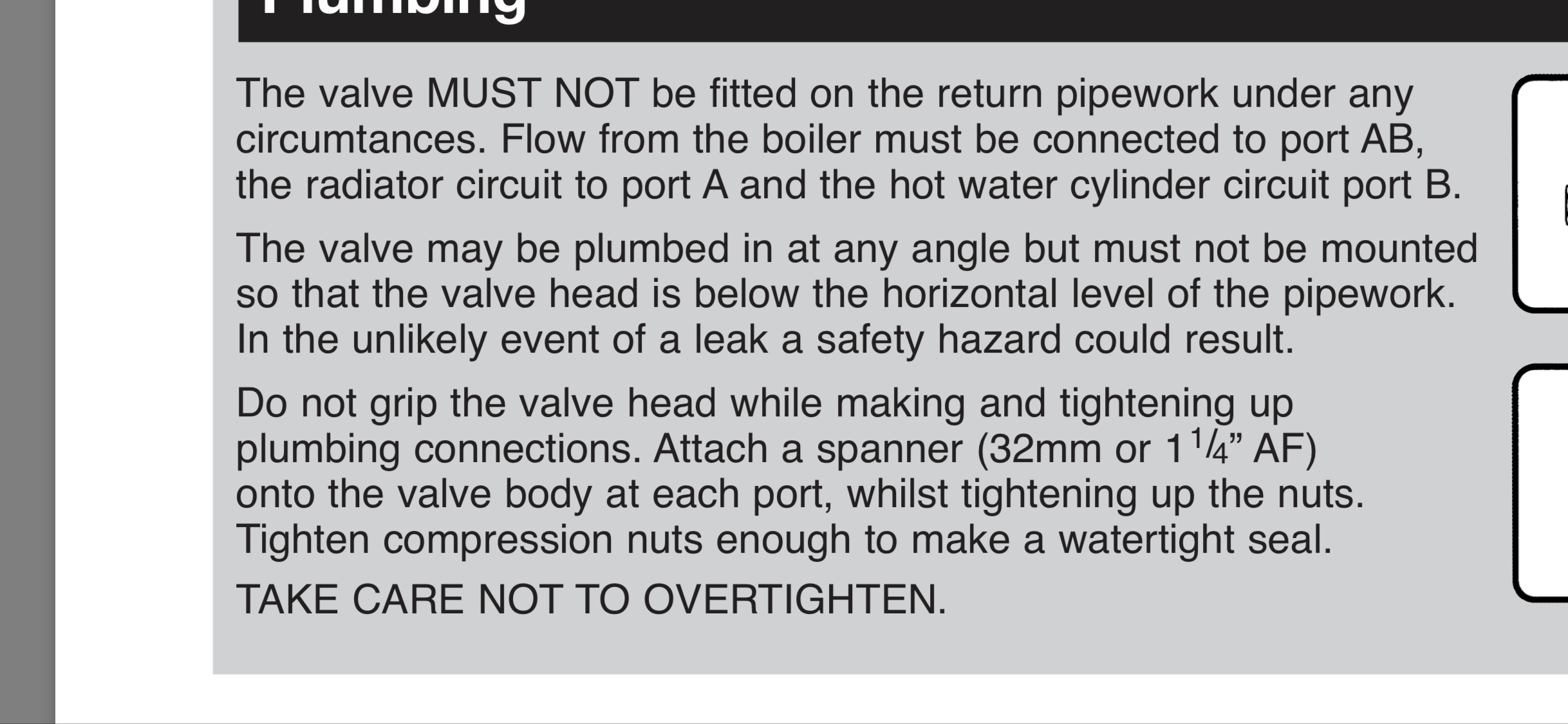

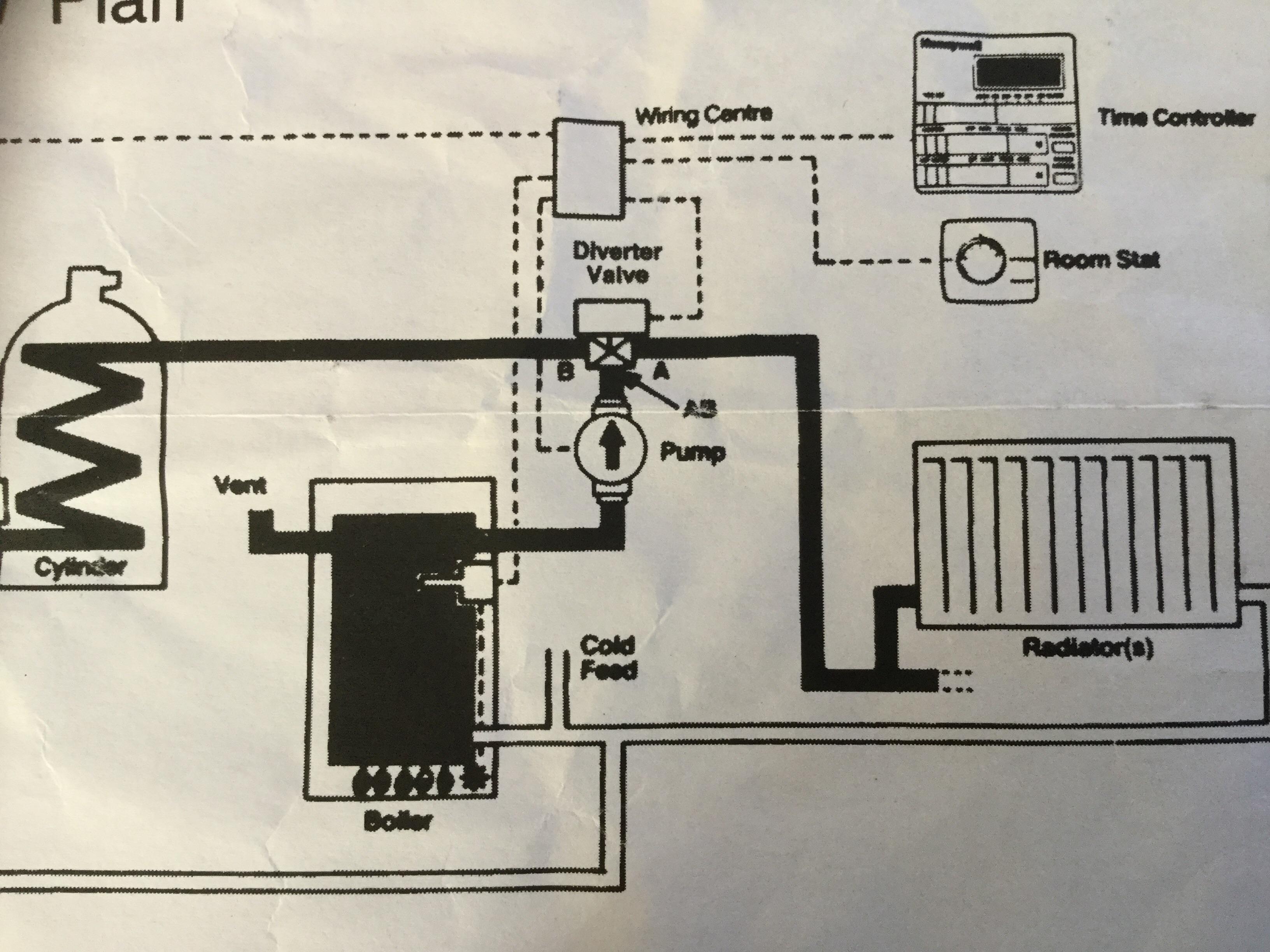

joe90 Posted November 11, 2018 Author Share Posted November 11, 2018 @Nickfromwales has confirmed that a diverter valve should sit at heating normally and on DHW demand power up. This is what my ASHP diagrams show but the valve I have (which I cannot reverse the head on) is the opposite. Am I the only one to have a diverter valve that does this?. I am going to drain it down and reverse the valve, should cure the problem (at last). Sorry for the long thread I just could not get my head around it. Link to comment Share on other sites More sharing options...

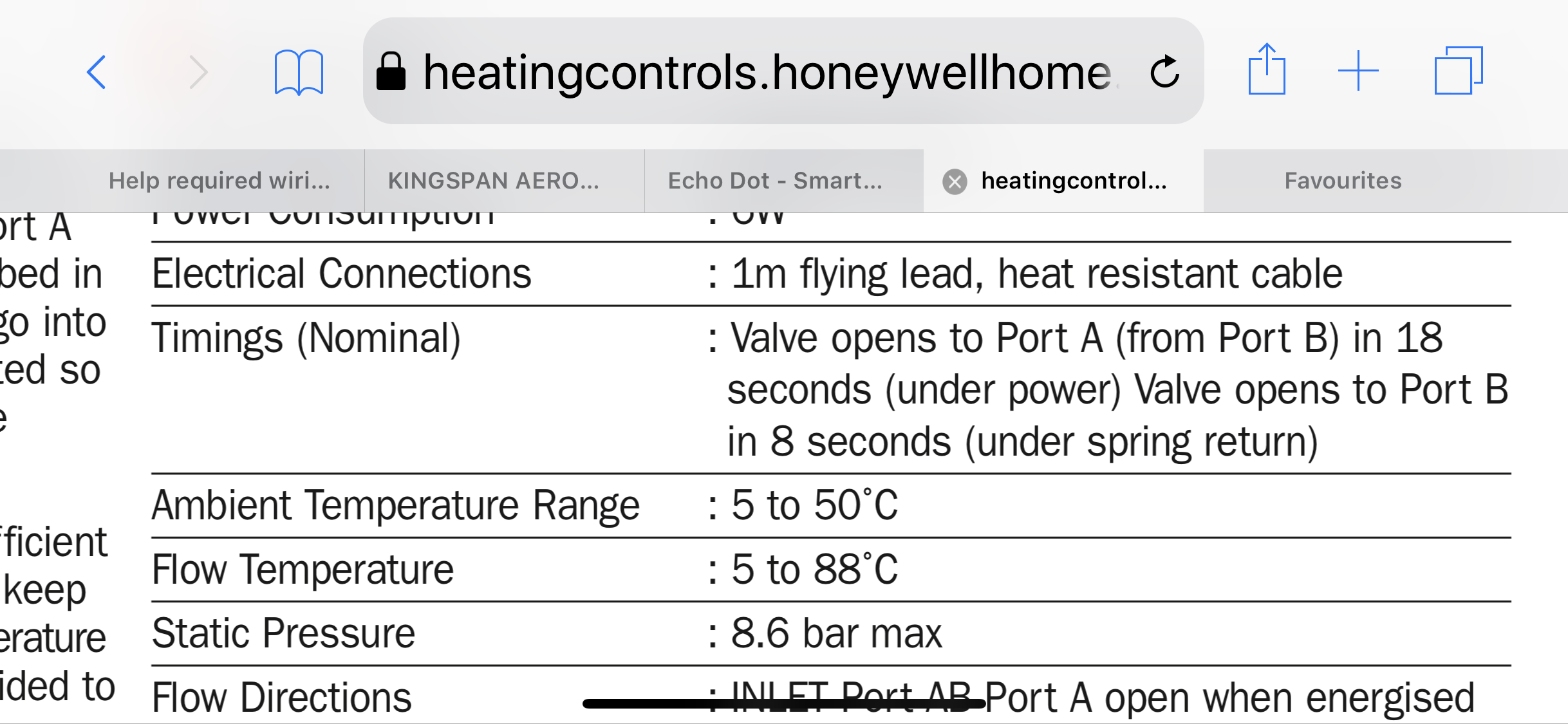

Nickfromwales Posted November 11, 2018 Share Posted November 11, 2018 @joe90 With both eyes open it reads that B aka DHW is the parked position of the valve. I’ll get my coat. It’s the mid position that parks in the heating position for pump overrun. Link to comment Share on other sites More sharing options...

joe90 Posted November 11, 2018 Author Share Posted November 11, 2018 9 hours ago, Nickfromwales said: With both eyes open it reads that B aka DHW is the parked position of the valve. Exactly, which is why my system is ass about face, my heat pump energises the valve when calling for DHW. Yet the instructions on the heat pump wiring and valve instructions say the opposite. I still can’t believe I am the only one to have had this problem. many thanks you guys ? Link to comment Share on other sites More sharing options...
joe90 Posted November 12, 2018 Author Share Posted November 12, 2018 Right, drained it down and took the diverter valve off and confirmed that in parked mode water flows from AB to B. Which should be heating, when powered up water flows from AB to A (DHW). This is as per @Gav_P pic above but not as the drawing I got with the valve. NOTE, I noticed that when using the manual override on the valve it only opens the valve halfway like a mid position valve!!! This must be for drain down only and not to manually operate the valve, this is why when trying the valve I was confused as both pipes got hot, it can only be tested by electrical energising. 1 Link to comment Share on other sites More sharing options...
ProDave Posted November 12, 2018 Share Posted November 12, 2018 I think the lesson here is don't just believe the instructions, actually LOOK at the thing and see if it really behaves as it should. 1 1 Link to comment Share on other sites More sharing options...
