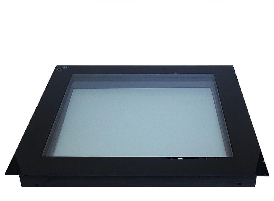

Simplysimon Posted March 4, 2019 Share Posted March 4, 2019 On 18/02/2019 at 17:11, Patrick said: I had some Flatroof Roofligh manufacturers claiming that it was absolute no problem installing Flatroof lights (which also have fairly decent U value) into a pitched roof (mine is 34 degrees) https://www.panoroof.co.uk/product/600mm-x-1200mm-triple-glazed-skylight/ Now i do not know if this is just Salesmen talk or if it can be done without a problem. Any Window Installers or Roofers on here? Please enlighten me @pocster someone needs help 1 Link to comment Share on other sites More sharing options...
joth Posted May 2, 2019 Share Posted May 2, 2019 Just found https://roof-maker.co.uk/rooflights/flat-rooflights/fixed-flat-rooflights/ they have one on clearance too. (See also I'm seeking anyone with Roof Maker experience over here!) Link to comment Share on other sites More sharing options...
