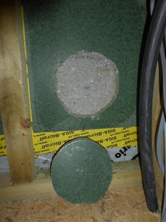

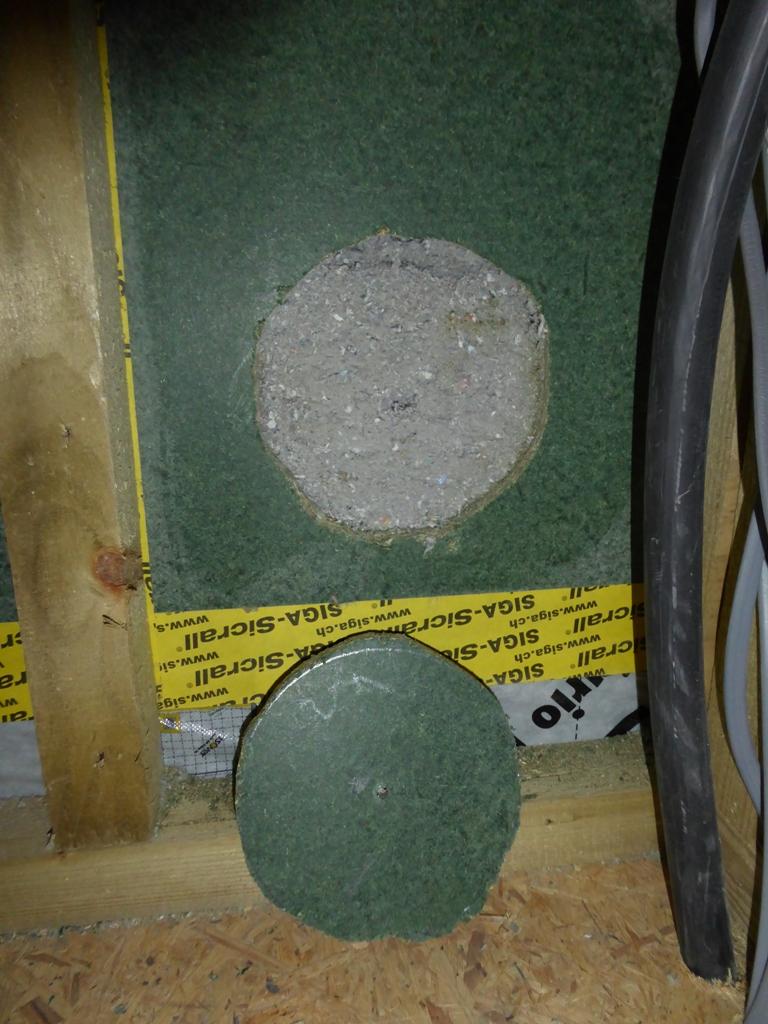

jack Posted September 4, 2018 Posted September 4, 2018 On 04/09/2018 at 08:57, JSHarris said: There's confusion in this thread about the two terms;they are different in practice. Expand I don't think there's confusion, but I agree it helps to have the different requirements set out explicitly. On 04/09/2018 at 08:57, JSHarris said: In practice, much of the outer airtightness in a pumped cellulose frame comes from the cellulose itself, which in a thick layer that fills every nook and cranny forms a reasonably effective airtightness barrier. Expand In general that may be true, but I'm less convinced about relying on it in areas that are less easy to access. The two areas I've had cause to open in our house (due to the roof leaks and while installing trims for our balcony fibreglass) have both had voids in the cellulose. In one case - and admittedly it's in a really awkward bit of wall - there was a void perhaps 100mm deep, most of the width of the wall, and stretching along nearly half of the width of the window under the cavity closer. Worse, the cavity closer had to be adjusted at short notice when the windows were being installed, so only had a very thin bit of OSB that definitely didn't seal very well to the frame in the area outside the window. Overall, if this region was relying on cellulose for airtightness, it was in trouble! I stuffed the area with some leftover rockwool I had lying around and sealed it up carefully before covering it with the fibreglass trim.
Dreadnaught Posted September 4, 2018 Posted September 4, 2018 (edited) On 04/09/2018 at 09:23, jack said: The two areas I've had cause to open in our house (due to the roof leaks and while installing trims for our balcony fibreglass) have both had voids in the cellulose. Expand Oh, that's concerning. Very concerning. It makes me wonder if: (i) there is best practice when blowing-in cellulose insulation to minimise voids; and (ii) there can be any post-installation checks to spot them. Edited September 4, 2018 by Dreadnaught
Jeremy Harris Posted September 4, 2018 Posted September 4, 2018 Usually the pressure on the fill hose should be a good indication that the cellulose has penetrated and filled every nook and cranny, but that depends on there being enough fill holes drilled at a close enough spacing. I remember chatting to the guys pumping our cellulose in and they reckoned that the cellulose seemed to flow a lot further than the distance between fill holes, but I'd guess that there is always the possibility that a particularly awkward area may not get filled completely, or that the installers could fail to spot that they needed to drill another fill hole in a critical area. The four holes I've had to cut through our walls were all very densely filled, and one of those was right in the top corner of a wall: This was awkward to cut out as it was right in a tight corner (hence the very ragged jigsaw hole) but it does show that the cellulose is normally very densely packed into the space, so densely packed that even the jigsaw blade hardly disturbed it and just cut it as if it were solid. This is where the fresh air intake duct for our MVHR goes through the wall - it comes out right under the eaves on the outside of the house. It was an afterthought, as I changed my mind about the type of MVHR we decided to fit so couldn't put the ducts through the wall before the walls were filled, which would have been the better option.
