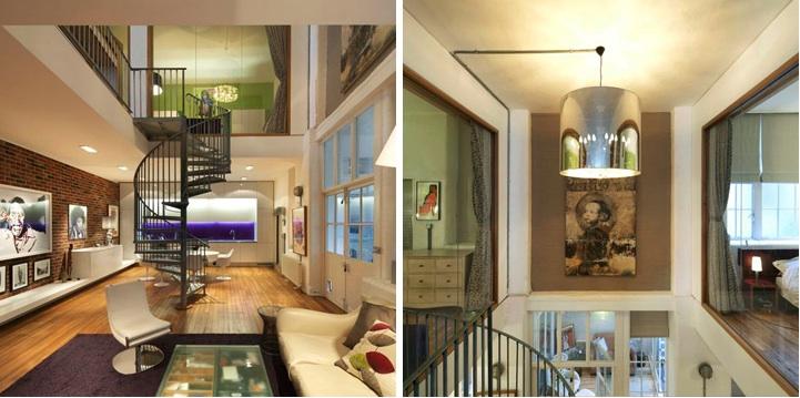

jack Posted August 26, 2018 Posted August 26, 2018 We have a full width window between our bedroom and the double height space above our kitchen/diner. It was inspired by pics we saw of Trevor Nelson's house a few years back: I think the idea can be very interesting if handled well. 3

jack Posted August 27, 2018 Posted August 27, 2018 On 26/08/2018 at 21:39, Dreadnaught said: @jack, wow, spectacular! Expand Just to be clear, that's Trevor Nelson's house, not mine!
Dreadnaught Posted August 27, 2018 Author Posted August 27, 2018 On 27/08/2018 at 13:30, jack said: Just to be clear, that's Trevor Nelson's house, not mine! Expand I did wonder. I suspect yours is even more colourful! ?
jack Posted August 27, 2018 Posted August 27, 2018 Way less, actually. We haven't done much furnishing, and even when we do I suspect it'll be a bit quieter than his place. I really, really like it though. 1

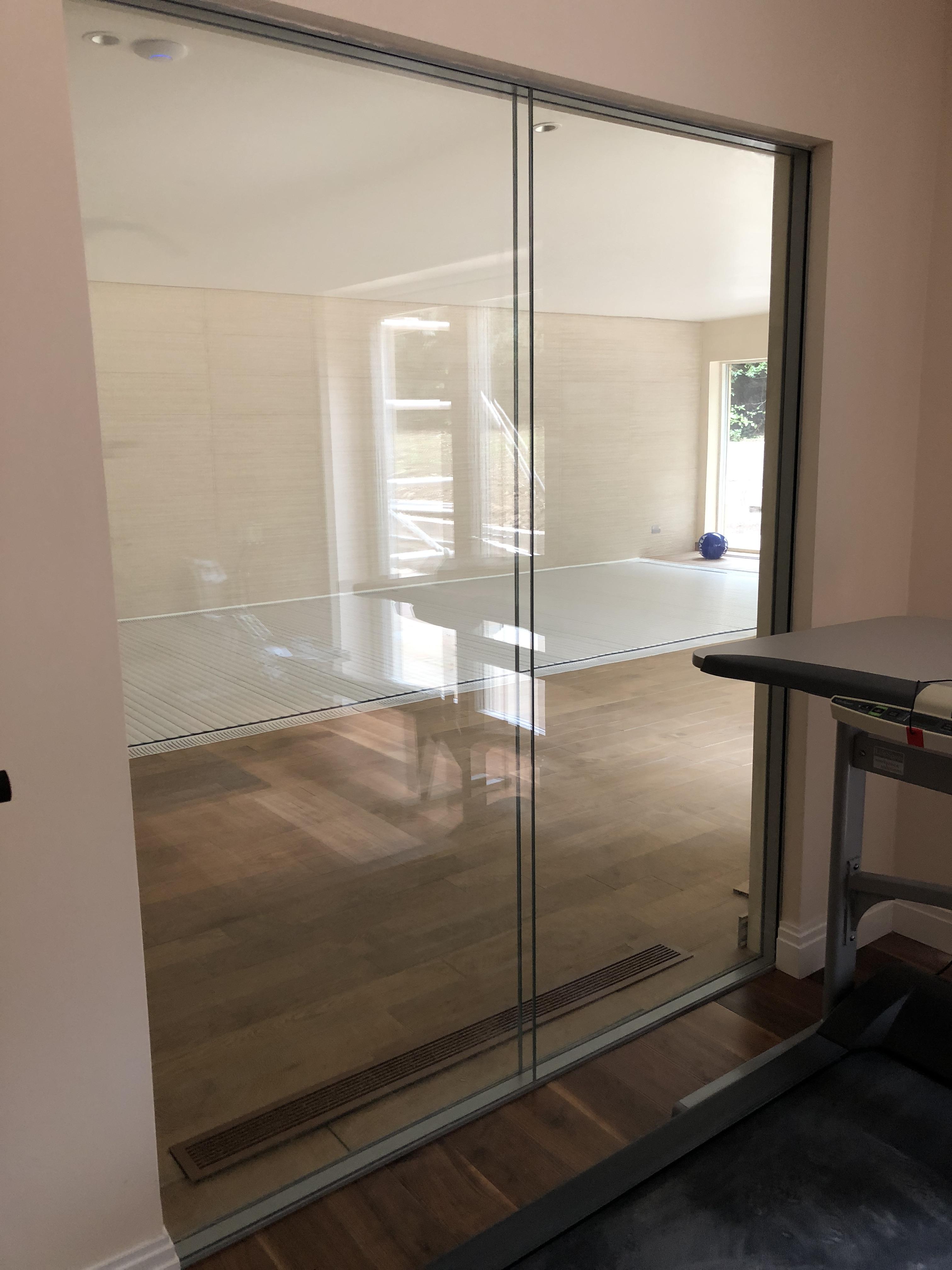

AliG Posted September 2, 2018 Posted September 2, 2018 We have a glazed wall between the pool and the gym. I am not sure that this applies in England, but in Scotland it had to meet the requirement for walls between rooms to cut sound by at least 40dB. It is roughly 2.3x2m, we were quoted some insane prices to get the acoustic qualities, I think the highest quote was £4000. Eventually we got a place to do it, the quote said a single unit, what it didn't say was that in their small print if the glass is over 1.2m wide then it will be more than one pane even though it is a single unit. So £2000 and not what we wanted or specified. There is some argument about who is at fault for this, it seems ridiculous to put this in your T&Cs not the actual quote. It is 2 layers of 11.5mm laminated glass. It does provide fantastic sound insulation, much better than a stud wall. Anyway, my wife wants it taken out and replaced with a single unit, all the people who do glazed screens said they cannot supply it, then I realised that our hall windows are almost the same size. We have contacted Rationel and they say that they can provide a double glazed window with 40dB of sound reduction, I think they can go up to 42-43dB in triple glazing. I reckon this will be about £1000-1500. We had reservations about using an outside window as the frame wouldn't look right which is why we contacted people who do glass screens, however, we are now looking either into hiding the frame in the wall or getting the cheapest frame and then taking the double glazed unit out and putting it into a channel in the wall.

AliG Posted September 2, 2018 Posted September 2, 2018 I checked the building regs for England and Scotland and the 40dB reduction only applies if the room can be used for sleeping, our gym could be classed as a bedroom. The regs also do not apply between an en suite and a bedroom and in England a wall which also has a door in it. 1

Mr Punter Posted September 2, 2018 Posted September 2, 2018 On 02/09/2018 at 10:45, AliG said: I checked the building regs for England and Scotland and the 40dB reduction only applies if the room can be used for sleeping, our gym could be classed as a bedroom. Expand As you just have a pool and a gym you would not need to consider acoustic issues. Although the gym could, in future, be used as a bedroom, it looks unlikely and the regs only take account of the current usage. An example is that you will need a heat detector in a kitchen, but if it were to become a lounge or bedroom you may need a smoke detector.
