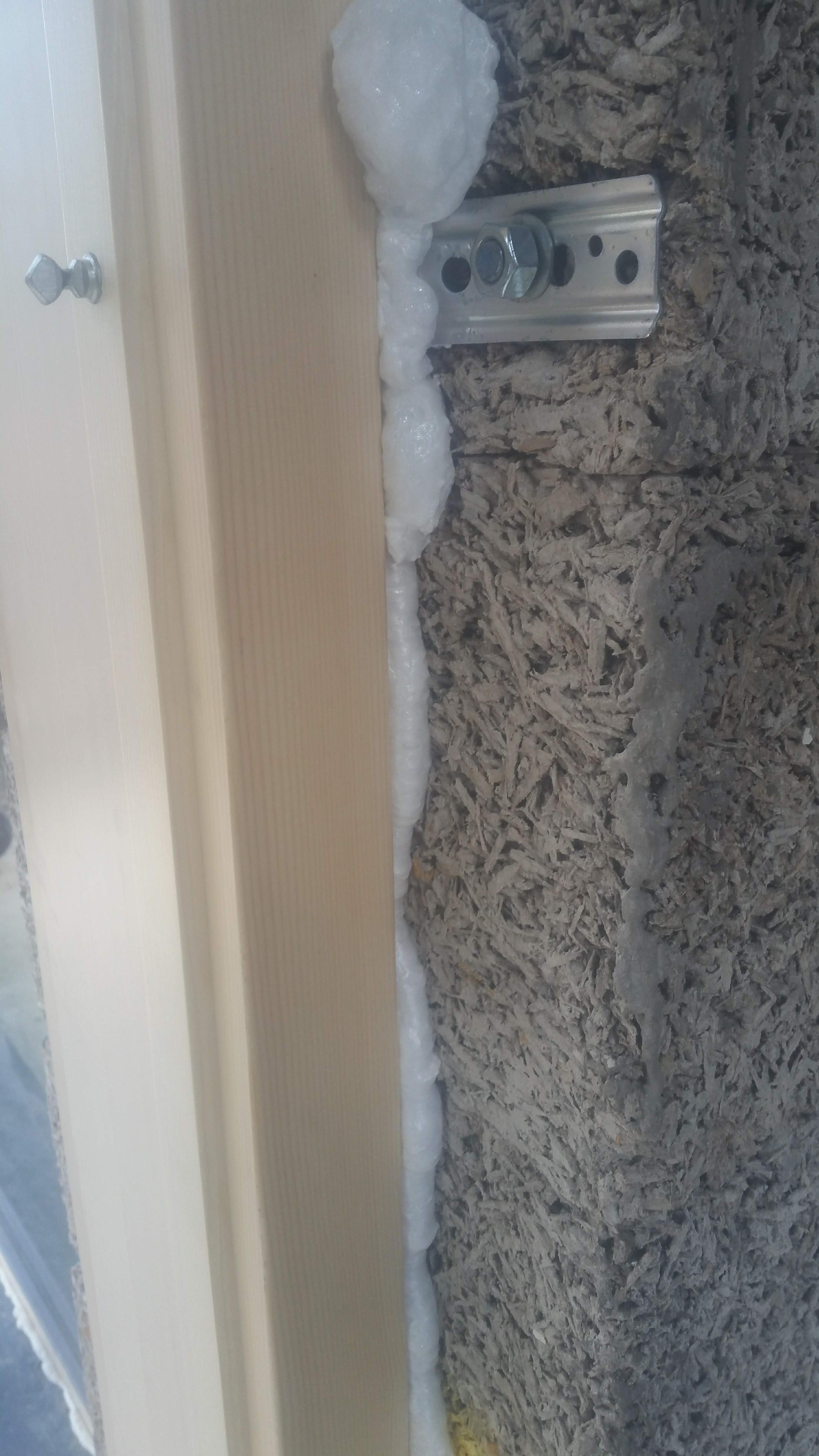

ToughButterCup Posted August 25, 2018 Posted August 25, 2018 Our window fitters left the site without having fitted the Compriband sealing tape. Today they returned to fettle our door (sticky lock mechanism) and , so I thought, to fit the Compriband. They explained that the Durisol surface was too rough for the Compriband to adhere to - and would therefore not act as an efficient seal; so they hadn't fitted it. The day they were fitted, nobody said anything to me about it. This YT video makes me wonder whether the information I have been given this morning is quite as comprehensive as one should expect. Here's a representative example for how the job has been finished ..... The Durisol is indeed rough. The senior fitter says that we need to make sure that the reveal is a lot smoother before the Compriband will adhere to it. Presumably all I need to do is lay on a smoothe parge coat on the window reveal - or is there another easier quicker way of doing it? Clearly, I need to trim back the expanded foam before I coat the reveal with something. Another instance where simple communication has failed. it would have been easier if they had told me either at the pre-fitting meeting or on the days that the windows were fitted or during the week I have waited for them to return - and I should have asked why the Compriband was not being fitted. That said I'm super-pleased with the windows and doors themselves: Gaulhofer. There's just one niggle. It'll be sooooo easy to lock ourselves out. The doors lock automatically when shut.
dpmiller Posted August 25, 2018 Posted August 25, 2018 if the window is foamed in where are you putting the Compriband anyway?
Onoff Posted August 25, 2018 Posted August 25, 2018 Sounds b@llocks to me. I'd insist Compriband is fitted however rough the Durisol is. It'll stick to the window & take up the bulk of the gap and you can foam the edges if necessary afterwards. I've used both on two successive retrofit DG windows (foam on the first, Compriband on the secoond) and the Compriband is far superior to foam imo.
ProDave Posted August 25, 2018 Posted August 25, 2018 Am I missing something simple? You STICK the compriband to the smooth window side of the gap, and it then expands to conform to the rough durisol side of the gap. What was so difficult they could not do that? TIP. It is a lot easier to fit comriband in cold weather, it only expands slowly when cold so you have a lot more time to get it right. In hot weather it expands quite fast.

ToughButterCup Posted August 25, 2018 Author Posted August 25, 2018 10 minutes ago, ProDave said: Am I missing something simple? [...] I have been given (bought with the windows order) two types of Compriband. Wide and narrow. The narrow stuff fits in the gap between the window and the wall, like this, I think. The wide stuff sticks on the side of the window and the wider section of the tape, sticks to the wall. 7 minutes ago, Onoff said: I reckon they just can't be ar$ed using Compriband.[...] In which case I can't be arsed to pay. 13 minutes ago, Construction Channel said: Are you sure it’s not a split latch? E.g the handle outside [...] There is no outside handle: just a key hole. 49 minutes ago, dpmiller said: if the window is foamed in where are you putting the Compriband anyway? Because the company said it is what they require. In which case, the fitters should fit it no?

Mr Punter Posted August 27, 2018 Posted August 27, 2018 I have used Compriband as an external seal between the frame and the finished external fabric. It is fine with brick and stone but if you are going to render, the render needs to be applied into the reveal before the window is installed. It does not look as if you have enough room for render and Compriband.
ToughButterCup Posted August 27, 2018 Author Posted August 27, 2018 6 minutes ago, Mr Punter said: [...] It does not look as if you have enough room for render and Compriband. Aaaarghhhhh. I know, what does Gary think? @nod, are you around? How do I dig myself out of this hole? Simply put, the Dursiol hasn't been ' sealed' before the windows went in. So the Compriband wasn't fitted. Is there any way of sealing the reveal such that the Compriband can be fitted? Come on Gary, show us what'cha got......
nod Posted August 27, 2018 Posted August 27, 2018 I That tgat boats gone Ian Ifealy it would have had a tight coat of render Pretty much like the Parge coating you have been doing The best tgat you can do now is to seal it up with silicone and give the reveals a coat of 3 -1 waterproofed render prior to plastering
Mr Punter Posted August 27, 2018 Posted August 27, 2018 For they type of window you have you will be able to render up to the frame externally and plaster internally. You could also run a bead of sealant round. I cannot see the need for Compriband.
