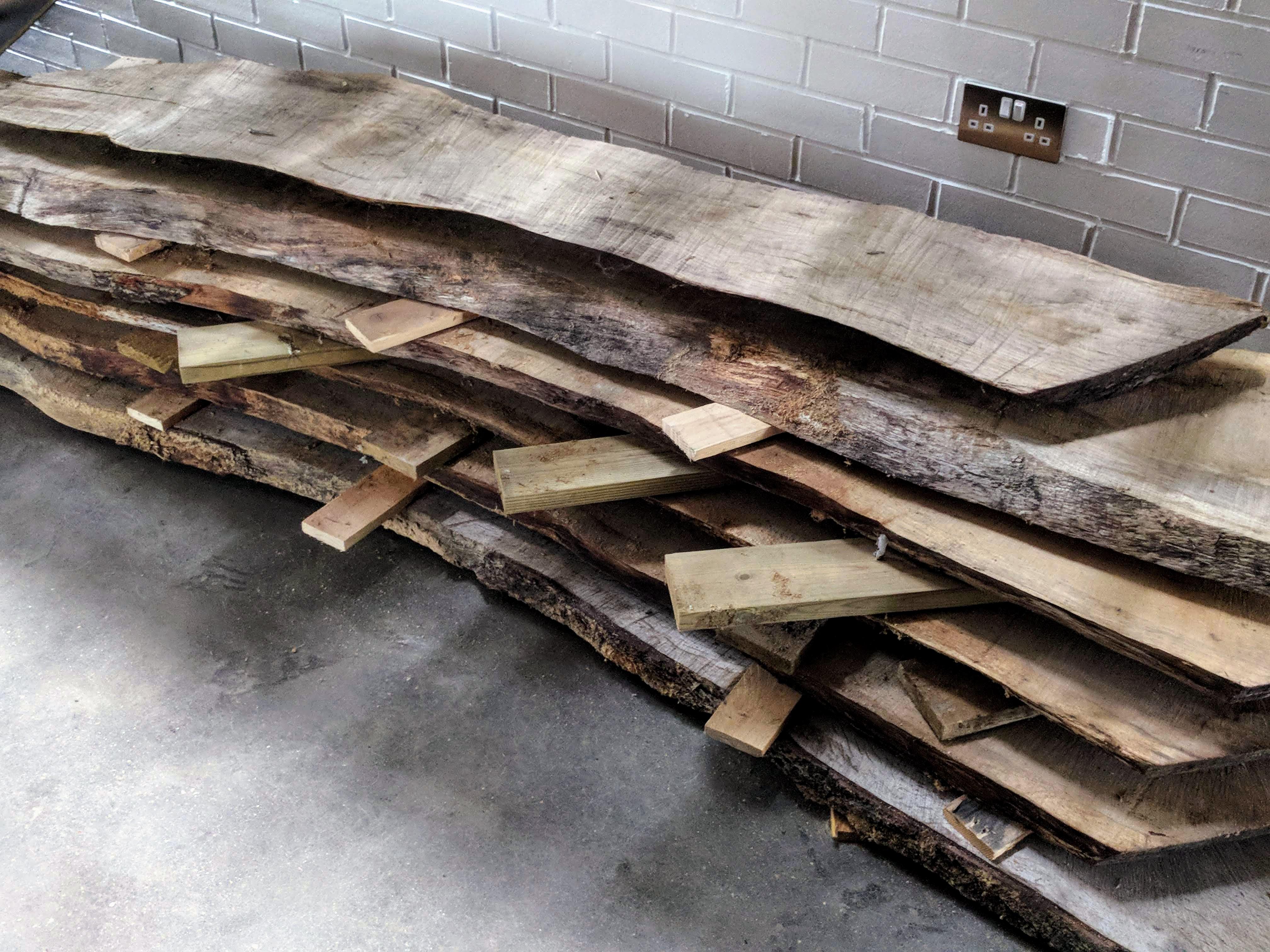

jack Posted August 19, 2018 Posted August 19, 2018 A couple of years ago, we planked part of an oak tree that we took down before we built. The aim is to make a table something like this (but without the live edge): http://livingwood.sk/solid-wood-furniture-tables-table-with-steel-legs-s-8 The three largest planks will give us 2 x 350mm and 1 x 300mm wide planks once squared off, which gives us the ~1m width we're after. The log we planked had already been lying there for a couple of years when we planked it, and it's been stacked drying in our garage since then. Naturally, the planks have warped quite a bit while drying out. This is them in our hall after we brought them inside last week: The planks we're thinking of using are all 50-60mm thick. So the questions are: Given this is seasoned oak, what chance do I realistically have of flattening it out using a hand plane (I have a sharp Record 5 1/2) and cheap electric planer? Failing that, who would you approach about getting the planks flattened? I think I'm after a thicknesser planer, but what sorts of outfits would offer this sort of service to the public? Sawmills? Joiners? Re: the legs, we've had some quotes back from various places and they're pretty eye-watering for what's effectively some bent lengths of steel. Is it realistic to expect to be able to do this myself? If so, ideas on how to approach? I assuming heating the bend points would be helpful, but I really haven't a clue about how to approach something like this! Thanks as always.

Jeremy Harris Posted August 19, 2018 Posted August 19, 2018 Definitely a job for a planer thicknesser. A decent sized one with carbide tipped blades would bring all those planks to a consistent thickness pretty quickly and take out any twists/bends that are less than the thickness you want to end up with. It's not a big job, maybe an hour or so tops for someone with the right machine, and the key to getting decent planks out of it will be using a pretty hefty industrial size machine. The saw mill near us would do this while you wait, but it's a bit far from you. Have a hunt around and see if you can find a good local saw mill that has a big planer thicknesser and ask them what they'd charge. I reckon it would be worth getting them done properly, as I don't think you have a hope in hell of getting those boards flat and even with a hand held electric plane, TBH. 1 1

ToughButterCup Posted August 19, 2018 Posted August 19, 2018 1 hour ago, jack said: [...] Given this is seasoned oak, what chance do I realistically have of flattening it out using a hand plane (I have a sharp Record 5 1/2) and cheap electric planer? [...] Zero. But please can I watch you try? 1 1

MikeSharp01 Posted August 19, 2018 Posted August 19, 2018 Don't want to rain on your parade but you may need to take advice from a pro because, IIRC my timber technology from way back, your thickness is going to take more than a few years to season fully and when you plane it you will get down to less seasoned wood which may warp again. There is a real art to seasoning long length hardwoods for cabinet making - long time / very slowly as near the finished thickness as possible and absolutely flat. I have friends who do it and 5 years is nothing to them. You could sell your planks and buy 295mm wide by 20mm oak planks ready for cabinet making, not the same as grow your own I agree, from HERE (where I get mine) but there must be someone closer to you. Another way to go would be to use your planks cross wise on the table that way any warping will be less pronounced. Alternatively go for a more rustic look, maybe with gaps between the planks which can accommodate any warping. 1
jack Posted August 19, 2018 Author Posted August 19, 2018 Interesting stuff, thanks Mike. I wouldn't want to pass these on and buy replacements. One of the main aims here is to have the tabletop come from the same site as the house, and to get some meaningful use out of a tree that we felt bad about cutting down (it was in poor nick, but still...). Given it's been around 4 years since the tree was cut down, and 2.5 years since it was planked, I'm willing to take the risk. I can live with a bit of movement after it's made. I'm not interested in a billiard table smooth finish on the top, either.
Jeremy Harris Posted August 19, 2018 Posted August 19, 2018 The saw mill chap was talking to me about this a few weeks ago. For air-dried oak their rule of thumb is one year per inch plus one year, so a 1 inch thick board would take 2 years, a 2 inch thick board three years, etc. That's for rough sawn boards stacked up in their yard outside to season. 1
jack Posted August 19, 2018 Author Posted August 19, 2018 Sounds like we're order of magnitude in the right region, thanks Jeremy. I'd rather not wait another year - our current table is falling apart!

Simplysimon Posted August 19, 2018 Posted August 19, 2018 2 hours ago, Declan52 said: Could you overboard your current table. Use big bolts countersunk into it to pull the warp in. You could even heat treat the bolts to make them appear older. Change the legs to metal/oak and you have a new table. bolts are not going to pull the twist out of seasoned oak at that width. @jack how badly twisted are the boards? as when you flatten them prior to thicknessing them they are going to be a good bit thinner. if not fully seasoned they will then twist again as previously stated

Temp Posted August 19, 2018 Posted August 19, 2018 I've done some work with green and fully seasoned oak. How bad is the twisting? I agree it would certainly be a lot easier to find someone to put it through a planer/thicknesser. However I think if the twisting wasn't too bad, and you can live with it being a bit rustic, I reckon you could get away with an electric plane and a bunch of spare blades. If DIY would be inclined to just plane the top surface of each plank. I would use packing between the un-planed side and steel frame or a carefully profiled cross member. Never leave anything made of steel (like the plane or other tools) on the oak even for a short time. When you get back from lunch and pick it up there will be a black mark on the oak and more
