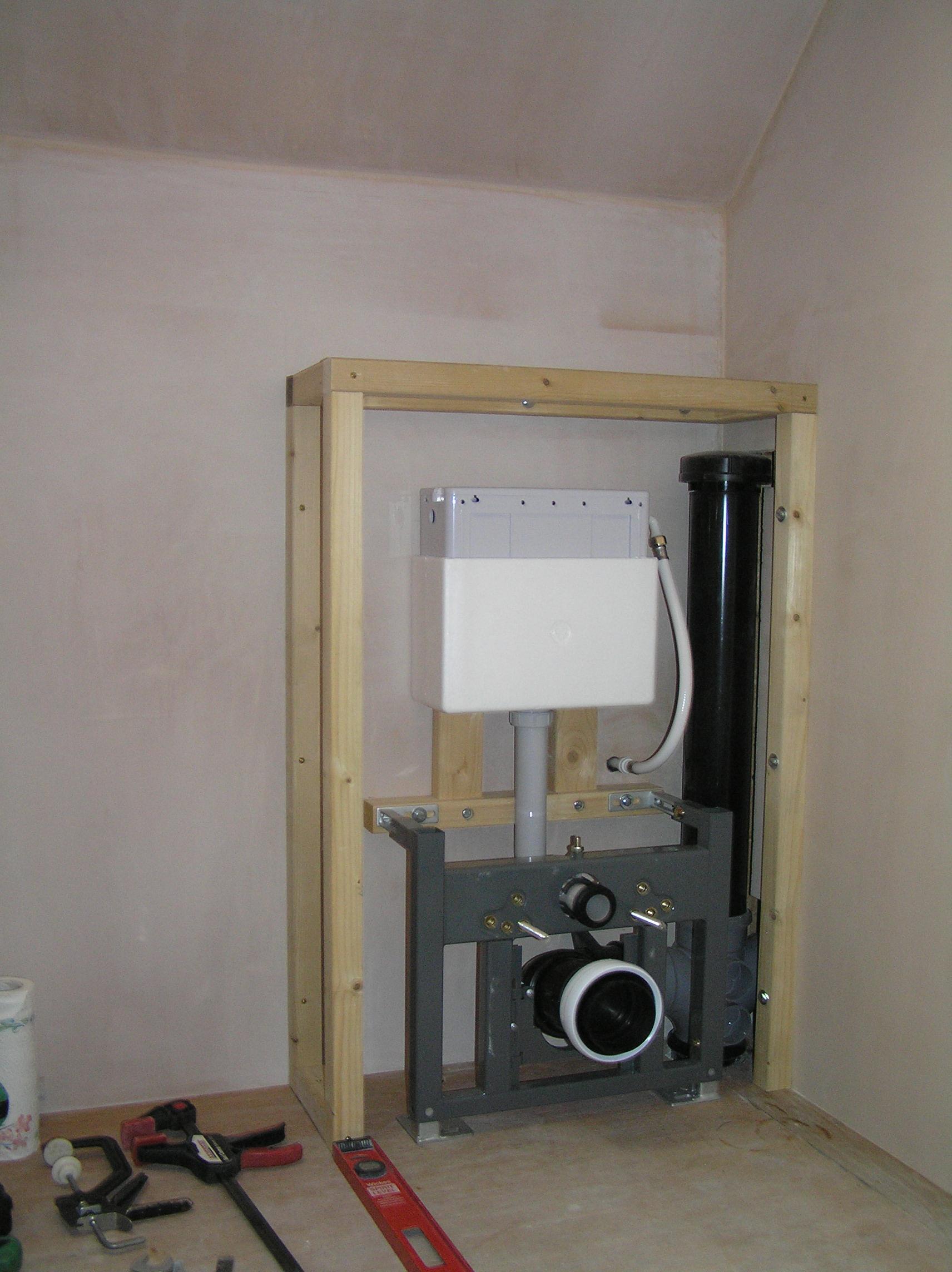

Gone West Posted August 16, 2018 Share Posted August 16, 2018 12 hours ago, JSHarris said: As a bit of additional info, I believe that @PeterStarck may have a low level external vent, and as his build is also a PassivHaus, he may well be able to confirm that external vents are acceptable when used i conjunction with an AAV on top of an internal soil stack. That is correct. I have the main, 110mm, AAV in the bathroom behind a false wall which houses the concealed cistern. I also have an external vent around 600mm high in a flower bed near the sewage treatment plant. The BCO didn't have any problems with the setup. Link to comment Share on other sites More sharing options...
dnoble Posted August 16, 2018 Author Share Posted August 16, 2018 Thanks for all this useful information. That's a good solution, Peter, so there's no particular reason the AAV needs to be up in the loft space, it just be hidden behind a false wall (but obviously above soil pipe level), then? Link to comment Share on other sites More sharing options...

Gone West Posted August 16, 2018 Share Posted August 16, 2018 6 hours ago, dnoble said: That's a good solution, Peter, so there's no particular reason the AAV needs to be up in the loft space, it just be hidden behind a false wall (but obviously above soil pipe level), then? The AAV should be above the highest drain point such as basin plug hole. Link to comment Share on other sites More sharing options...
