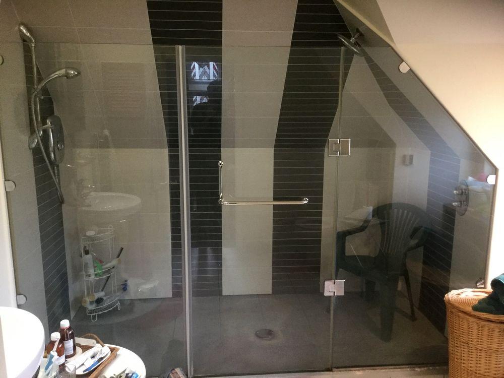

Ferdinand Posted August 8, 2018 Posted August 8, 2018 (edited) This is mine in the posh bathroom. Front to back is 1.1m. End to end is 2.6m. The screen is 1.8m high. Installed by the former owner. This is 8mo overkill. My plan is to shrink it a little by installing a bath on the left end on. You could play tennis in this. Edited August 8, 2018 by Ferdinand

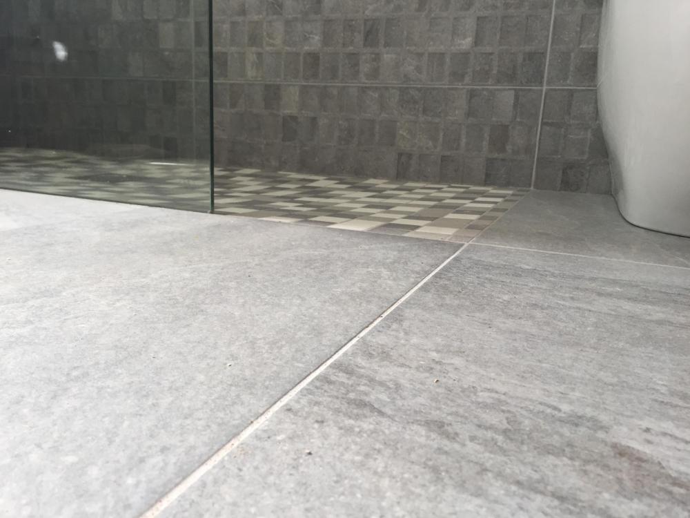

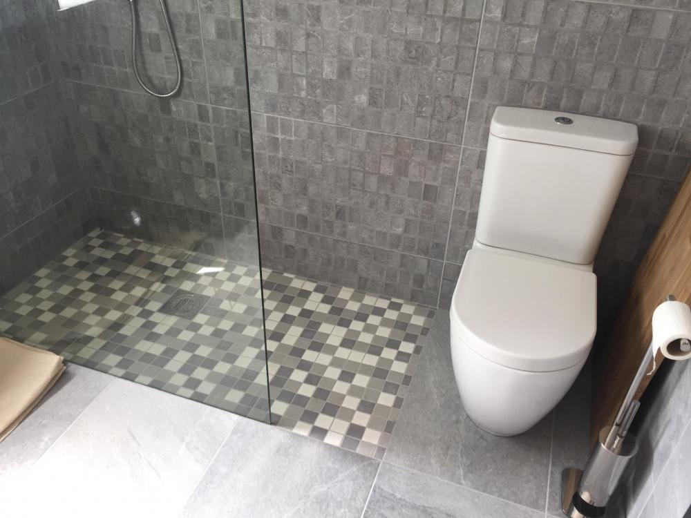

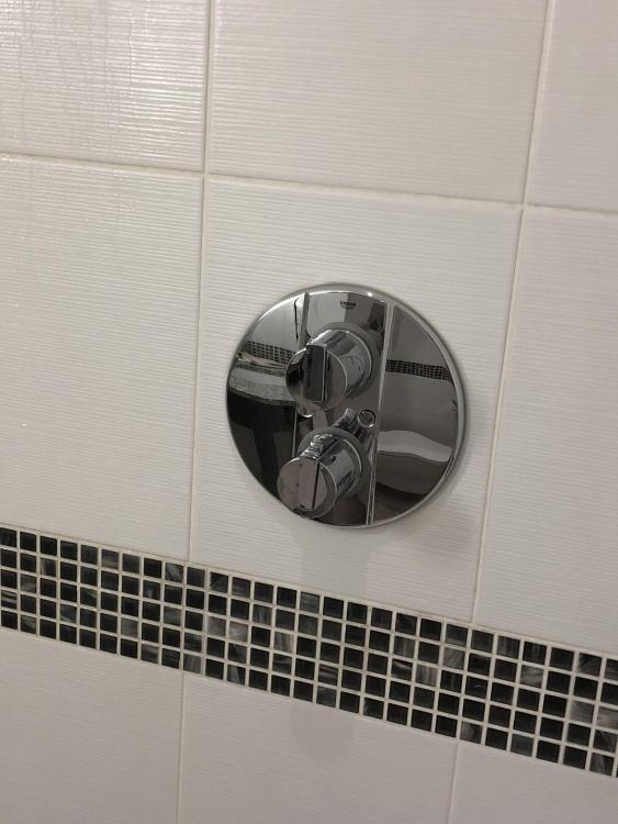

Nickfromwales Posted August 9, 2018 Posted August 9, 2018 1200mm is the smallest screen you can go for if you have a true wet 'open' area afaic. The ones I'm doing now ( 2 wet rooms same house ) are 1500x740mm ( window called the width ) with a 1200mm glass, open-ednded, and the upstairs will be 1850x850mm again with a 1200mm screen open-ended ( even though I told them to take it back and get a 1400mm to no avail. The 1500mm long downstairs former is mosaic tiled beyond the glass screen but is still part of the sloped floor. Ill take a pic later and that'll explain in seconds. I've set the mixers out away from the shower heads, as frequently mentioned here, and it goes down a treat with the punters.
Onoff Posted August 9, 2018 Posted August 9, 2018 14 minutes ago, Nickfromwales said: I've set the mixers out away from the shower heads, as frequently mentioned here, and it goes down a treat with the punters. A lot of people have copied that idea...
Jeremy Harris Posted August 9, 2018 Posted August 9, 2018 16 minutes ago, Onoff said: A lot of people have copied that idea... I first did it 8 years ago, when refurbishing the bathroom in our old house, as it seemed daft to have to get your arm wet when turning on the shower to warm up. I adopted the same system in the new house, of having the mixer at the opposite end to the shower head, because it worked so well at the old house. I've never understood why it isn't the standard way to install a shower - seems daft to position the mixer where you have to get a wet arm in order to turn the thing on.
