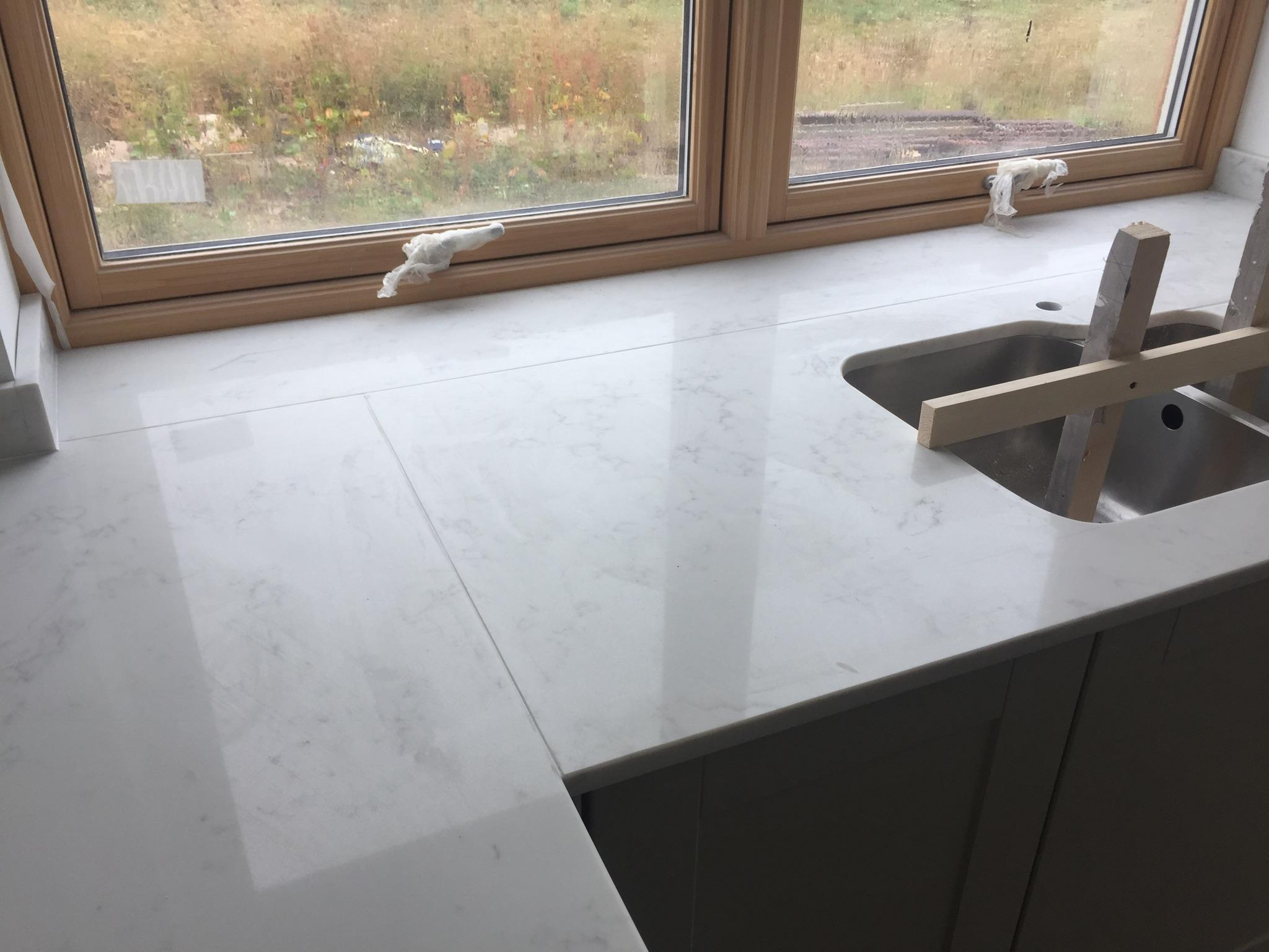

Triple07 Posted July 29, 2018 Share Posted July 29, 2018 (edited) So yesterday we had our worktops fitted, 1st issue is we have a rather long joint in the worktop in a window sill that we were told would be from one slab so that we didn’t have a joint , we then knew we would have 2 joins each side where it would meet the rest of the worktop (U shaped kitchen) and we were told that the join would be smooth to touch, that no join was invisible, but it would only be visible if you look close. Obviously with quartz/ silestone we knew it couldn’t be seemless. 2nd issue is they cut the hob out too small despite it being there, easily rectified though. but our main issue is the type of joins, I just want to know if this is acceptable. It looks horrendous to me, almost like it’s been tiled, the joints are “grouted” with a thin silicon layer to seal. Help! Edited July 29, 2018 by Triple07 Closer image 1 Link to comment Share on other sites More sharing options...
Triple07 Posted July 29, 2018 Author Share Posted July 29, 2018 Oh and the drainer groves are on the wrong side from what was specified, meaning the tap is not central to window which will REALLY bug me! Link to comment Share on other sites More sharing options...
Nickfromwales Posted July 29, 2018 Share Posted July 29, 2018 Sounds like a proper FUp. Whats written down and signed for re the drainer ? Link to comment Share on other sites More sharing options...
Triple07 Posted July 29, 2018 Author Share Posted July 29, 2018 Nothing was written down or signed....yeah hindsight is a wonderful thing. 1 Link to comment Share on other sites More sharing options...

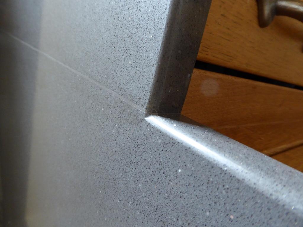

Jeremy Harris Posted July 29, 2018 Share Posted July 29, 2018 We have 20mm Silestone and the joints were made flush as possible, with a colour matched epoxy adhesive and then buffed down and polished when cured. I can take some photos either tomorrow or Tuesday that show the way our joins look, but I'd have to say you can't easily spot them without looking closely. Link to comment Share on other sites More sharing options...
Declan52 Posted July 29, 2018 Share Posted July 29, 2018 Being right under the window doesn't help hide the joint. The light will always catch the sides and make it more visible. Link to comment Share on other sites More sharing options...

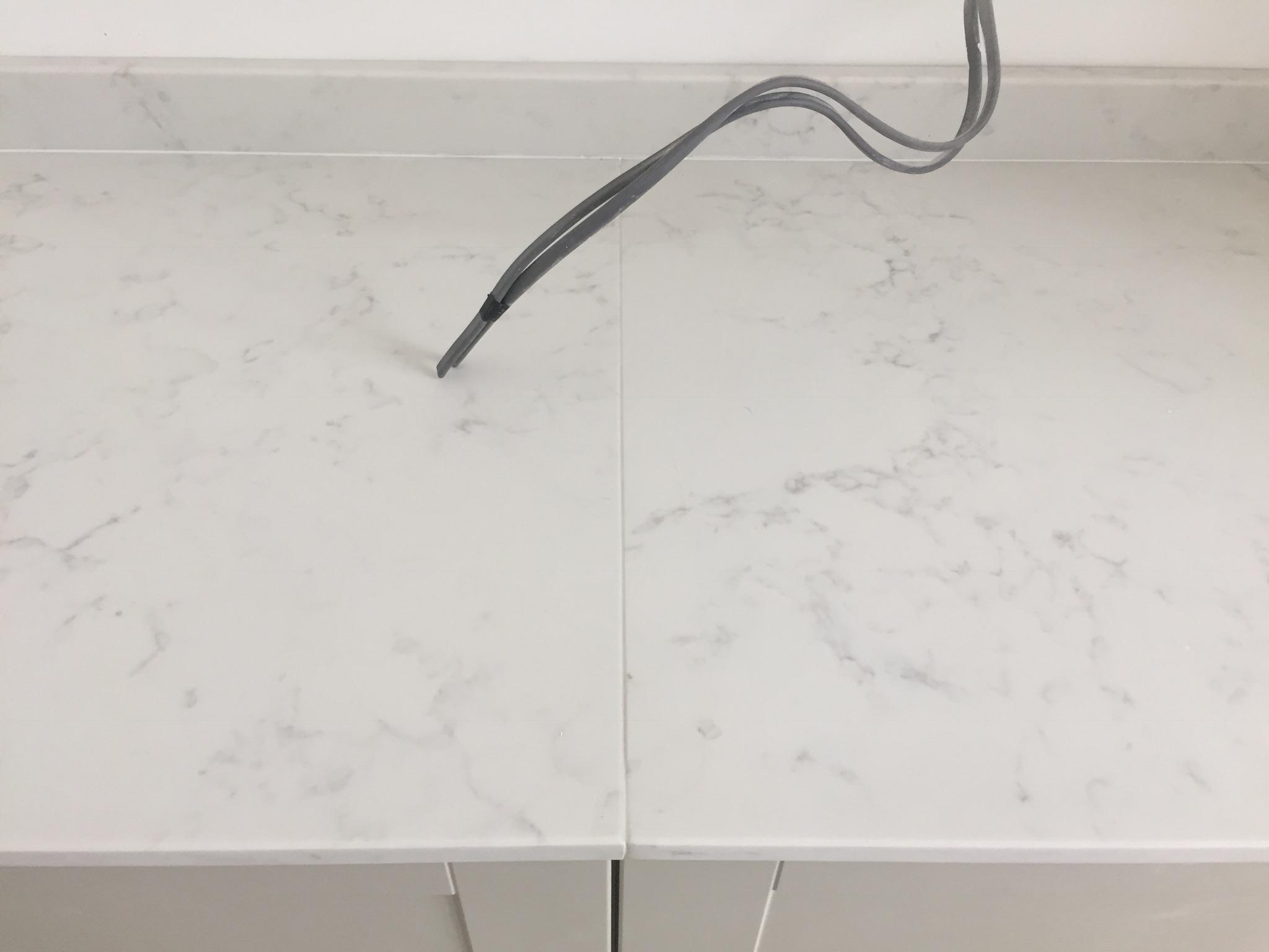

Triple07 Posted July 29, 2018 Author Share Posted July 29, 2018 So far I have paid £2k deposit (via bank transfer ? ffs what an idiot) meant to pay a further £3k on completion. I have emailed them but as yet no reply, it is Sunday though. The close up photo of the join isn’t the one under the window, that’s one further down the run of units, and every bit as visible. the slabs they used were bevelled, even on the join so they were never gonna get a clean seam, shoddy finish. @JSHarris photos would be much appreciated, I am currently moaning to a family member that thinks I am simply being “precious” Link to comment Share on other sites More sharing options...
lizzie Posted July 29, 2018 Share Posted July 29, 2018 @Triple07 looks like a poor job from your photos. I would not pay the balance pending resolution. Not sure what can be done now its in situ. If they fill it in some way it may not last. Link to comment Share on other sites More sharing options...

Nickfromwales Posted July 29, 2018 Share Posted July 29, 2018 4 hours ago, PeterW said: Ask the family member to pay the balance then ...... let’s see how long they moan for then ..! The bevel is there to take the epoxy joint compound - they should have epoxied them together then made it proud, polishing it back to a flat surface. They should be able to un-install it, and re-do the joints properly. No smiles, no more cash. Tell them to come and take them out if they want to get funny. Tell them if you cant see the joints then maybe the non mono section may be liveable. Lets see what they come back with first eh Link to comment Share on other sites More sharing options...
cherryfountain Posted July 30, 2018 Share Posted July 30, 2018 This looks a totally unprofessional job and I would refuse to pay any more money until it is sorted out. Quartz worktop blanks are up to 3050x900to1400 deep why so many joints? Was the job properly templated as all details of tap position, drainer grooves,cutouts,sink position,polished edges, joint positions are all clearly written on the templates all to be confirmed by the customer before being fabricated. Where there are joints they should be barely visible when bonded with the proper matching epoxy adhesive .If you look on YouTube there are videos on how a joint should look. Link to comment Share on other sites More sharing options...
ryder72 Posted July 30, 2018 Share Posted July 30, 2018 Thats a bodge. Period. The joins should be better than that and the front edges at the join should alight. The worktop overhang should be consistent across the kitchen (provided the kitchen is well fitted). Link to comment Share on other sites More sharing options...
