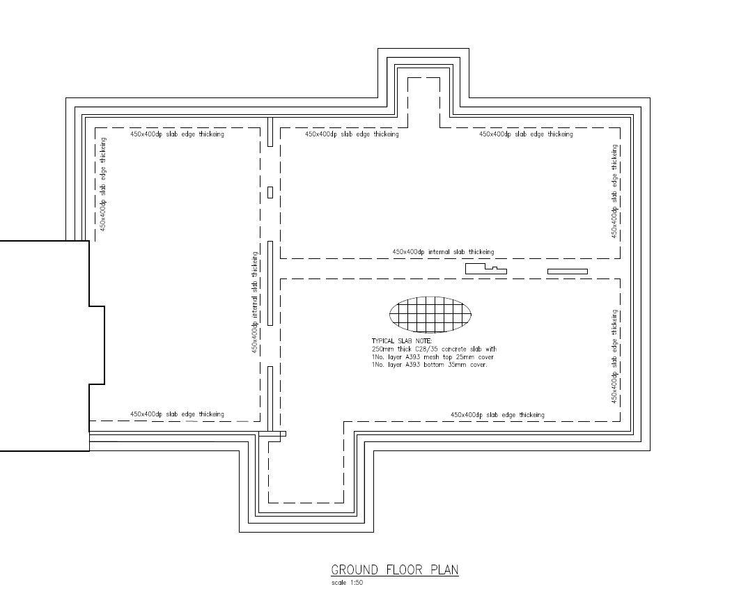

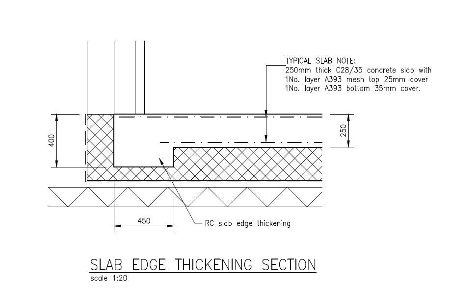

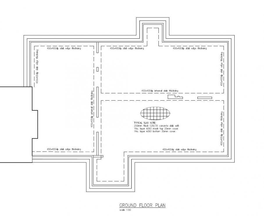

willbish Posted July 22, 2018 Posted July 22, 2018 For those with an insulated raft foundation, what was your ground bearing capacity figure? And was your raft designed with extra thickening? My SE had made noises that my ground bearing figure of 50kN/M2 is a bit low but workable. His latest design of the raft has 25% of the area thickened to 400mm and in these areas insulation reduced from 300mm to 150mm. This feels like a big step down in thermal performance to me, but perhaps I shouldn't be so concerned. During the ground investigation I was told that I had ideal ground for a raft so not sure how a 50kN/M2 figure has been derived. I've asked the GI chap if he could revisit his Standard Penetration test results with hope to increasing the ground bearing figure; no response yet. I also feel the SE is being over cautious; he has the slab edge thickened where a single story porch will be. That seems really unnecessary. 1

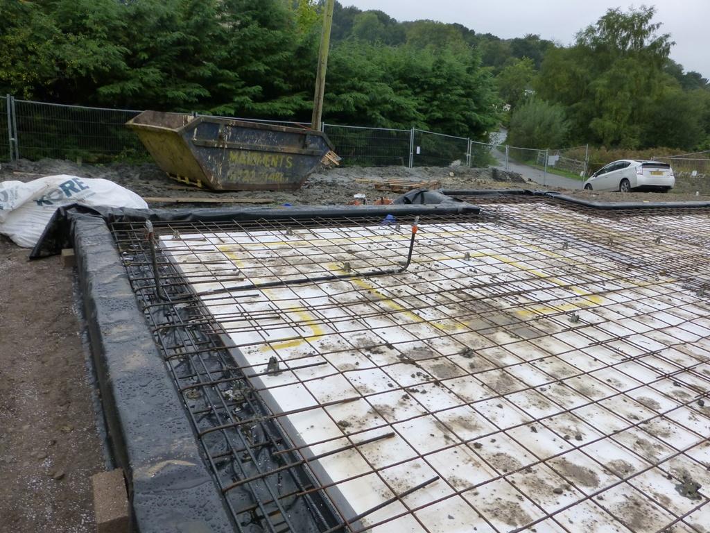

Jeremy Harris Posted July 22, 2018 Posted July 22, 2018 Our slab has 300mm of EPS under most of it, a 400mm high x 200mm wide upstand around the edges and the edge ring beam is 200mm x 200mm. The slab is 100mm thick across most of the area. There's a layer of steel fabric in the centre of the 100mm deep section and four tied rebars running around the 200mm x 200mm outer edge ring beam. Soil max allowable bearing load is way over 100 kN/m², so didn't I bother measuring it accurately (simple 2 x 2 test with a lump hammer confirmed it was way over 100 kN/m²). House actual bearing load on the soil beneath, allowing for 45 deg outward load spreading from 150mm deep packed crushed stone bedding, works out to be just over 4 kN/m². In other words, the reserve between the minimum possible allowable soil bearing load of 100 kN/m² and the actual house and foundation applied bearing load is a factor of around 25, which is extremely conservative, even for the typical ranges of reserve normally allowed in civil engineering. I'd question why you have such a massively thick slab. 250mm seem way OTT for the non-bearing load area to be. Our reinforced 100mm thick slab is plenty thick enough, with it's 200mm x 200mm reinforced ring beam. Here's a sketch showing a section through our house and slab (it's one drawn up as a part of my building regs submission): Structure - Detail for BC.pdf
PeterW Posted July 22, 2018 Posted July 22, 2018 35 minutes ago, JSHarris said: 250mm seem way OTT for the non-bearing load area to be. @willbish are you having UFH in that too as it’s going to be a serious heat sink if you are ! As @JSHarris has said, 250mm is thick and even if the SE is looking at uneven stress loading, putting 2 or 3 beams at 250mm with the remainder at 100mm would be ample - unless you’re building a car park ..??!

willbish Posted July 22, 2018 Author Posted July 22, 2018 Thanks @JSHarris your figures and dimensions are much more in the region of what I was expecting. I'm not too fussed about the 250mm slab thickness over non loading bearing areas, it is the common design with Isoquick. My understanding of the Isoquick system was the thicker 250mm slab throughout would compensate the need for a ring beam/ edge thickening therefore allowing 300mm insulation throughout. I have already asked the SE if anything could be done to reduce the slab thickening, his reply was no. I asked him what ground bearing he would need to scrap the slab thickening. His response 'somewhere in the region of 100kN/m2' Hence returning to the ground investigation chap. Just to add to the pressure, I've being told if I don’t approve the draft plans on Monday the SE will not be able to finalise next week before going on holiday for two weeks! @PeterW Yes to UFH. The SE has specified thickened strips as well much like @jack so the thickened area is now 25% of total slab area

Russell griffiths Posted July 22, 2018 Posted July 22, 2018 Can I add a non educated but common sense thought to this. My feelings are that adding thickness to the concrete does hardly anything without the correct reinforcement your drawing shows extra extra thickness of concrete but no additional reinforcement in that area, if you maintain the 250mm thickness all over but add extra reo in the ring beam area I’m convinced that would improve things over just thickening the concrete. I have been installing my ringbeam over piles this week and all the high load areas have 8x16mm bars and the low load ares only have 6 x16mm bars I questioned this and was told it was the beams that were carrying the floor load as well as the wall load that have the additional steel.

Triassic Posted July 23, 2018 Posted July 23, 2018 16 hours ago, Russell griffiths said: feelings are that adding thickness to the concrete does hardly anything without the correct reinforcement That was my initial thought when I saw your drawings, where’s the steel reinforcing in the ring beam?

MikeSharp01 Posted July 23, 2018 Posted July 23, 2018 I notice no reinforcement along the ring beam in your section drawing. I am no structural engineer but I would have thought this was a requirement probably both above and below the neutral axis. On 22/07/2018 at 09:00, willbish said: unnecessary. As you say without good reinforcement the concrete will need to be much greater volume. If it's an ISOQUIK design they must be carrying the structural risk if the thing fails.
Jeremy Harris Posted July 23, 2018 Posted July 23, 2018 IIRC, our ring beam had four rebars that were around 10mm to 12mm dia running around it, all set inside the 200mm x 200mm ring beam section. These were tied to the fabric running across the centre of the slab with loads of 10mm to 12mm diameter bent bars, as in the photo below (not all the steels are tied in yet in this photo - there's loads more wire tying to be done before the pour): 1

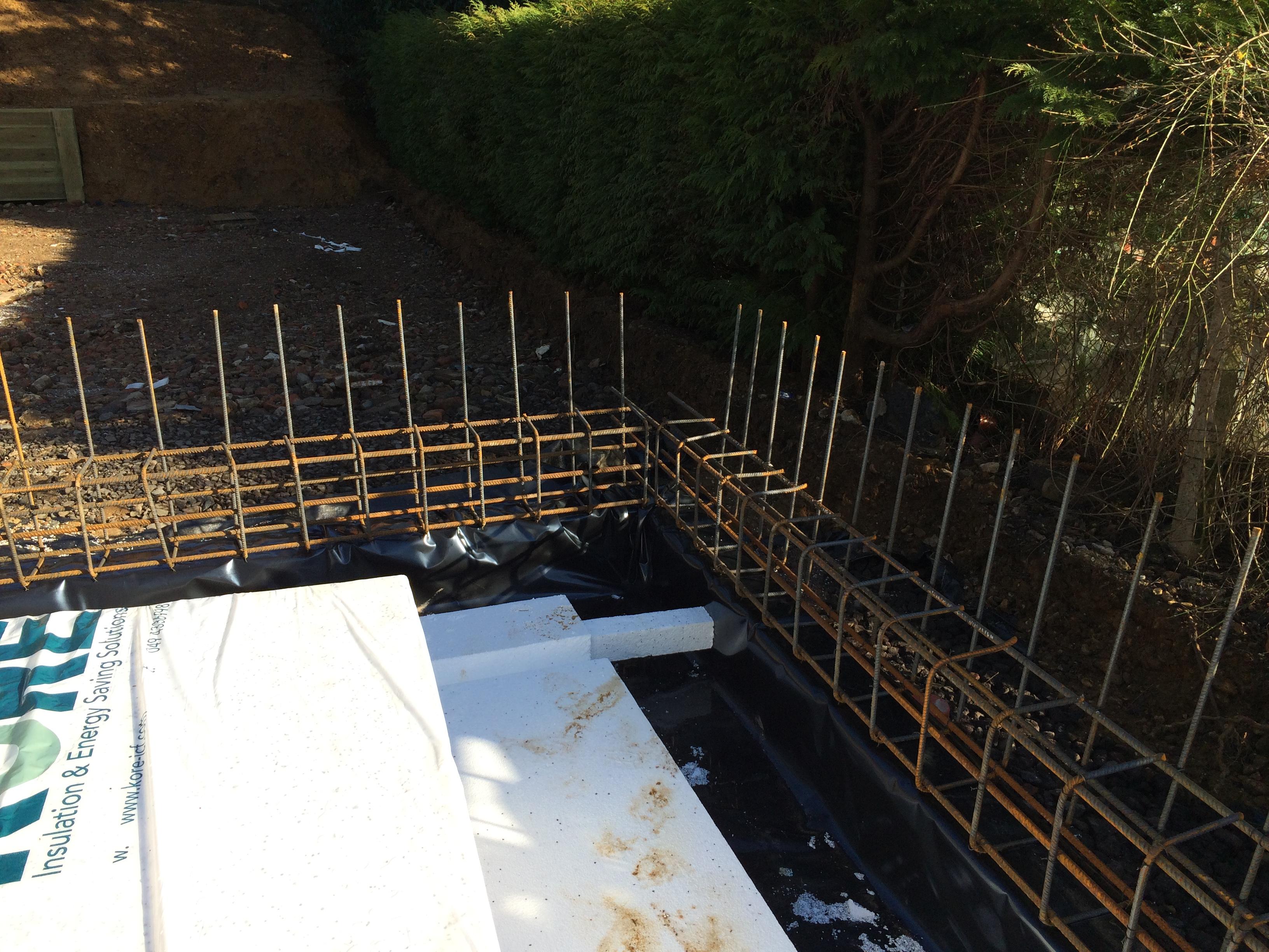

jack Posted July 23, 2018 Posted July 23, 2018 Our ringbeam reinforcement before being dropped into position: 1
willbish Posted July 23, 2018 Author Posted July 23, 2018 (edited) We have reached a workable solution today. No ring beam or slab thickening in any areas, which means I get 300mm of insulation under the whole slab. But as a compromise a 300mm slab throughout with, as yet unspecified but, 'significant' amount of reinforcement! What did @PeterW say about a serious heat sink! How much heat is this 30m3 slab going to hold ? The extra 50mm shouldn't affect my levels too much, everything so far has been buried deeper than necessary. I will have one run of 110mm storm pipe in the bottom 50mm of type1 layer however, assuming that can be left as is? Edited July 23, 2018 by willbish
