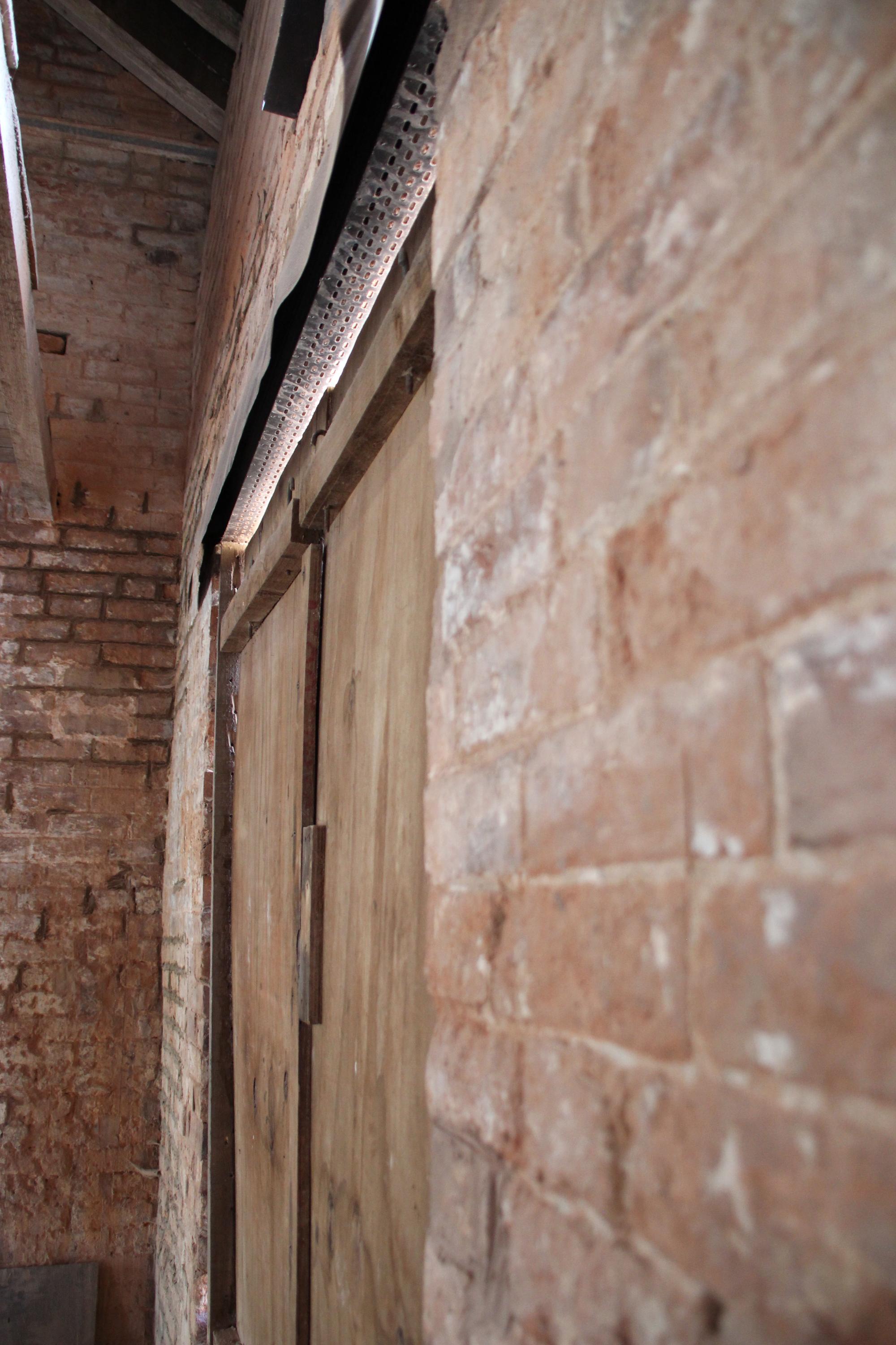

Digmixfill Posted July 3, 2018 Posted July 3, 2018 I've got to build inner leaf to create a 100mm cavity against existing 225mm brick outer walls. The existing walls are anything but straight which means that if i built the inner leaf true the cavity will change size quite a bit on some walls. The roof wall plates will be on the new leaf when it is replaced. My question is should i build the inner leaf straight and try to average out the cavity space or should i construct the new leaf to follow the undulations of the existing walls to maintain a 100mm cavity?

Digmixfill Posted July 3, 2018 Author Posted July 3, 2018 Thanks for the replies :) It's an old brick barn and the alterations it has had, roof failing and general movement over time have taken its toll. I've underpinned the entire building and extended the concrete inside to serve the new inner leaf. (My username is based on this joyful task) The leafs will be tied together with wall ties resin bonded into the existing brickwork. Insulation will be full fill. The worst measurement i have shows that one wall is > 100mm out of true at one end due to the wall bowing and twisting at the same time. Most are +/- 50mm at some point along them. If I changed to timber frame now I'd have to submit changes to the plans and whatnot. It's an option i suppose but i'd prefer the new inner leaf. 1
PeterW Posted July 3, 2018 Posted July 3, 2018 11 minutes ago, Digmixfill said: The leafs will be tied together with wall ties resin bonded into the existing brickwork. Insulation will be full fill. So pick the min 100mm and work from it. Some gaps will be bigger than 100mm but none will be smaller. Then get blown bead insulation installed - fills every cavity and you will have no gaps and a really decent level of insulation. The only plans you would need to change for TF would be for BRegs as planning doesn’t care what the inside looks like ... 2

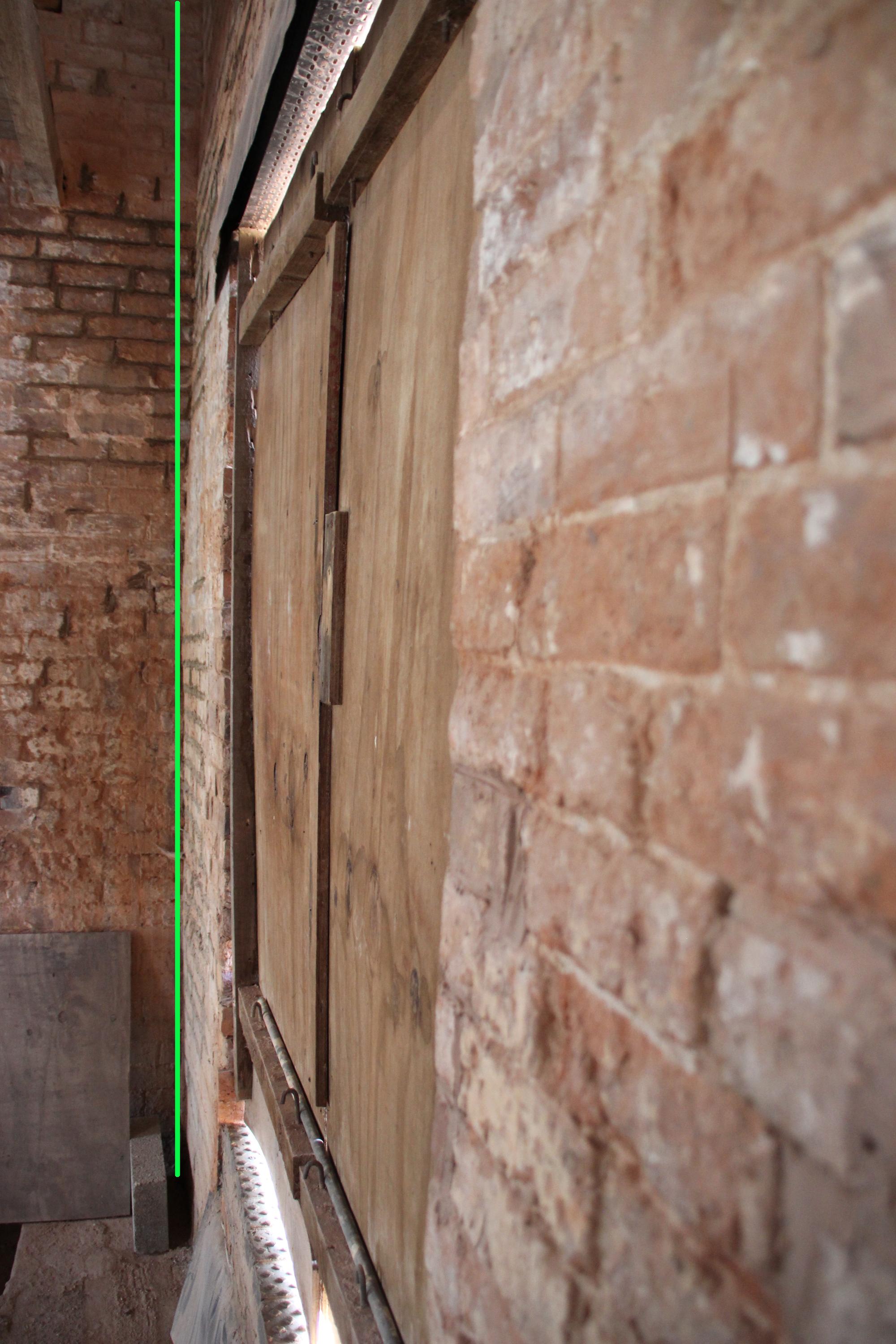

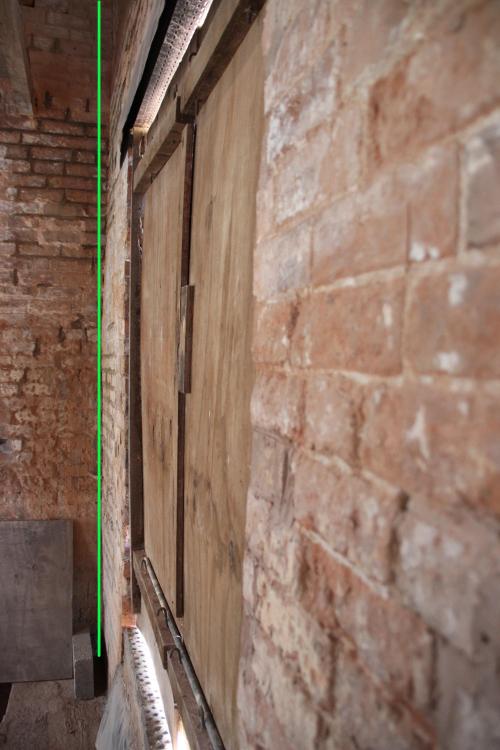

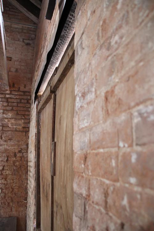

Tyke2 Posted September 6, 2018 Posted September 6, 2018 Hi Im probably too late to assist now! I had this same issue on my build. If you have to maintain the 100mm cavity then you need to pick out the most protruding "wonky" bit and use this as the datum for the internal blockwork. On mine the protruding area was most prominent at wall plate , so I used a plumb line from this point and projected it down to the foundation. measure the 100mm cavity from this point. Its you decision if you want top make the internal square or not. I had a 50 mm cavity on mine, with a leaning wall of 125mm. So at worst case I had a 175mm cavity. I drilled holes on the existing wall and used epoxy resin to set in wall ties. The ties I had made bespoke, in 3 sizes 150mm, 225mm and 300mm, with a wavy tail on one end to epoxy into the hole and a "kite" shape at the other to fit in the new mortar joint. Hope this helps ?
Digmixfill Posted September 9, 2018 Author Posted September 9, 2018 Only just spotted the update to this thread. I'm still not sure why i don't get email alerts for posts I ended up walking around the building with a 12ft 2x4 and a laser level. Found all the low and high spots and ended up doing what you have described. Two rooms are up to DPC level and the height level change bit is almost up to the top DPC level. Just a couple of beams and block to sort to finish the height change. Where did you get you ties made up? And did you opt for beads to fill your irregular cavities?

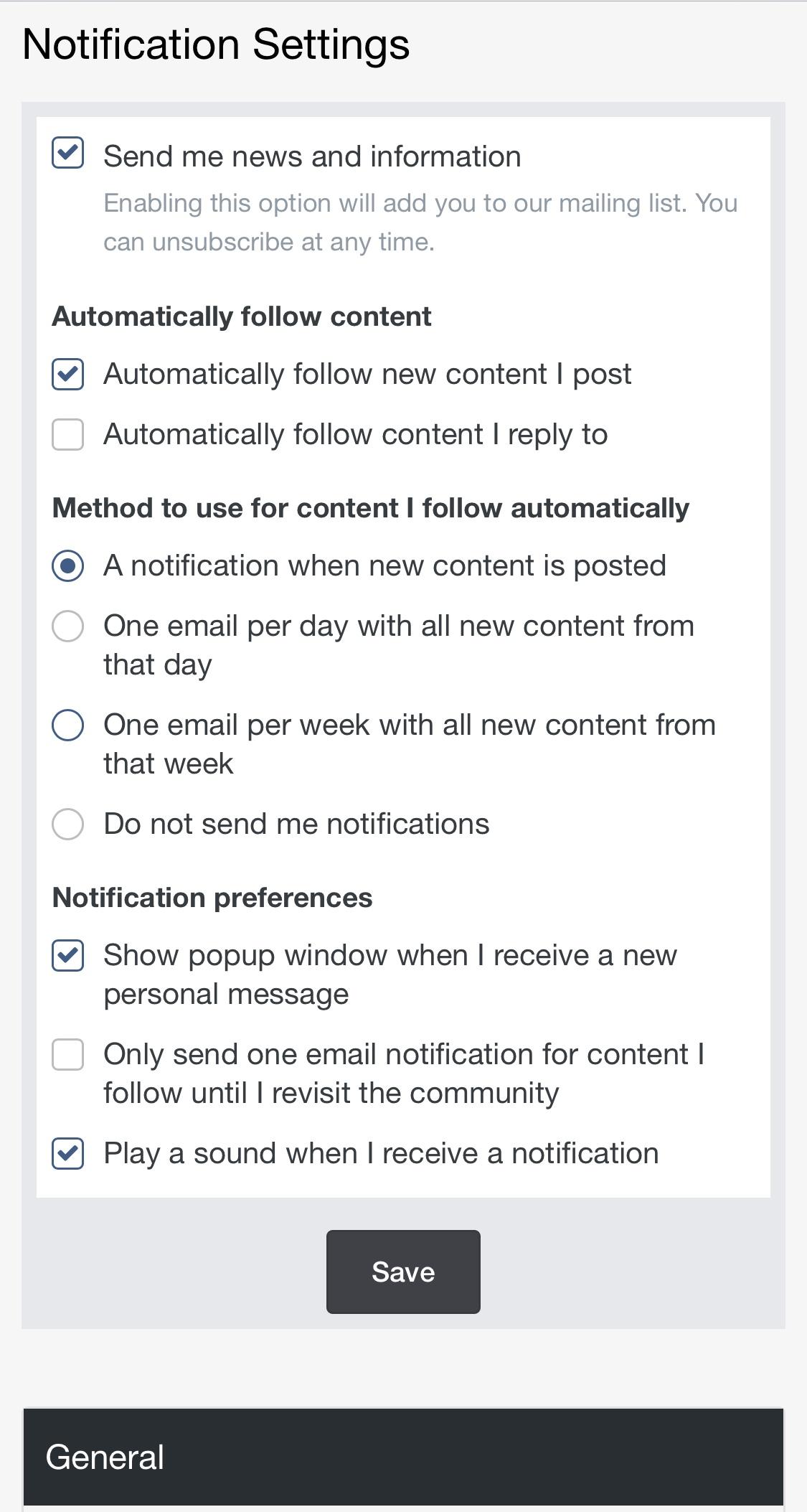

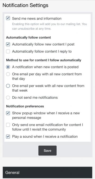

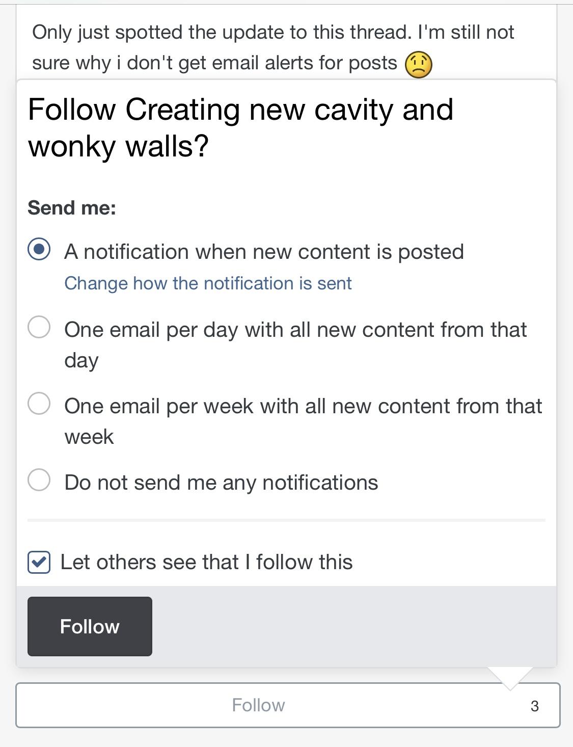

newhome Posted September 9, 2018 Posted September 9, 2018 @Digmixfill it doesn’t look as though you are following this thread (unless you are the incognito follower). At the bottom of the page hit the follow link and this screen will appear. You can select to follow a thread here. To manage your settings at account level once you are in the follow screen select ‘change how the notification is sent’. You can then manage the settings for your account. There are general settings at the bottom that you can set too.
