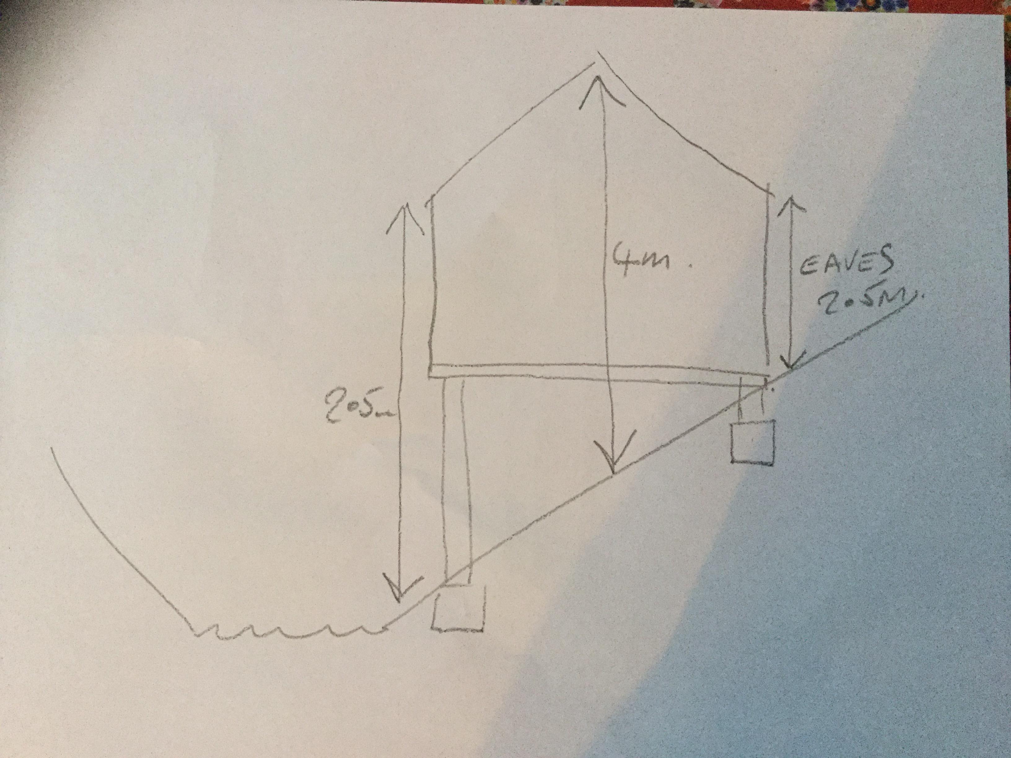

zoothorn Posted July 10, 2019 Author Share Posted July 10, 2019 29 minutes ago, Temp said: It's says "any part of the building" (the left hand corner is a part) .."measured from the surface of the ground immediately adjacent to that part"(eg adjacent to the left hand corner). I'm sure the wording in England is different and in England it would be measured from the right hand side. Ok if I interpret as you suggest, that in wales (for some odd reason- Id usually expect it less strict than england, or the same) it might then be measured from this L corner instead, I wonder in my case then if the H would be measured like this.. thoughts please Link to comment Share on other sites More sharing options...
joe90 Posted July 10, 2019 Share Posted July 10, 2019 But, taking that “measured adjacent to that part,”. 1, the eaves no more than 2.5m high both front and back. 2, ridge no more than 4m high. Will this be ok for you? Link to comment Share on other sites More sharing options...
Onoff Posted July 10, 2019 Share Posted July 10, 2019 10 minutes ago, joe90 said: But, taking that “measured adjacent to that part,”. 1, the eaves no more than 2.5m high both front and back. 2, ridge no more than 4m high. Will this be ok for you? How can it be 2.5m to the eaves BOTH sides? Link to comment Share on other sites More sharing options...
joe90 Posted July 10, 2019 Share Posted July 10, 2019 3 hours ago, zoothorn said: f) any part of the building, enclosure or container would be— (i) within 2 metres of the boundary of the curtilage of the dwellinghouse; Just read this too, if the stream is the boundary you need to move it 2 mtrs away from your boundary. Link to comment Share on other sites More sharing options...
joe90 Posted July 10, 2019 Share Posted July 10, 2019 1 minute ago, Onoff said: How can it be 2.5m to the eaves BOTH sides? Thats the maximum allowed per side, front one obviously less, depends on cabin dimensions and slope dimensions. Link to comment Share on other sites More sharing options...

zoothorn Posted July 10, 2019 Author Share Posted July 10, 2019 Thanks chaps. Unfortunately I'm as completely lost as I was. I don't know whether my (?) sketch is relevant, or totally irrelevant. And I can't comprehend the last few replies that followed it either. For eg @joe90 yes that's good for me.. but I don't know what you mean! (a better sketch than mine? yes). If I can go back a step. I was given this gobledigook page above by my planning officer. His covering email included the following (sorry I should have included): " Our understanding is that if the height of the building conflicts with (e) (i) and (ii) then you will need to apply for planning permission irrespective of height of land surrounding the proposed unit. " You see how he (& maybe someone else too) also seems to have to try & decipher it? Link to comment Share on other sites More sharing options...

joe90 Posted July 10, 2019 Share Posted July 10, 2019 Right @zoothorn we need a more accurate drawing with measurements to give us an idea of the actual ground slope etc, it’s dark now so off you go after breakfast in the morning with a tape measure and pencil and paper . Link to comment Share on other sites More sharing options...

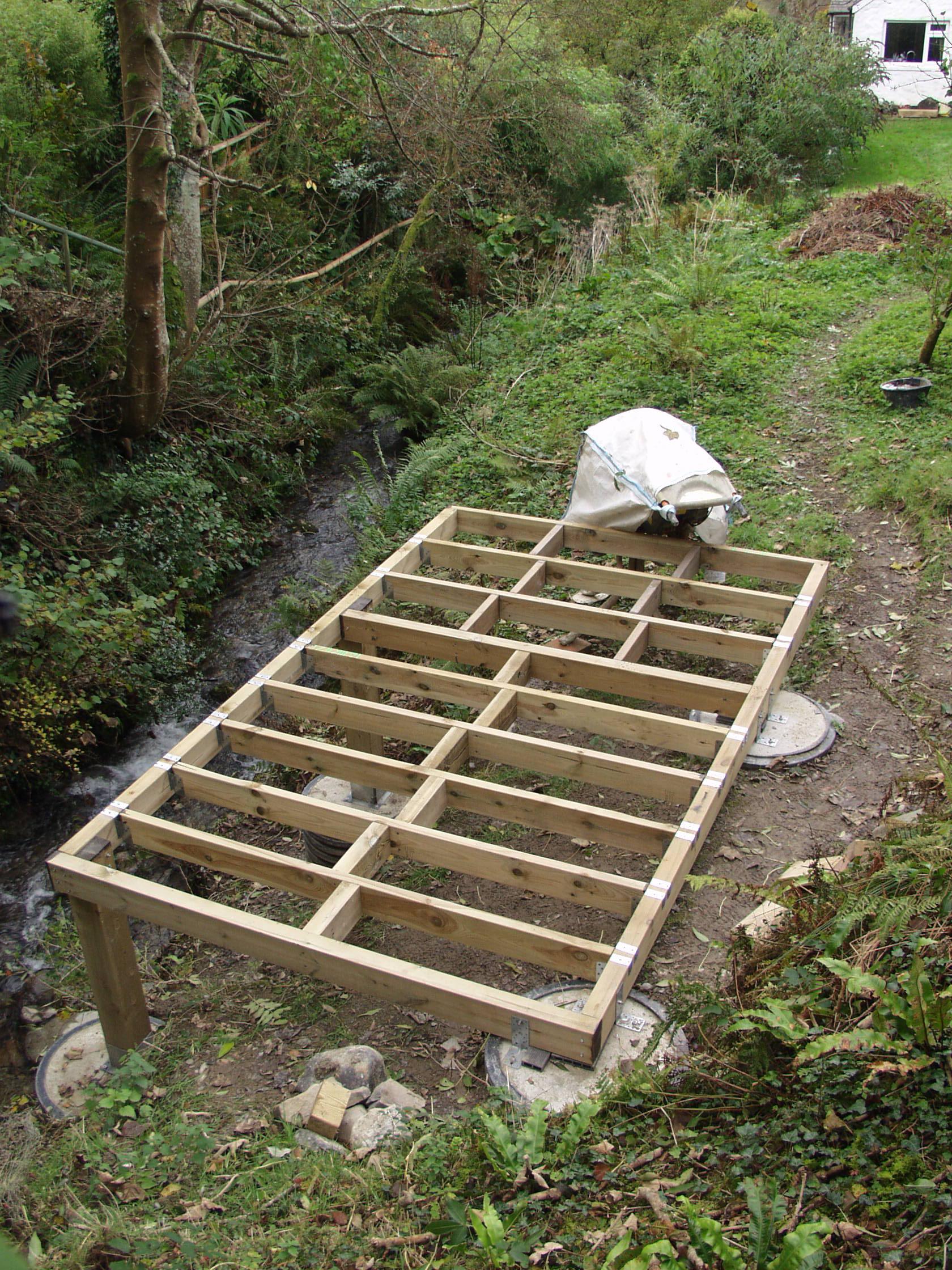

zoothorn Posted July 10, 2019 Author Share Posted July 10, 2019 Ok joe90 will do just that. Was still faffing in me cuttlefish dwellingthing at 10.30pm cutting great big tree down. I'm now thinking of invading this unreg'd land, marking it liberally with my zoot-musk & laying claim.. seriously if it might mean I can get it as I've spent alot of time in the planning, as per my pic. Link to comment Share on other sites More sharing options...

zoothorn Posted July 11, 2019 Author Share Posted July 11, 2019 @joe90 I spoke to my pillar chap today who expected to start this tmrw, we had it pencilled in. He said honestly round here you just do it & crack on etc. But with your replies has entered doubt & anxiety etc. Anyway, if I had to move it 2m away from stream centre.. then I could only have a 2m wide cabin. And Im still none the wiser about the H where its measured from, or know whether I can overcome this 2m limit -IF- I were to get PP for it: IE maybe if I approached PP dept I might be able to overcome these limiting factors by way of 'approval' by them having approached them. I have no idea whatsoever. I cannot understand the list of rules/ the words & sentences used, or the implication of the covering email from my PP officer. The only thing stopping me just cracking on as I'd planned tmrw, is my sod n'bors probable calling PP dept. But I overheard him say they've sold the house/ starting the slow chain of move xyz.. yet no evidence as I can see.. so whether the time to just crack on might be as soon as they've gone & new folks in (who'd unlikely start a fuss with new only n'bor, or need to know its either not got PP, or that PP was ever needed for it) I'm not sure. What I do know is that shifting it over 2m from stream centre, because I'm then into the steep bank & very tricky ground to put the low footings into, makes the project pretty much not-doable. Plus I could only get a 2m wide cabin in. Alot of work & expense for not much shed: cost of just doing the 3 footings will be approx £600 which is about £200 more than I expected worse-case (say £200 on other footings & base) = £800. Link to comment Share on other sites More sharing options...

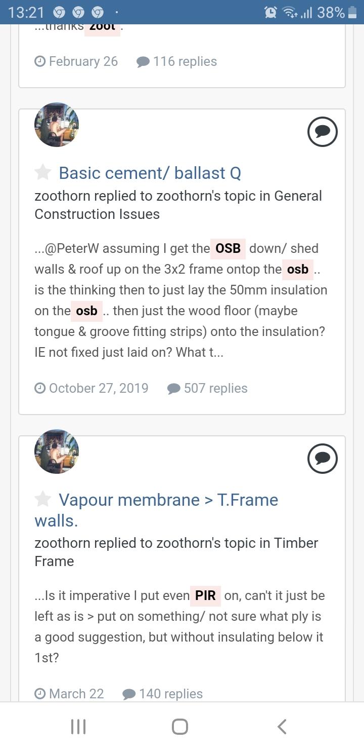

zoothorn Posted May 15, 2020 Author Share Posted May 15, 2020 Hi all. back onto this job. I need to put a layer ontop of my base here, for my t&g log cabin to go on. [2.5 m square cabin, front will face twds white bag, single noggins below (front 'deck' next to white bag, has double noggins)]. It was suggested I think, but I've searched in vain.. OSB, PIR, & an outer 3x2 'frame'. I think idea was 3x2 outer frame > PIR/ OSB inside it, just resting ontop my base (or PIR friction-fit in joists 1st?). Was it a @PeterW idea I wonder: can anyone shed any light? (pun sadly intended). Thanks- zH Link to comment Share on other sites More sharing options...
Onoff Posted May 15, 2020 Share Posted May 15, 2020 Page 19 here: Link to comment Share on other sites More sharing options...
zoothorn Posted May 15, 2020 Author Share Posted May 15, 2020 6 minutes ago, Onoff said: Page 19 here: Hi Onoff. that's impressive.. thanks. You must have one heck of a memory. Link to comment Share on other sites More sharing options...
Onoff Posted May 15, 2020 Share Posted May 15, 2020 Not really. I used the forum search function. Typed in "zoot osb pir" and put you as the author. A quick scroll through the pages that came up and I came across your thread: Link to comment Share on other sites More sharing options...
