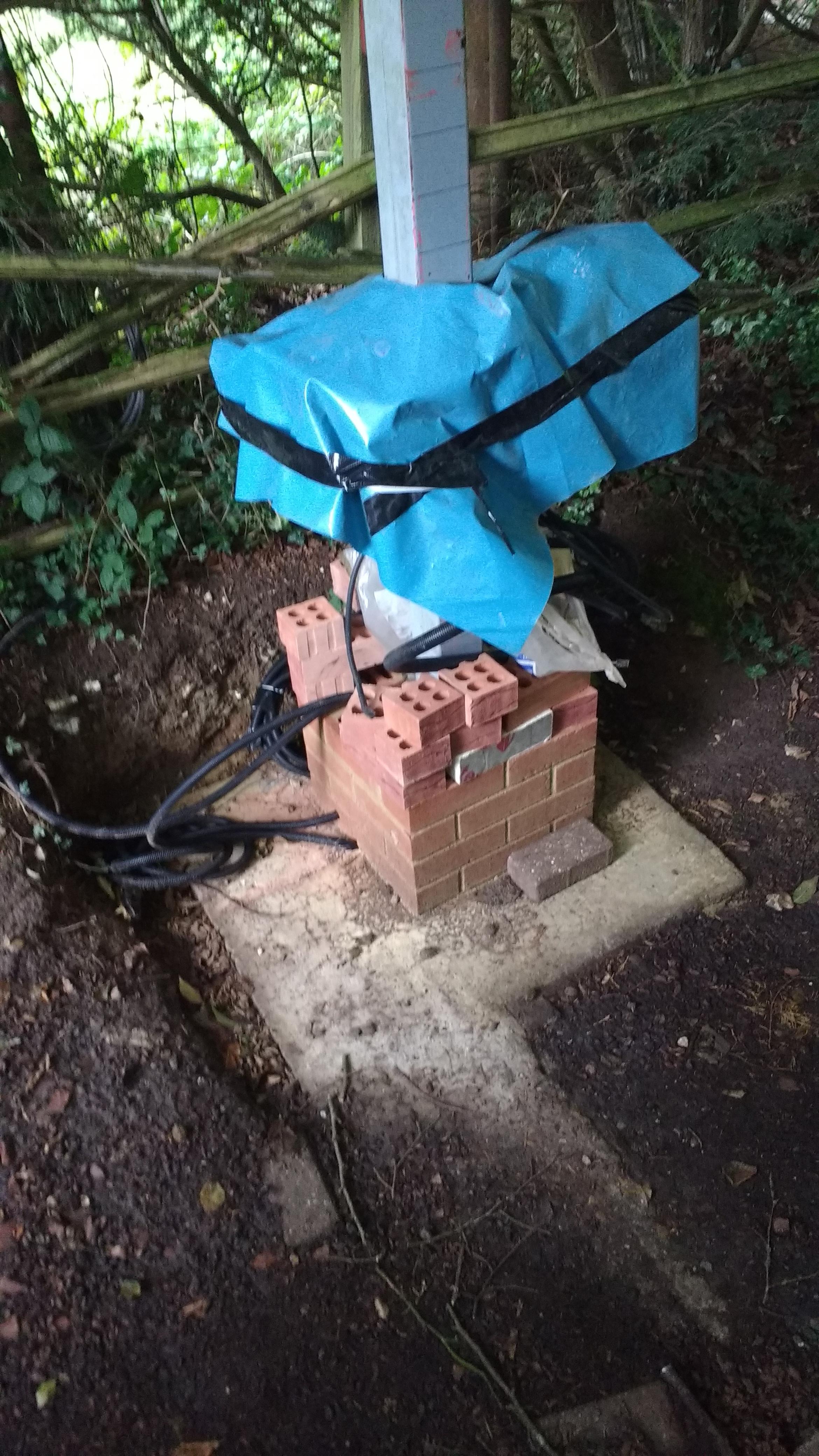

Onoff Posted September 8, 2019 Author Share Posted September 8, 2019 The lad and I did a few more courses. We are not brickies by a long shot! . Made a faux pas! 7th course high is a few mm higher than it should be. There's an angle iron welded to the box section that the set back brick at course 7 should have sat on directly. I unfortunately put muck on it then the brick. Living with it. 2 Link to comment Share on other sites More sharing options...

Onoff Posted September 8, 2019 Author Share Posted September 8, 2019 Reckon I need to claw back 12mm in height Due to a combo of initially the welded angle issue then too thick mortar lines and basically not working to those lines. My fault. Each horizontal black line on the post is 75mm apart. Where the bricks finish at the mo it's 63mm to the next black line! So 12mm in total. Thinking to thin 3 courses by 4mm each using the diamond blade in the evolution saw. Link to comment Share on other sites More sharing options...
Russell griffiths Posted September 8, 2019 Share Posted September 8, 2019 Don’t do it, if you cut one it will stand out like dogs balls. Why can you not just carry on as you are. Link to comment Share on other sites More sharing options...
Onoff Posted September 8, 2019 Author Share Posted September 8, 2019 Just now, Russell griffiths said: Don’t do it, if you cut one it will stand out like dogs balls. Why can you not just carry on as you are. Top of brick has to finish level with that wooden former on the front. What do you reckon lose it on the joints? Link to comment Share on other sites More sharing options...
PeterW Posted September 8, 2019 Share Posted September 8, 2019 Add don’t subtract ..!! You’ve got another 6-7 courses to go, make the beds a bit thicker and you’ll lose the problem. Link to comment Share on other sites More sharing options...
