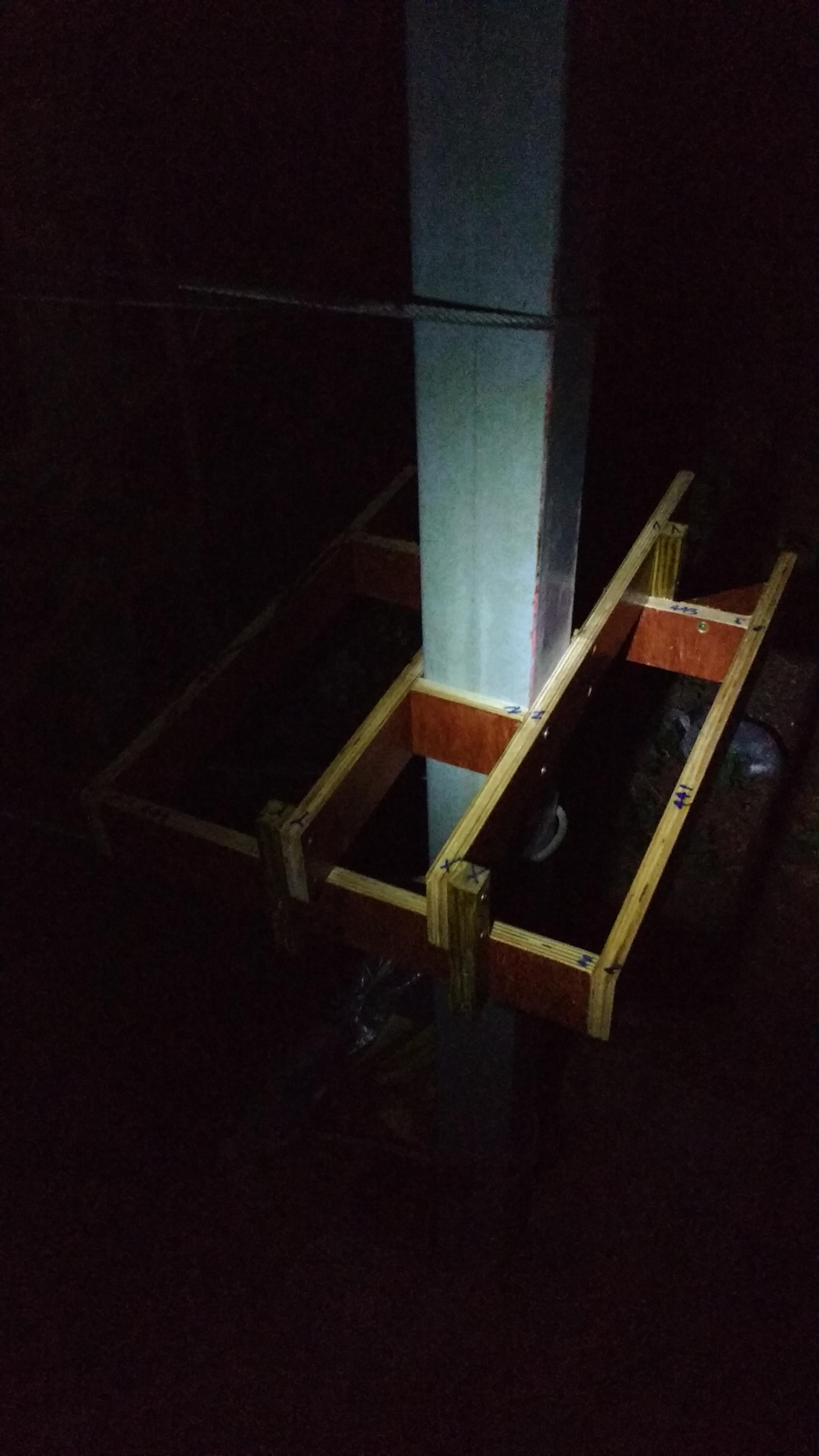

Onoff Posted August 1, 2019 Author Posted August 1, 2019 That's the jig done. See if it works tomorrow. How many courses can I lay in a day, as in how high? Wondering whether I'll get away without ties as I plan on filling it, top to bottom with wet concrete.

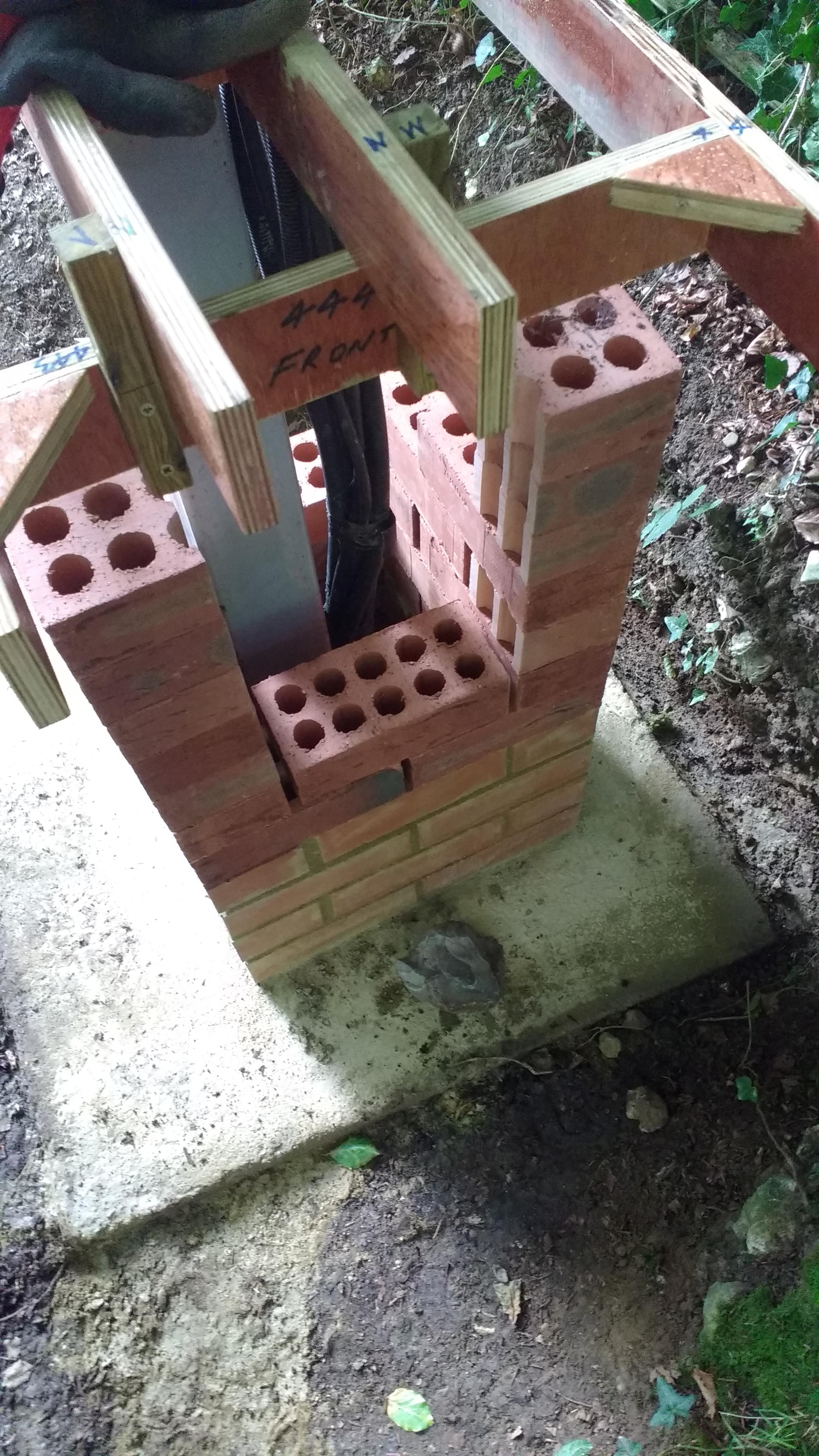

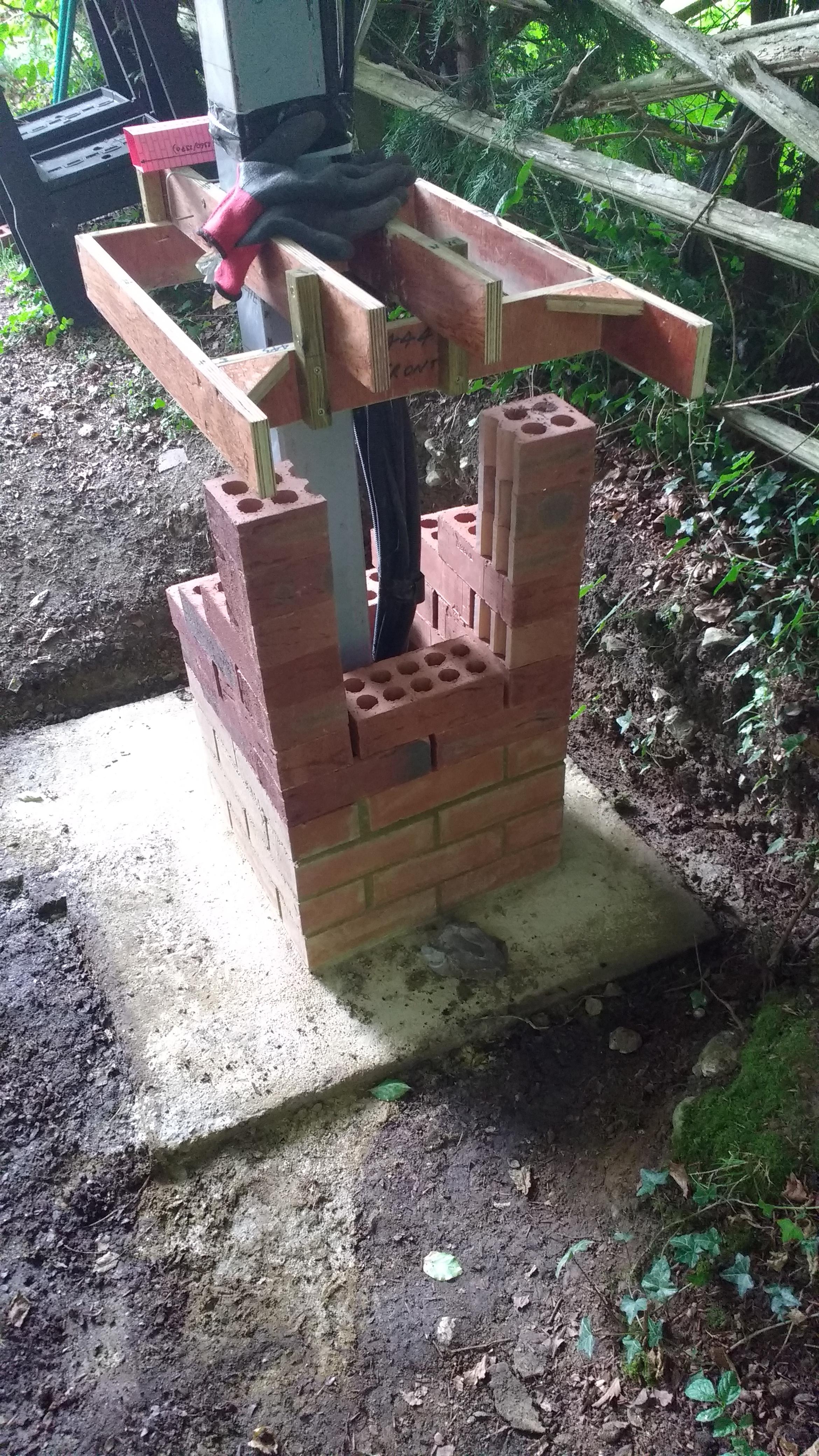

Onoff Posted August 2, 2019 Author Posted August 2, 2019 (edited) Made a start with the footing brick 4 courses. Tbh a 50/50 effort by my lad & I. Didn't realise, until now, that the 100x100 post is slightly "twisted", so the pillar is too. Difficult with the jig to do the vertical joints so I did those with a mortar gun. I'm not worrying about excess mortar falling inside as that'll be filled with a sticky, wet concrete mix later. I'm using stainless, Staifix wall tiles every 3rd course, across the 4 corners. Pre pointing up/ cleaning the faces off: Bump...how many courses high, can I safely lay in one go? Cheers Edited August 2, 2019 by Onoff
PeterW Posted August 2, 2019 Posted August 2, 2019 How wet is your mortar ..? 8 or 9 courses shouldn’t be a problem but it’s to do with how quick it is going off. What mix are you using ..?
Onoff Posted August 2, 2019 Author Posted August 2, 2019 16 minutes ago, PeterW said: How wet is your mortar ..? 8 or 9 courses shouldn’t be a problem but it’s to do with how quick it is going off. What mix are you using ..? Thanks. 4:1, building sand to opc. Maybe a tad too wet but not by much I don't think. Figured a nice, strong mix. Mixed up with Everbuild Integral Waterproofer, 1 part to 20 parts water. I'm pre soaking the bricks too before laying. Reckon tbh I can stiffen the mix up a bit. Tomorrow, I, or the lad , will need to weld a chunky angle on the front face after a couple of courses so I can set back the front face by half a brick for 11 courses. Going to see how well the Evolution saw halves bricks with the diamond blade fitted...might need a mask... This is the actual model of where it's going albeit with 4 courses of footing bricks: The opposite face will have a large, inset control panel affixed to the post so I'll need to come up with some sort of lintel for that and make a wooden box the same size to brick around then remove.
