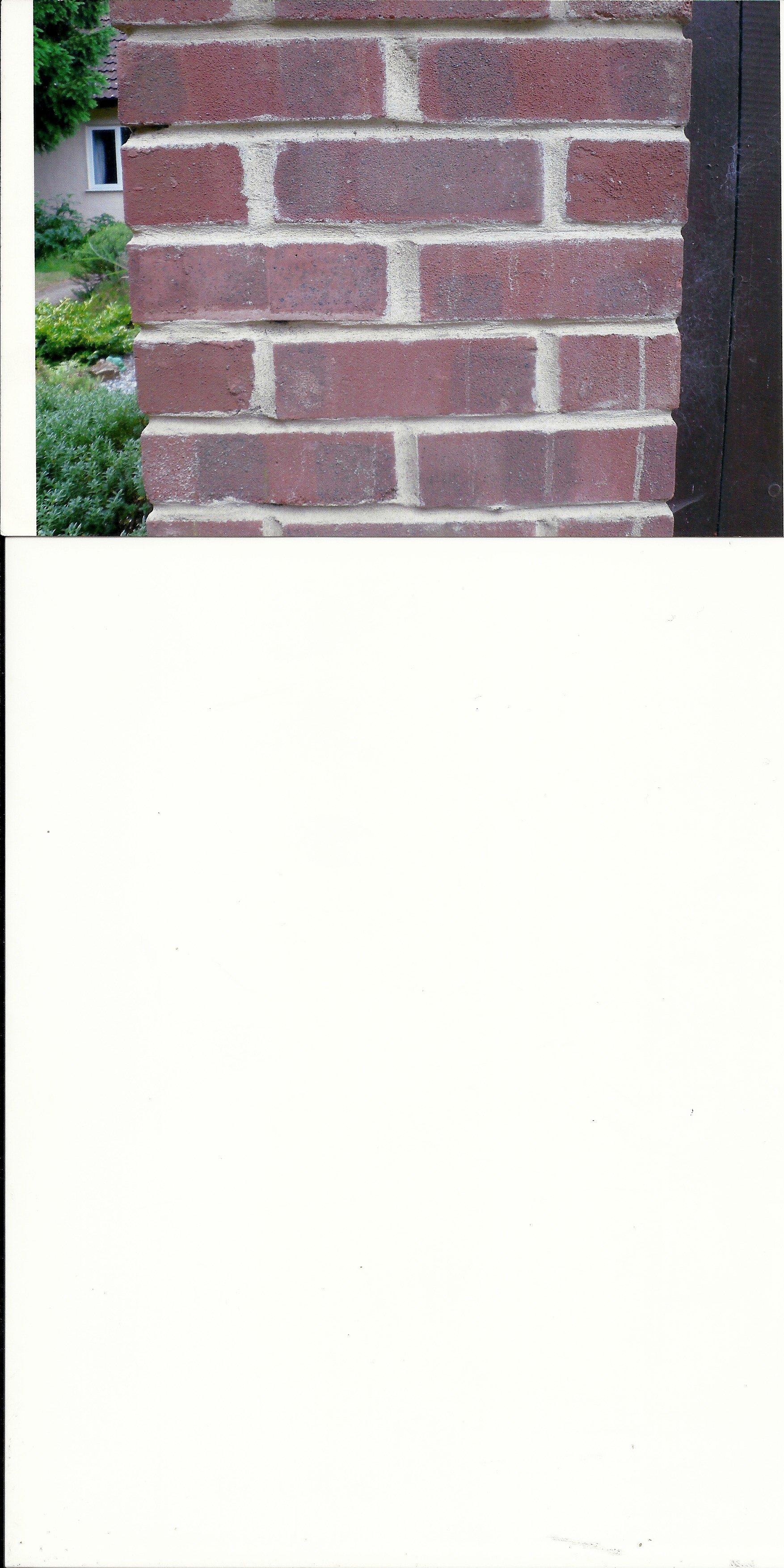

Me again...still thinking about my gate pillars! Selco have some on offer. Toss up between Tuscan & Tabasco reds:
https://www.selcobw.com/tuscan-red-brick-65mm
https://www.selcobw.com/baggeridge-tabasco-red-brick-65mm
F2 frost resistance. Could I build with straight off the concrete base i.e. no dpc?

I think you could build all in f2 without dpc. Why not put some solid engineerings in if your worried about breaking bond with plastic dpc. At least this would stop rising salts/efflouressense in future
Link to comment
Share on other sites
Thanks. You're meaning say 3 courses for instance of (red) engineering bricks first?

Option 1:
- 3 courses smooth red engineering brick
- F2 bricks thereafter
Option 2
- F2 bricks all the way, straight off the concrete base.
Mocked up with a few Celcon block. If a DPC goes down not sure on just a strip one the width of the "bricks" or a big one piece one, the area of the pillar itself:
SAM_8333
I will make a Bricky esque tool that clamps to the 100 x 100 post that you slide up to ensure complete dimensional accuracy and a constant thickness mortar bed.
I also thinking about infilling with mass concrete at least up to "Tesco van bumper height". I need to be VERY sure all my ducts for brick lights, intercom, sensors etc are in place beforehand and that there's eps blocks or similar  in place in lieu of bricks to be dug out later for the brick lights.

You will need to come up higher than 3 course of engineering bricks as in that pic you ground slopes.
so the 3 courses need to come up 3 courses above that high point of ground, no point putting them or a damp course lower than finished ground level.
Why not not just go 600mm high engineering bricks and then your face bricks, no damp course in garden wall, don’t over think it they will be covered in green mouldy shit in a years time.

Reckon I need to come up a good bit with engineering bricks to make 6" above ground! That's about 8 courses if 600mm. Might just do 3 courses then wrap the base 2' out of the ground in a black membrane and just cut it to the eventual ground slope. A bit like a post saver.
2019-05-05_11-57-54
Made a faux pas way back with the posts. After welding I ran gear oil down inside them so all faces were coated. I then gun foamed the insides. Why I don't know. Means the grey painted face condensates quite a bit. Think I'll paint with black bitumen before doing the brickwork.
