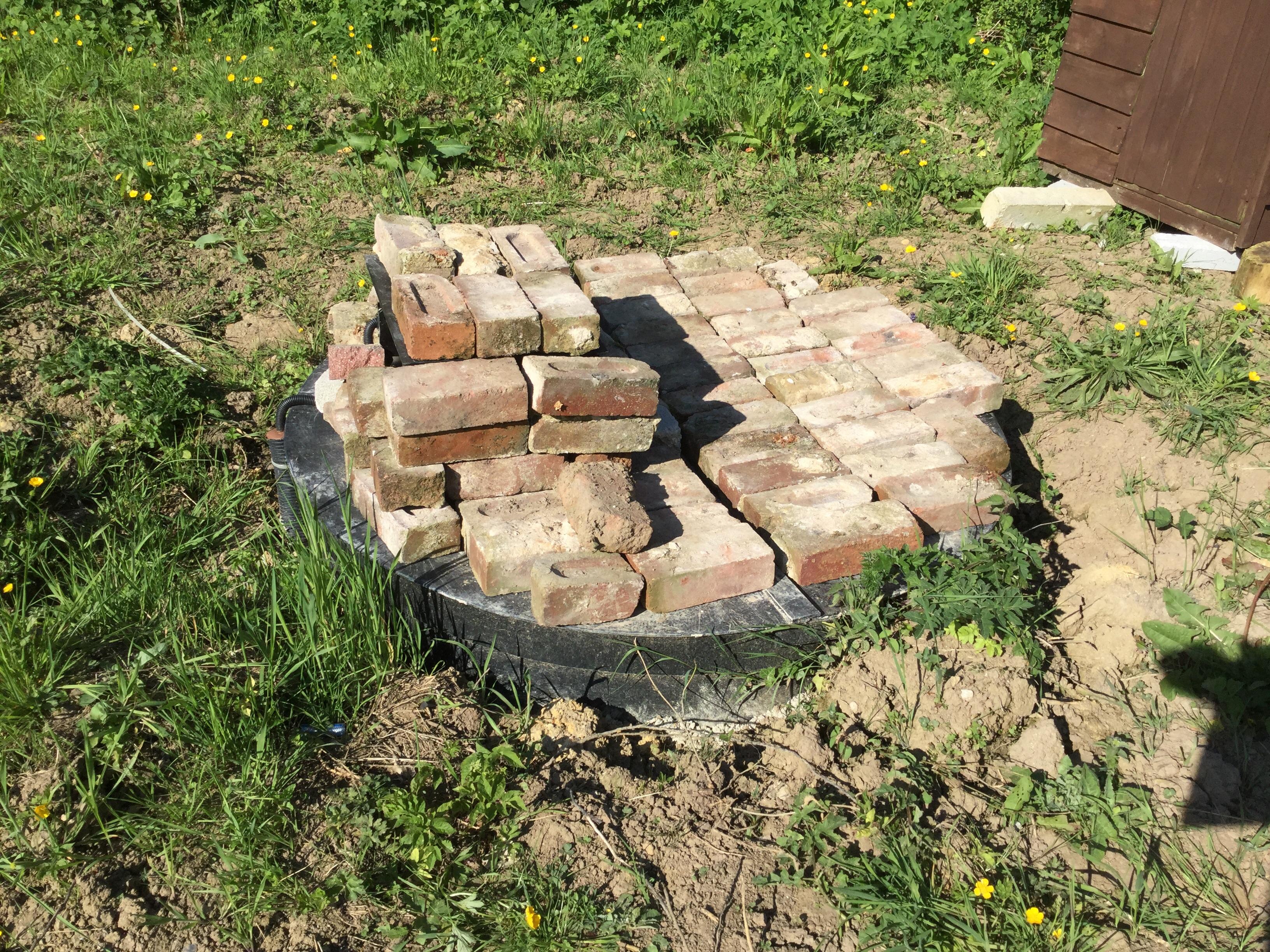

Well our Vortex treatment plant is in and working, I am having it commissioned properly by a local firm next week ( which may tweak the settings) . We live in a very quiet place but the plant when running produces a low hum and water turbulence can be heard at all times. We love to sit outside and listen to the birds and wildlife that surrounds us but it’s detracting ( a bit like a computer humming away in a quiet room). As mass is good for absorbing sounds I stacked bricks on the lid ( plus the lid acts like a drum I believe) but it’s not done much good and the lid is beginning to bow with the weight. Eventually the plant will be surrounded by dense bushes/shrubs to hide it.
I think the next plan is accoustic foam ( closed cell/ waterproof) stuck to the inside of the lid and the inside of the box on top that contains the air pump. Any suggestions will be very welcome ( plus good supplier for said foam)

    It makes a massive difference moving the air pump from the GRP compartment in the top of the unit to a solidly built housing.  I made a stone chamber on a solid concrete base to house our pump and ala
  • Jeremy Harris
    Jeremy Harris
    Just sticking the compressor on a pad of firm neoprene foam makes a big difference to the noise.  Making any enclosure from something like block or brick also makes a big difference.  The lid of mine

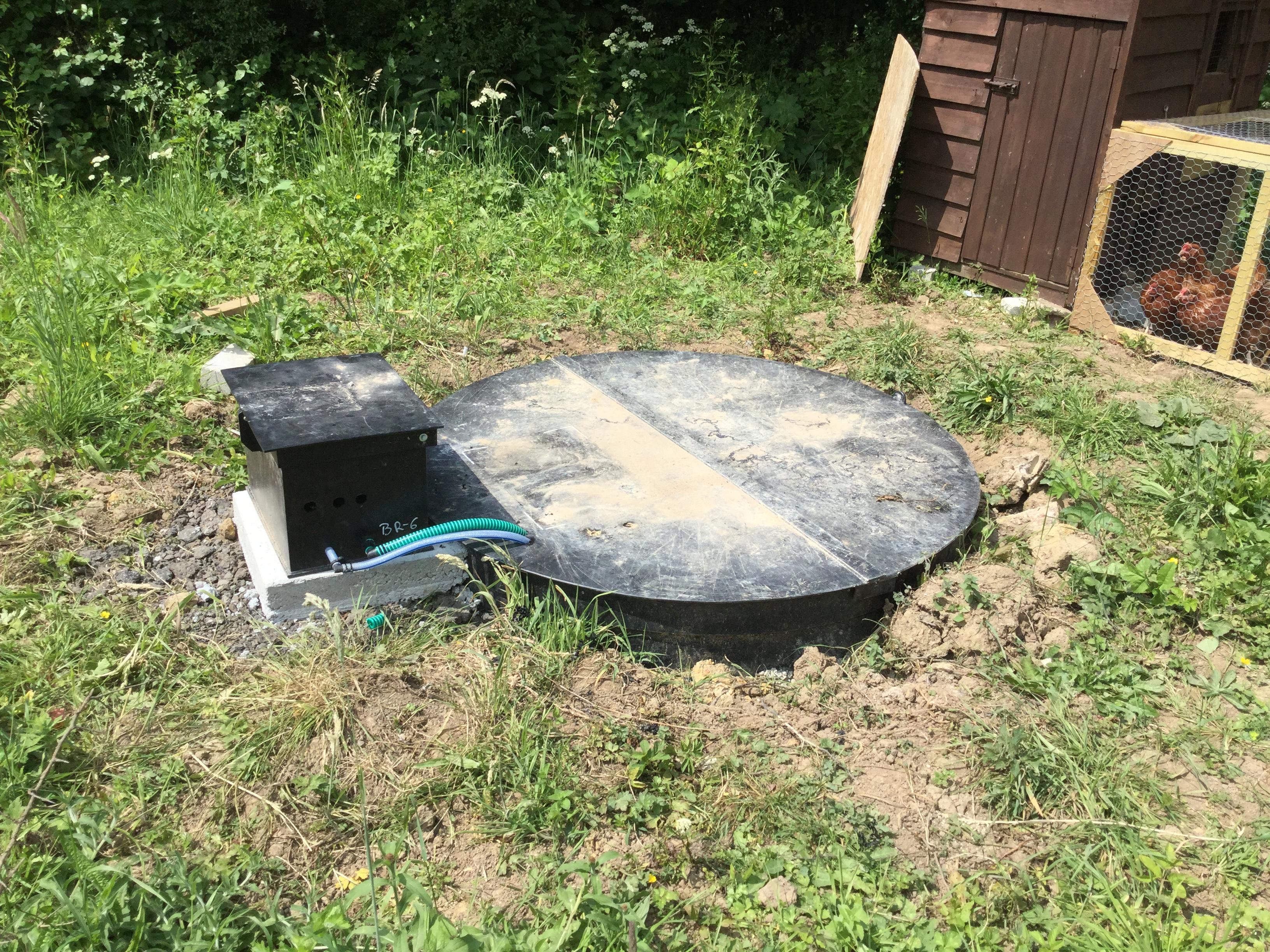

As an update, I have moved the blower housing on to a concrete pad next to the unit, lined the whole lid with acoustic foam, lined the blower housing with it as well and the unit is a lot quieter, job well done.

It’s the pump, which you will see from the pic above is next to the plant but now on a concrete pad, rubber mounted and lined with accounting foam.

Hi @mnt , yes and no, the noise is a lot less but still annoying at times as it’s very quiet here. I plan to build a brick “house” for the pump housing but I have a thousand and one jobs to complete first. (90% finished, only 90% to go!) Others have said “mass” I.e. concrete/brick is best for sound absorption so I will try that. Mine is only about 15 meters from my house so a ,lot closer than yours.

Looking at the Tricel it seems to have the air pump mounted in the tank top - that is part of the issue with these units and moving the air pump to a separate unit with a hard and heavy base may help.
Definitely helped with mine.
My air pump is in a box under the ground and can only be heard when a couple of metres away.
