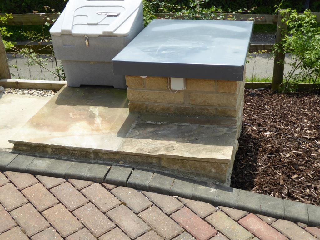

It makes a massive difference moving the air pump from the GRP compartment in the top of the unit to a solidly built housing.  I made a stone chamber on a solid concrete base to house our pump and alarm system.  Not only did it reduce the noise so that it's now practically silent, but it also makes checking and servicing the pump a great deal easier.

    Just sticking the compressor on a pad of firm neoprene foam makes a big difference to the noise.  Making any enclosure from something like block or brick also makes a big difference.  The lid of mine

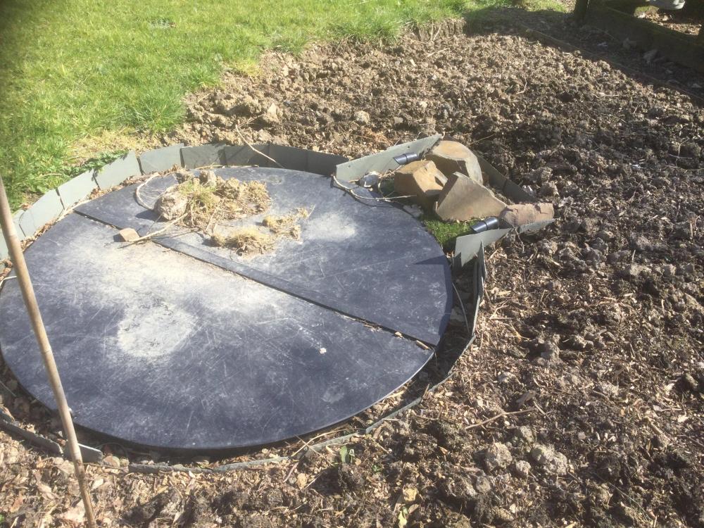

Thanks for the replies. Yes it seems that the Tricel sewage treatment plants with the pump above the ground in a green box makes it noisy. It's also not very attractive having that protruding from the lawn. Definitely a make to avoid! Not sure what to do as it's not going to be easy to dig it out and put a different one in, never mind the expense.
I have recently looked at the Tricel unit, I don’t think @mnt you need to be looking into digging the unit out, you need to look into re positioning the pump unit, just like Jeremy has done in a brick surrounded box with a bit of added insulation, some shrub planting and you should be able to get it a lot quieter.
Apart from the noise, the Tricel does have a large protruding green box which isn't very attractive and there are occasional whiffs of sewage if you stand next to it. It is positioned on a lawn so we could plant shrubs around it but it wouldn't fit so well in the garden scheme. It is mainly the humming that is the problem. I'm not sure how to place the pump somewhere else. I could unscrew the lid and have a look but I'm not confident about taking it apart. I've asked the guy who installed it to come back but he doesn't seem very enthusiastic. Do these things have settings? Perhaps it's on the maximum setting and could be turned down? Are the settings inside the device?

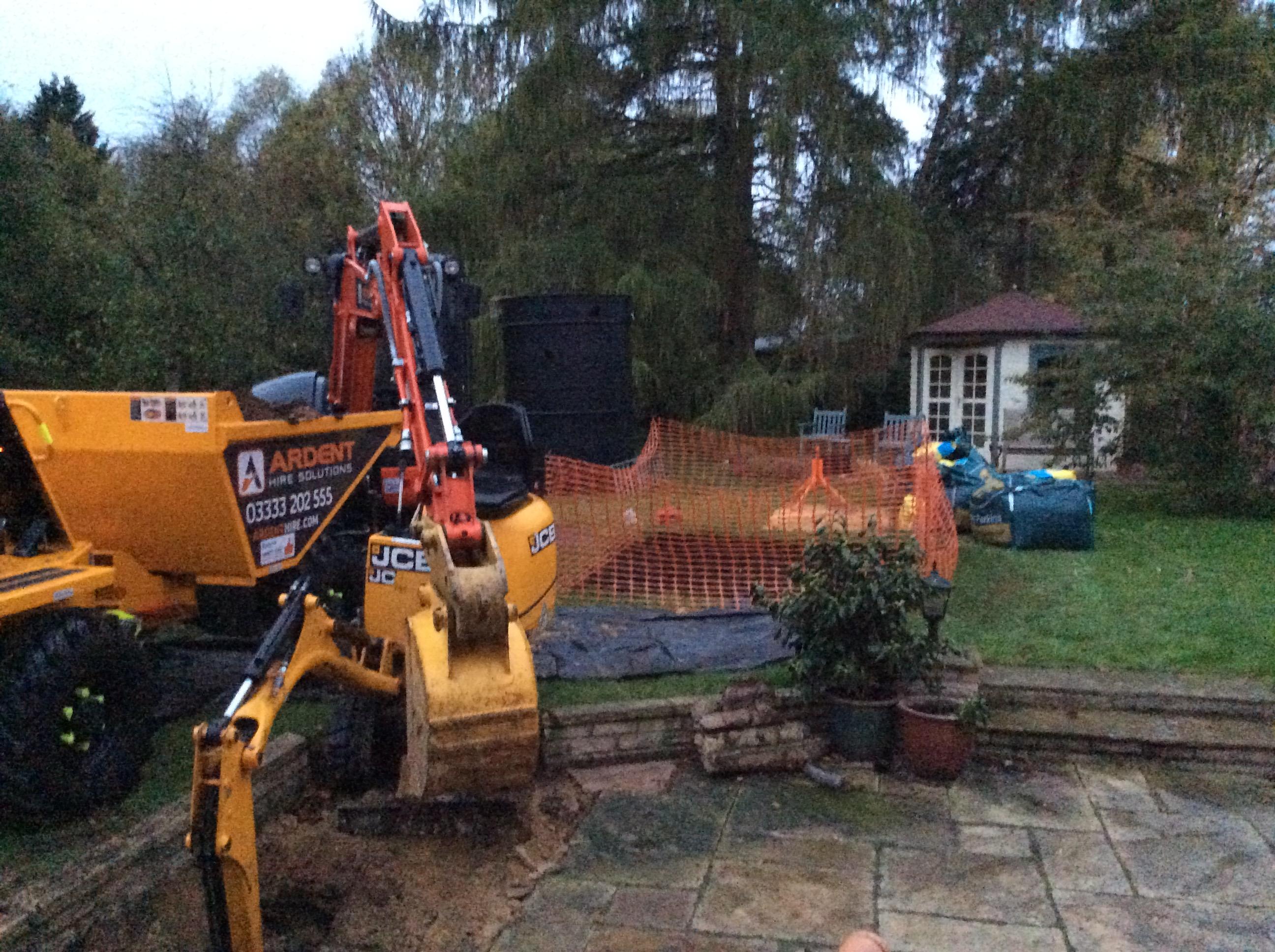

Joe, where have you got to with this? Mines just being installed.
One suggestion the guys installing it had was to mount the pump on strings, ie suspend it, so its not actually  touching anything.
As mines only 8 meters from the house, its a concern ive had right fro the start, but figured i will have to adapt/modify etc.

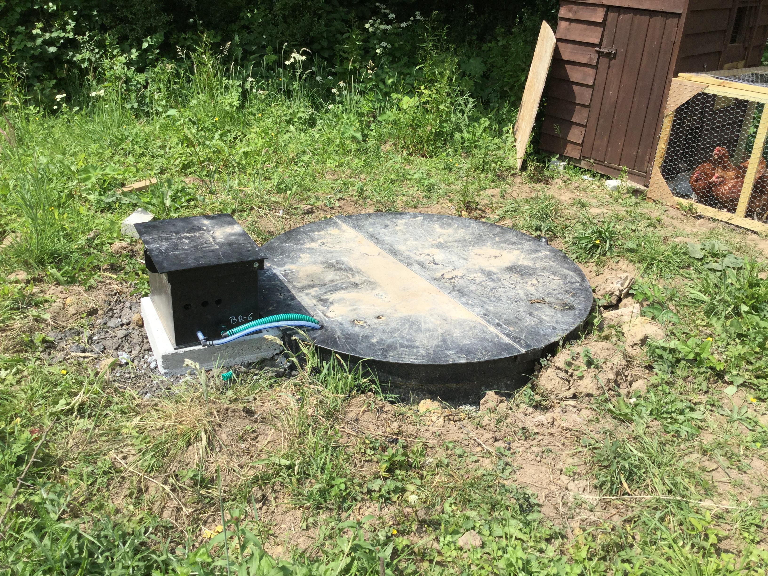

Well mines in all and running.
The box is temprarily mounted on a paving slab as ive got to lay a patio etc round it.
However, it is quite noisey. Having had the dubious privelege of looking inside it this morning (and more than halving the noise with a towel) i think its fair to say that minimal engineering thought has been applied to this.
The compressor sits on rubber feet, but has 2 plasctic upstands each side of it, with a hole in the top of each and a tie wrap strapping it into position, thus bypassing any benefits the rubber feet might have!
Standing next to it, you can feel the vibration through the ground!. Plus the lid rattles when its closed.
Addtionaly, the rubber output pipe is in hard contact to box, as are the pipes to the tank where they pass through the box..
Upshot is, this lot is destined for the skip.New design required.
Im thinking something similar to Jeremys, but buried, and built into an insulated "well" to cut down virbration transmission. And suspensd the compressor on "strings". And rubber mount the pipework.And, and and,................................

Just sticking the compressor on a pad of firm neoprene foam makes a big difference to the noise.  Making any enclosure from something like block or brick also makes a big difference.  The lid of mine is made from two layers of 18mm ply, glued either side of a layer of 6mm neoprene foam, with the underside lined with acoustic foam.  The lid is hinged at the rear and has a strip of 6mm neoprene foam all around the edge as a seal.
The only slight  source of noise I had initially from the box was from the air inlet hole, which I had made from a bit of 40mm waste pipe sealed into the enclosure with sealant and fitted with a rod end type screw cap, with the lid bored out and a mesh fly filter fitted.  Noise from that was fixed by fitting an elbow inside the box and short length of 40mm pipe running inside, perpendicular to the pump.
