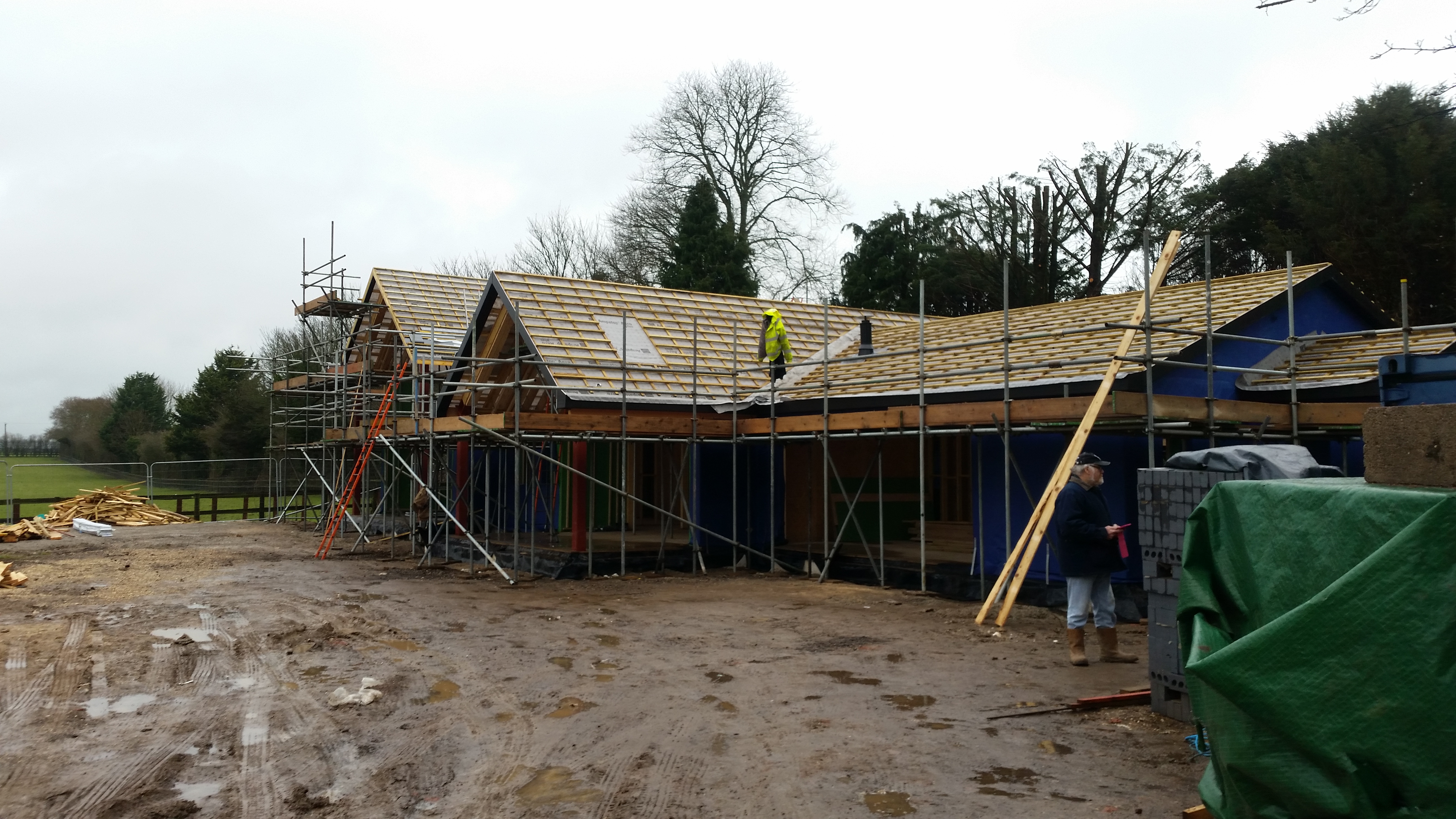

Mikey_1980 Posted June 28, 2016 Posted June 28, 2016 We had that decision to make with our build as we missed out original August start due to sales issues, weren't ready to start until Decemeber and it was a case of do we hold off until March when the weather maybe be better or start ASAP, we but the bullit and the MBC slab went down the week before Christmas and the Frame on the 18th Jan, we had no problems with the Weather other than some heavy rain but as there is no insulation in the frame and plenty of air can get to it until it is weather tight than there is little risk of Damage.
joe90 Posted June 28, 2016 Posted June 28, 2016 From what I have read about MBC they get a watertight structure very quickly and that's their job. I was planning a straw bale build a few years ago and that is much more prone to water damage and I planned to build a scaffold house around it and build within. Where you are you is exposed so may be a different situation. I would get on with it, we could well have an " Indian summer" ( personally I am praying for it as I am STILL waiting to start my build).
Jeremy Harris Posted June 28, 2016 Posted June 28, 2016 Our frame went up during November and was watertight within 4 1/2 days. We had the worst winter for years, with torrential rain and floods for days on end, and during all that time the house had no roof covering, other than the membrane. The roofing wasn't completed until near the end of January, because of all the bad weather. There were no problems at all with water ingress anywhere, the only real issues were that things were delayed by the weather (the rain and wind delayed fitting the PV, for example, as it was too hazardous at times to work on the roof).

Barney12 Posted June 28, 2016 Author Posted June 28, 2016 Thanks guys. My confidence is improving with every post One thing I didn't (and should have) mention is that the most exposed elevation has some pretty huge windows. So....if the worse happened and the window install was delayed do you think that with the fabrication of some OSB frames to fill the holes we will keep enough weather out? Or, even pay MBC a little extra to take the exterior membrane over the openings and simply cut them back? Even the fairly cheap non tenting membrane I used on the sheds is incredibly tough and hard to tear so assumably has pretty good wind resistance? As @joe90 and @recoveringacademic (my fellow delayed builders!) have said a number of times; delays do have the effect of allowing too much thinking time! I'm not sure thats entirely helpful at the early stage. Ironic when once it all gets going I'll probably crave more thinking time!
Jeremy Harris Posted June 28, 2016 Posted June 28, 2016 Our panels were supplied with the membrane over the external openings. It was cut back on site and stapled to allow the windows to be fitted
Mikey_1980 Posted June 28, 2016 Posted June 28, 2016 We have two very large glazed openings and these were open to the elements for 6 weeks, and there was a lot of rain and frosts.
Declan52 Posted June 28, 2016 Posted June 28, 2016 Having worked outside for too many years you would be surprised how few days over winter where it would be a complete washout. The cold stopped work more as scaffolding isn't much fun when it's frozen. If you had the roof on before the cold came you would be flying. You can cover up any openings easily enough till the windows go in.

TerryE Posted June 28, 2016 Posted June 28, 2016 We were lucky enough to be able to coordinate the window installation with the frame erection, so the windows went in starting the last day of the frame erection when the MBC crew were working in the loft anyway, but if you can't do this then (i) make up temporary windows or equiv out of tarpaulin grade clear plastic and (ii) make up a simple lobby out of framing and OSB3 and get yourself the cheapest Wickes exterior door and frame that you can buy so that you can secure the building. It's just so much easier working out of the wet. Like Jeremy we had a delay of about 6 months, but ours was between the frame going up and starting the inside work. This gave us time to experience the space and we made quite a few small changes as a result: swapped the use of an internal bedroom and divided the largest into a bedroom + smallish walk-in wardrobe + ensuite; moved another couple of non-loadbearing internal walls; swapped the side for the racking on another wall. This also gave us time really to think through the layout of the wet rooms and kitchen. Jeremy recommends building a physical model of your build during design -- well there is nothing like a 1:1 model to plan out your house in and this can take time to get right
ProDave Posted June 28, 2016 Posted June 28, 2016 My frame went up in the summer and was finished in the Autumn. Because from then on it has only been me working on it, a lot of it was exposed over the winter. I spend December and January tiling the roof when the weather allowed, and it was only in the spring that I got started on the external cladding and render. The most exposed, west facing elevation I covered with some left over damp proof membrane to keep the worst of the weather off. I have known peiople take 2 years doing all the work themselves to get a frame winf and watertight and still have no problems.
