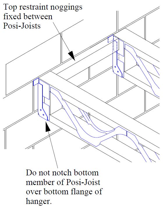

epsilonGreedy Posted March 21, 2018 Share Posted March 21, 2018 I get that masonry wall floor joist hangers are favoured over traditional in-wall fixing of joists in the pursuit of airtight homes but can these hangers cope with 100 years of cyclical loading? Here is my beef. Driving a metal nail into a brittle masonry block to attach a hanger feels like an abuse of such dissimilar materials with long-term failure designed into the fixing. Next add 100 years of 80kg cyclical loading as humans walk around inside the home, stir in some thermal expansion and contraction loads on the hanger attachments and surely after a decade or two the hanger nails will start wobbling in the blocks? Then finally for a laugh apply that process to light thermal blocks. Are my concerns unfounded? The no nonsense commercial builder of a plot nearby has fitted his metal web floor joists direct into the inner blockwork and these blocks are heavy structural blocks I think. Link to comment Share on other sites More sharing options...

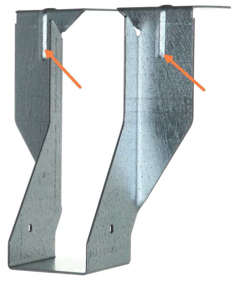

ADLIan Posted March 21, 2018 Share Posted March 21, 2018 There are 2 basic types of joist hanger - onto masonry and onto a timber ledger. The masonry ones are built into the mortar beds and hook over the block - they are not nailed. The others are nailed onto the timber ledger. In both instances manufacturers give very strict fixing instructions. Link to comment Share on other sites More sharing options...
epsilonGreedy Posted March 21, 2018 Author Share Posted March 21, 2018 50 minutes ago, ADLIan said: There are 2 basic types of joist hanger - onto masonry and onto a timber ledger. The masonry ones are built into the mortar beds and hook over the block - they are not nailed. The others are nailed onto the timber ledger. In both instances manufacturers give very strict fixing instructions. Ok this is reassuring. I thought the lower part of the masonry hanger had to be nailed to prevent the lower half of the joist from twisting and thus promoting floor flex. There was a long thread here at the start of the year and some excellent photo detective work from forumites identified lack of nailing and thus twisting, having re-read those posts I now think the problem related to wood to wood fixing around a chimney breast. There is however another aspect mentioned in the Posijoist manual, they say if joists are expected to contribute to lateral wall bracing special hangers are required. I wonder if these require nailing. Quote Posi-Joists™ can be supported in masonry hangers at an external masonry wall. This method of construction meets the thermal and air leakage requirements of Building Regulations. This detail does not provide lateral restraint to the wall unless a restraint type hanger is used, if standard masonry hangers are used restraint straps will be required. I am spending two days at the NEC exhibition this week and hope to get more technical insight from metal web joist manufacturers. Link to comment Share on other sites More sharing options...
Mr Punter Posted March 21, 2018 Share Posted March 21, 2018 http://www.strongtie.co.uk/products/detail/safety-fast-hanger-for-i-joist/402 These go over the blockwork, so give lateral restraint. Link to comment Share on other sites More sharing options...

Temp Posted March 21, 2018 Share Posted March 21, 2018 1 hour ago, epsilonGreedy said: I thought the lower part of the masonry hanger had to be nailed to prevent the lower half of the joist from twisting and thus promoting floor flex. I think that's true for hangers fitted to a timber wall plate. The pictures of masonry hangers show no nail holes on the bits facing the wall. http://www.strongtie.co.uk/products/detail/heavy-masonry-hanger-for-solid-joists/341#tab-installation Link to comment Share on other sites More sharing options...
Temp Posted March 21, 2018 Share Posted March 21, 2018 (edited) 1 hour ago, epsilonGreedy said: There is however another aspect mentioned in the Posijoist manual, they say if joists are expected to contribute to lateral wall bracing special hangers are required. I wonder if these require nailing. NHBC have a lot on floors and joists in their site work guides.. http://nhbccampaigns.co.uk/landingpages/techzone/previous_versions/2011/Part6/section4/sitework.htm Builders merchants are full of bent bits of metal for this sort of thing. I think you normally use a L shape strap hooked over the wall and nailed to the joist in addition to the hanger. One of these straps every 2m. Something like that. PS: If it's different for Posijoists I would ask them. Edited March 21, 2018 by Temp Link to comment Share on other sites More sharing options...
StructuralEngineer Posted March 21, 2018 Share Posted March 21, 2018 The timber to masonry hangers in this list all have a ledge which sits in the bed joint: http://www.strongtie.co.uk/products/gamme/timber-to-masonry-hangers/129/liste Link to comment Share on other sites More sharing options...

Gone West Posted March 21, 2018 Share Posted March 21, 2018 4 hours ago, epsilonGreedy said: There is however another aspect mentioned in the Posijoist manual, they say if joists are expected to contribute to lateral wall bracing special hangers are required. I wonder if these require nailing. My metal web joists hang on a ledger plate from the top chord. Link to comment Share on other sites More sharing options...
epsilonGreedy Posted March 21, 2018 Author Share Posted March 21, 2018 (edited) 42 minutes ago, StructuralEngineer said: The timber to masonry hangers in this list all have a ledge which sits in the bed joint: http://www.strongtie.co.uk/products/gamme/timber-to-masonry-hangers/129/liste Thanks, this video from the StrongTie web site helped and now I can picture how the ties work as well though did anyone notice show they skipped nailing the tie to the wall block, is that an error in the video creation? p.s. Do people find these auto enhanced YouTube inserts annoying? Edited March 21, 2018 by epsilonGreedy Link to comment Share on other sites More sharing options...
Mr Punter Posted March 21, 2018 Share Posted March 21, 2018 25 minutes ago, epsilonGreedy said: Thanks, this video from the StrongTie web site helped and now I can picture how the ties work as well though did anyone notice show they skipped nailing the tie to the wall block, is that an error in the video creation? p.s. Do people find these auto enhanced YouTube inserts annoying? Do don't nail to the blockwork. The courses above keep it in place. Link to comment Share on other sites More sharing options...
