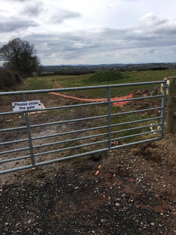

readiescards Posted March 10, 2018 Posted March 10, 2018 This is a photo of my 'front lawn' as you can see it has a lot of standing water and if you look in the background you can see standing water in the fields too. When I walk on my lawn my wellies sink a good 4-5" inch into the top soil as it is sodden and little more than a brown sloopy soup with a crust on top. The sub soil is clay that, I reckon, has been badly compressed by the build process. The site has a distinct slope so I think some sub-surface drainage would help prevent this issue in the future. However the only solution I know is to scrape off the top soil and run a mole plough through the sub soil to break it up and open up some drainage channels. This would be quite tricky as it would need a big tractor to pull the mole plough and that would be tricky within the confines of the site. Would like some advice on other drainage ideas, I'm reluctant to just accept that 3 months of the year the lawn will be underwater...

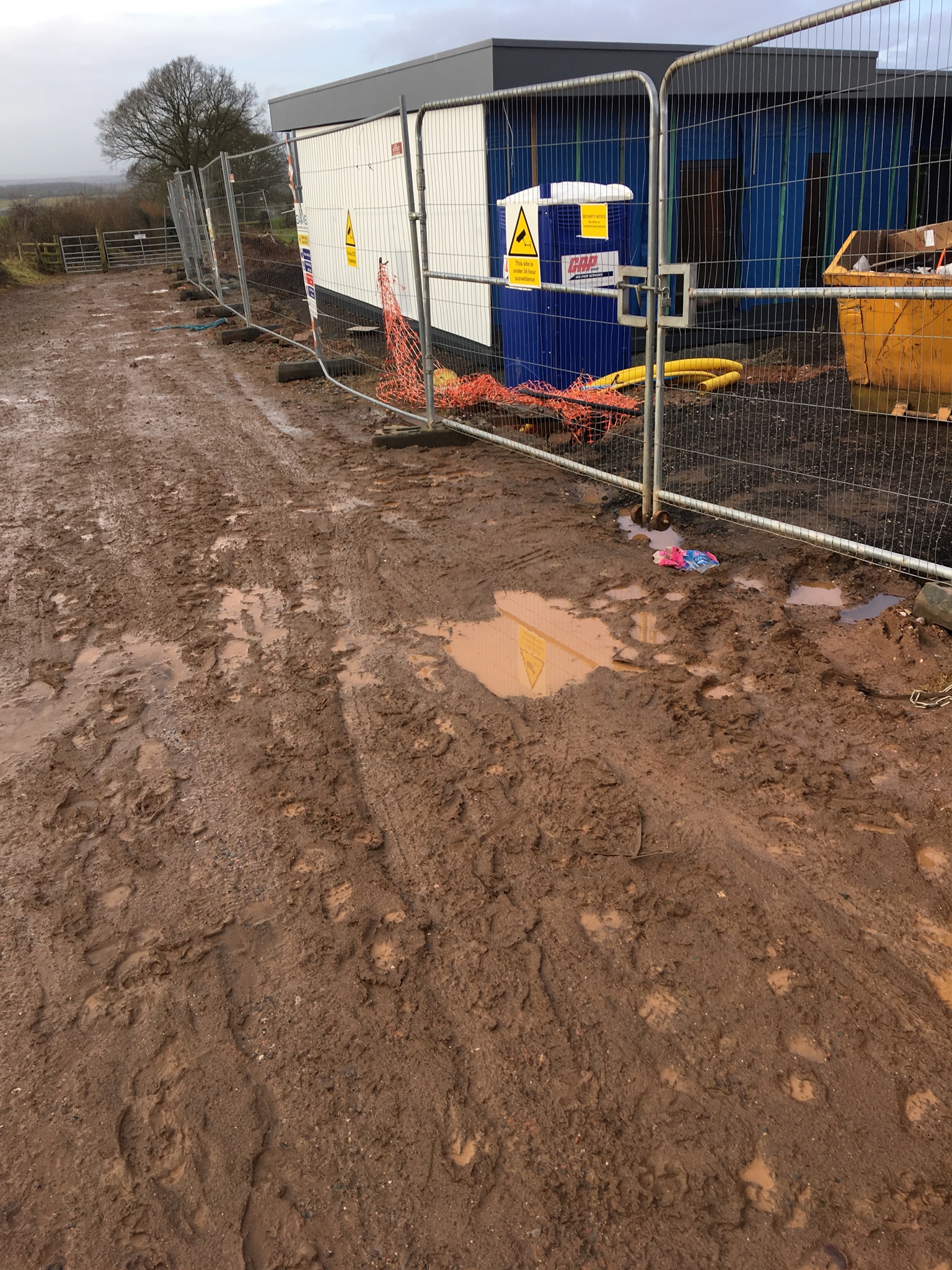

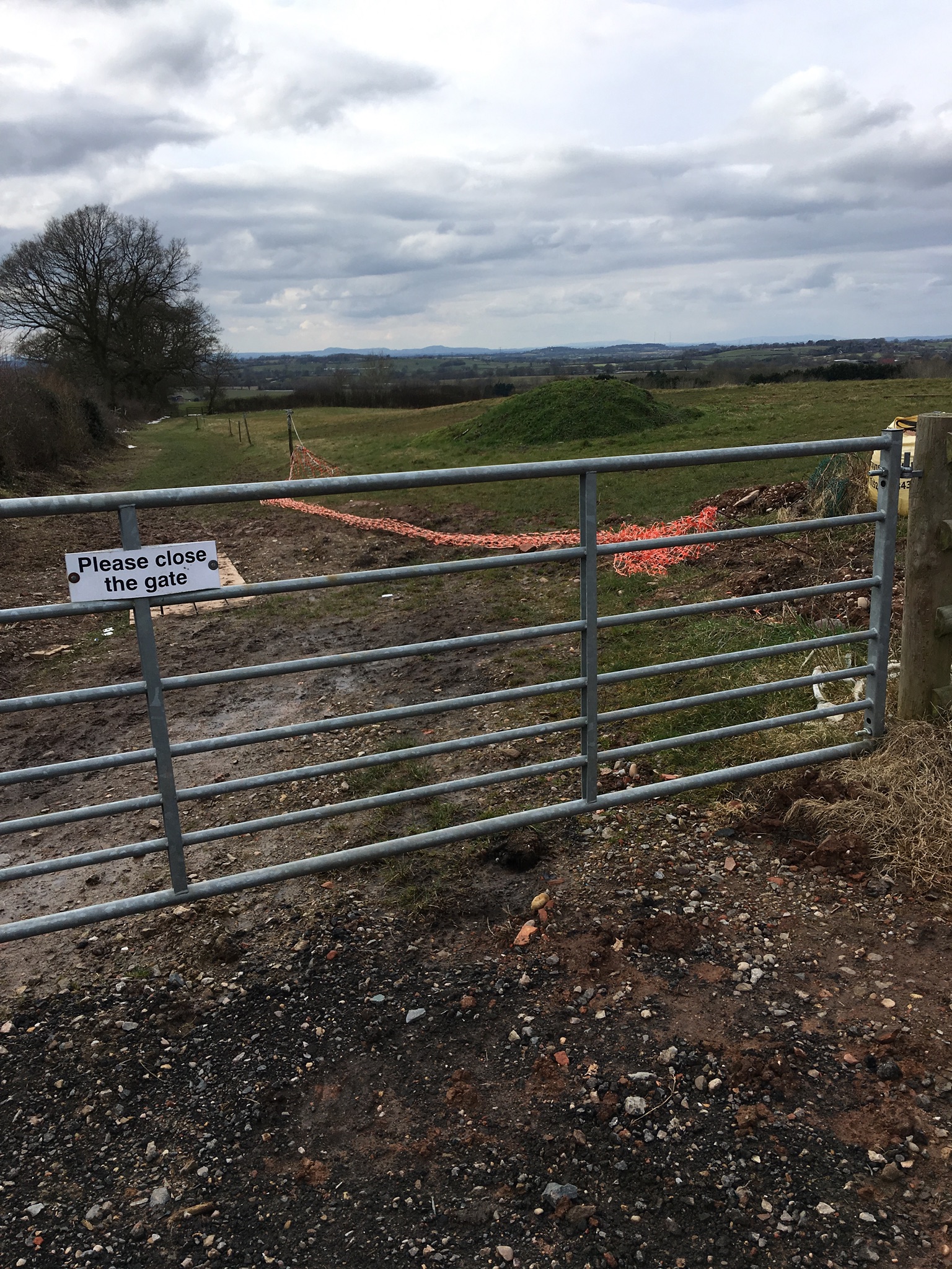

lizzie Posted March 10, 2018 Posted March 10, 2018 14 minutes ago, readiescards said: Share your slop pics please! I cant get at the garden pics at mo, we are planning to get topsoil down shortly but as we found unconnected drainage pipes (from the en suite!) we are digging trenches again and that is delaying garden levels. This is a pic of the access road (after many 100’s of tons of stone down) the clay in the garden is worse as it has no stone in it. The other picture is the field in front of us and you can see it is waterlogged. 1

readiescards Posted March 10, 2018 Author Posted March 10, 2018 Spent the morning cutting some channels in the top soil slop to help water drain away (plot on a slope so works well). As you can see where my welly has been the top soil is turning into solid mud. I'm fairly sure it is not a water table issue as the plot is higher than the surrounding land. If I can get the top soil drained and dry with some sub soil drainage, will a run over with a rotavator revive it?

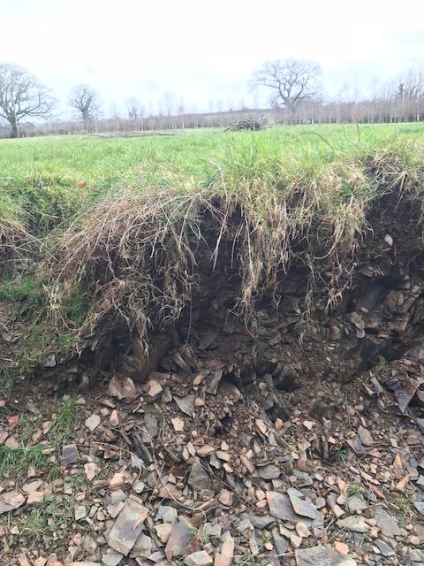

ToughButterCup Posted March 10, 2018 Posted March 10, 2018 @readiescards, how much time do you have? We are on Glacial Till overlaid by Made Ground. We like you are also on slope. 31 minutes ago, readiescards said: [...] I'm fairly sure it is not a water table issue as the plot is higher than the surrounding land. [...] The first thing I did with the digger I bought was to dig a deep hole (as deep as the arm would reach), mark and cover the hole with railway sleepers. And left it for a year. Each month, I'd take a photo of the water level in the bottom. As @ProDave suggests above, that job established the winter and summer water table. (For that year only: but it gave an indication of an average level at that location) We did the same at another location and the level was a little bit different, but not much. That exercise provides us with fairly hard evidence of where to put in land drains: and where to duct the water. On the basis of those results we have a plan for a 'wet area' for our GCNs. When that overflows, it'll trickle off into the surrounding fields. 1

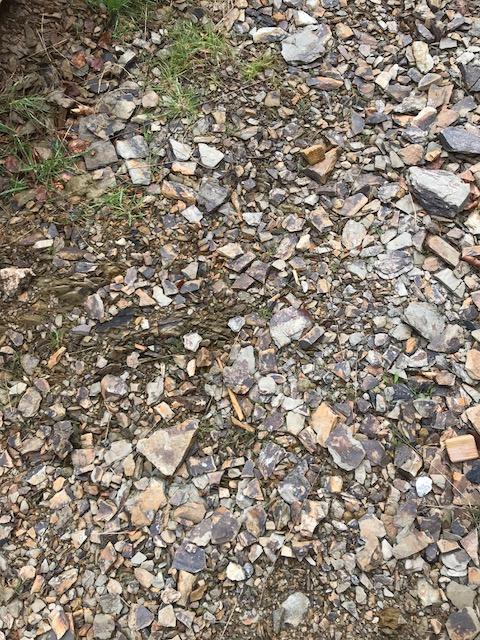

Nestor Posted March 10, 2018 Posted March 10, 2018 (edited) One of the benefits of living in the Dartmoor NP is the geology. Upper Devonian, slates and volcanics. About 250mm of top soil then what the locals call shillet, Its been raining for weeks, roads flooded but just no standing water on site. What Russell has suggested is a good solution, my folks had problems with clay, dug trenches, gravel, perforated pipe and always water draining out. Edited March 10, 2018 by JamesP spellin 1
