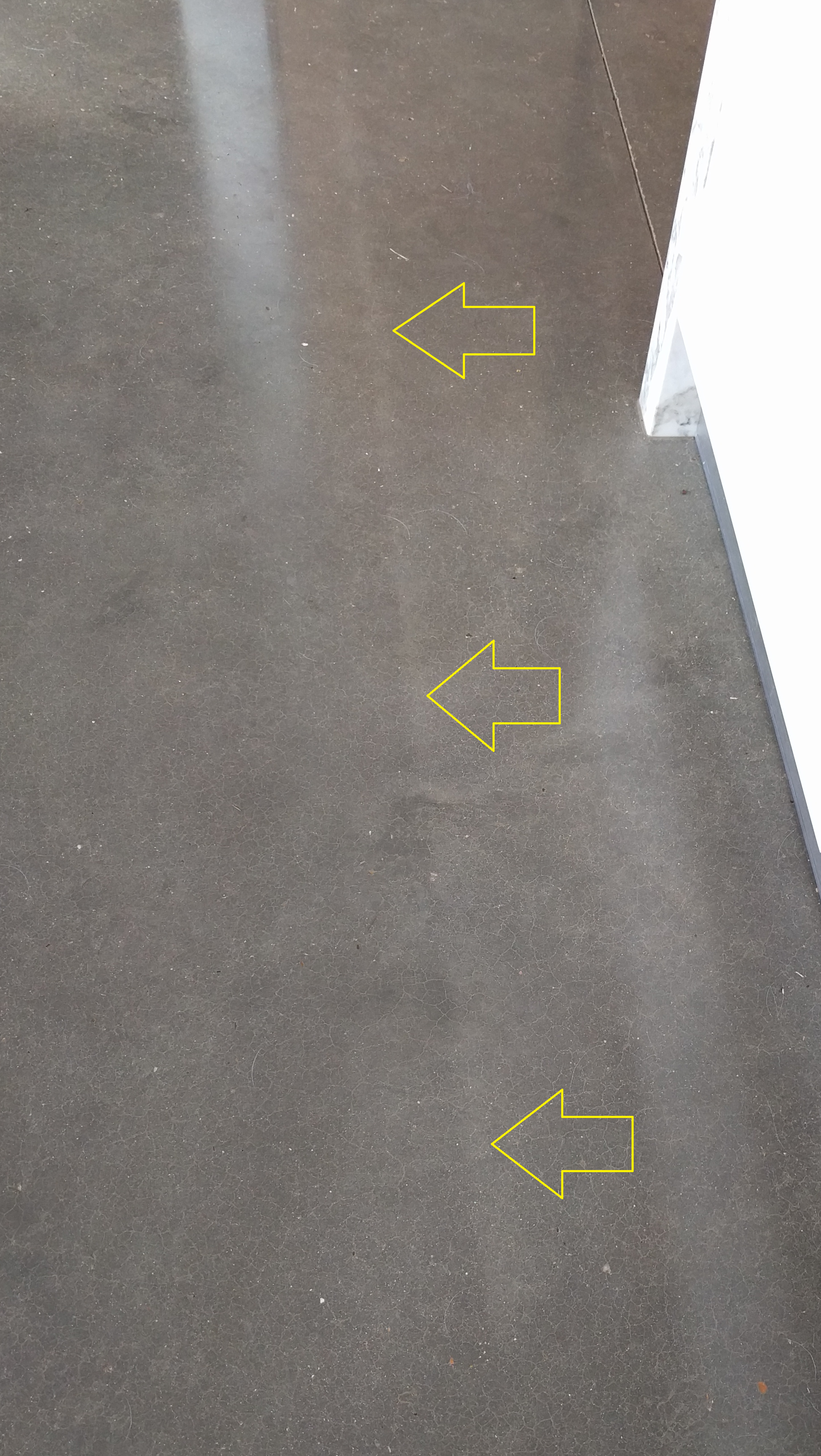

September 8, 201610 yr We used corex to cover our concrete after polishing. It was down for several months before we moved in. One thing to look out for is that you can get different colours appearing where the corex joins and air can get in. We taped all ours, but in a couple of places had to lift it for one reason or another and didn't tape it down again. There are a couple of light linear strips where the untaped join between pieces of corex was. I doubt anyone else would notice the odd line, as there's a lot a variation across the concrete anyway. What you don't want is a grid of lines in the shape of corex sheets! Also, the lines do fade over time. Our concrete's been down for over a year and it's not as noticeable as it appears in the pic above.

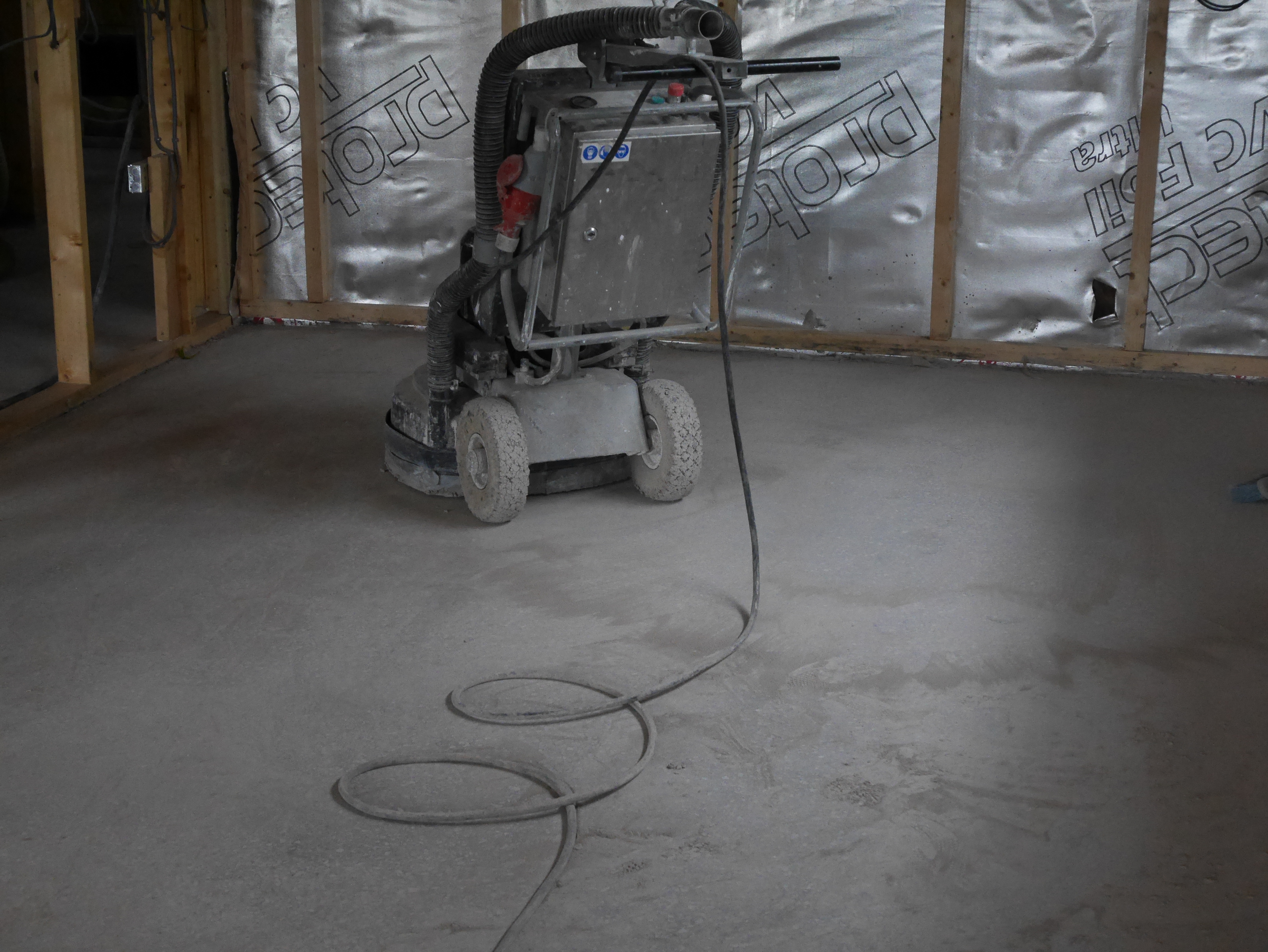

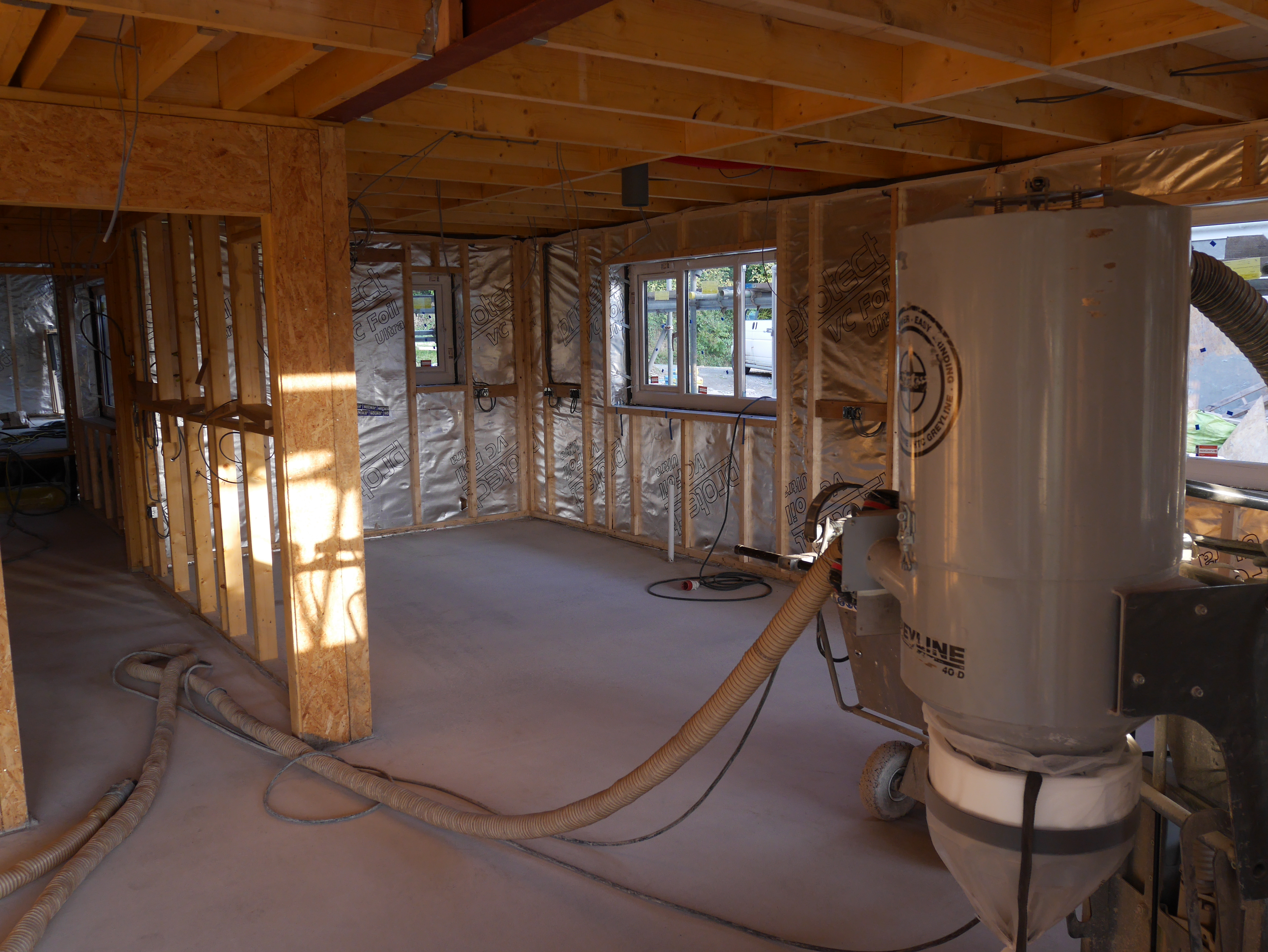

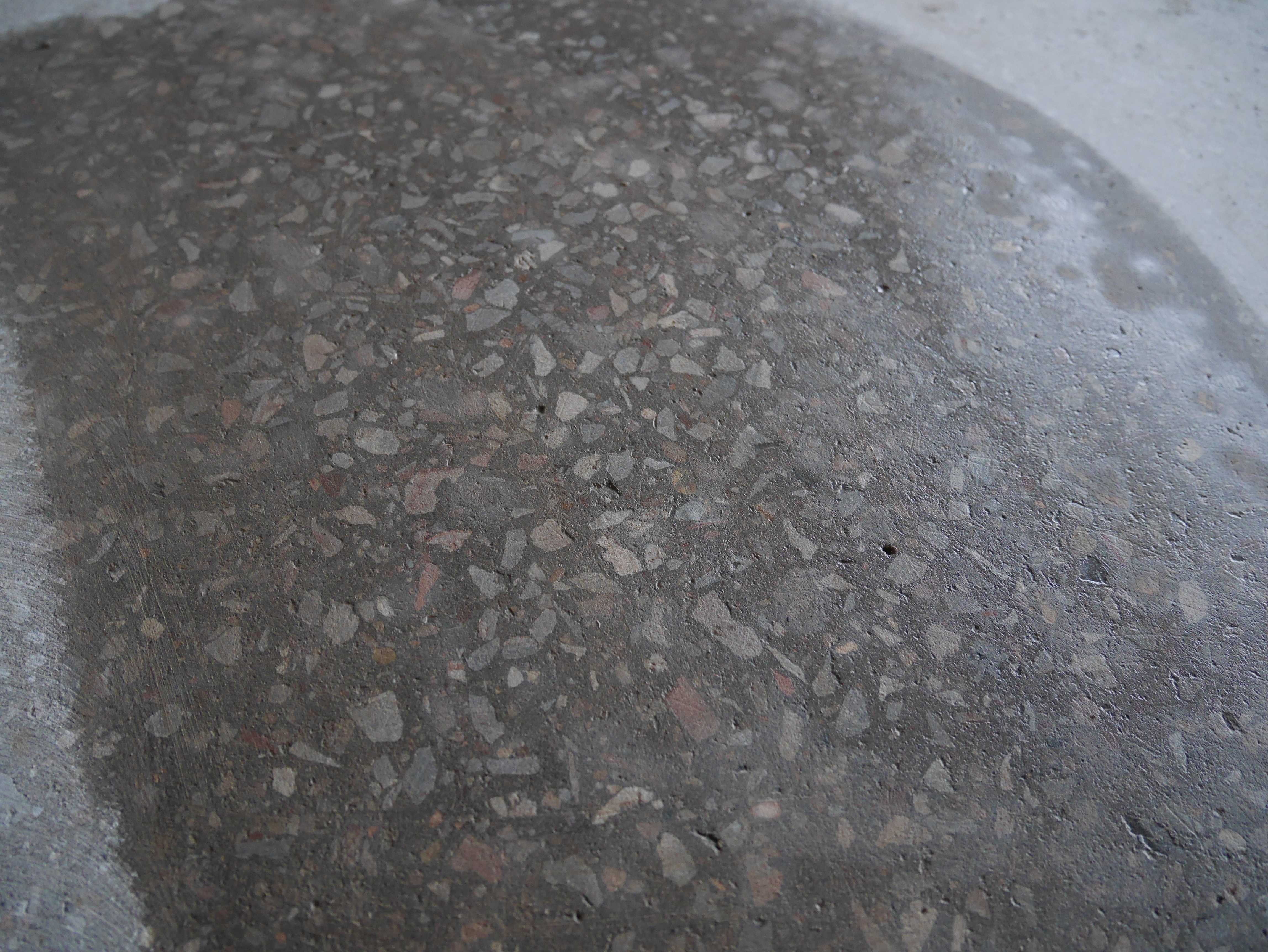

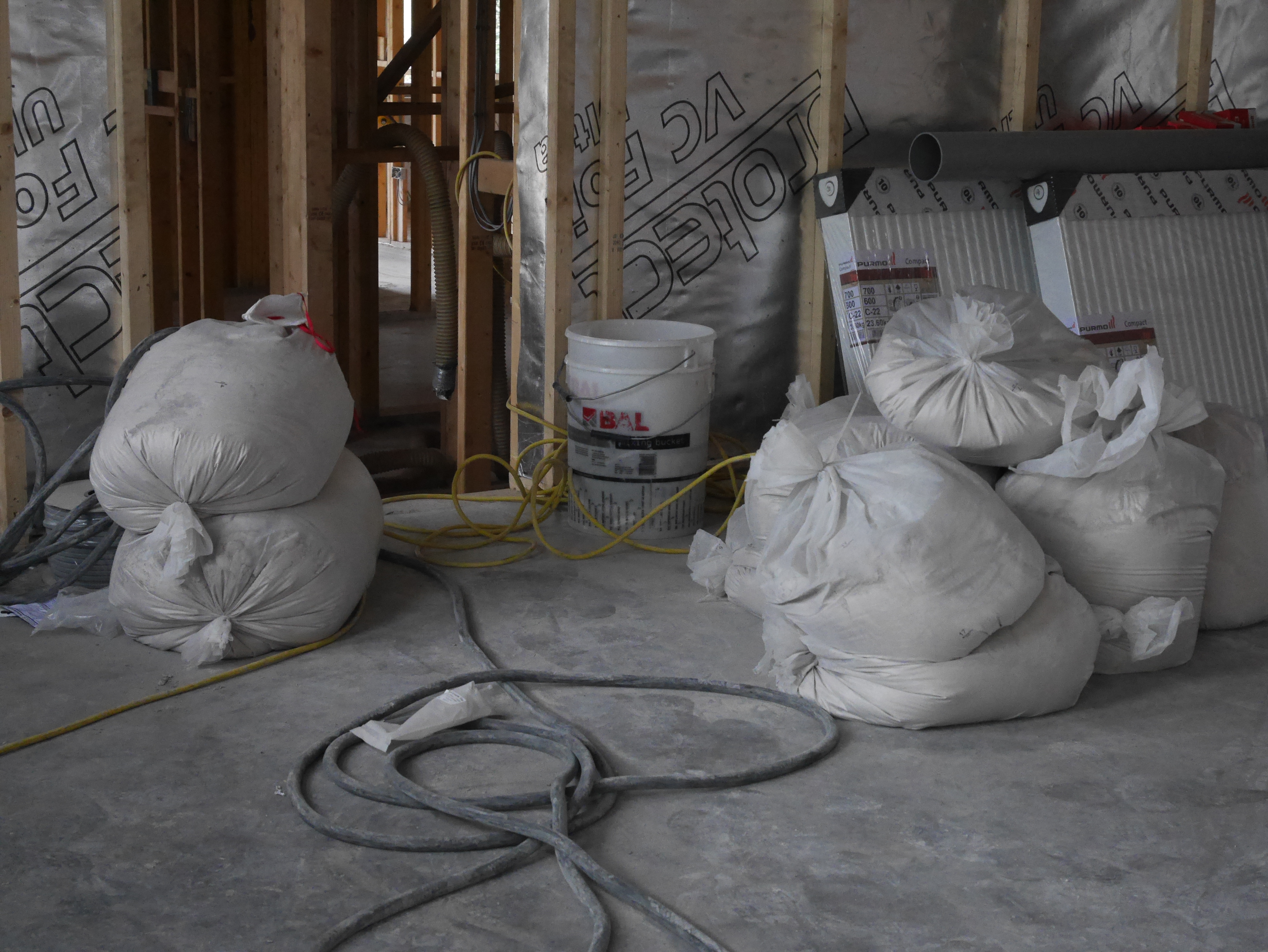

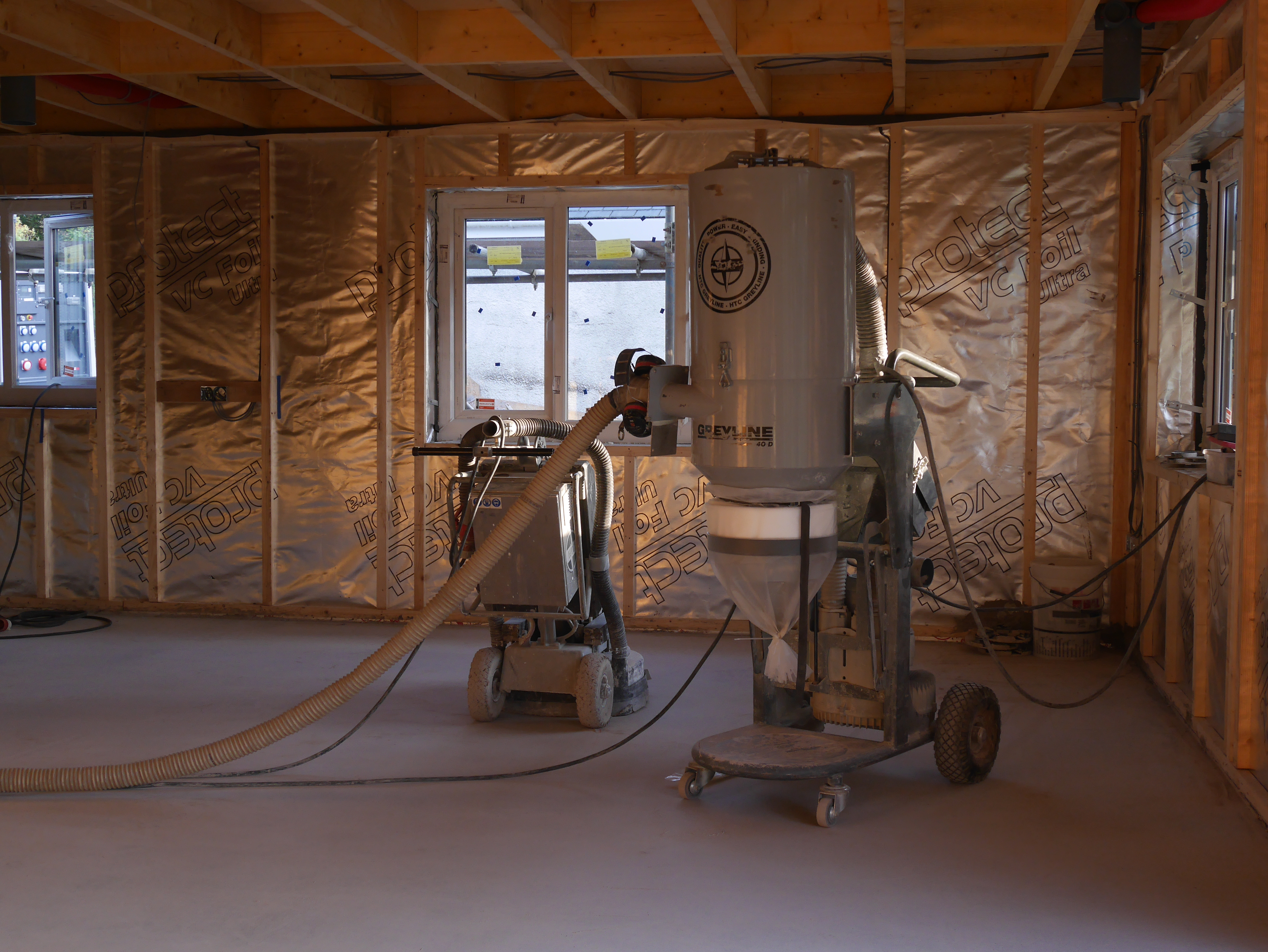

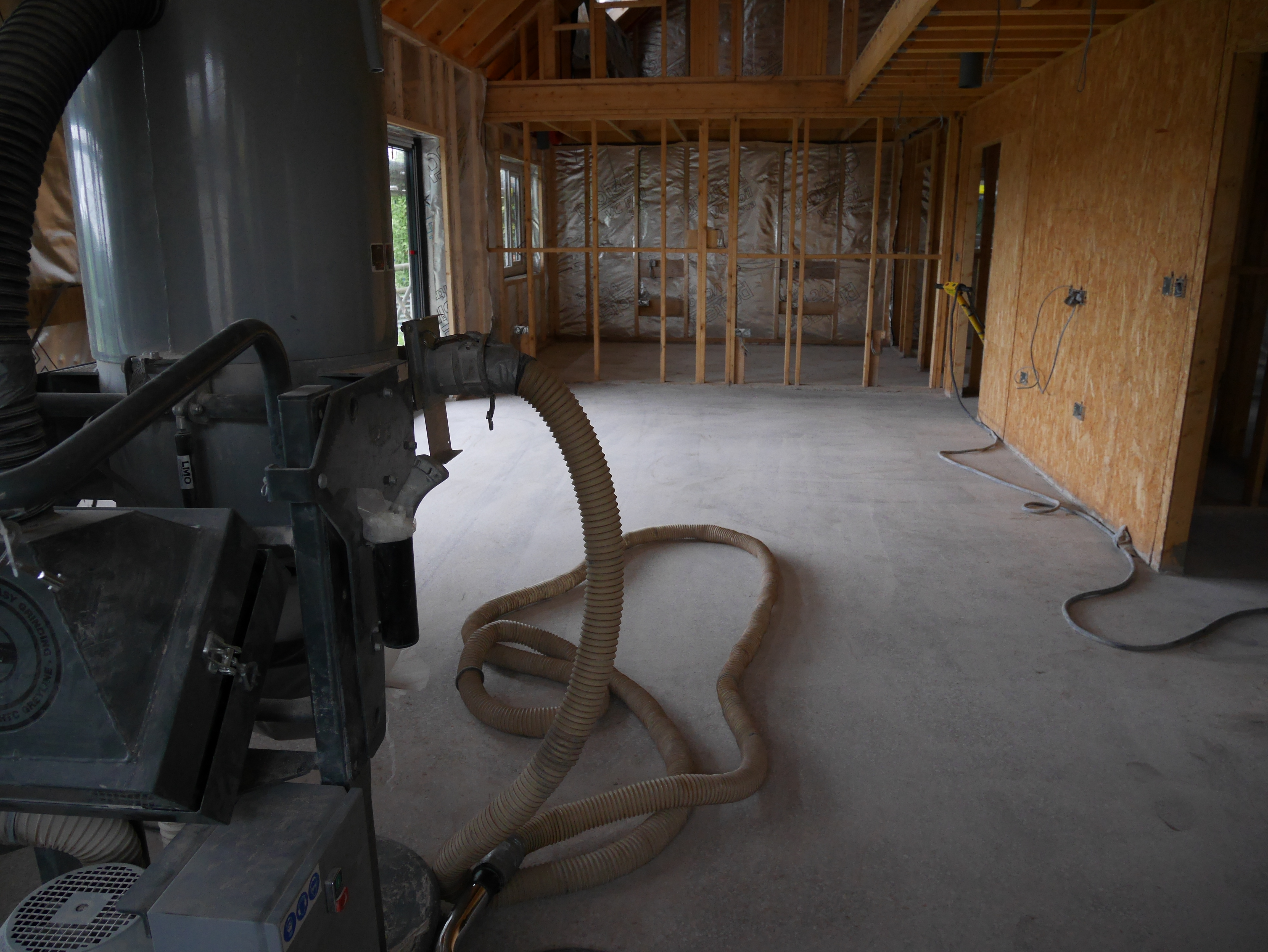

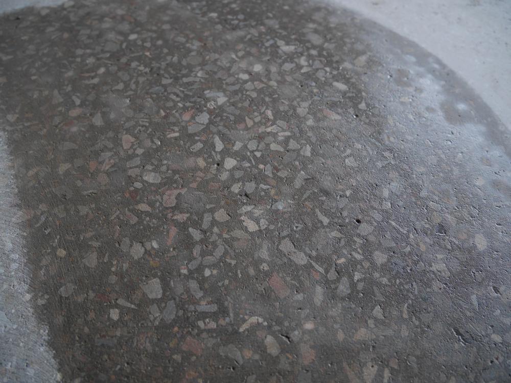

September 10, 201610 yr So 3 days in and apperently its going to take another 4 days minimum, a really hard concrete is proving hard work for the diamond grinders floor keeps needing to be wetted to cool machines 16 grit to 3000 is taking its time some 10 bags of dust so far and hardly making a dent in the concrete, some aggregate showing through and looking good.
September 10, 201610 yr Four weeks seems a long time to wait to do the grinding and polishing on hard concrete. Our guys suggested ten days to ensure it wasn't completely hard, and in the end did it starting on the 8th day if I remember correctly. I'd need to check my notes, but I believe it only took the two of them two days to grind down to "pepper pot" (some aggregate showing randomly in patches, rather than across the entire floor). You're taking quite a bit more than that off, so I guess that's part of what's taking the time. Yours looks a similar shade to ours - very nice!

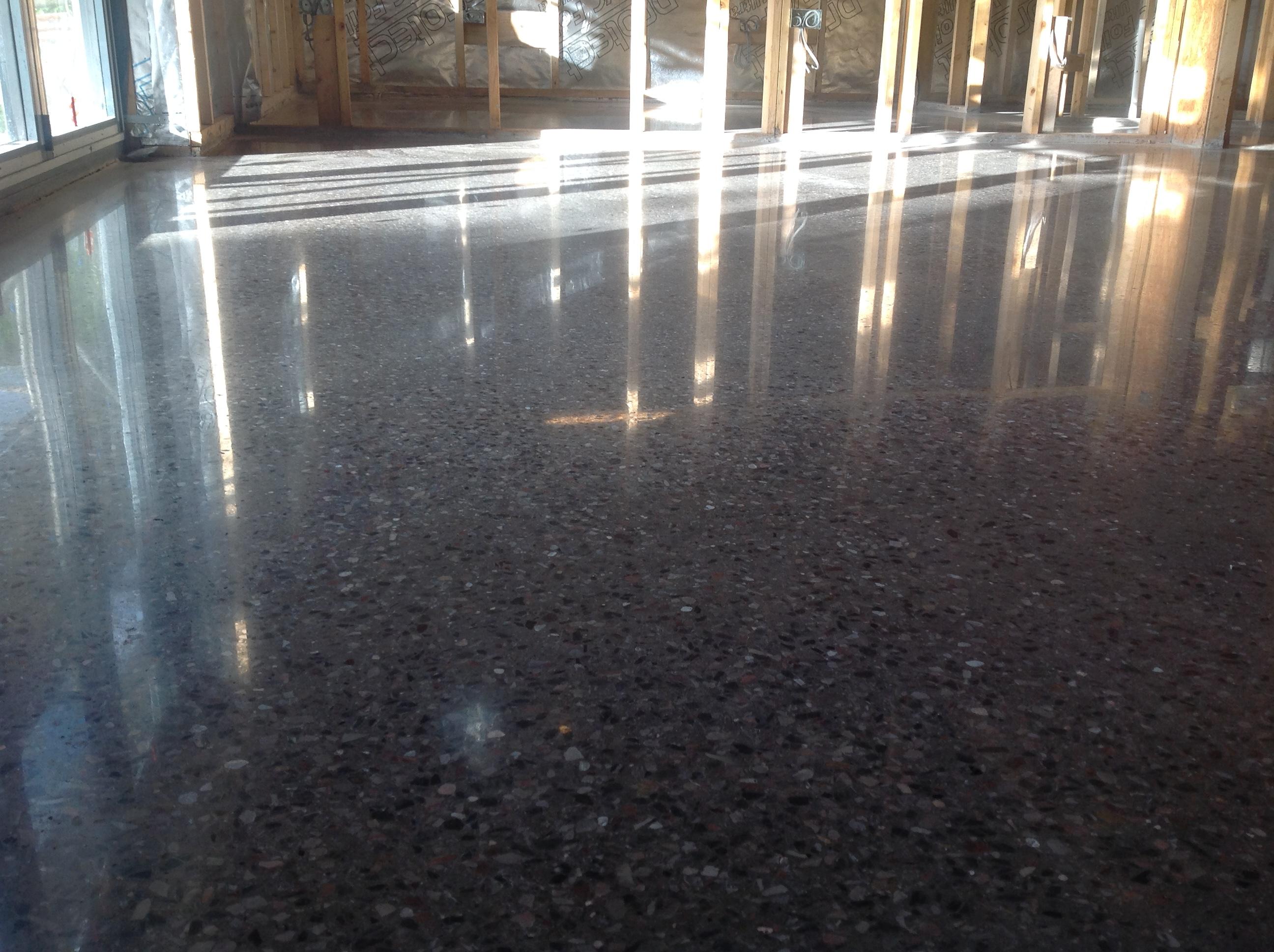

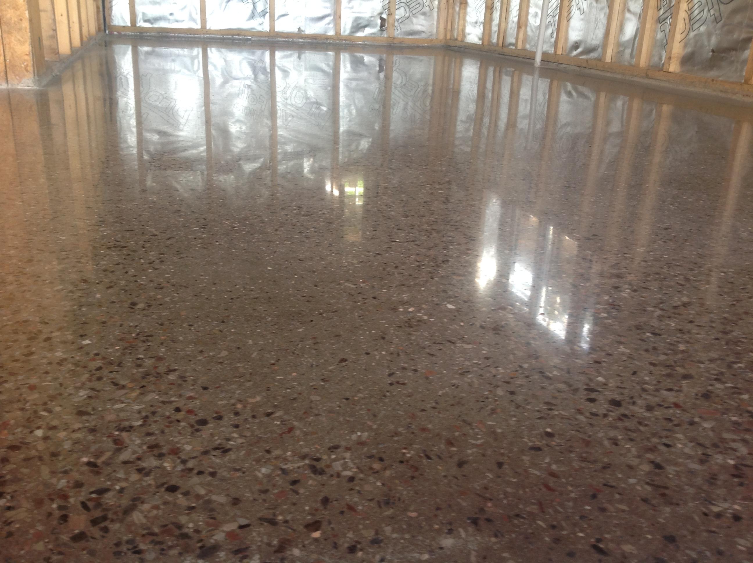

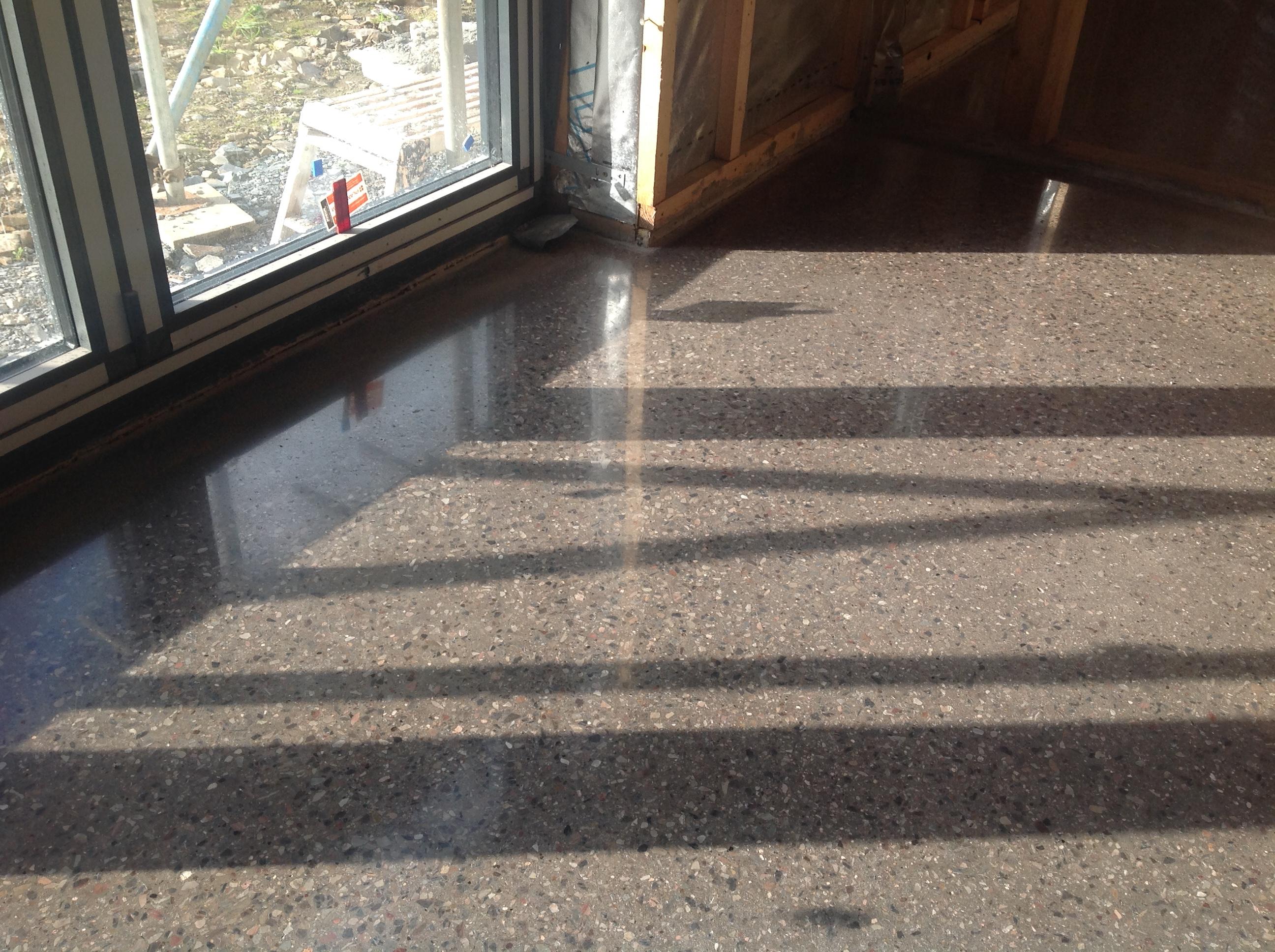

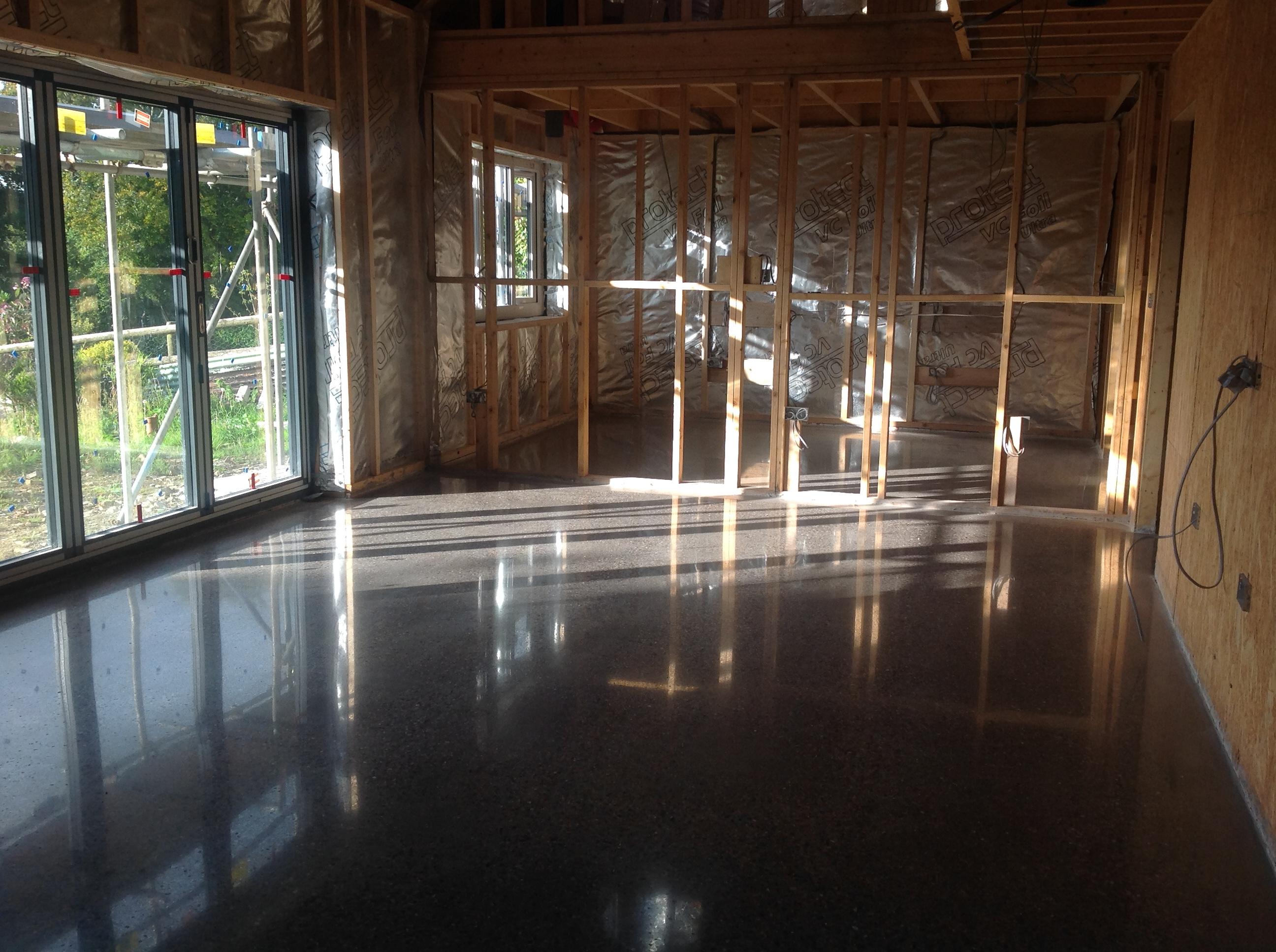

September 14, 201610 yr So main house is polished and sealed took 6 days for the 2 guys, they ended up bringing in 2 machines that weighed a tonne each, through the grits then polished and sealed 100sqm back on Monday to do the garage which isnt aggregate show its a powerfloated finish with a high polished end result.
September 14, 201610 yr Looks great, and the way the light reflects off it just adds interest. We had highly polished tiles (cream coloured) in our last house, and they looked a million dollars when clean, but within half an hour of any activity started to look dirty again. Hopefully the colour of your floor is a bit more forgiving in this regard. One technical question - will you have to reseal the floor at any point in the future, if so have the installers advised when this should be done?

September 14, 201610 yr Thanks guys, very little mainenance maybe a reseal after 2 years if it ever gets heavily scuffed it can be repolished and sealed, just got to keep it covered while boarding and first fixings finish. incredibly skilled proud workers who,did,this job we are really pleased and monday the garage/ family room gets done with a different finish!!!! glad we went for this option as it should last for years.

September 15, 201610 yr 9 hours ago, Vijay said: how do they get into corners? The boss spent 10 hours on Sunday with something that looked like a big angle grinder with diamonds on the pad went around all edges about 7 times.
September 15, 201610 yr I think you've gotten very lucky with these guys. Definitely a better finish than we got, especially in the corners and around the edges.
September 15, 201610 yr it looks great, now you'll become obsessed with protecting it while the rest of the build progresses.

October 5, 201610 yr On 03/10/2016 at 18:31, Alexphd1 said: wow, looks awesome! Do you know the spec of the concrete? We are using c25/30 in our slab. The guys wanted c32 when they came to polish they reckon it was nearer c40 said great for us a so hard wearing not so great for them 7 days grinding. !!!
October 5, 201610 yr On 03/10/2016 at 19:57, mafaldina said: That looks really great, well done. Also, thanks for the pictorial diary. What did it come to per m2 in the end? Roughly £90 per sq m including steel reenforcing throughout, comcrete pour grind and burnish, seal.
