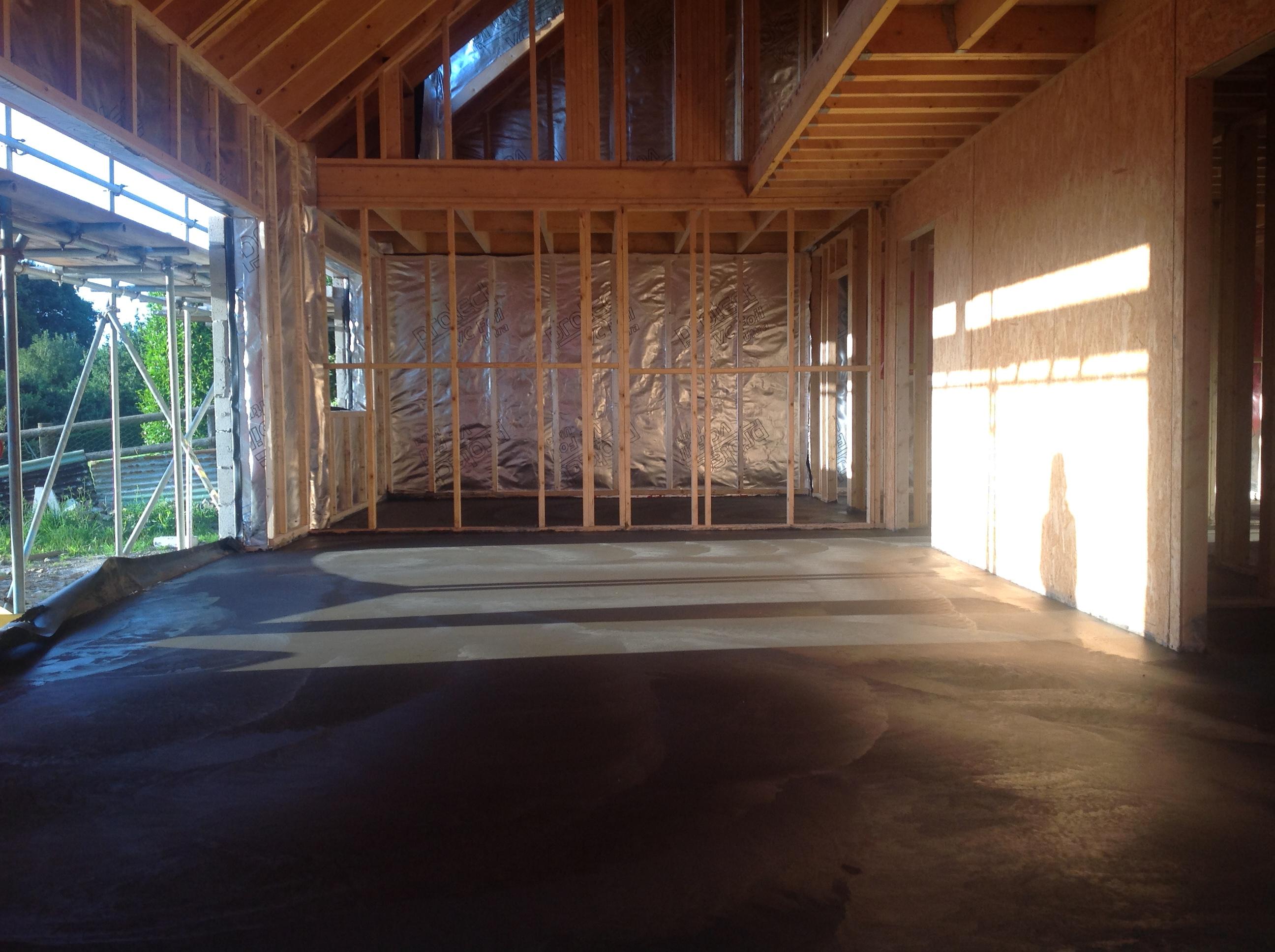

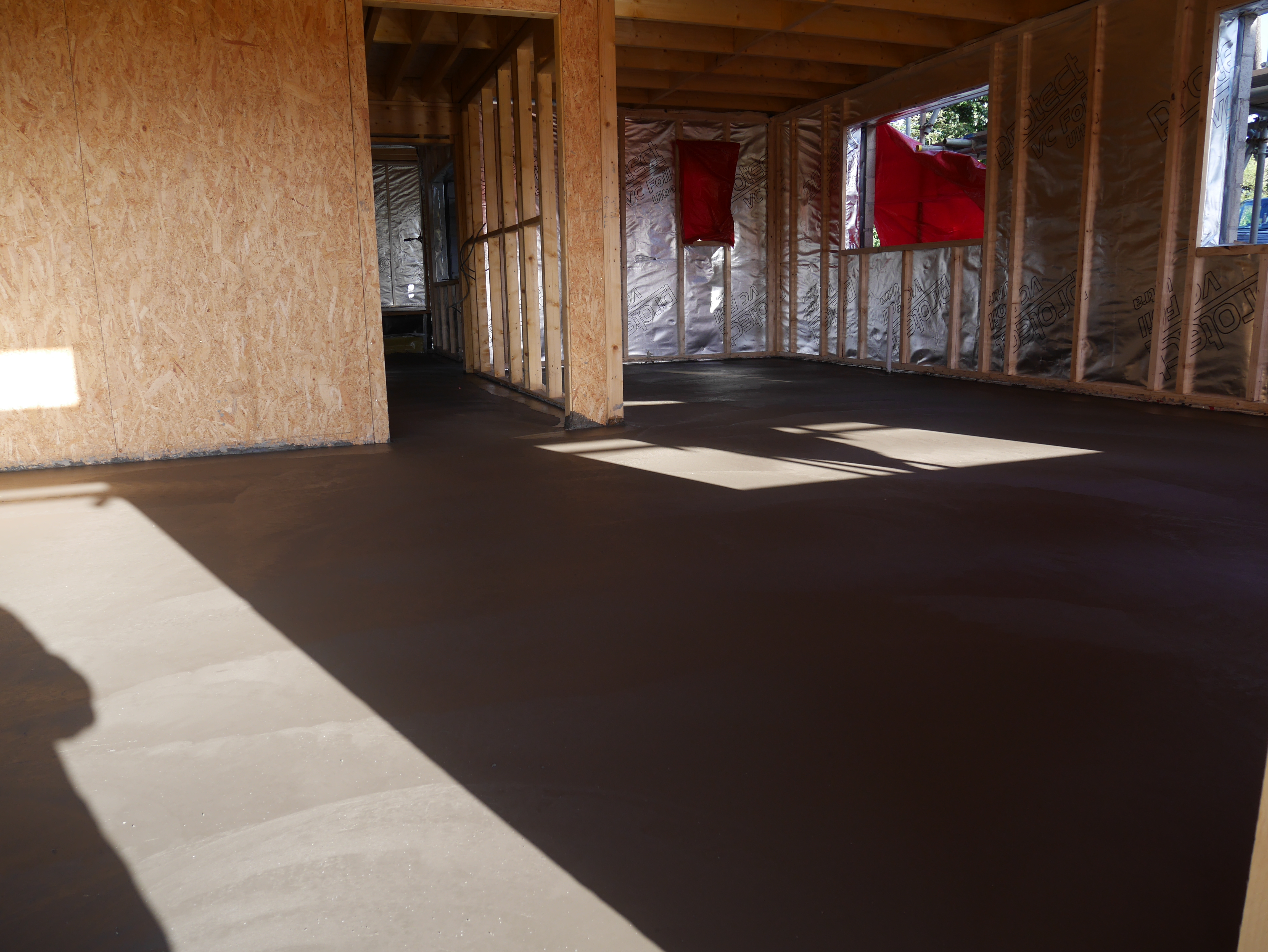

  • So main house is polished and sealed took 6 days for the 2 guys, they ended up bringing in 2 machines that weighed a tonne each, through the grits then polished and sealed 100sqm back on Monday to do

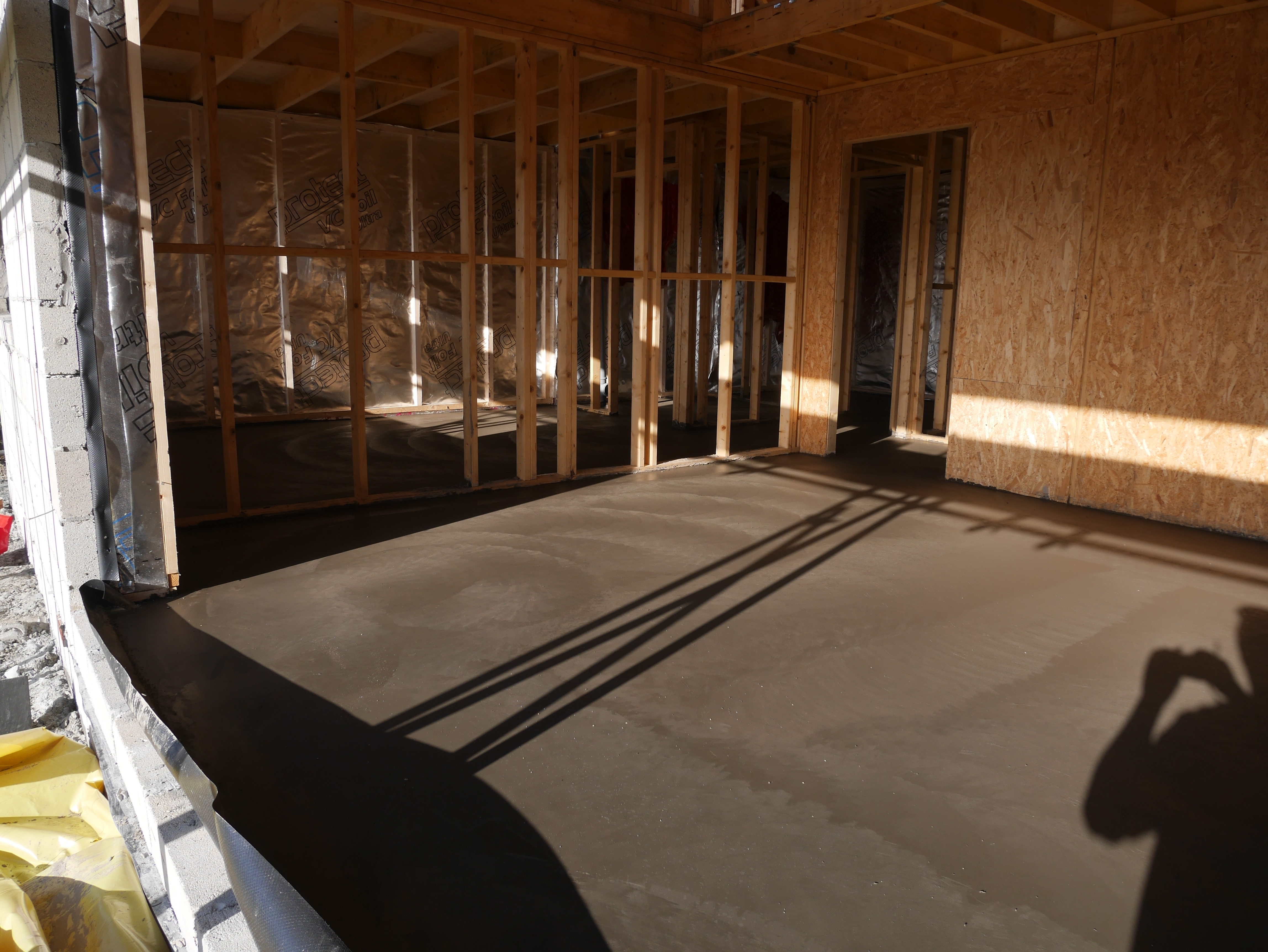

  • As requested from 7.30 this morning 4 concrete guys arrived installed mesh on chairs, 9am pump arrived, 10 am first load of concrete arrived one hour later second lorry, then we ran out oops 32 tonnes

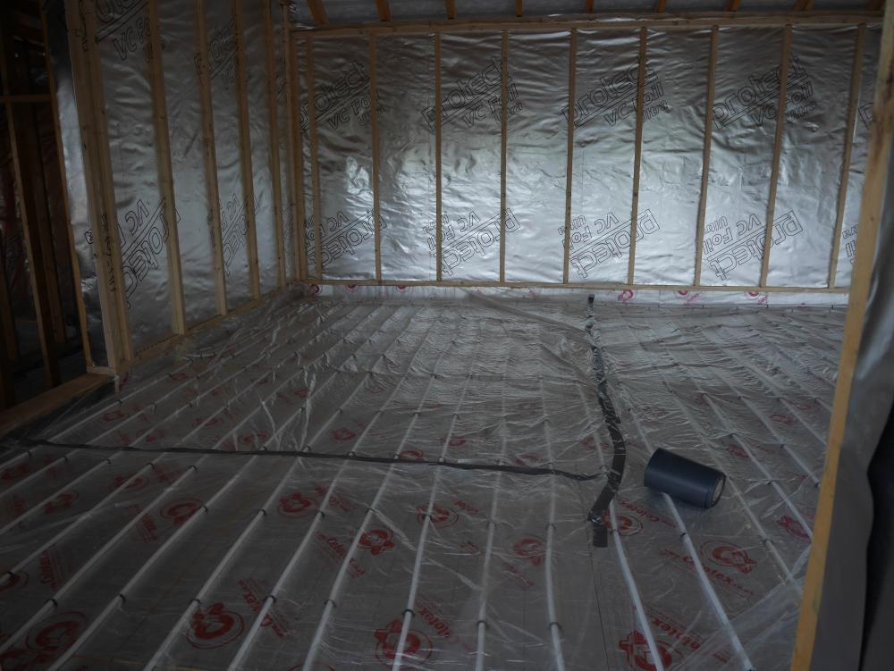

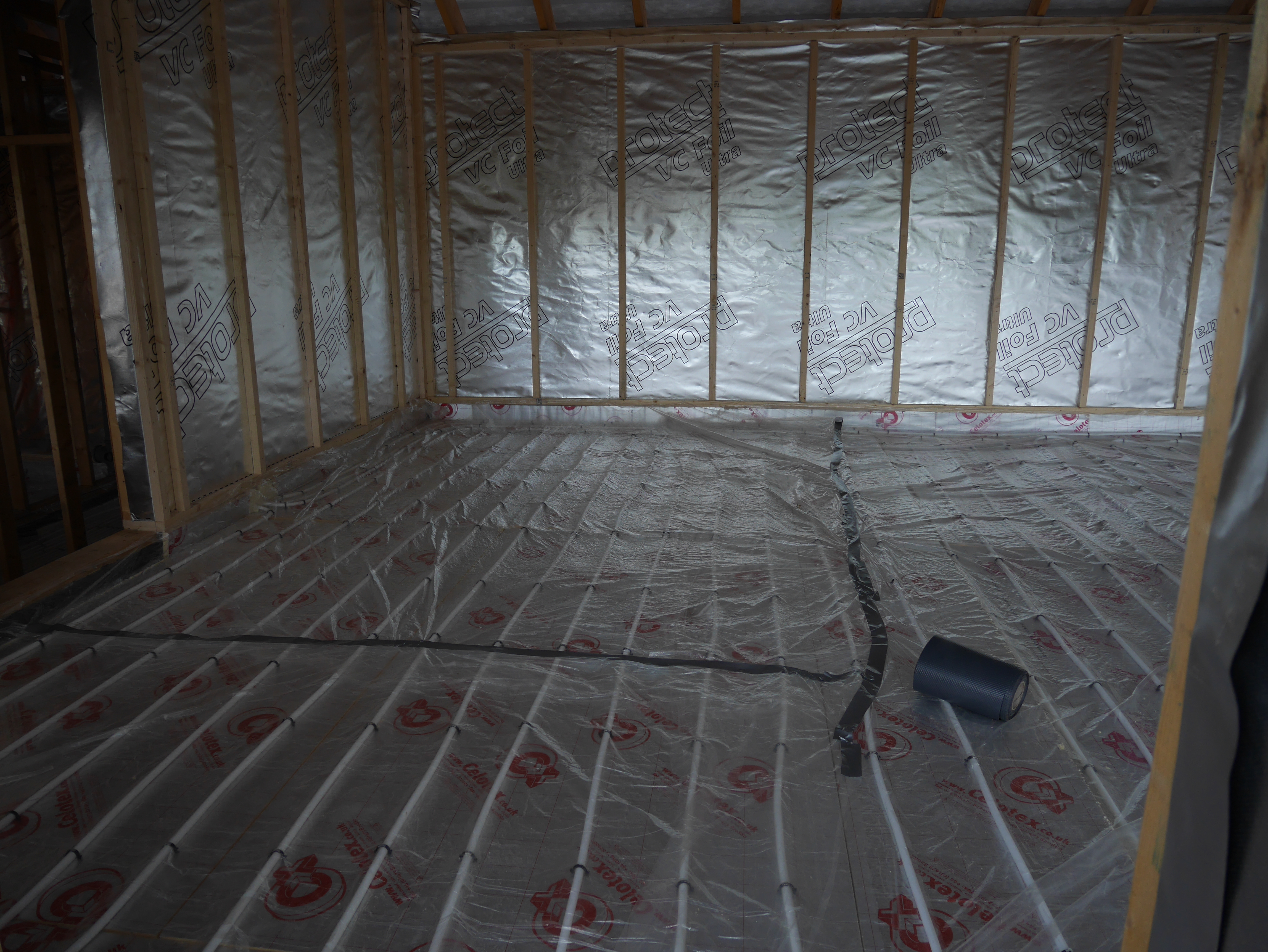

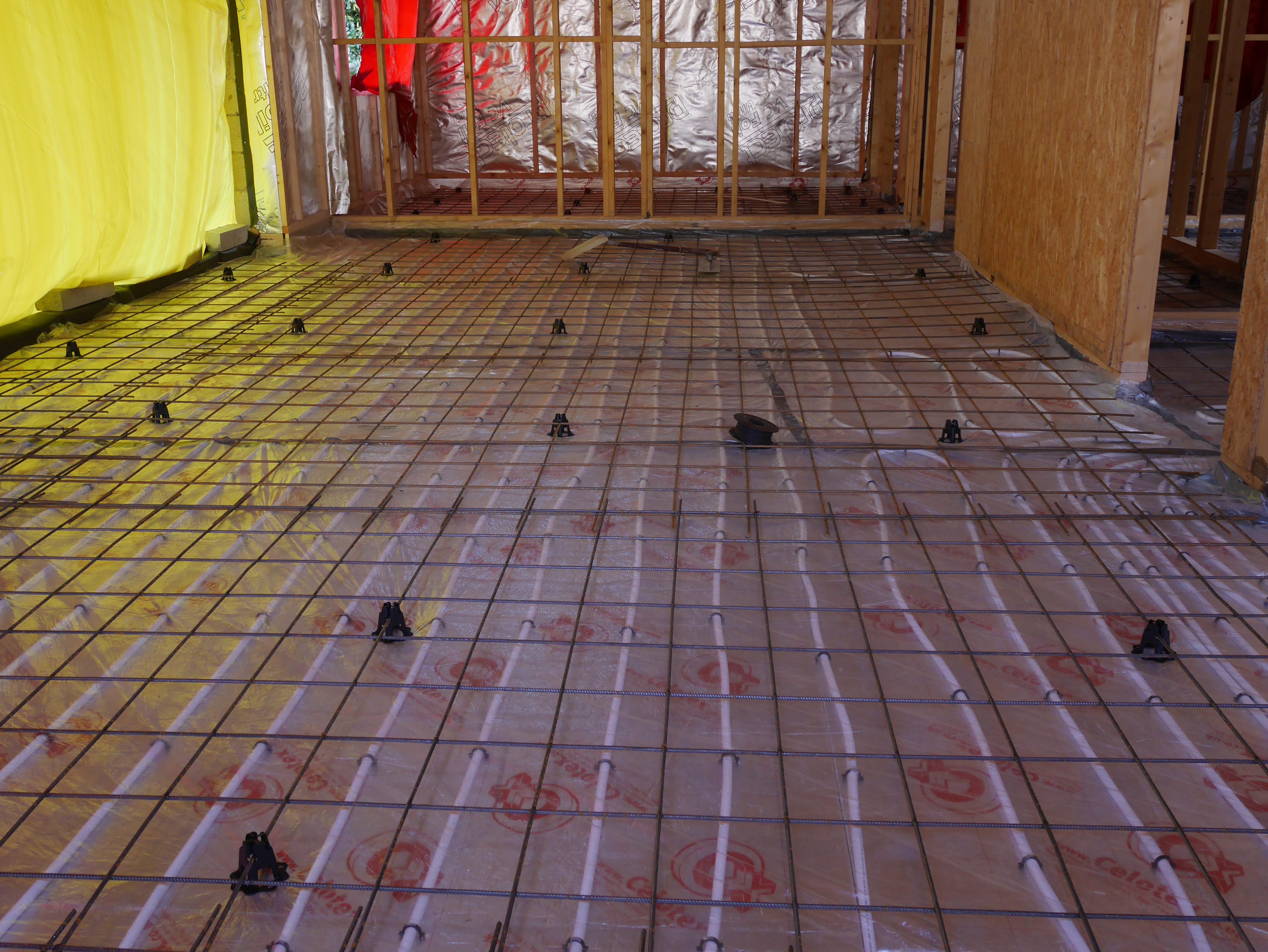

Yes im looking at 100 mm celotex then ufh it has been suggested to me to put a layer of polythene over celotex prior to clipping in ufh pipes, this would help as well as your hoovering idea.
Is structural slab a reinforced slab?  im pretty clueless and learning as i go but i certainly like the look of the finished product.
A structural slab is load bearing and would therefore include reinforcing of some kind (steel mesh or fibres etc), and the load bearing external and internal walls are supported by it. The Insulation underneath it therefore needs a similarly load bearing capability,
Your Celotex is not loadbearing, so it and the concrete on top will not go under the load bearing walls, it will go between the walls.
This means it is likely that that there will be cold-bridging from walls to sub-floor as they won't be isolated from the sub-floor by the insulation.
Your UFH will have to work a little harder to replace the heat lost through the walls to the sub-floor. You're likely to be mitigating this with an upstand of insulation between edge of newly poured concrete and the walls, but you are generally limited in how thick this can be.
An insulated structural raft fully isolates the UFH from the cold sub-floor, so can generally be left on 24/7 at a very low temperature, maintaining a constant house temperature. Depending on your overall insulation levels and airtightness so may need a higher temperature on the UFH due to losses. That higher temperature and the use pattern of the house may mean it is not economic to leave the UFH on 24/7. Depending on those temperature swings will decide on whether 100mm thick of concrete around your UFH slows the perception of its response time down.
It will likely still be OK. But it's no longer the certainty of my original comment.

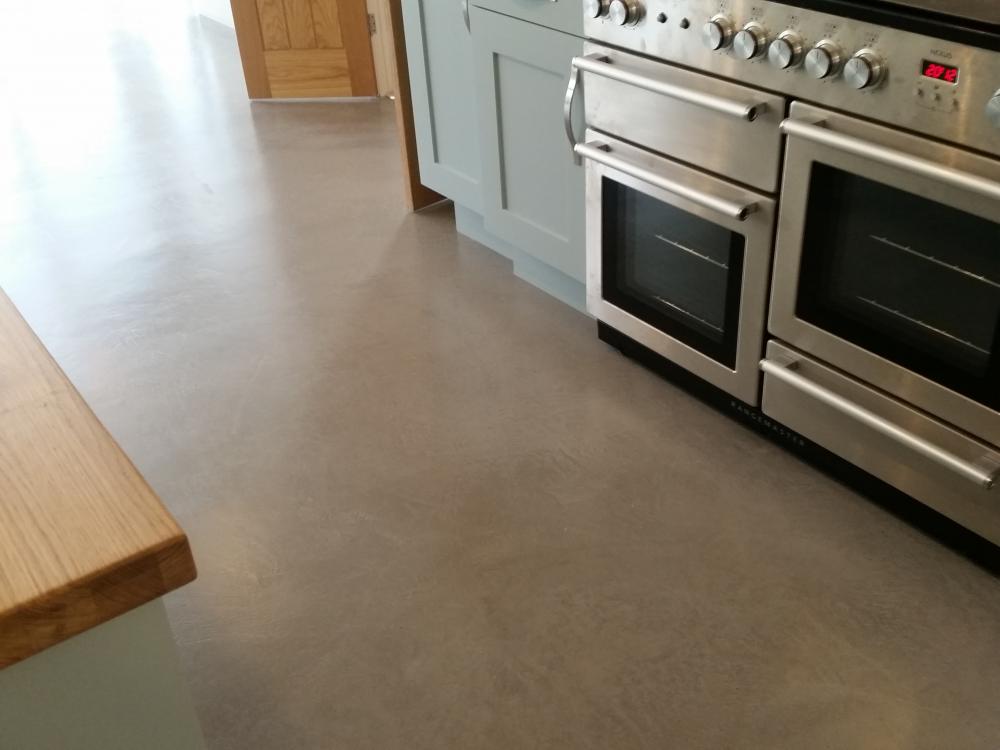

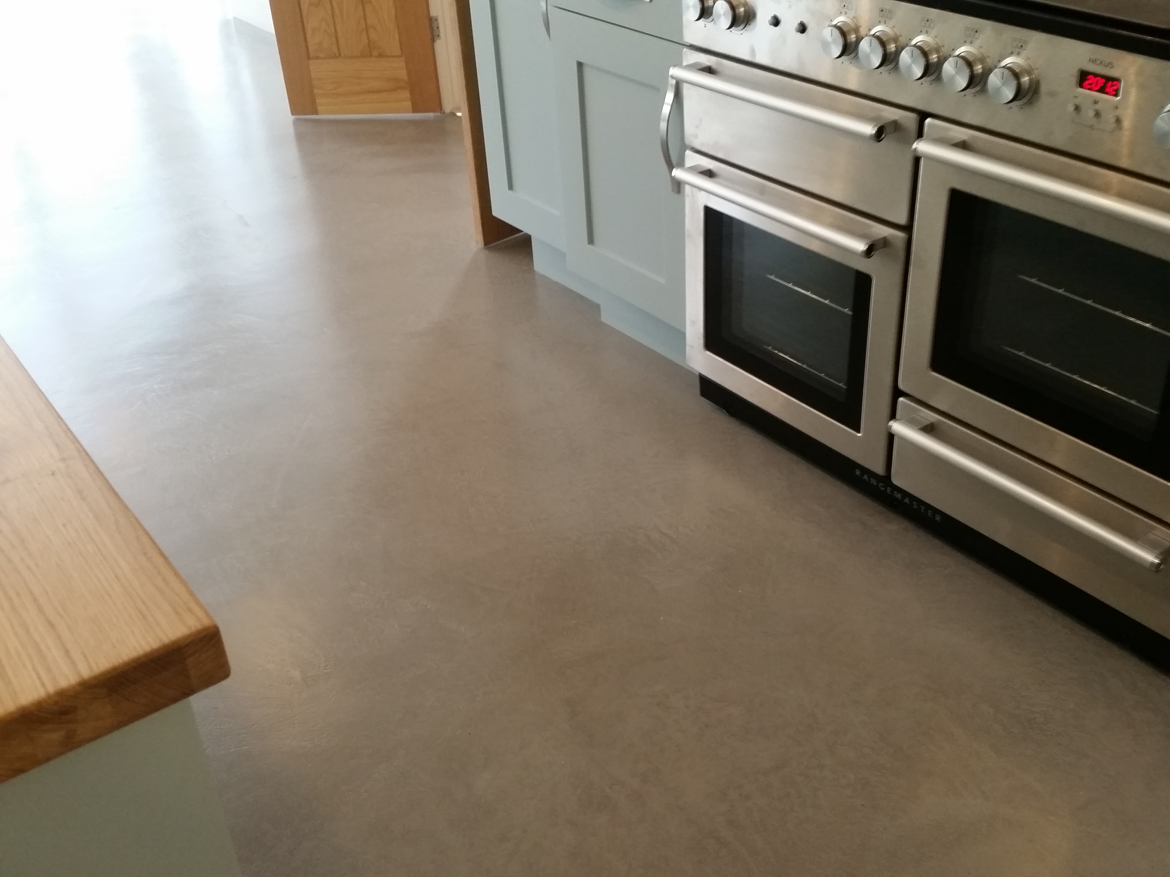

So our floor was cleaned sealed and waxed today, the below is the end result.
Its great underfoot, and really easy to clean with no grout or anything to scrub at.
@Mikey_1980 Very nice floor!
Looks very consistent, Is it as good as it looks all over?
@Mikey_1980, looks brilliant.

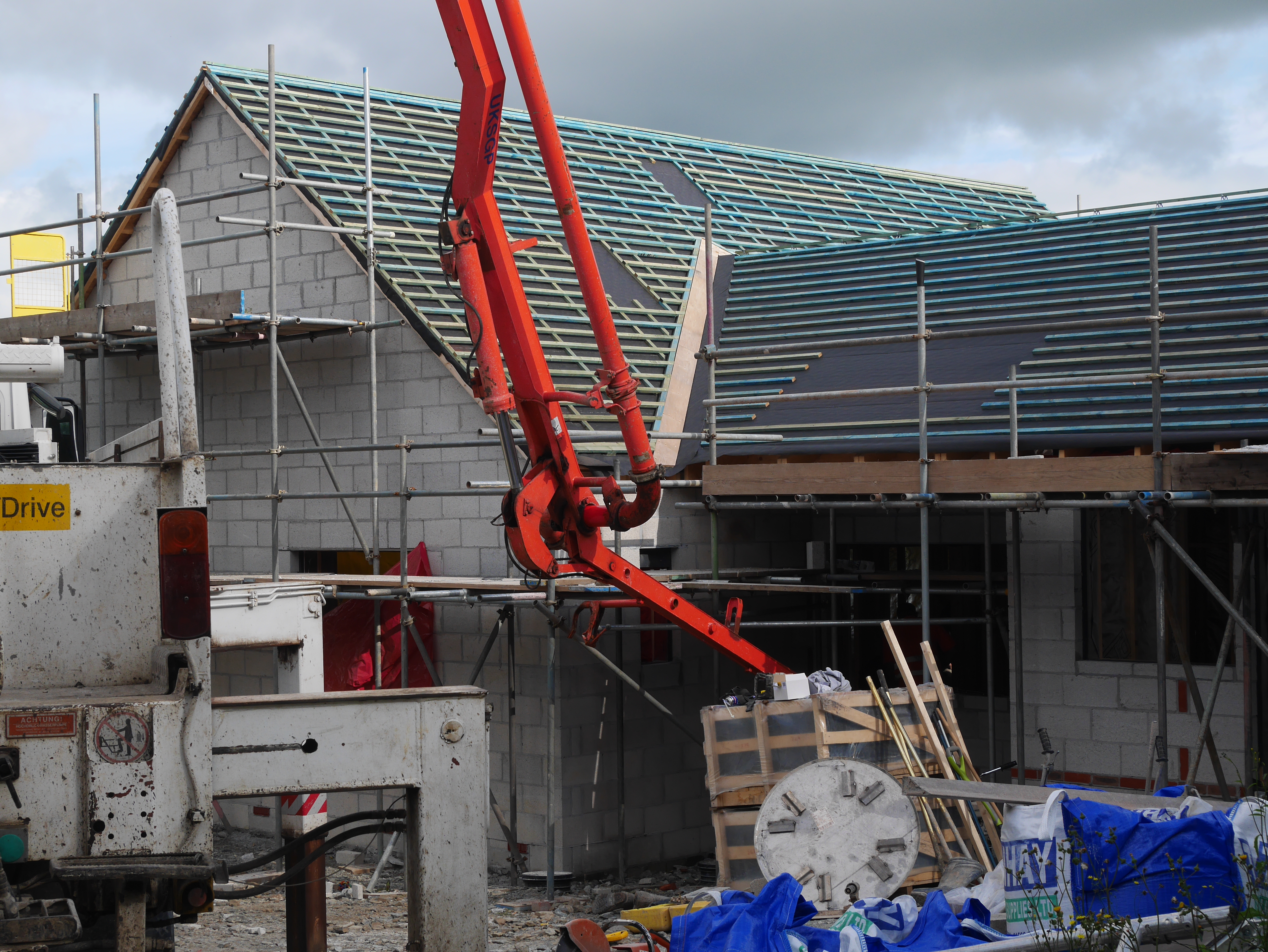

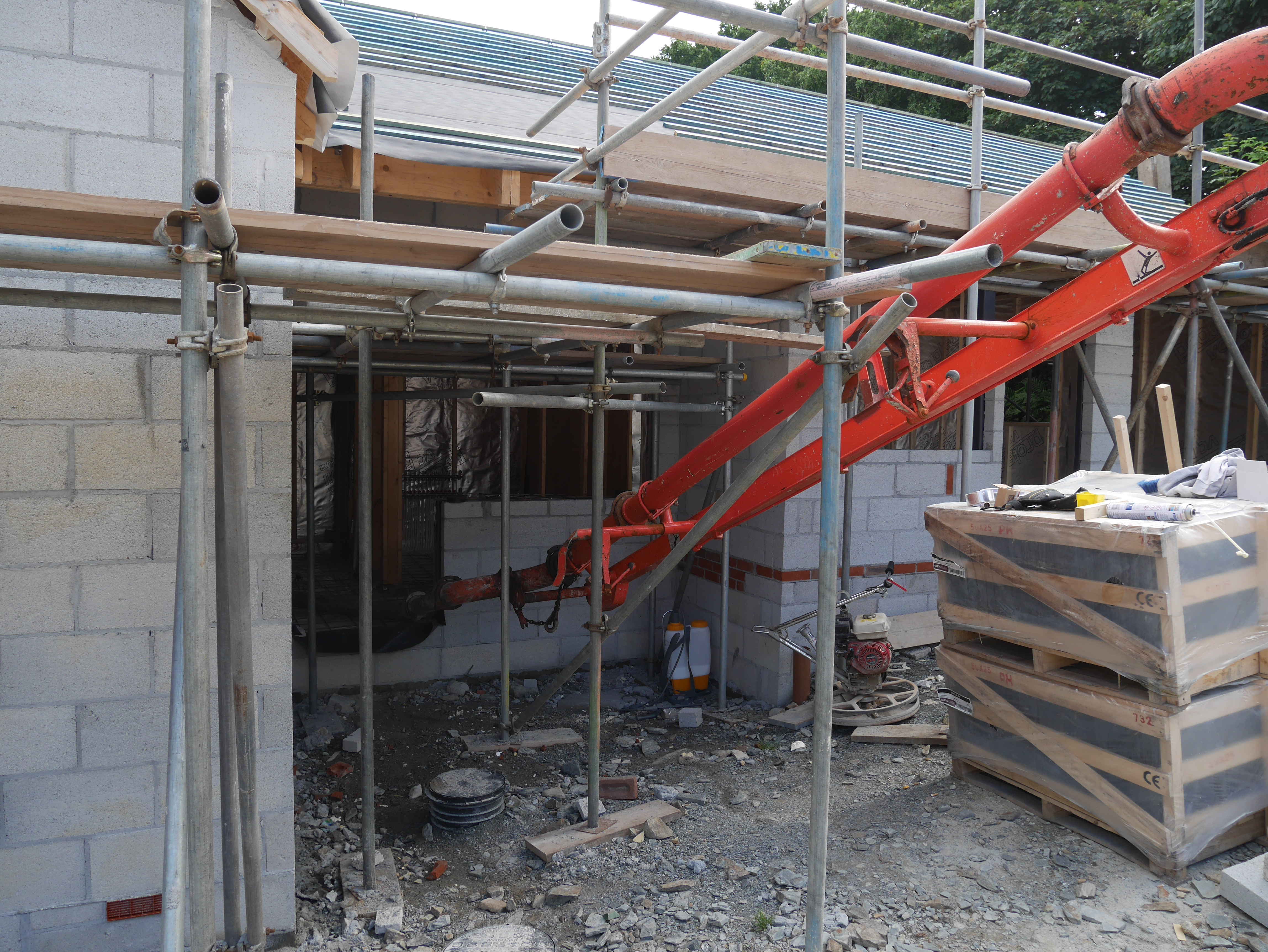

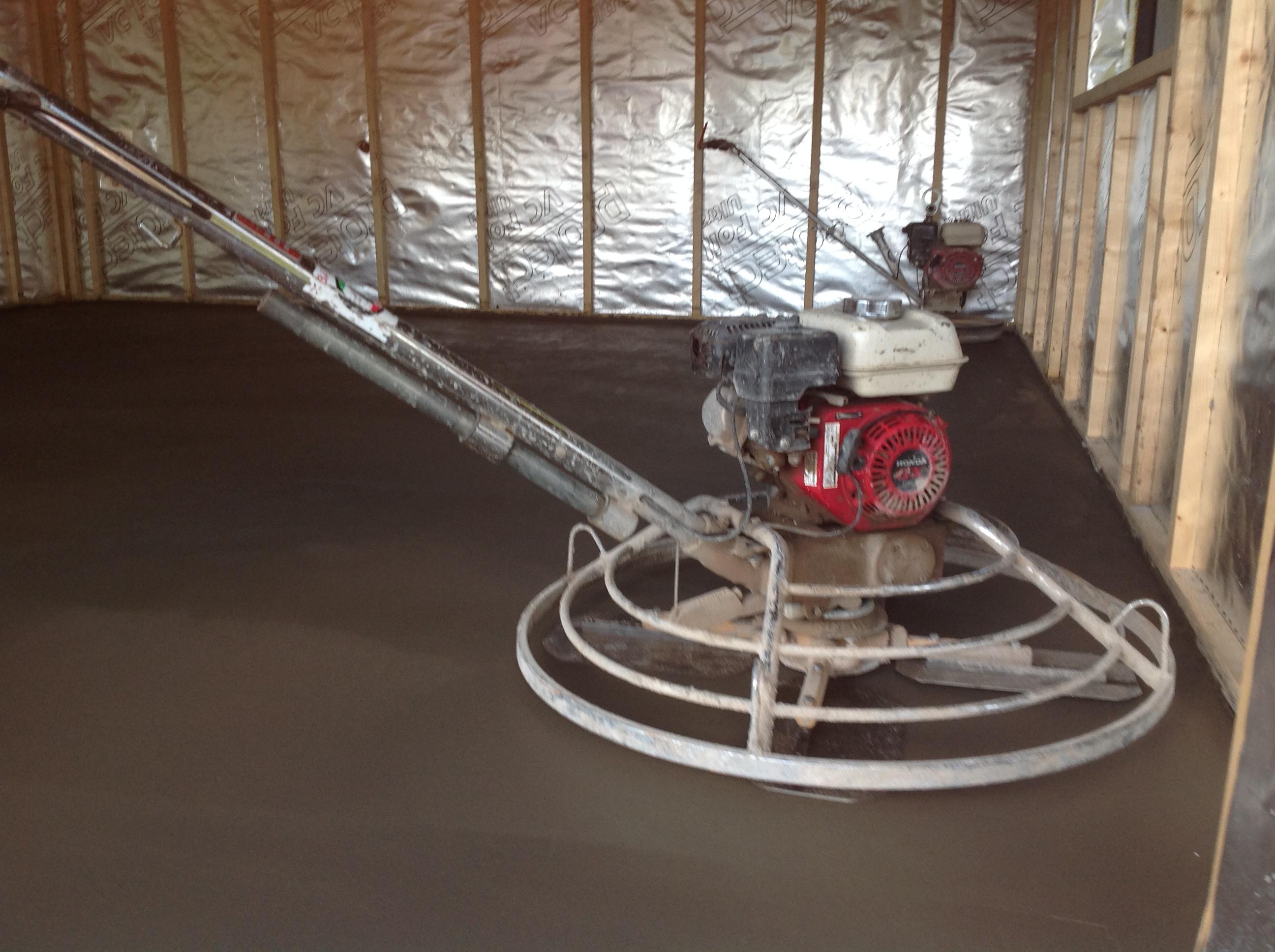

Have just had 40 tonnes of concrete poured, guys are panning and power floating as we speak they reckon they will be here until 10pm!!
As requested from 7.30 this morning 4 concrete guys arrived installed mesh on chairs, 9am pump arrived, 10 am first load of concrete arrived one hour later second lorry, then we ran out oops 32 tonnes not enough quick call and another load. Levelled then left for 4 hours before panning then blading and power floating main house being polished to an aggregate show so 4 mm will be ground off, before polishing, the workshop area will be powerfloated with only poloshing no aggreagate show so the guys are still working on that area just took the pics now should look like glass before they finish.
Polishers come in 4 weeks today cant wait.

Floor polishing started today the guys bought a genarator the size of a caravan, looking forward to the result in 3 days !!!!
