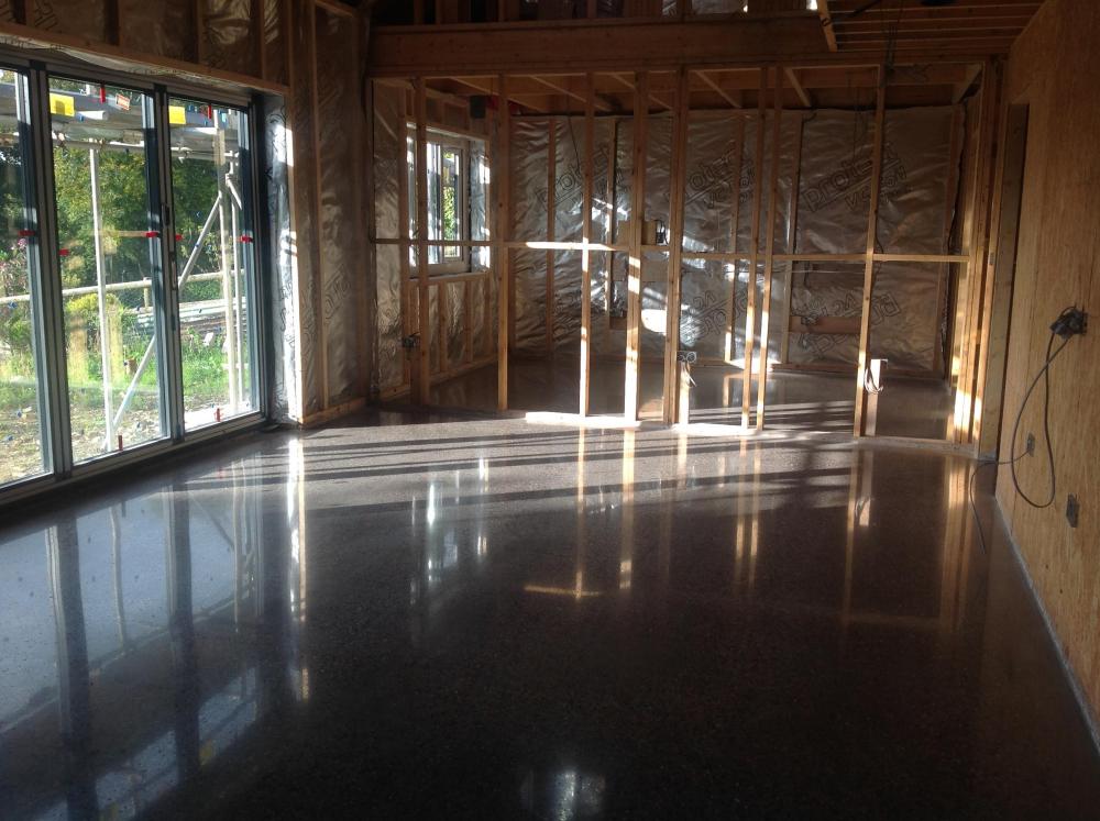

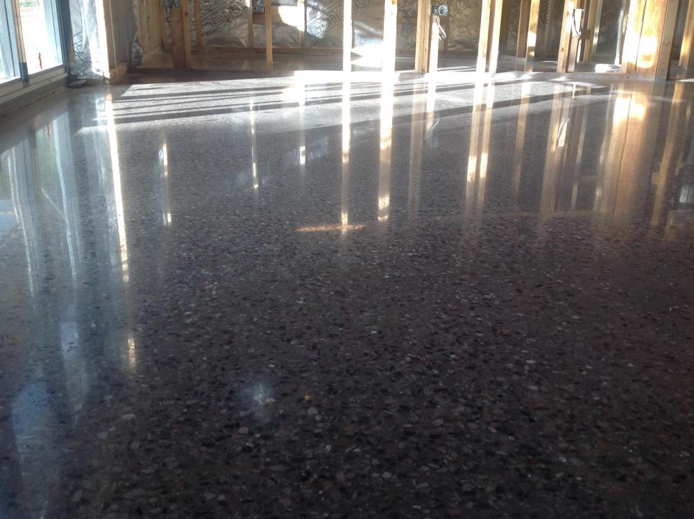

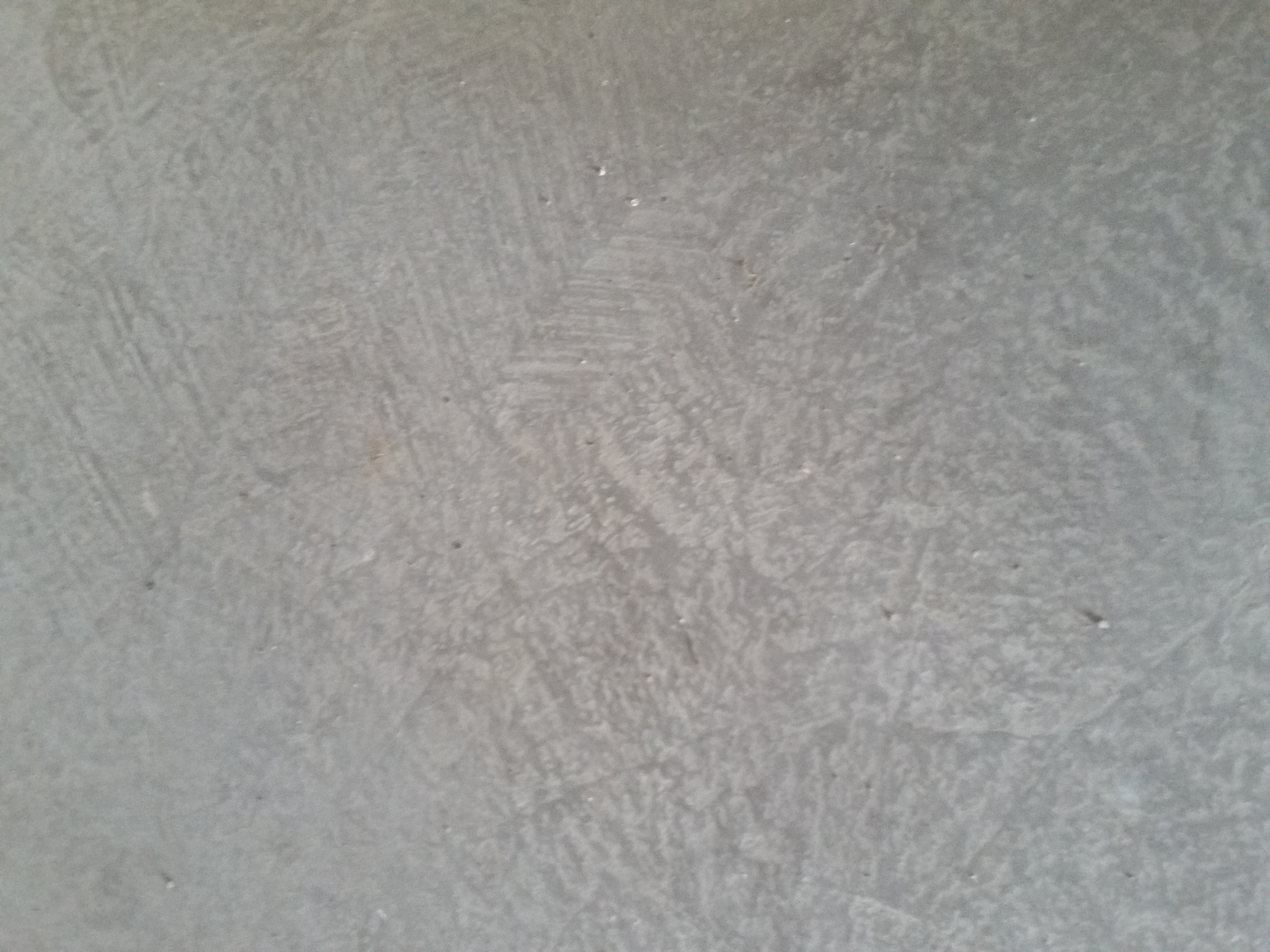

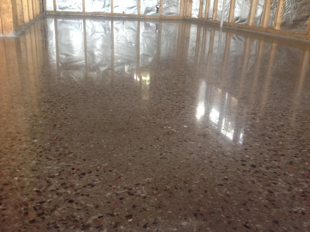

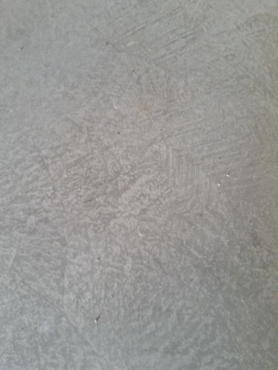

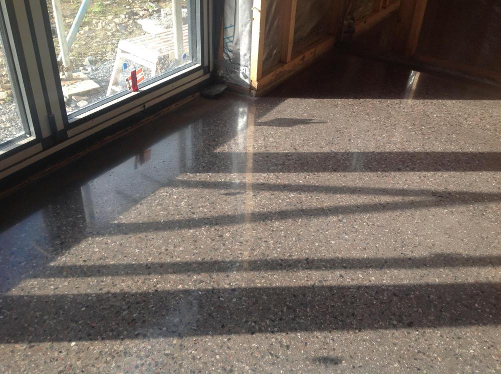

Mikey_1980 Posted June 25, 2016 Posted June 25, 2016 We have a polished concrete floor on our passive slab from designs in resin, and it looks great, when I have given it a clean I will post a picture, its approximately 4-5mm thick is troweled on in layers and then polished and sealed and then waxed. It is concrete based so hard wearing it has been down for 8 weeks while people have been doing internal works and aren't very careful but there is no damage sustained.

ToughButterCup Posted June 25, 2016 Posted June 25, 2016 On 25/06/2016 at 10:42, Mikey_1980 said: We have a polished concrete floor on our passive slab from designs in resin, and it looks great, when I have given it a clean I will post a picture, its approximately 4-5mm thick is troweled on in layers and then polished and sealed and then waxed. It is concrete based so hard wearing it has been down for 8 weeks while people have been doing internal works and aren't very careful but there is no damage sustained. Expand Thanks Mike. We look forward to your photos.
