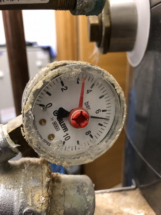

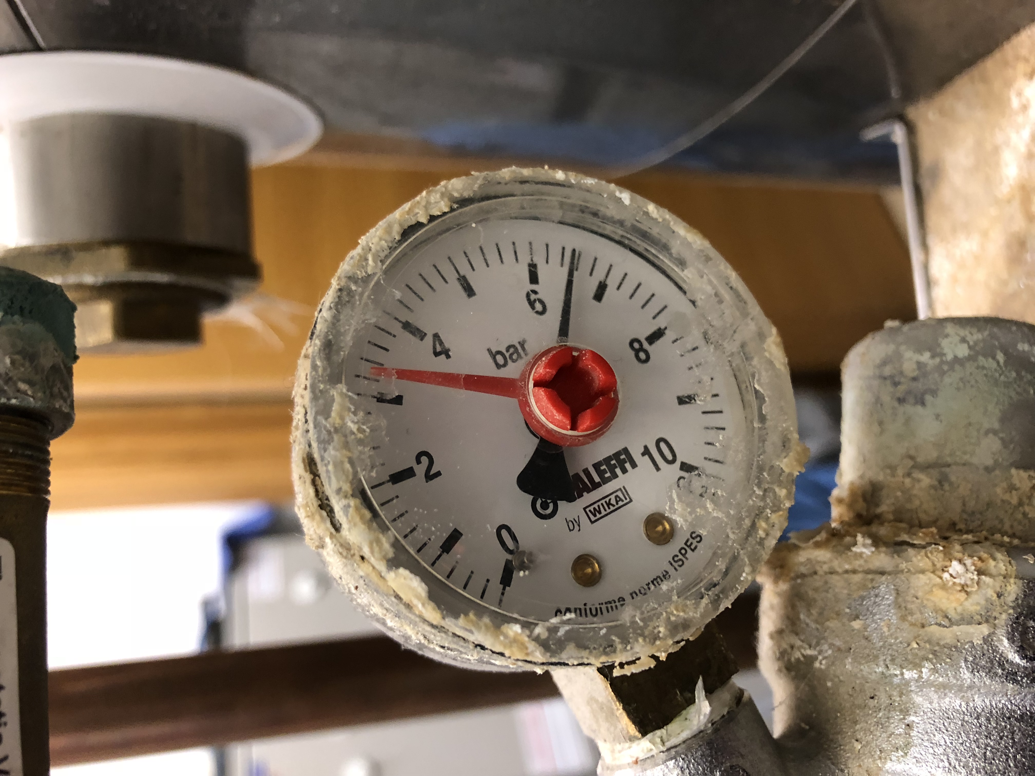

Um, what the heck is that at 6.5 bar pressure???
No idea I’m afraid! O.o

The pressure gauge reading is OK for a sunless day, when the sun comes out it should increase.
If the pump (the circular thing under the controller) is warm but no water is circulating it is possible that the pump is seized. Should be easy to fix if that's the problem.
Solar systems are fairly simple so there's no reason why it shouldn't be fixable.
I was kinda assuming the red pointer was set to indicate the maximum recommended pressure. No?

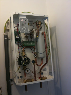

make and model of the electric boiler would be handy
It’s a Fusion 24kw 3 phase boiler supplied by The Electric Heating Company. I found an old photo with the cover off.
I have the manual at home somewhere.
I can do pretty simple things like bring the boiler back to pressure if it drops too low or reset the immersion heater if it trips but am clueless about the rest really.

I think he may mean this?
That's the pressure reducing valve for the incoming cold I believe, 6.5 bar is a bit high, might need turning down
Just been on the phone to technical for some divine intervention ;)
Thats the PRedV ( pressure reducing valve ) that supplies cold water to the quenching coil at the very top, the one that has the silver corrugated pipe, which cools the tank down as stated in the red text I posted. Shouldn't ever have been fitted ! @newhome, can you confirm that you done have / never will have / dont have pipework run for a woodburner or solid fuel heater / boiler / other?
Oh, and its Fecked too.
I have to go out now, I will look for the manual later (unless someone finds it first and posts a link)
Do you have a 3 phase supply? I assume so (still waiting for pictures of your meters and consumer units )  Otherwise 24KW (105A) is too much for a single phase supply
