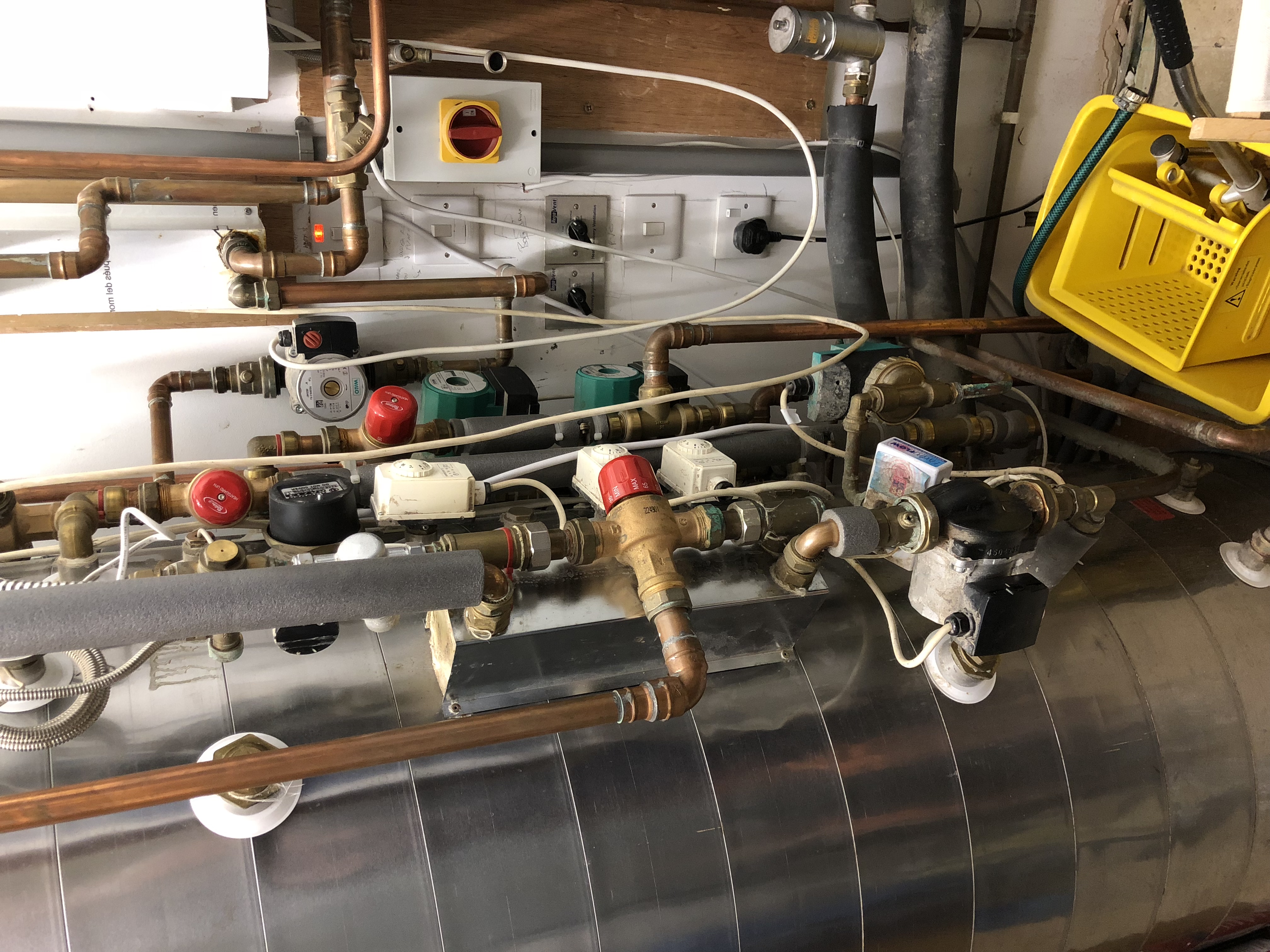

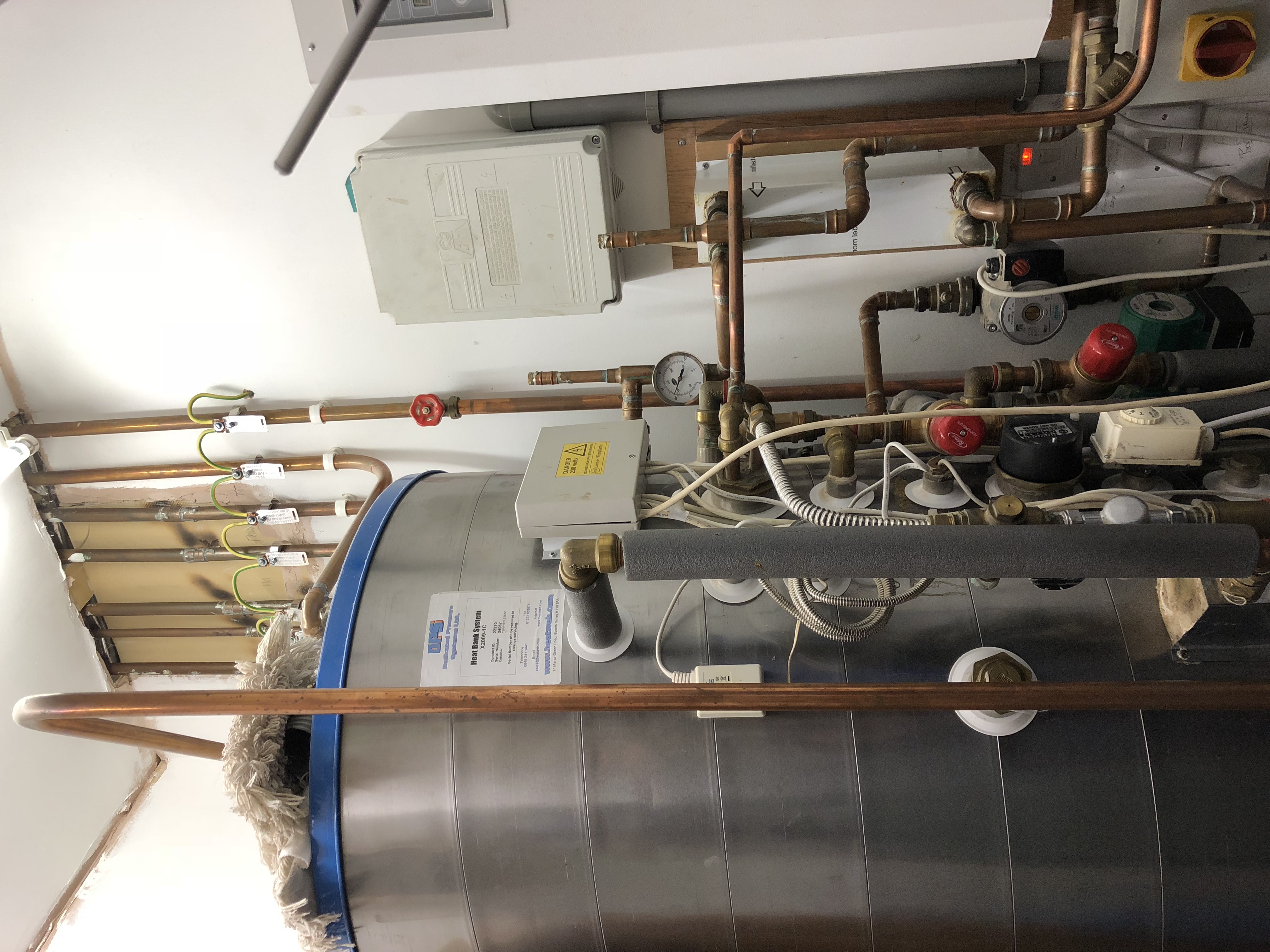

    Right then, here we go...... Order of events :- ( chapter one lol ).   Electric boiler which is sealed and pressurised. Thats the reason why the pressure needs topping up occasionally.

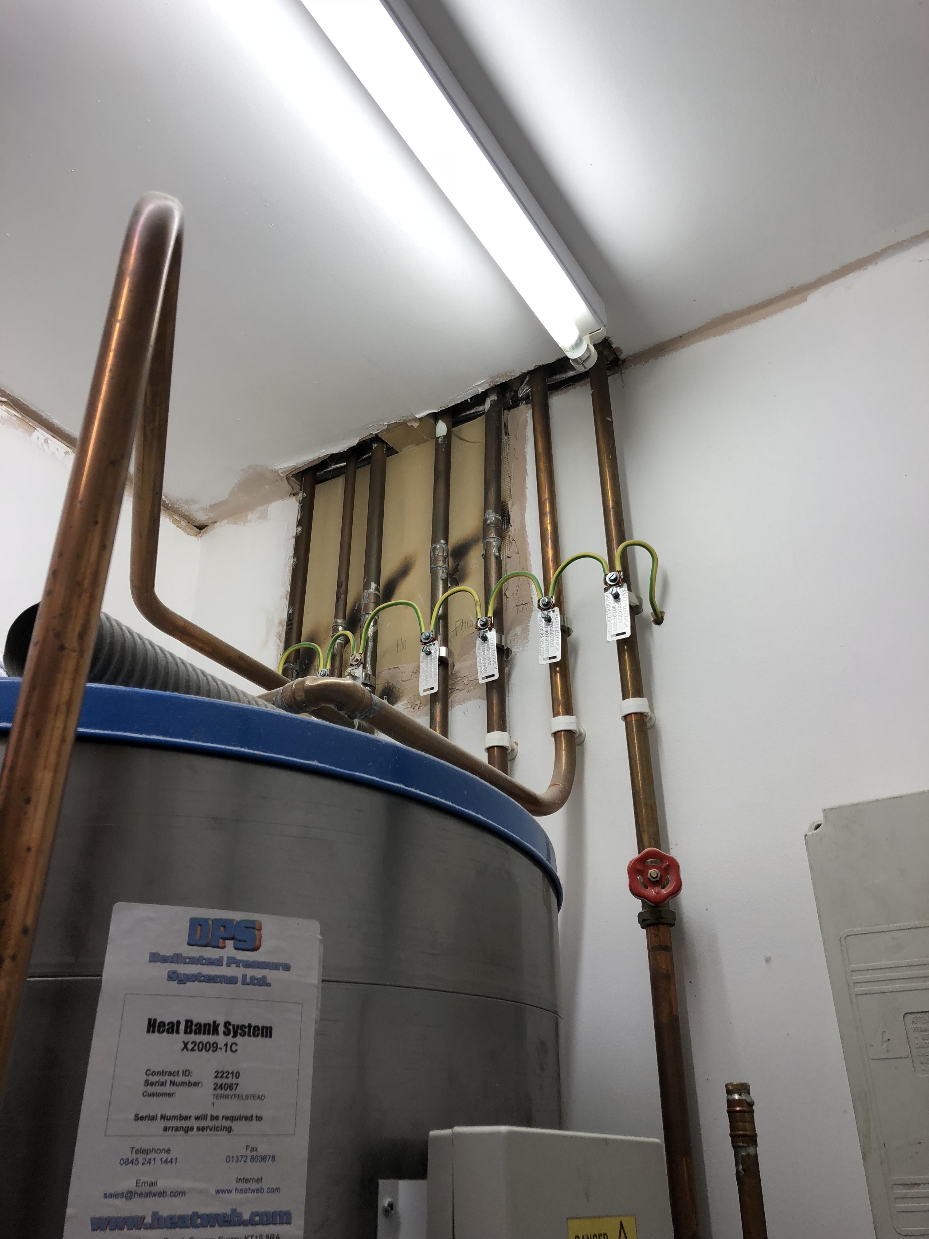

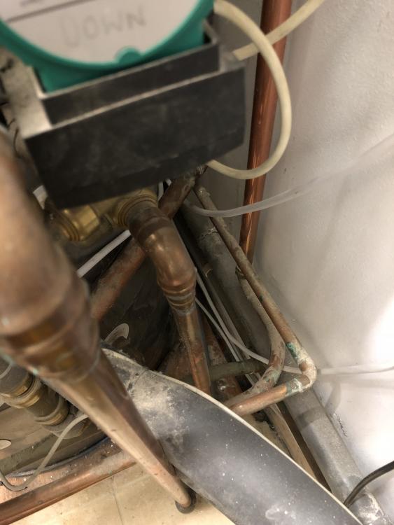

On the copper pipework, not the plastic. They'll be around the TS if any at all usually.

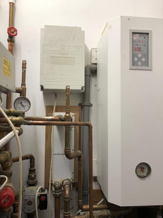

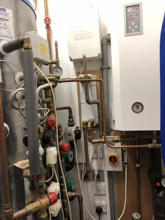

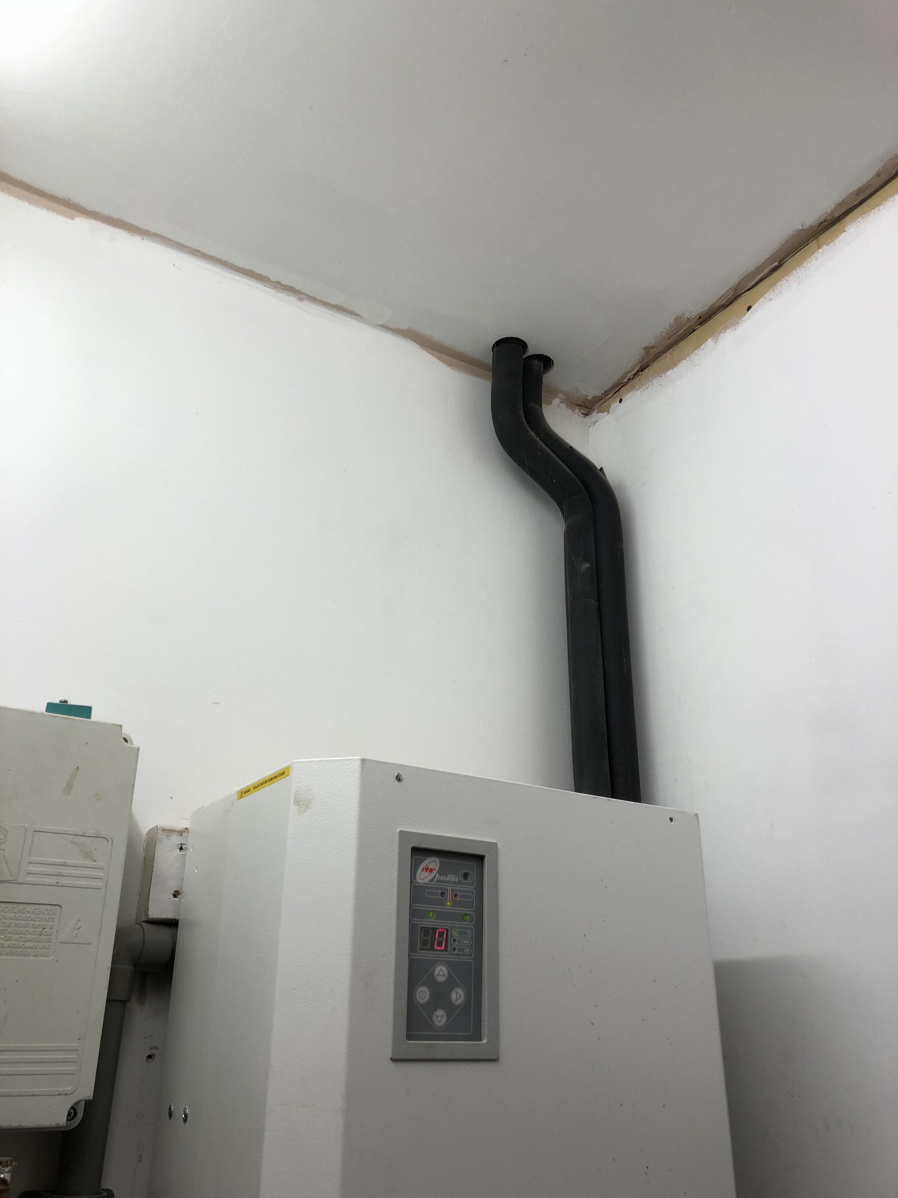

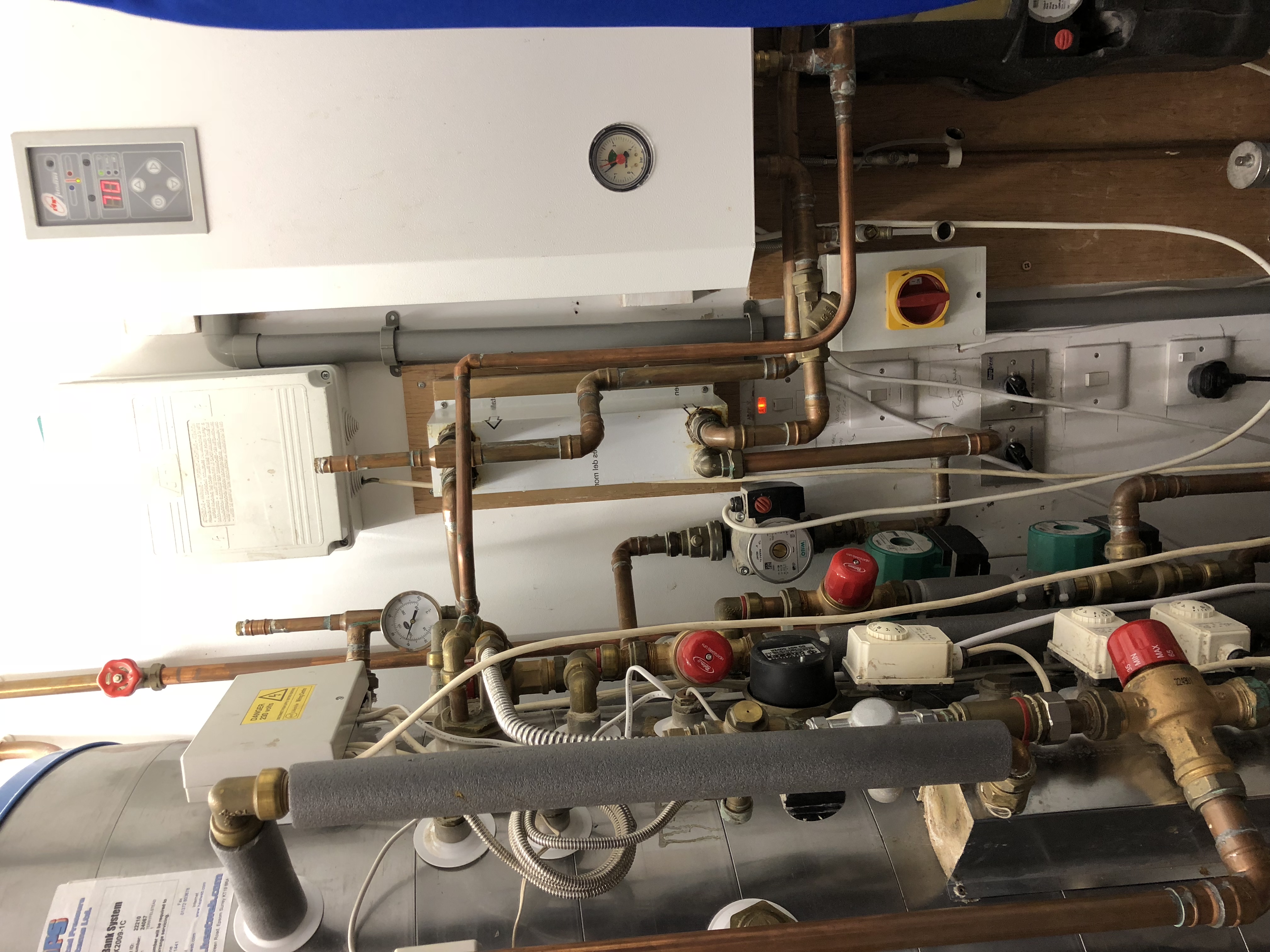

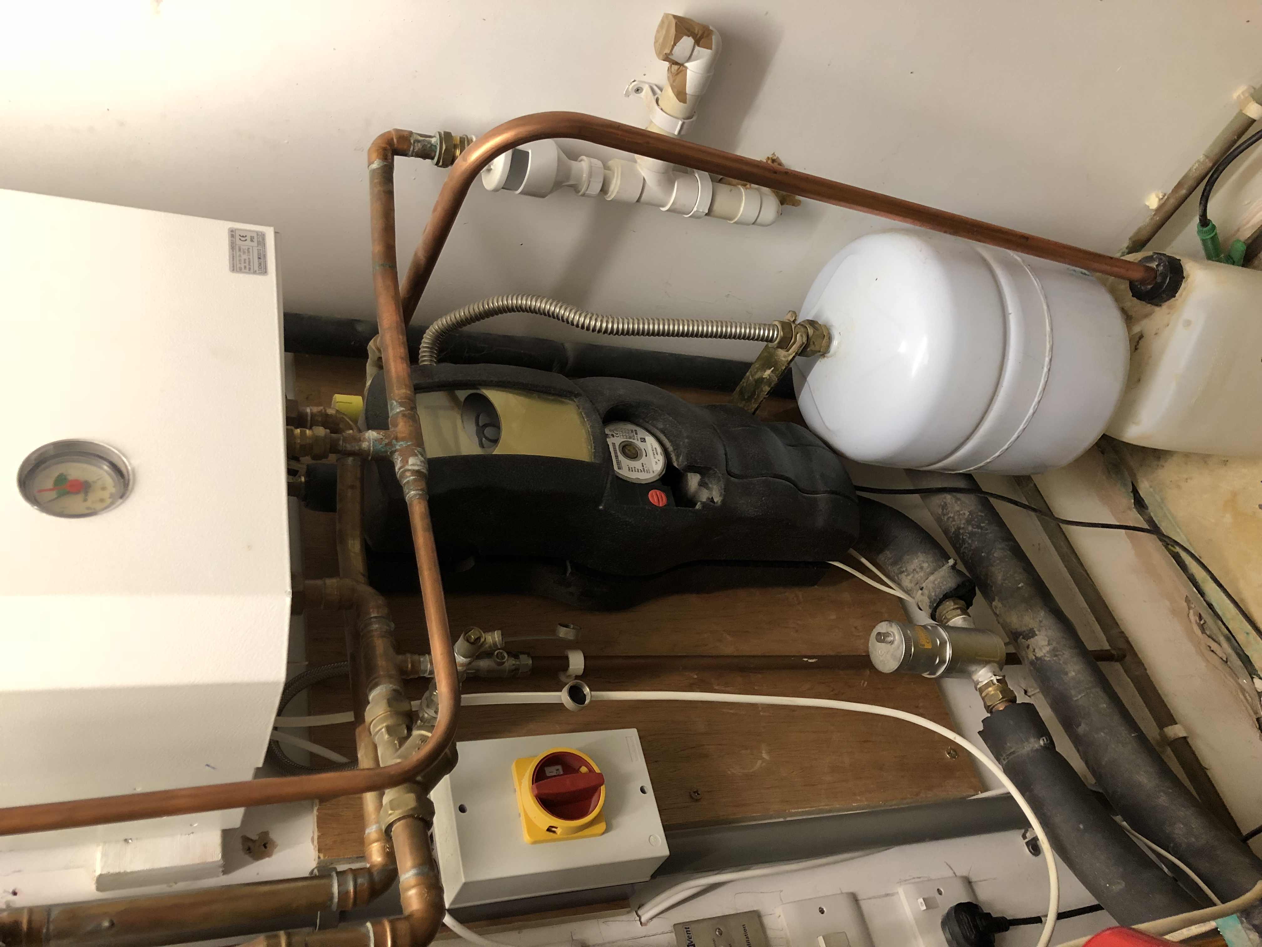

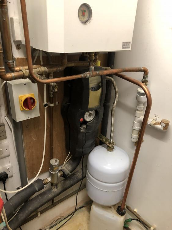

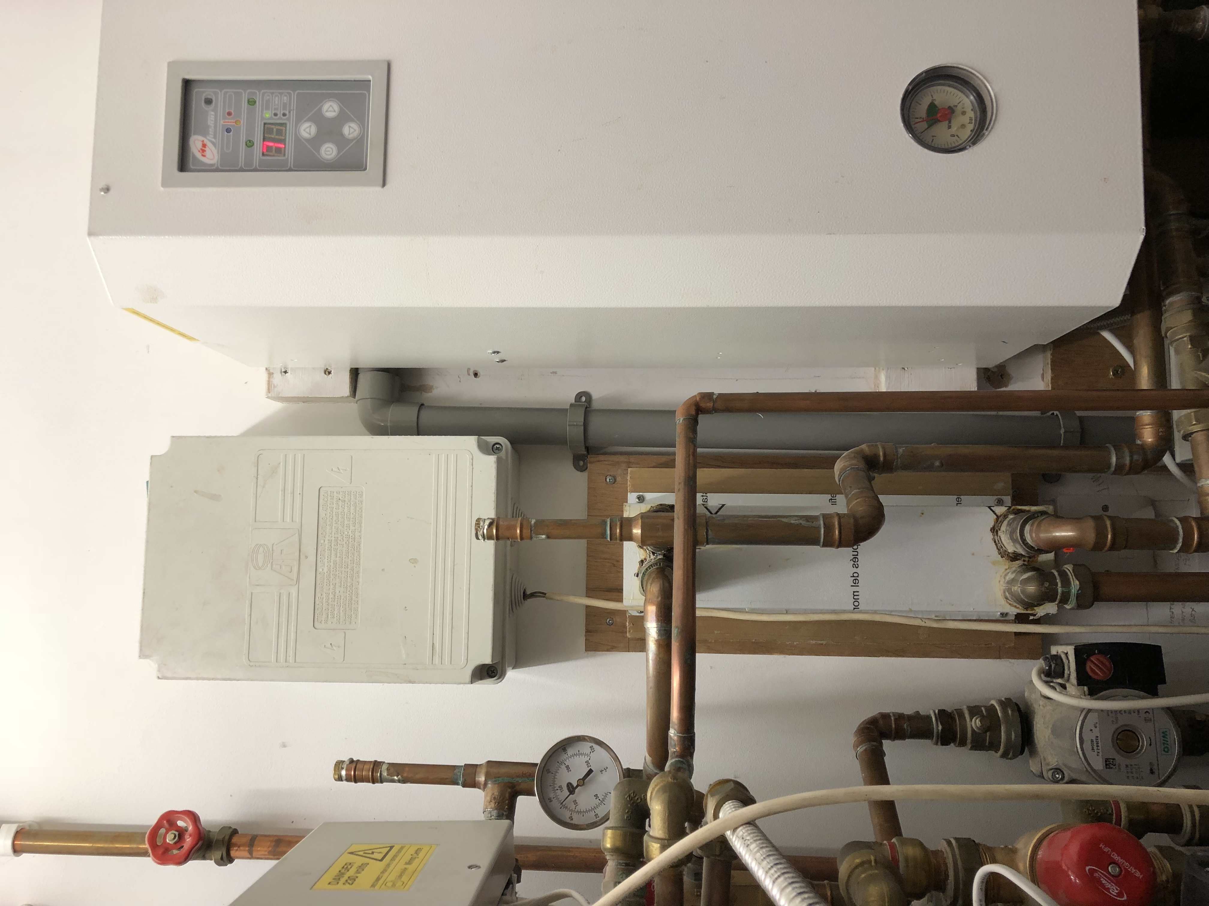

Some pics of the boiler and any pipework / valves / paraphernalia too please.
You can post them tomorrow ;)
When you say picture of the boiler isn’t that in one of the first photos? Just a big white cover over all the working bits tho.
Will take some more photos of anything else not in photos already and post tomorrow.

Adding a quick note to say that the guy who came out to fix the boiler in Nov when it stopped working turned the heating down to 50. It was at this point that there wasn’t enough hot water to fill a bath enough etc. It was always set at 60 before and at least provided enough hot water to take a decent bath. I don’t know how to turn it up though.
Do you mean he turned the BOILER down? The HEATING would be turned down on the room thermostats.
He did something that means that the water in the thermal store no longer gets as hot as it used to.

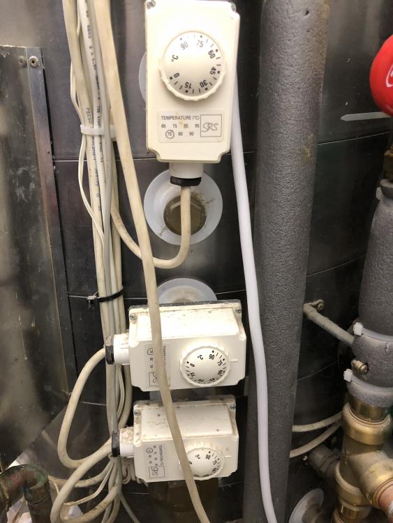

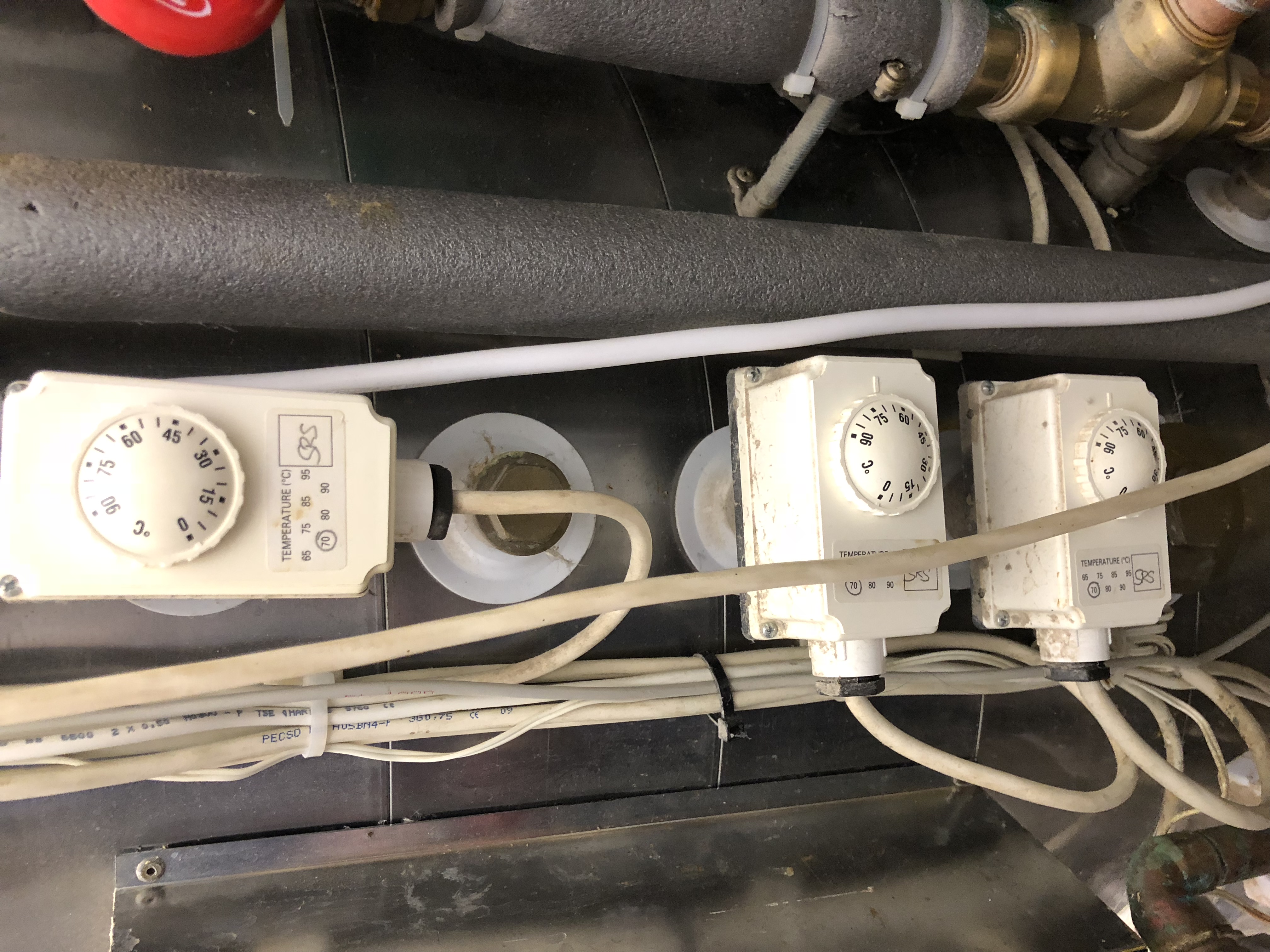

If the boiler flow is set too low then here is the boiler manual which should show you how to raise the flow temperature back to 60 degrees. Personally id set it for at least 65. That way you should get much better hot water performance. If you check that and the boiler is already set higher than 50, then we need to look at the TS cylinder thermostat which will have a temperature setting on it. If your going to tweak anything on the cylinder, make a note of what it is set to before adjusting it, or better still, take a pic and ask before you tweak.

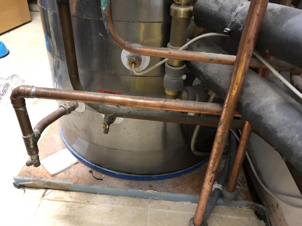

Some manufacturer website excerpts :

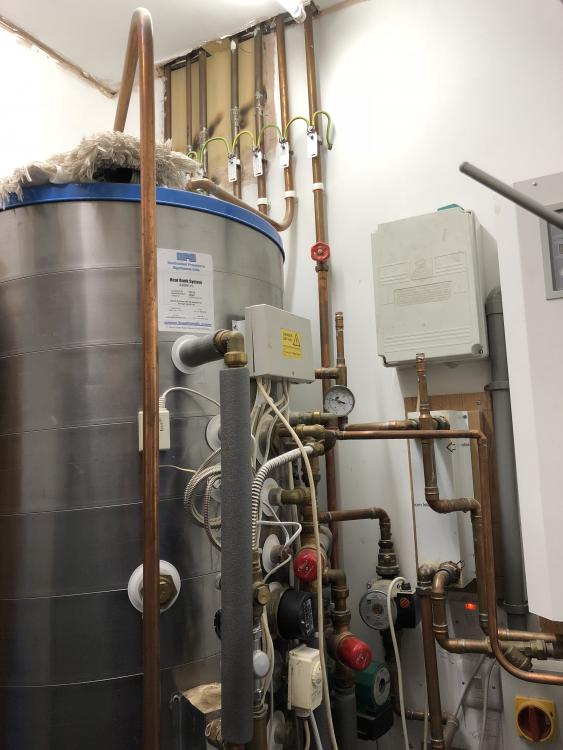

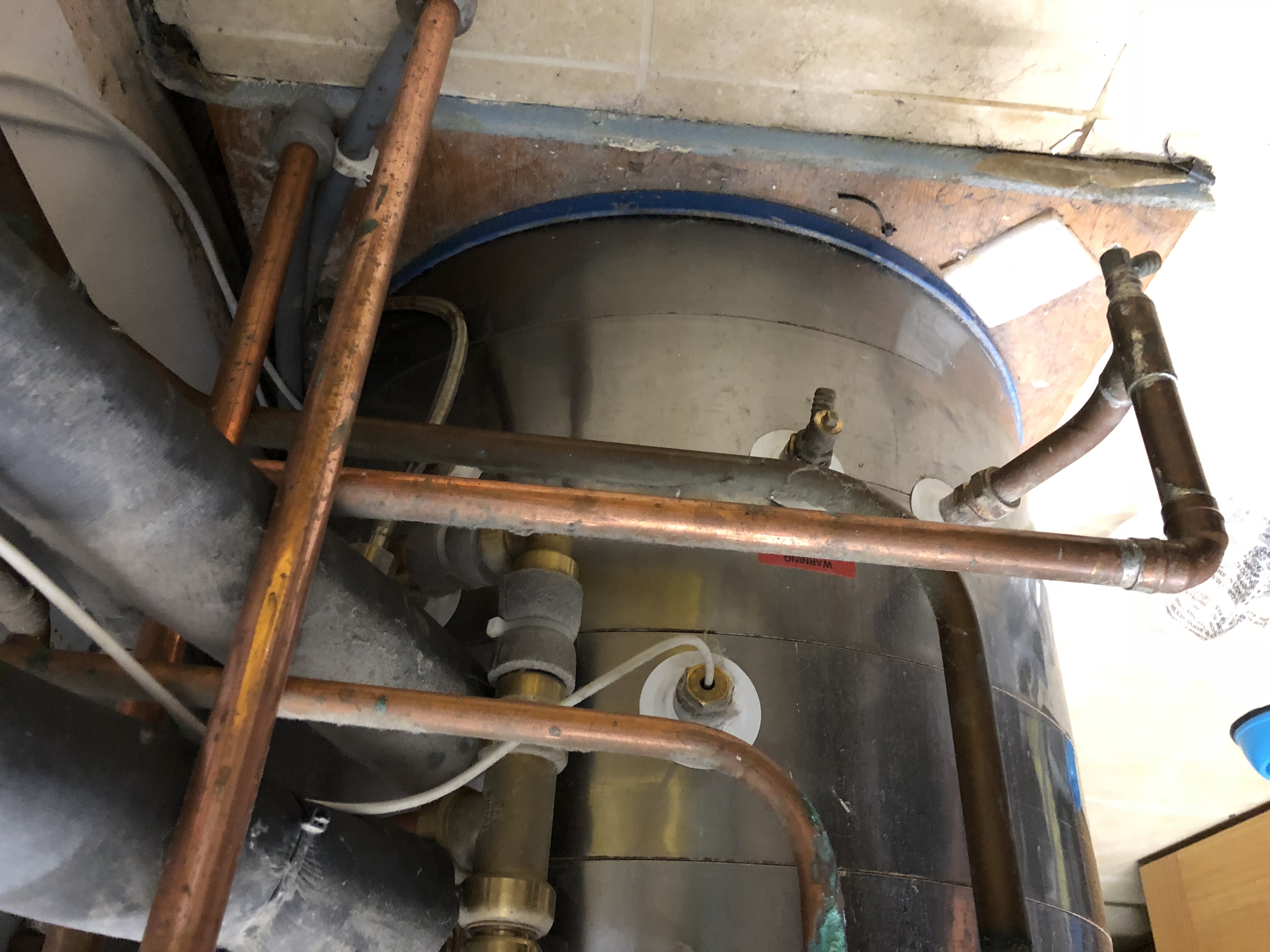

The protection system on the Xcel works on the basis that the heat can circulate from the wood burner to the Heat Bank naturally using thermo-syphon (gravity) circulation. The Xcel is fitted with a heat exchanger in the top, and if the temperature of the water in the store ever goes over 95°C then a mechanical valve opens up to allow cold mains water to pass through the heat exchanger and out to drain, cooling down the stored water as it does so.  The heat exchanger can extract over 12kW of heat and as such is suitable for all types of wood burner, and in many instances is the only way that the latest building regulations (now covering vented systems) can be met when using a wood burner.
So that explains why theres a lot of additional pipework at the upper portion of the TS. Im guessing that the stainless corrugated hose that brings that reference temp to the mechanical quenching valve. Strange that they specified such a cylinder when they knew it wouldn't be serviced by a woodburning stove :/
It is also worth pointing out that there are two other forms of overheat protection built into Xcel Heat Bank systems.  The first is an overheat thermostat that turns on the central heating when the store reaches 90°C. This protection is the normal day-to-day protection and requires power supplies to be on, and pumps to be functional.  The other form of protection is the system is open vented.  Whatever happens and if ever the system does boil, you have peace of mind that the vent pipe will protect the system from catastrophic failure.
So with the system being void of a woodburner, this function should never kick in.
Still trawling to find a cylinder schematic that I can see when zoomed in. Lots available but none helping yet.

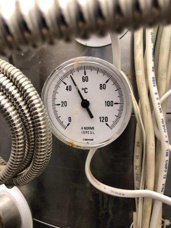

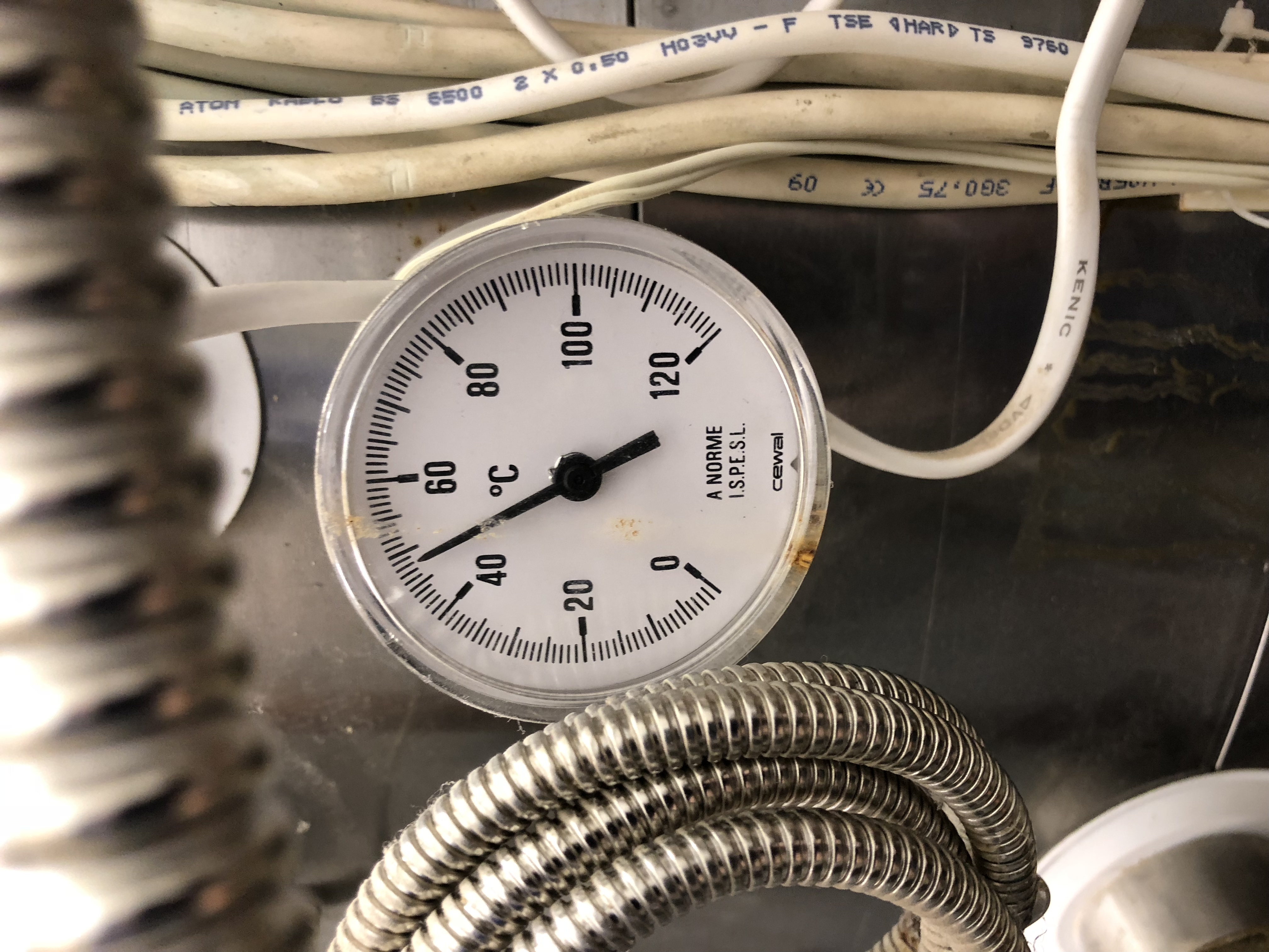

I had the boiler switched up as high as it could go at one stage but the Electric Heating Company man told me that I was cooking it and to turn it down. No matter how high the boiler was turned up the temp on one of the dials on the thermal store never seemed to get above 50-60 tho.
Strange as the boiler should be sufficient to heat that TS up to the flow (set) temp of the boiler. The pic shows the cylinder stat ( the creamy white box under the round black immersion heater ) set to over 75oC.
That dial showing 50 never goes above 50 now. It always stops at 50 and never rises. When the water was hotter it used to stop at 60. I will try turning the boiler up and see if that has any effect.

The Electric Boiler is a Fusion 24kW model from the invoice. Is that big enough for a 350sqm house with 6 (I think I read) showers and bathrooms?

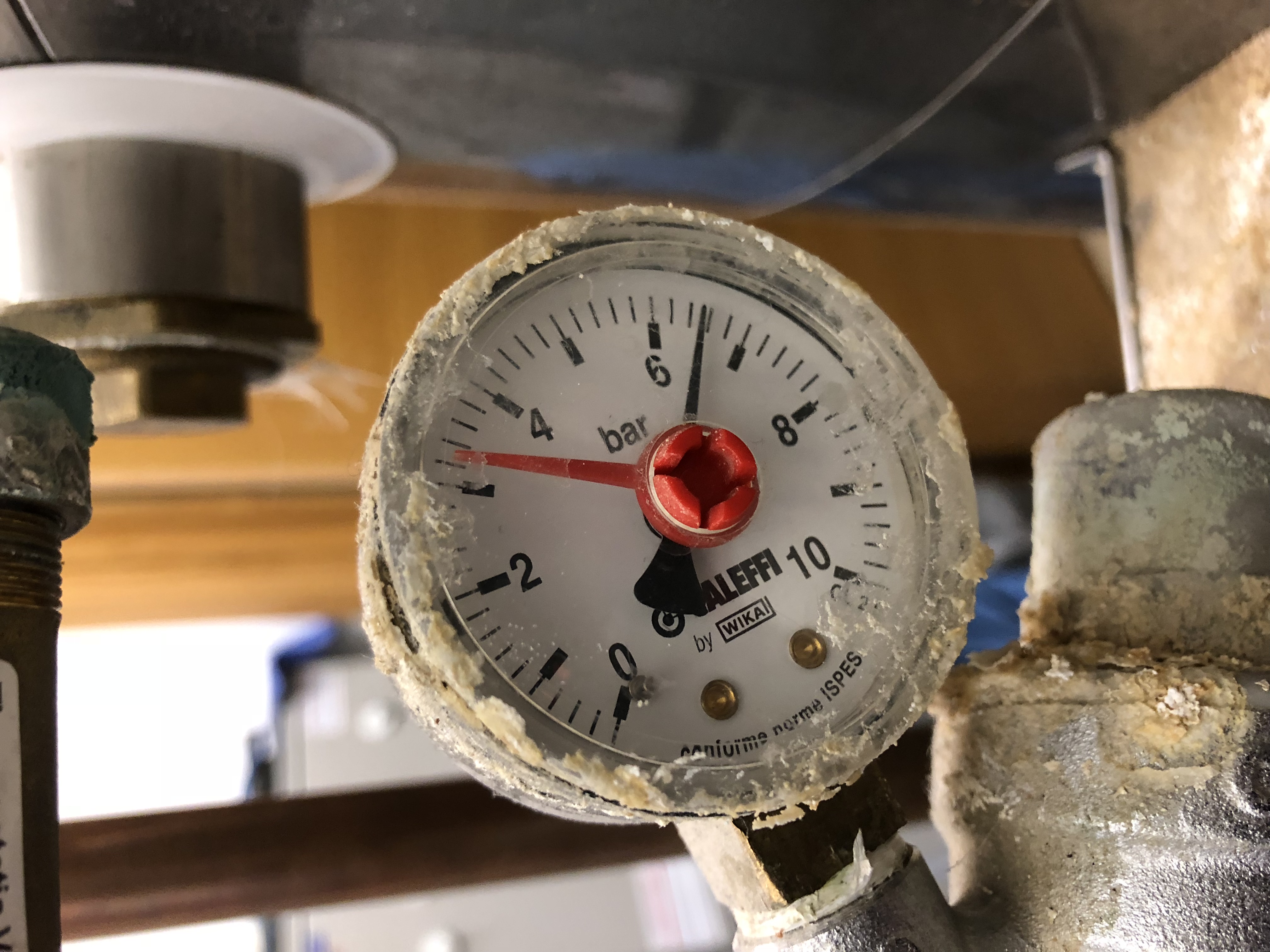

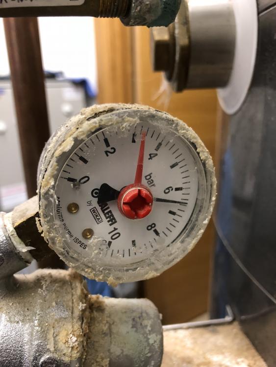

The solar thermal system looks like it is a sealed system which means that there is ALWAYS fluid in the panels on the roof. If the controller for the solar (deltasol thing) has been switched off for any length of time then the fluid in the panels on the roof will have stagnated and probably boiled (the sun is powerful like that). This pushed up the system pressure and triggers the over pressure valve to open and you loose fluid.
No big deal TBH. the system will need draining, cleaning and recharging with new antifreeze. Hopefully there are no leaks form the overheating, but it's an easy fix really. Scottish Borders is too far for me I'm afraid ?

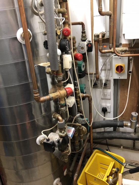

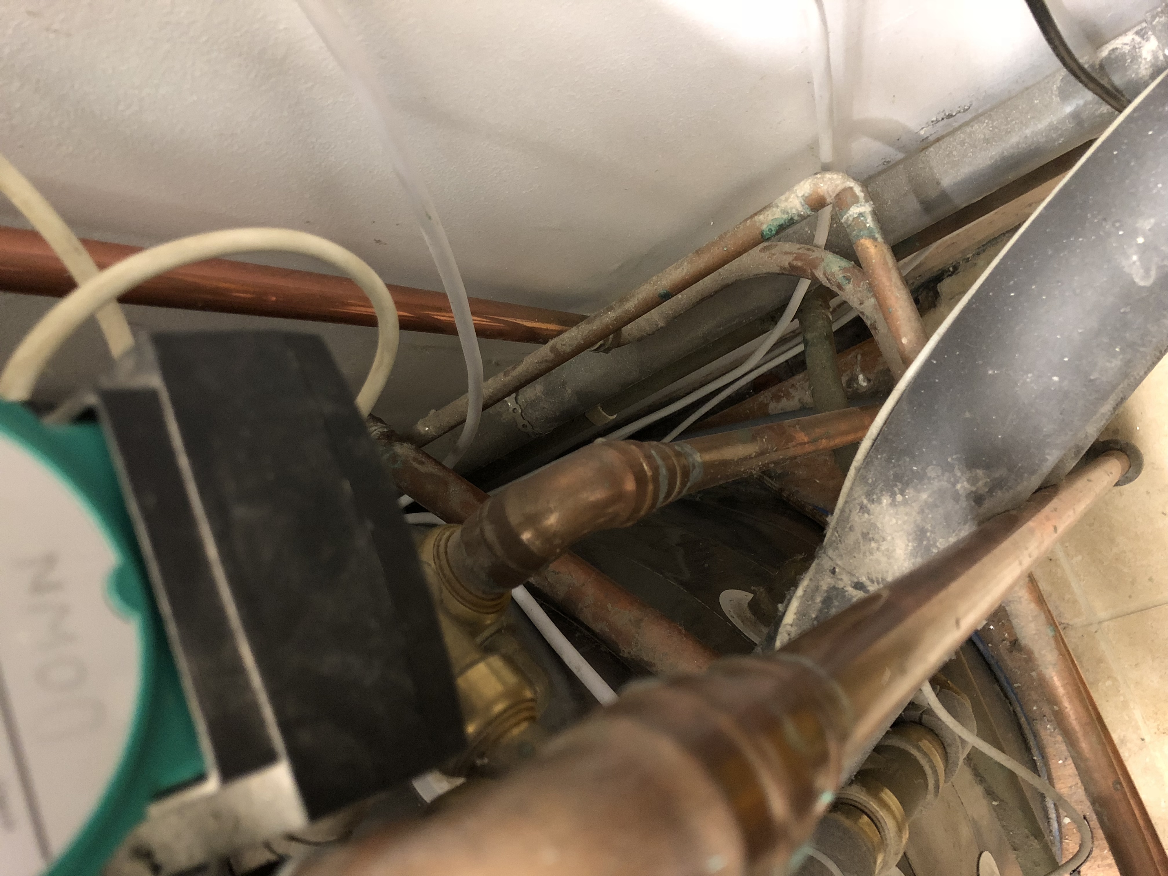

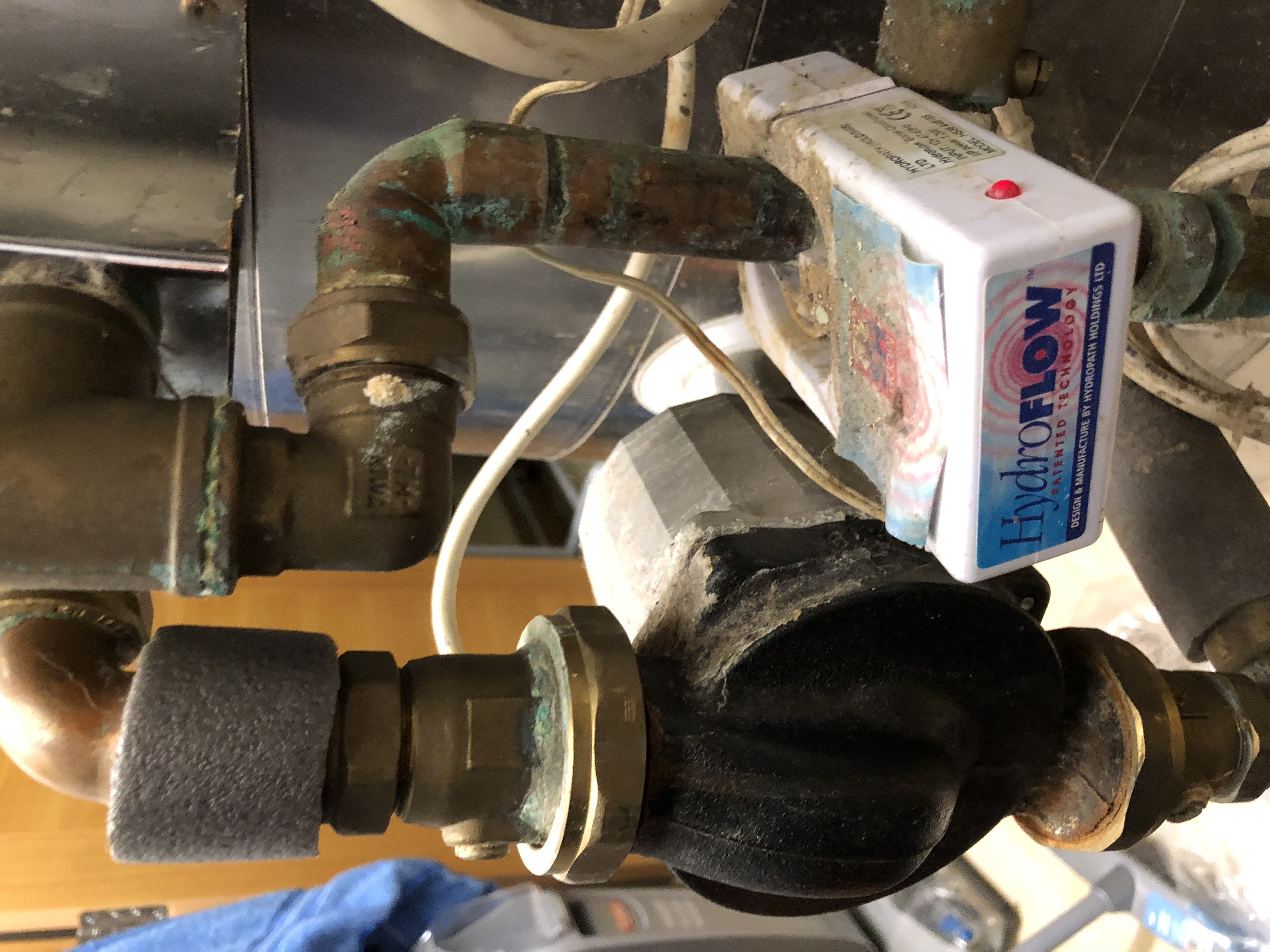

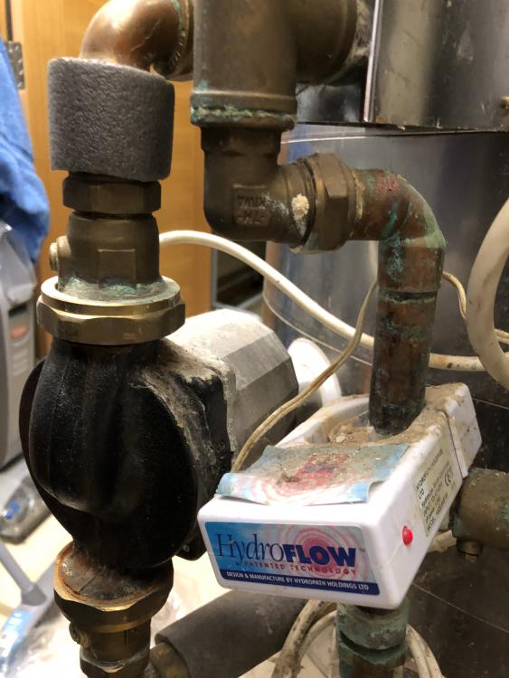

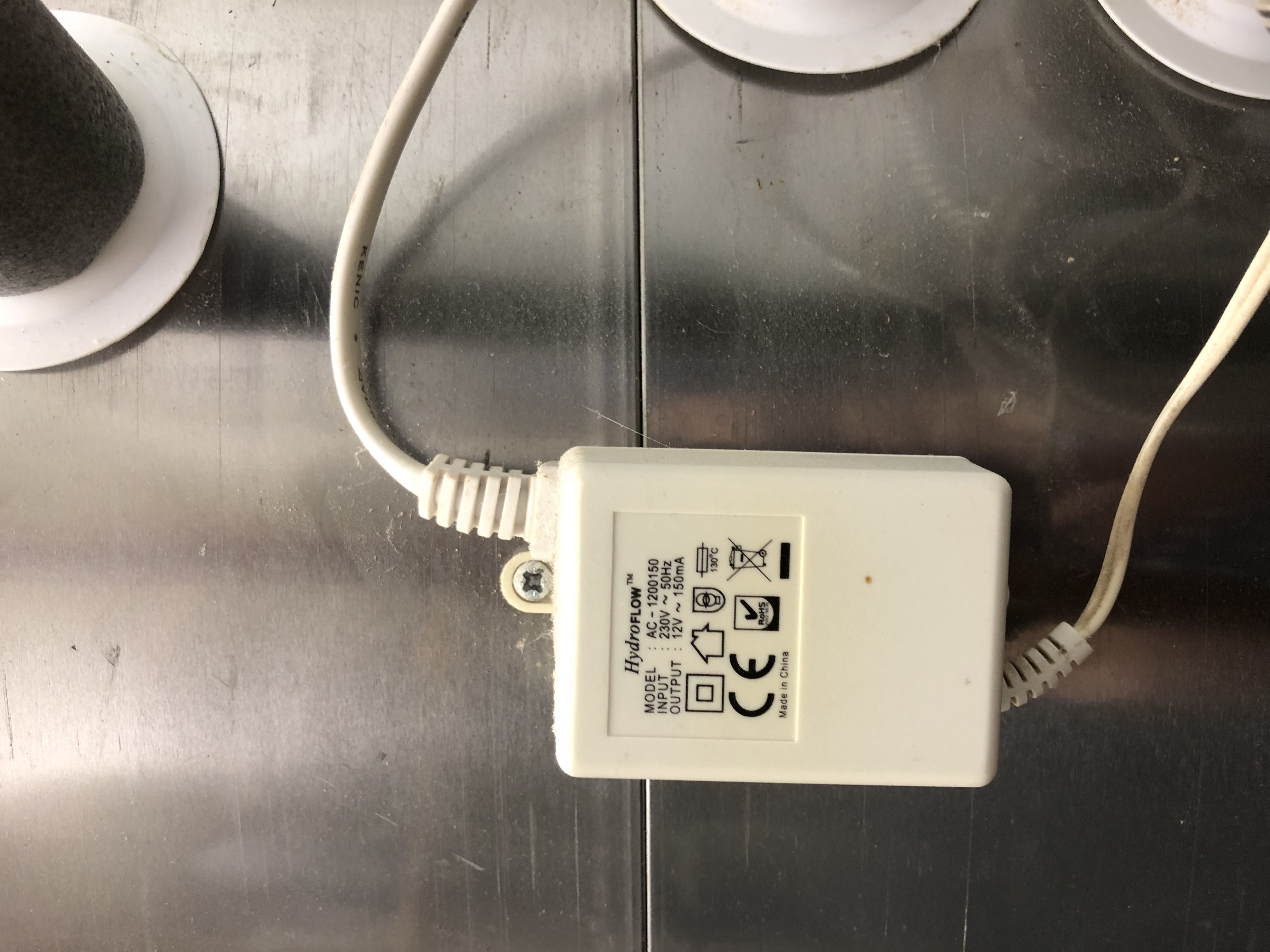

So here are a few more randoms pics I grabbed this morning in case they are helpful.
Edited by newhome
Last ones. There is not much more in there. A single pipe that goes round almost at floor level and some pipe spaghetti at the end but I’d need to remove all cleaning stuff to get to those for a photo.
