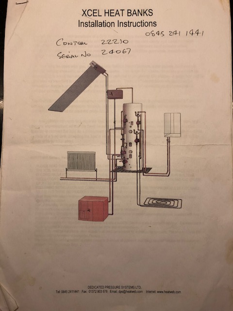

I think this statement nails it. I doubt he, or perhaps you, knew that the system ( what you already had fitted ) just needed to be configured properly, and had the means there to do what you wanted by programming.
The touchscreen heat miser system clearly is plenty comprehensive enough to do the job, just its the dangerous grey area where plumbing and complex wiring reside........and very few plumbers have the slightest clue about multi-discipline wiring and controls. I make a good few quid off my Gas registered plumbing mates who cant do any complex wiring, particularly old to new conversions.
Can you recall which controls were in place before 'his' arrival ?
There were no 'controls' as such before his arrival. The room thermostats and the touchscreen heat miser thingy aside. There really didn't seem to be a way of switching it on and off before he came other than switching off the boiler and the UFH pump manually if I really needed it off. Other than that it seemed to be on all the time unless I physically switched it off. So I used to switch the boiler and pump off in the boiler room when I needed to.

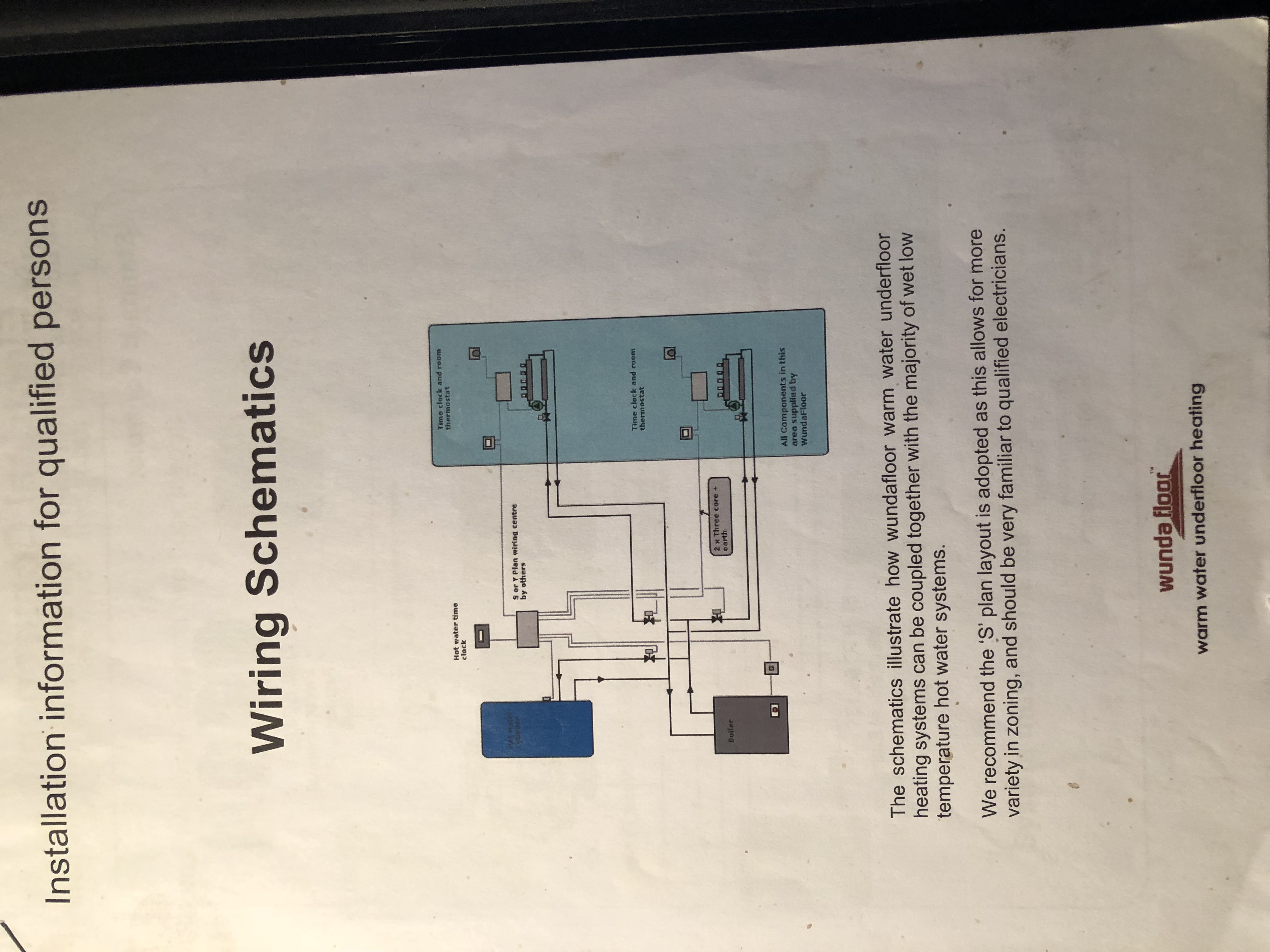

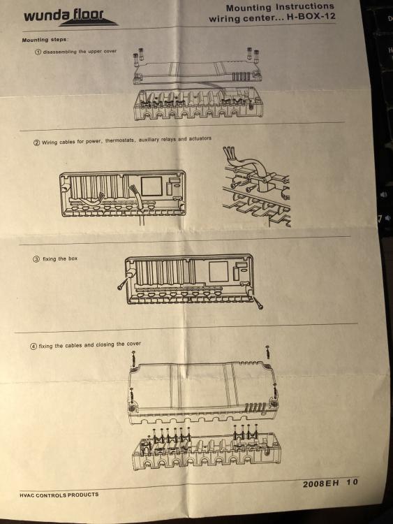

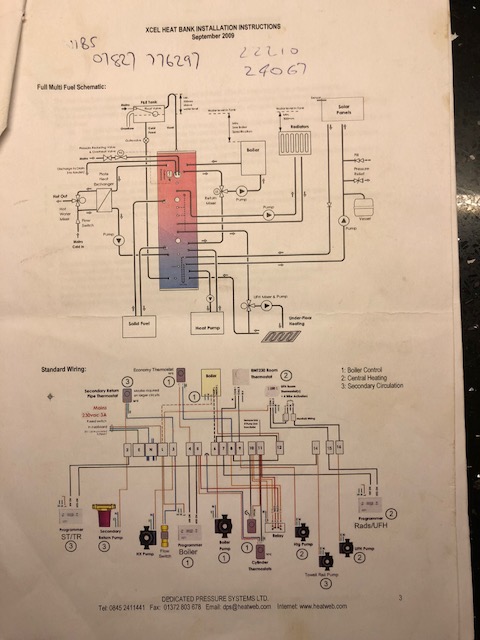

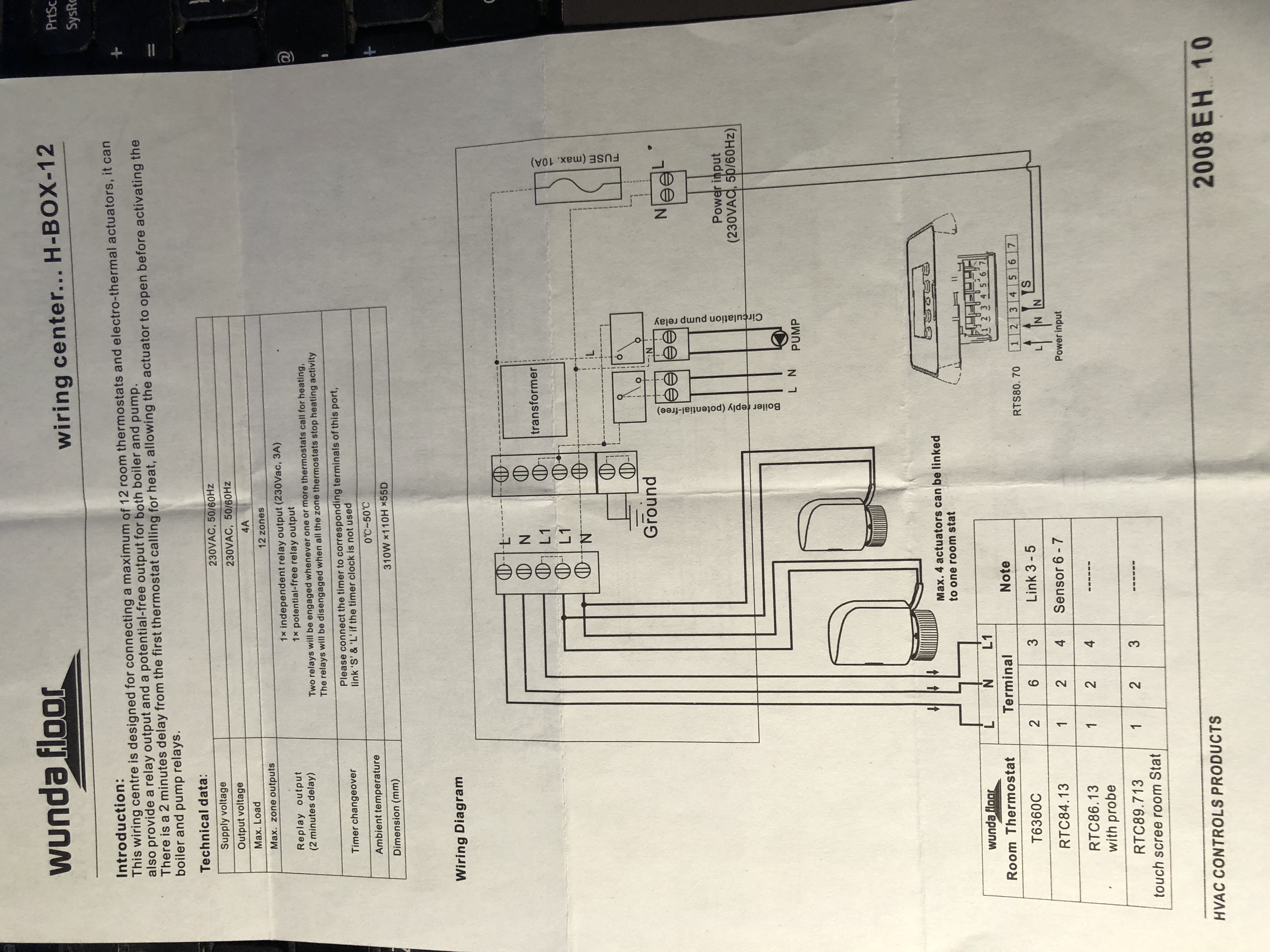

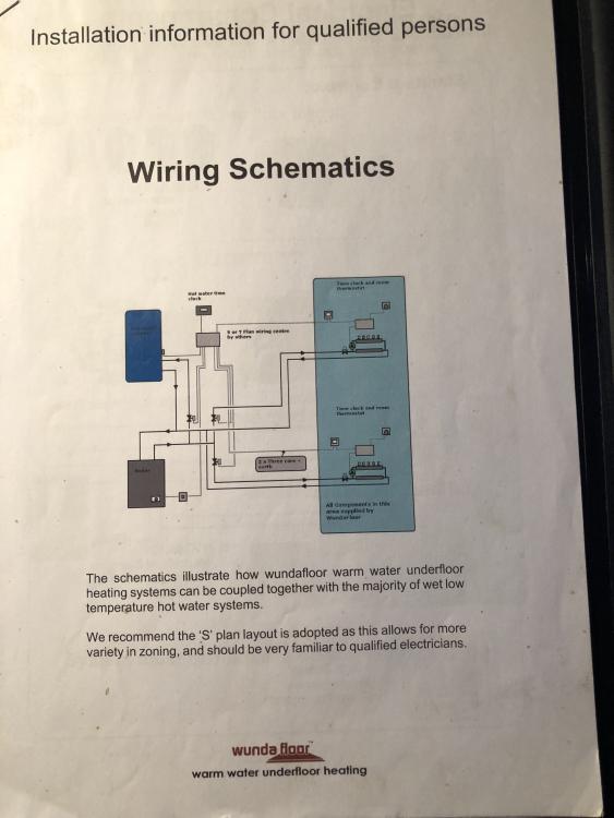

And there are these. Not sure if useful?
Plus all the UFH loops that I assume are pretty standard.

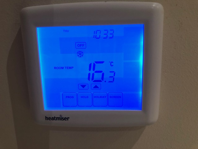

5 hours ago, Nickfromwales said:
turn down all the ROOM / HOUSE stats
Most of the rooms are turned off. Will this do (see pic) instead of 'turn down'? As in the frost setting on only.
I'm actually here all day tomorrow but I can still turn everything off in the morning as you suggest. Better wear some warm clothing though :D
I am not 100% sure I understand all of your 'what to do next' advice. I will read it all again tomorrow. Head spinning a bit from all of this today O.o
Its fine on frost setting as room stats like that dont typically switch on / off, just up or down.
Read through and if your stuck on a particular point just post here and someone will guide you through if I dont see it for any reason. Ask plenty of questions and we can crack it sooner :) It doesn't matter if your repeating yourself, just ask until your confident enough to push on.

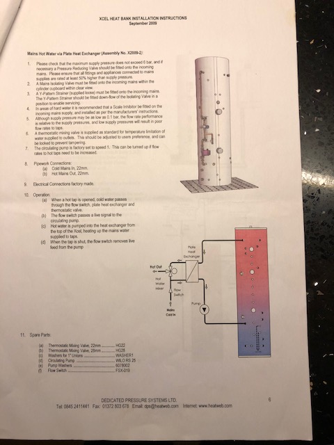

16 hours ago, Nickfromwales said:
I assume that either runs off a Hot Water time clock setting, or is operated by a flow switch that senses you opening a tap and fires that particular pump up for the duration the tap is open.
I think this is one of the main issues. I don't think there is a hot water clock setting or a flow switch. If I open a tap no hot water arrives unless the UFH pump is switched on.

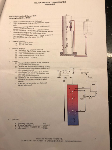

Principle of operation ( as advised from technical support ) :
You should have a two-channel time-clock for toggling between summer and winter 'mode' which you will have to do manually as required. You may also have another time-clock for DHW production, depending on how its been configured.
I can't see any 'clocks' anywhere. If it ain't on their invoice where would they have come from unless included with the TS?
I think I'm ok with your instructions but there are a couple of things that I want to clarify using photos so will do so in the next post. I will give it all a whirl when I finish work.

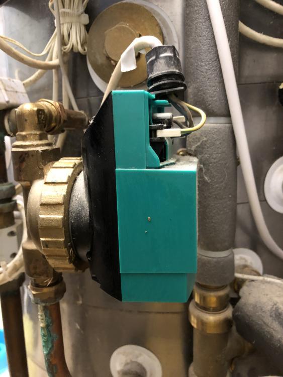

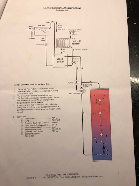

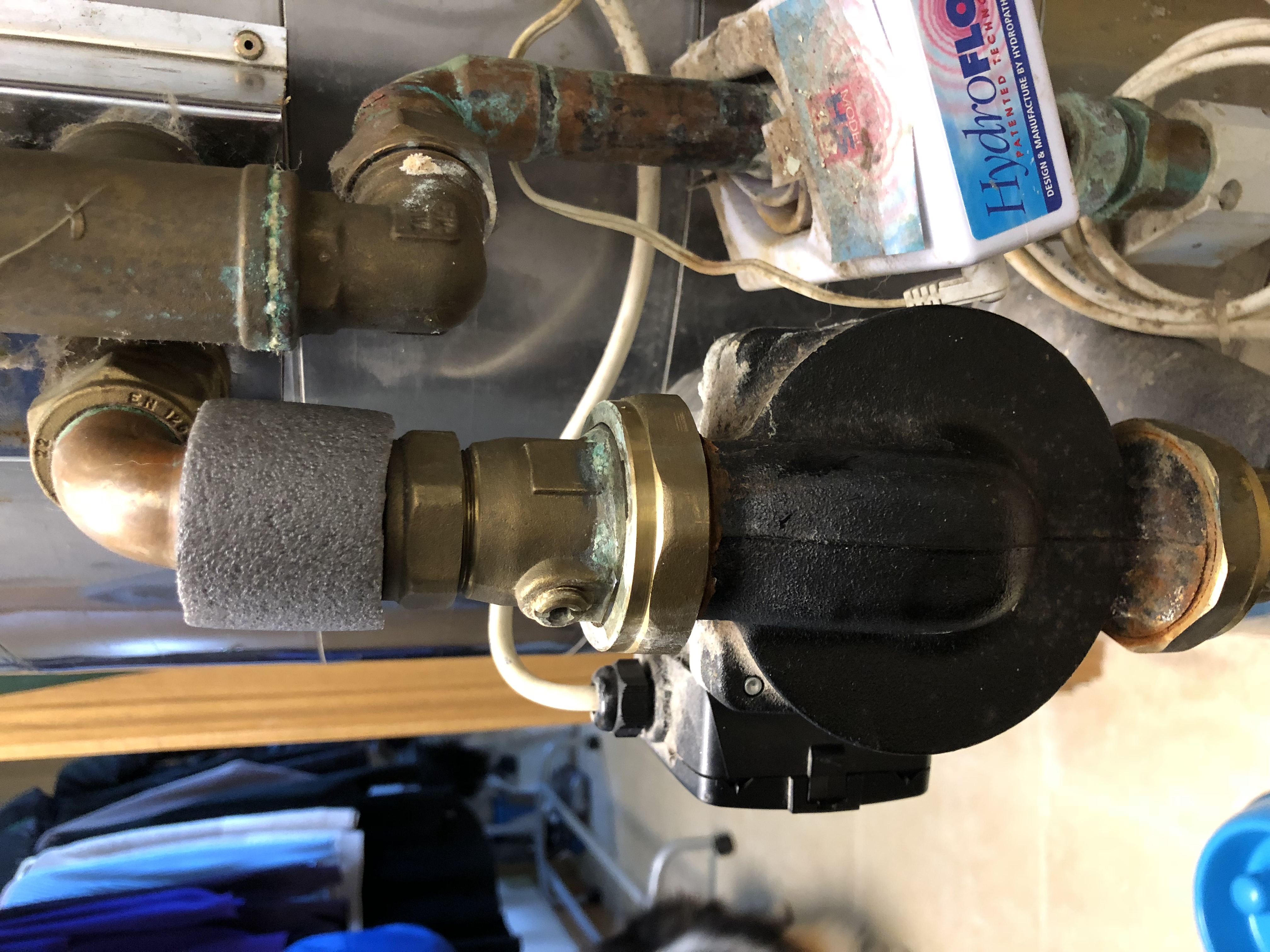

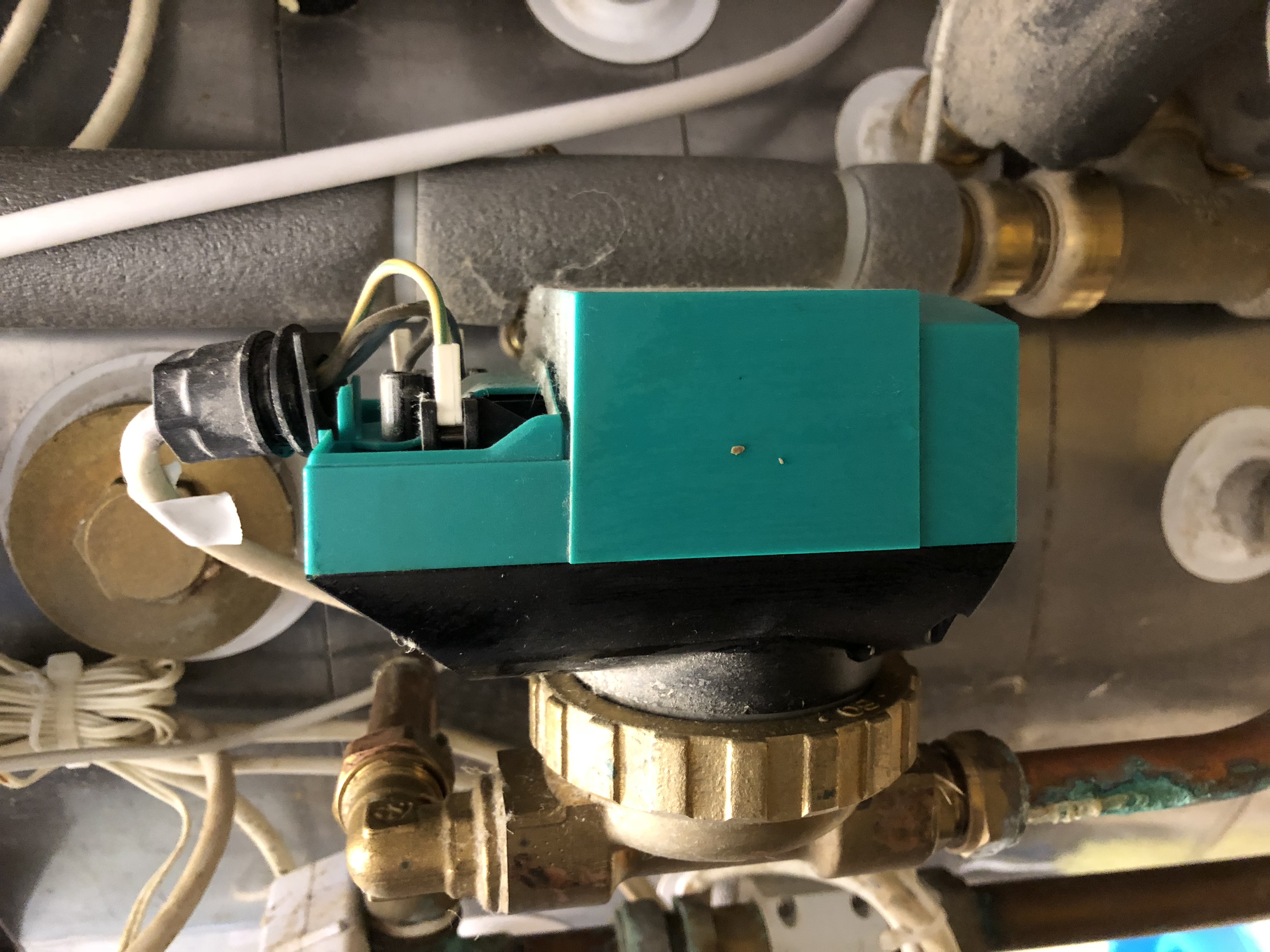

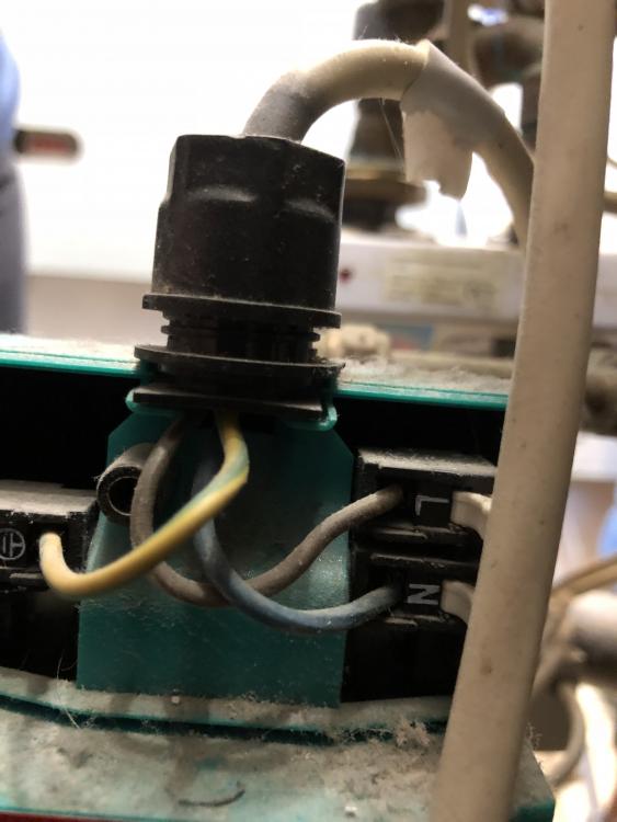

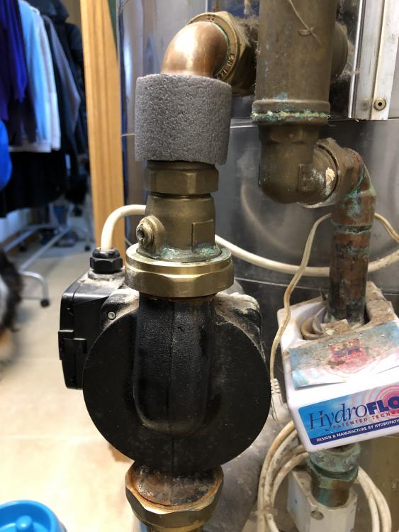

Couple of things to clarify please:
What are these? I had to take 3 photos of the top thing as it was difficult to reach.
And what’s the black thing in the 4th photo?

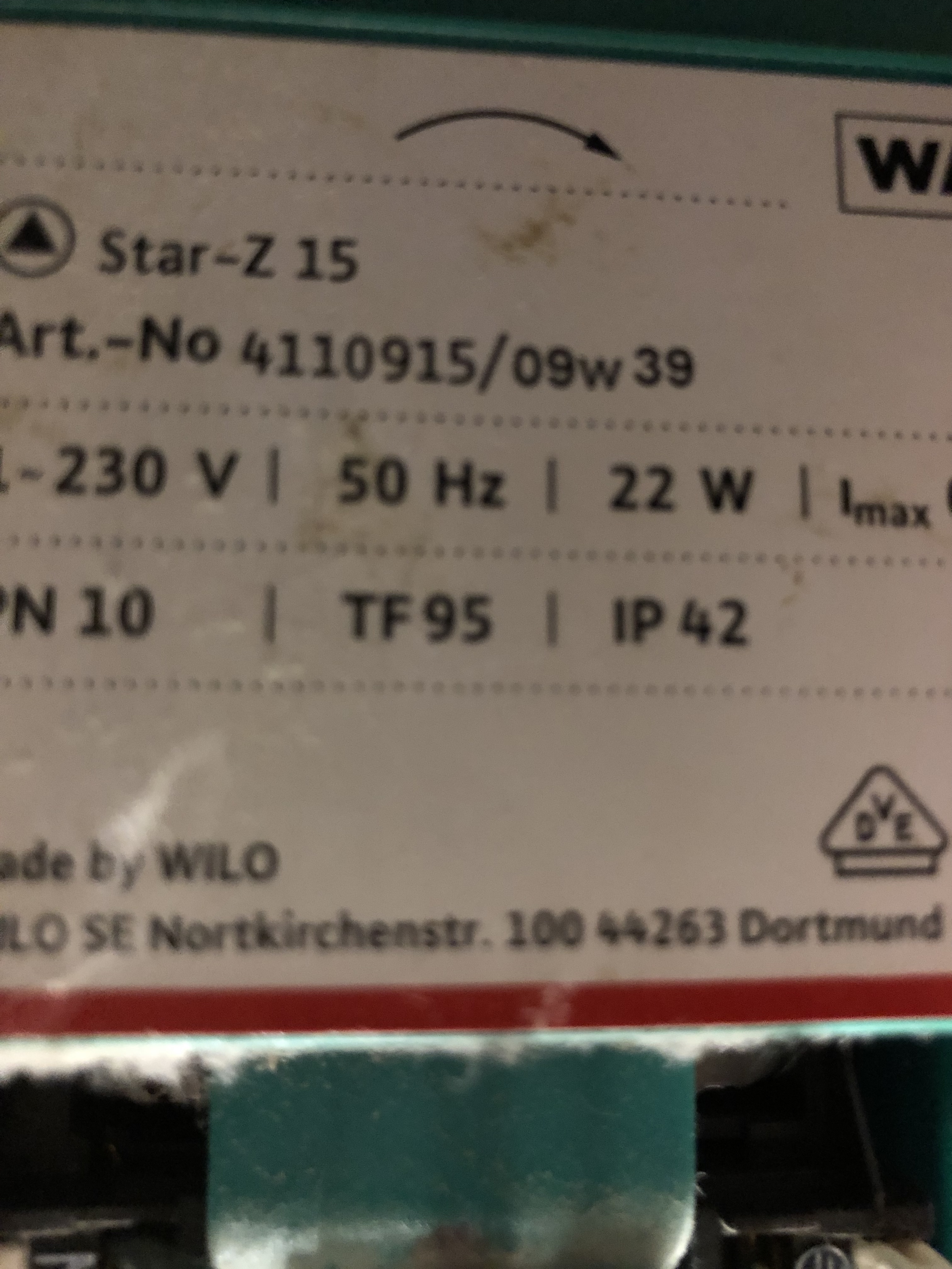

6 minutes ago, Nickfromwales said:
Black thing is a pump.
Is there a serial / part number on the other bit you can read and post.
 It's on the label says Wilo Star Z - 15. Part number 4110915/09w 39
Edited by newhome
Is there any chance that things have scaled up, do you have a proper water softener?
And is there a chance that water is thermo-syphoning through the solar system and losing heat though that?
