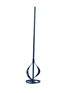

Onoff Posted April 2, 2018 Author Posted April 2, 2018 5 minutes ago, PeterW said: Make as much as you can lay ... Cheers. What do I mix it with though I assume instructions are on the bag! I've got one of these:
