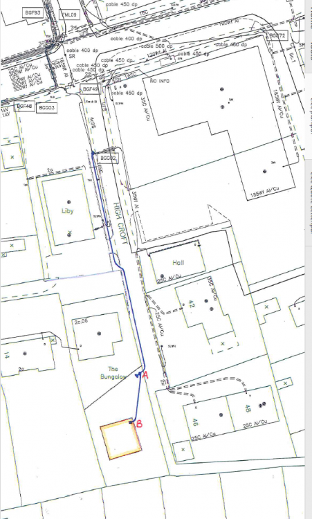

Hecateh Posted January 31, 2018 Share Posted January 31, 2018 I have just received a quotation from Northern Power Grid for the electricity supply. My house, in the garden of my current house, is at the end of a small cul de sac and will be the 5th property - others having been built many years ago. As there are houses just the other side of the road from me, using NPGs calculator my estimated costs were between 1 and 2 k depending which side of the road the electricity supply was on. The quote is for over £8600 - Not connecting to existing supply but running a whole new supply down the road. Another 6.5k to add to the bill Ouch ouch ouch Link to comment Share on other sites More sharing options...
ProDave Posted January 31, 2018 Share Posted January 31, 2018 Can you get to speak to the surveyor that made up the quote. It could be the existing cable is at full capacity? Or did you tick the wrong box and and ask for 3 phase, or an unusually high capacity supply? (I was "offered" a 12KVA supply and chose to accept that, as I just knew if I wanted more I would be hit with a cost for upgrading the local transformer) Link to comment Share on other sites More sharing options...
Hecateh Posted January 31, 2018 Author Share Posted January 31, 2018 2 hours ago, ProDave said: Can you get to speak to the surveyor that made up the quote. I will call them tomorrow - think I might have been a bit too 'emotional' to tackle that today Quote It could be the existing cable is at full capacity? Could be - My current house (where the supply comes from the other side) was built in 1951 The 2 bungalows inline with my new one - were built in the early 70's and the house across from me was built in the 80's Quote Or did you tick the wrong box and and ask for 3 phase, or an unusually high capacity supply? (I was "offered" a 12KVA supply and chose to accept that, as I just knew if I wanted more I would be hit with a cost for upgrading the local transformer) I don't think I ticked the wrong box "Thank you for asking us to produce a quotation for a new supply at the Property. In line with your request, we will provide you with a new low voltage (230 Volt) connection to our electricity distribution system (the “Distribution System”), full details of which are included in this Quotation. Works Required: Install a low voltage mains cable to your site Install a service cable to your meter position Install equipment suitable for connecting the meter" I am going to ask about it but I think it is going to be just another thing and I'll just have to live with AAaaaarrrrggggghhhh - another reason why @epsilonGreedy may need to have a few more thinks. If you haven't got a load of 'contingency' you really could end up in the stew. I have already gone 25% above my (admittedly tight) budget. Luckily it is not at deal breaker level - just reducing the retirement pot. Although if things carry on in the same way I will be selling the new build and moving into the bog standard, housing estate property Link to comment Share on other sites More sharing options...

ToughButterCup Posted January 31, 2018 Share Posted January 31, 2018 39 minutes ago, Hecateh said: [...] The quote is for over £8600 - Not connecting to existing supply but running a whole new supply down the road. Another 6.5k to add to the bill [...] Hold on a mo @Hecateh, why aren't they connecting to the existing supply? By that I mean, the supply that connects the bungalow? (if I have read your diagram correctly) Link to comment Share on other sites More sharing options...

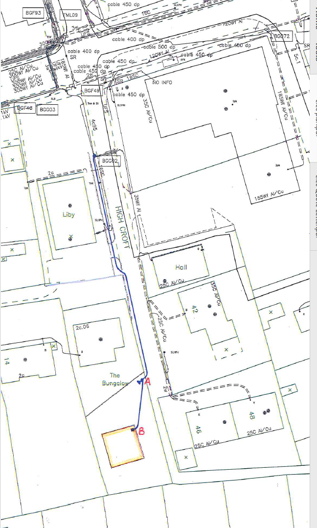

Hecateh Posted January 31, 2018 Author Share Posted January 31, 2018 6 minutes ago, recoveringacademic said: Hold on a mo @Hecateh, why aren't they connecting to the existing supply? By that I mean, the supply that connects the bungalow? (if I have read your diagram correctly) I was wondering if they could link into that. It's one of the things I want to check. The application asked me to say where I wanted the supply to come in and I put by the drive as they is where other services are coming in. I suspected, but didn't know for sure where my bungalow supply came from - the meter is on that side - and now feel I should have asked to talk to someone first. I didn't ask for maps (duh) Link to comment Share on other sites More sharing options...

Hecateh Posted January 31, 2018 Author Share Posted January 31, 2018 2 minutes ago, MikeSharp01 said: IS there another possible connection point the other side of the new plot, this may be cheaper if closer, although I would have thought the surveyor would have spotted that one. That's a question I am going to pursue. I put entry at the drive on the application but it doesn't have to be. Would involve extra work (and money) for my builders but not 8k Link to comment Share on other sites More sharing options...
ToughButterCup Posted January 31, 2018 Share Posted January 31, 2018 23 minutes ago, Hecateh said: I was wondering if they could link into that. [...] I would be very surprised if they couldn't. Keep asking . And get a supply map first ....! Link to comment Share on other sites More sharing options...
PeterW Posted January 31, 2018 Share Posted January 31, 2018 Looking at that plan there is a supply to the bungalow to the left of the plot. The join is in the neighbours garden so as long as that cable has enough capacity it’s all in your own property currently. I would ask for an alternate connection from that and see where they go. Link to comment Share on other sites More sharing options...

PeterW Posted January 31, 2018 Share Posted January 31, 2018 1 minute ago, Hecateh said: Can easily run an extension from the garage - on its own spur - or do I need more than this? @recoveringacademic @MikeSharp01 @PeterW this was SO what I was hoping to hear. It was my thought but, as I thought we were only a metre or so from supply at the drive side, didn't put forward on my application. The supply that feeds my current place and next door though was laid in about 1959 - is this likely to still be a suitable feed? If the supply isn’t suitable they have to replace it under their own regs as it’s “unsafe” and it’s their problem ..! I’ll see if I can get the supply map for the other side tomorrow - should show what it is. Link to comment Share on other sites More sharing options...
Hecateh Posted January 31, 2018 Author Share Posted January 31, 2018 2 minutes ago, PeterW said: If the supply isn’t suitable they have to replace it under their own regs as it’s “unsafe” and it’s their problem ..! I’ll see if I can get the supply map for the other side tomorrow - should show what it is. That's just brilliant - Thank you, Thank you, Thankyou - I'm quite happy to fight for something so long as I know I have 'mi ducks in a row' as regards facts and back up AND that is so difficult when I have 'thoughts' but no knowledge 1 Link to comment Share on other sites More sharing options...

ProDave Posted January 31, 2018 Share Posted January 31, 2018 Your problem is the amount of road to dig up, very expensive (I paid £1K just for the road crossing across a 3 metre wide single track road) You need to find out WHY they need to run the cable so far. If it is capacity issues ask just what rating supply they can give you from the existing infrastructure. It's not a matter of the condition od the existing cables, but their size. Link to comment Share on other sites More sharing options...

Hecateh Posted February 1, 2018 Author Share Posted February 1, 2018 Spoken to the guy today. Very approachable but no joy as to any other way to achieve. Across the road is at capacity. The one to the bungalow uses a method that they longer use - because of the increased demands on electricity each dwelling has to have its own supply. The library shown on the plan doesn't exist any more but their supply was also old style and no longer used. The supply along the path to the north of the bungalow is only for street lighting. I am going to get another quote but, for that supply route the price is understandable I guess, and it's going to be another hit to the pocket. My new kitchen plan is getting more basic by the day. 1 Link to comment Share on other sites More sharing options...
ProDave Posted February 1, 2018 Share Posted February 1, 2018 That's a bit of a bugger. One way you could reduce the cost would be for the cable to come off the road into the front garden of your existing bungalow and from there across the front garden close to the road. You (or your chosen contractor) could dig the trench for that bit, and it would reduce the length of road or path to be dug up. Link to comment Share on other sites More sharing options...
