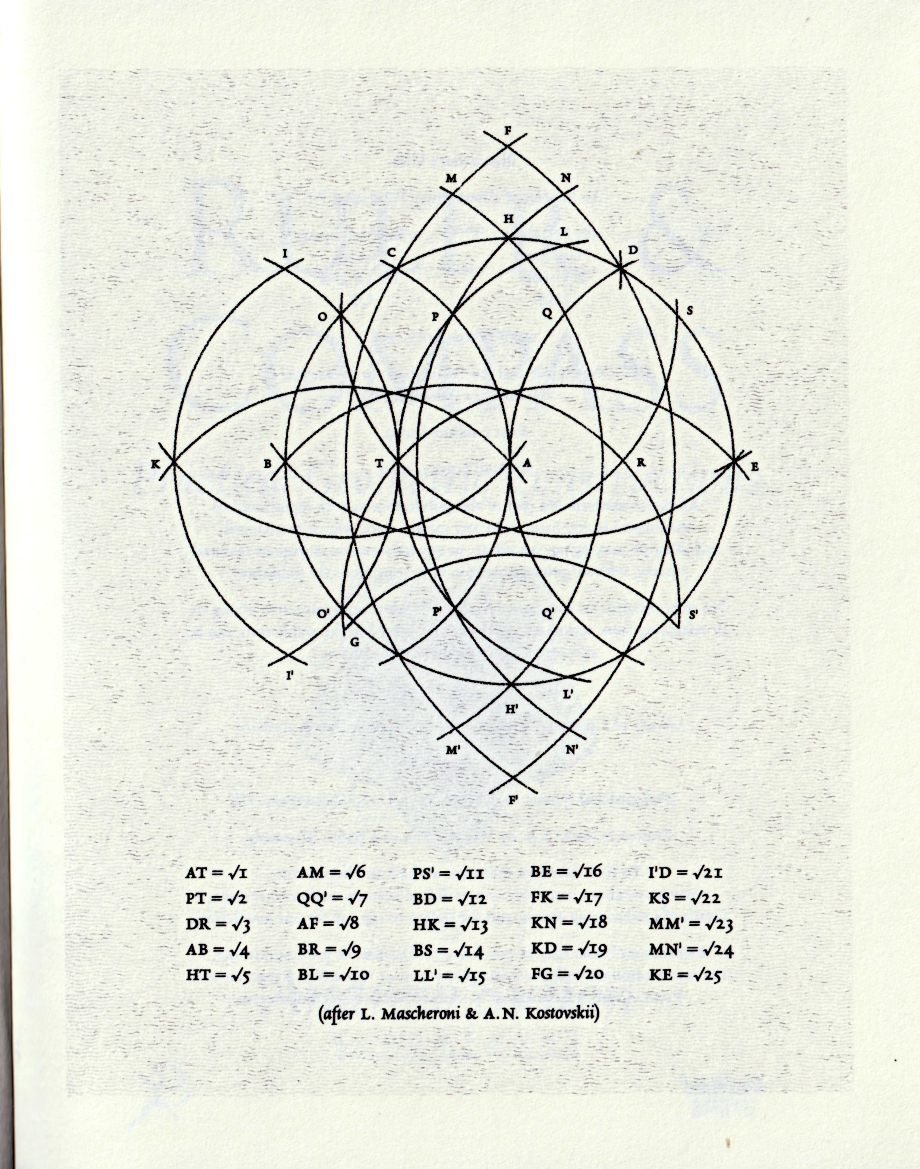

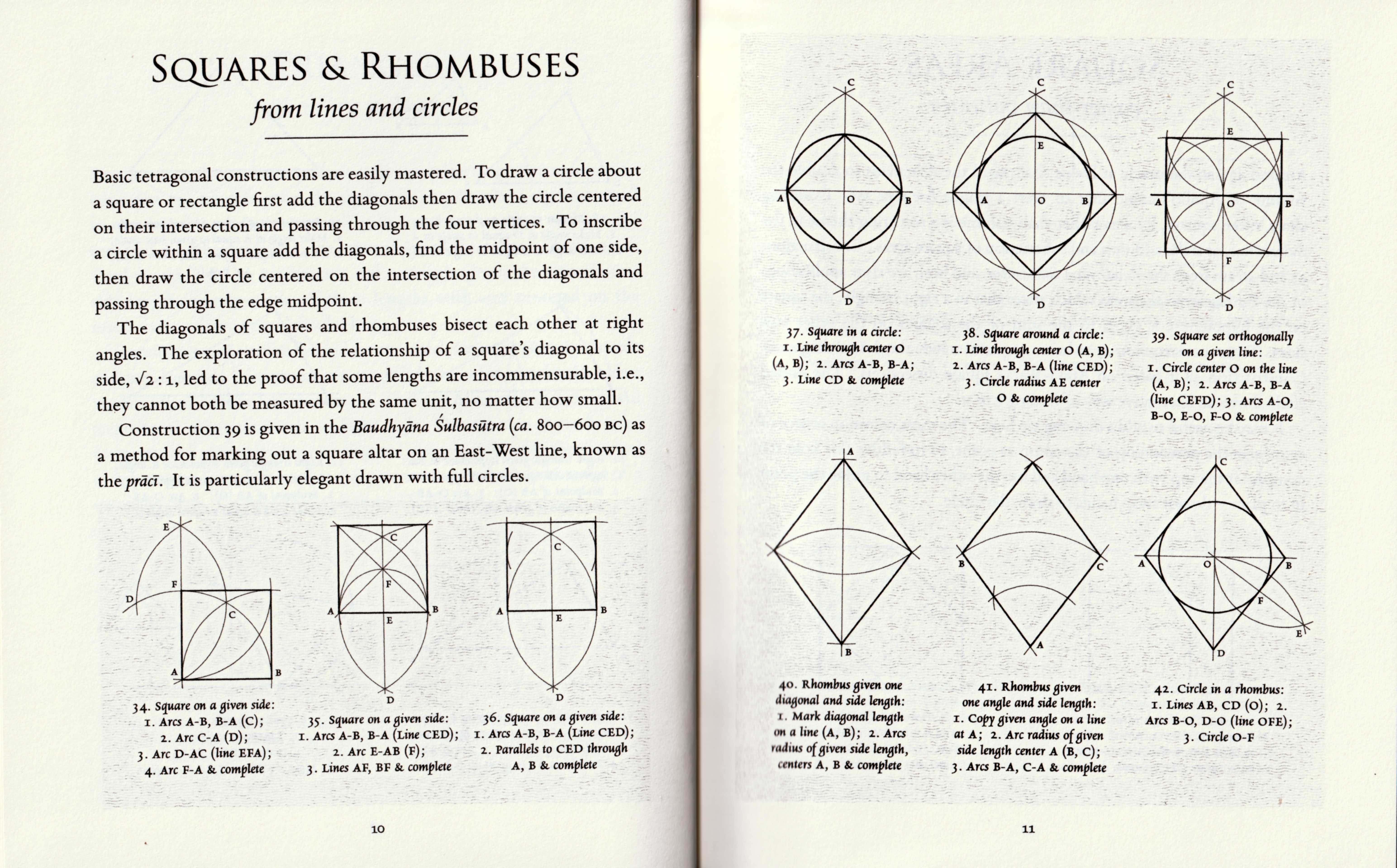

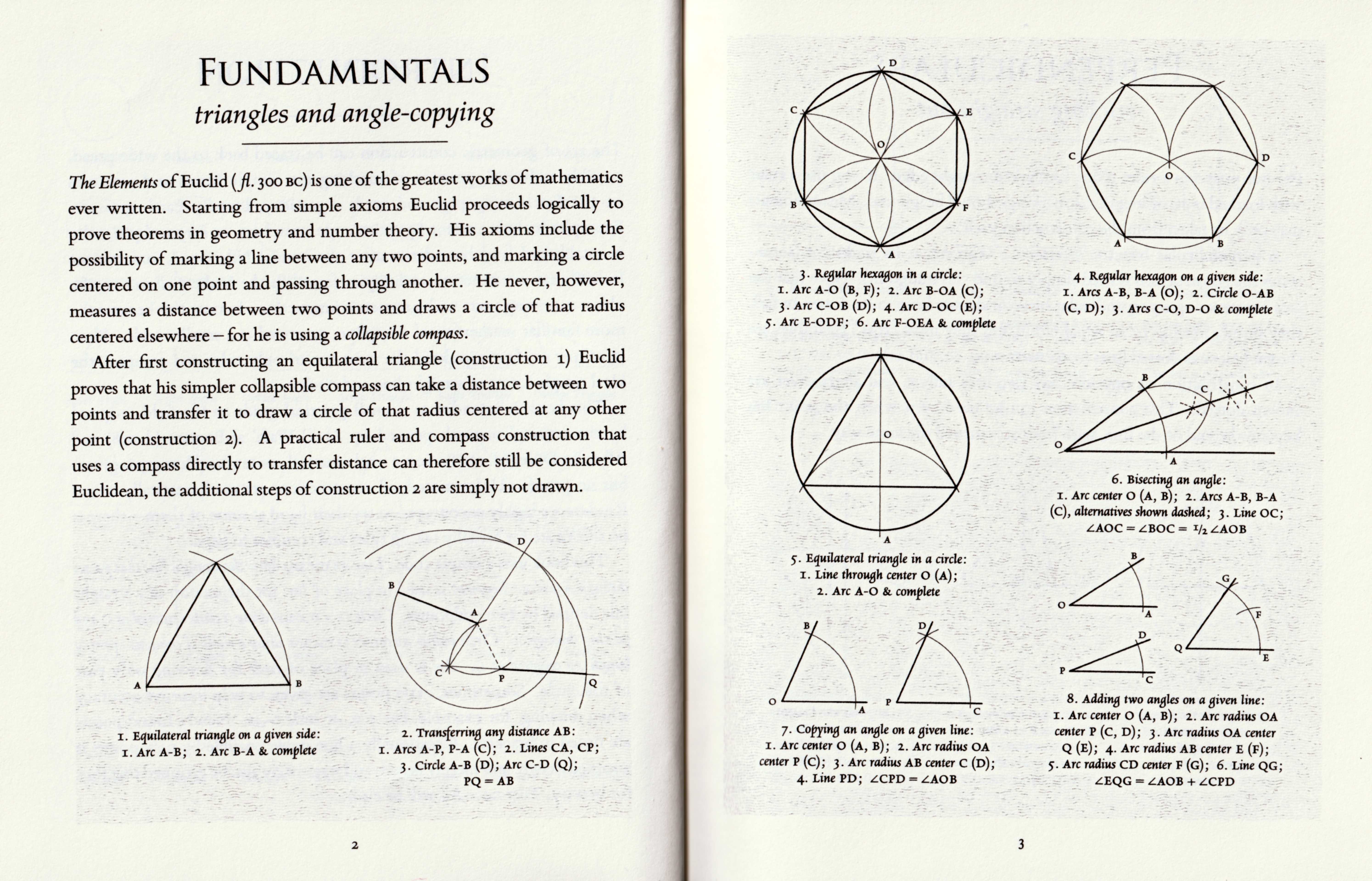

@saveasteading and other interested parties
On 17/03/2026 at 17:59, SteamyTea said:
Somewhere at home, in my vast library of mathematic's books
Here is part of it, no tape measure needed ( @Pocster ).
