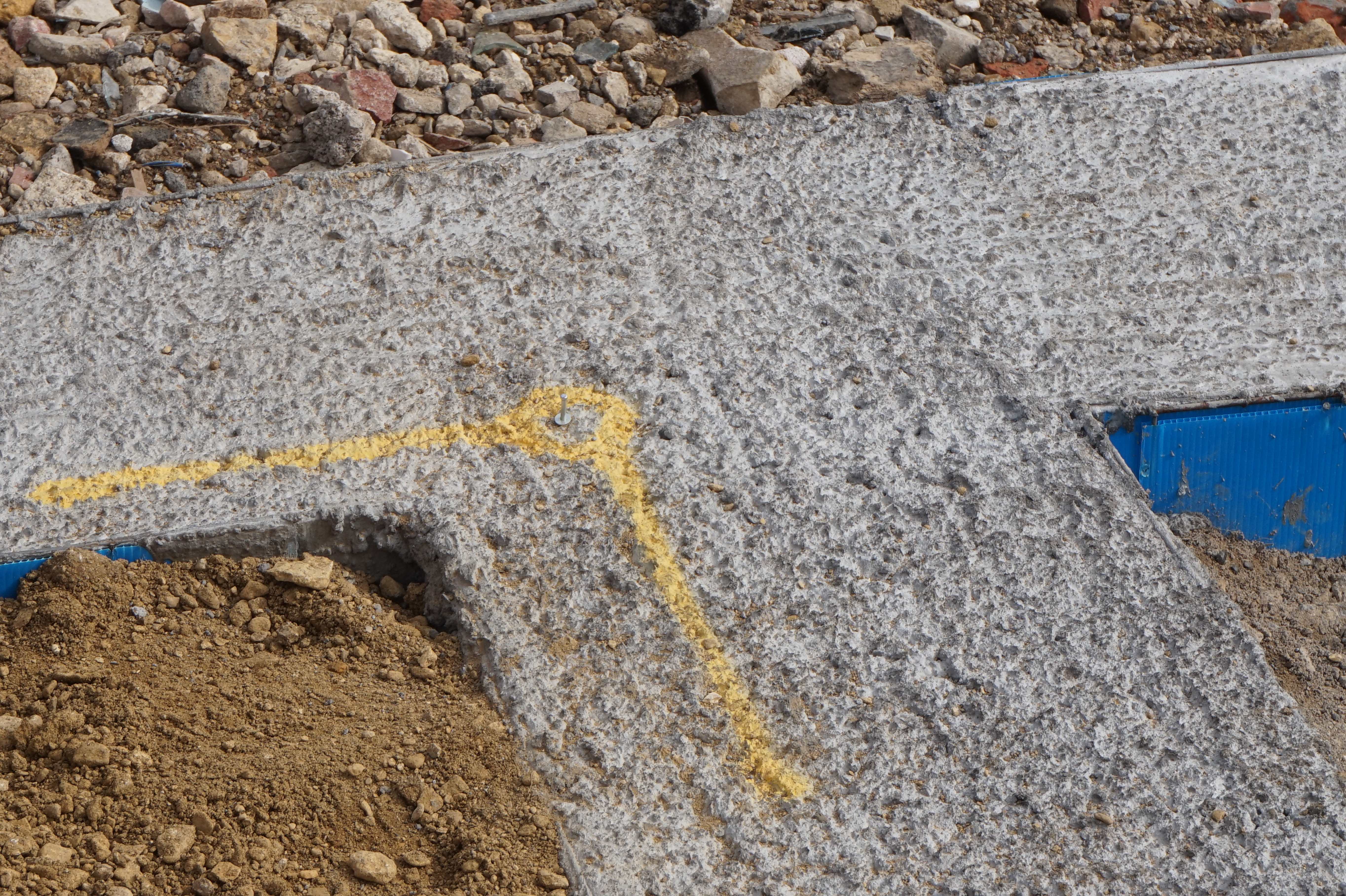

March 15Mar 15 We had a local surveyor, he came to site 3 times. 1. rough set out. footprint plus 2 m in all directions so we could strip the site. 2. Accurate footing set out, footings set out with metal pins on every corner accurate to 20mm in any direction 3. Wall set out, masonary nails put into footing concrete on corner locations, accurate to the mm.

March 15Mar 15 1 minute ago, flanagaj said: This is really helpful. I hadn't thought about multiple visits and assumed they just came once to set out and that was it, but it makes complete sense for them to mark the concrete footings for the exact location of the wall position. I haven’t seen profile boards used in years. they take your drawing and load it into their computer in the office, when they come to site it is all loaded into their total station all ready. they use a glass prism on the concrete footing that gets the accuracy bob on. get them to put a height post in, you can mark it with ffh and all the other things you need on it.

March 16Mar 16 17 hours ago, Russell griffiths said: accurate to the mm Think I need to lay down in a darkened room.
March 16Mar 16 2 hours ago, SteamyTea said: Think I need to lay down in a darkened room. Look for the nail !
