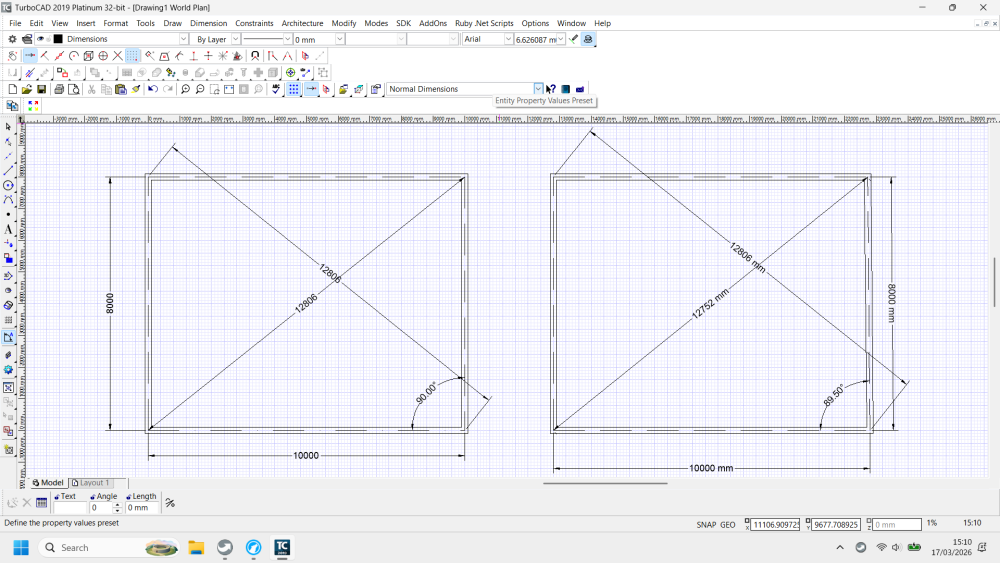

March 17Mar 17 Re taking diagonal measurements. Quick sketch below show what one, half degree out, but correct length does.

March 17Mar 17 26 minutes ago, saveasteading said: In real life, I was going to say that the error would not usually be in having a non-square corner as a starting point Was more to show how easy it is to be 50mm out. In real life the problems are accumulative errors and systematic errors. Get two workers with their own tape measures and errors can be quite serious even over a few metres. I never trust tape measures, they are only good for relative reference, withe the relative reference being themselves. Somewhere at home, in my vast library of mathematic's books, I have one a about using a rule and compass to establish mathematical concept. Shall see if I can dig it out and find some relevance to absolute geometric referencing.
