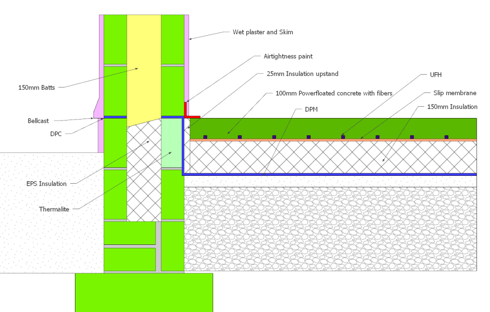

flanagaj Posted 4 hours ago Posted 4 hours ago Our vague regs drawings just state the walls will achieve a U value of 0.18W/m2k and consist of high strength 7 concrete blocks. I went back to the TA, who wasn't much help and he said "when you know what blocks you you are using, I'll run it back through the SAP calcs". I can't be bothered with the faff and want to know if 7N blocks can be used across the whole build. Thermalites are expensive and will they really reduce the U values, or would another layer of insulation in the loft offset their better thermal performance. I need to get materials ordered as footings are scheduled to be pulled in 3 weeks time.
JohnMo Posted 4 hours ago Posted 4 hours ago No one could answer your questions without more information. Ideally your wall build-up drawings are needed, but you sound like you don't have the drawings down to a detailed enough spec, to even consider buying let alone building yet.

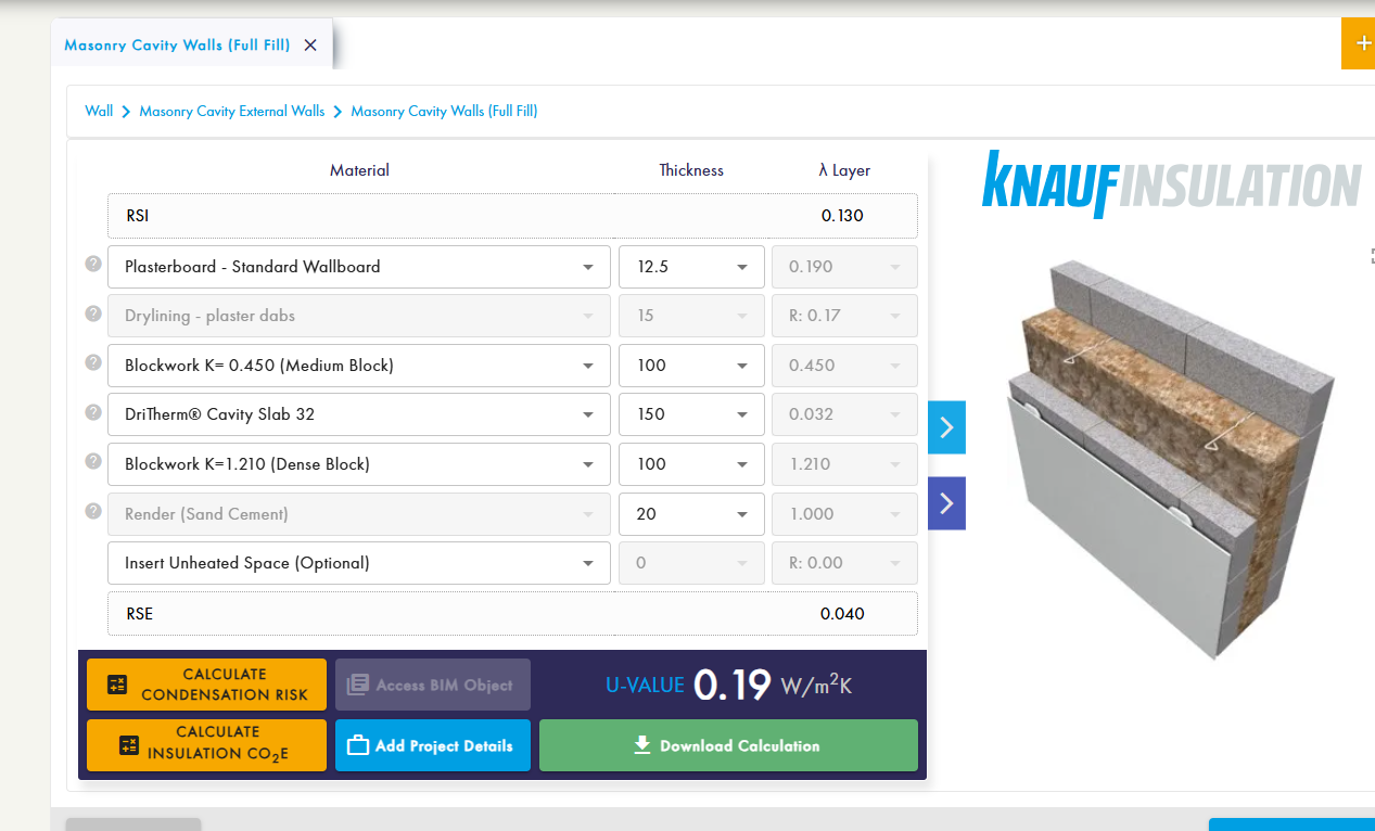

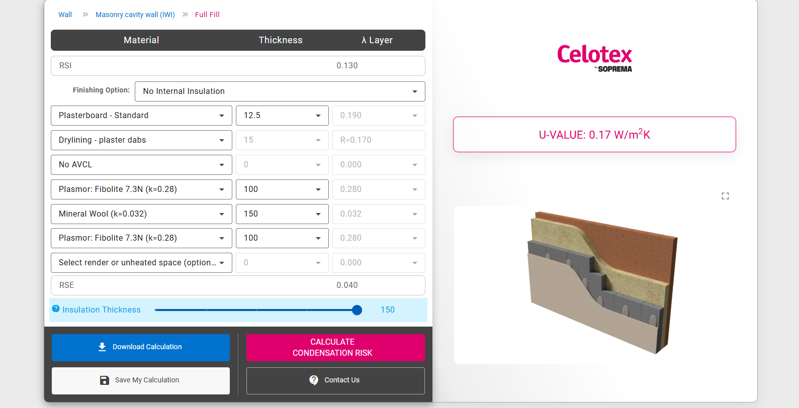

torre Posted 1 hour ago Posted 1 hour ago You can get a good idea of the difference by going on ubakus or similar, configuring your wall build up and swapping the block type and seeing how the u value changes. Switching out thermalite for something like fibolite could take you from say 0.18 to 0.19 and if you switched to a dense block even worse. Might sound a small difference for SAP but houses have a lot of wall area so it will suffer. If you're talking about dense blocks, you'll save on materials but lose some of the difference paying more for labour.
Iceverge Posted 6 minutes ago Posted 6 minutes ago Standard dense blocks 7.5N is the norm in Ireland. Thermalites really add almost no insulation compared to making the cavity just a few mm wider. They're lighter to lift but crack easier and don't take wet plaster as well. Swings and roundabouts. 100mm dense blocks 175mm cavity batt 36 100mm Thermalite (0.18) will get you to 0.18W/m²K. Blocks and insulation~£65.14/m² If you used 100mm dense block 175mm cavity batt 36 100mm dense block ~£48.12 per m² You'd be at 0.174W/m²K
