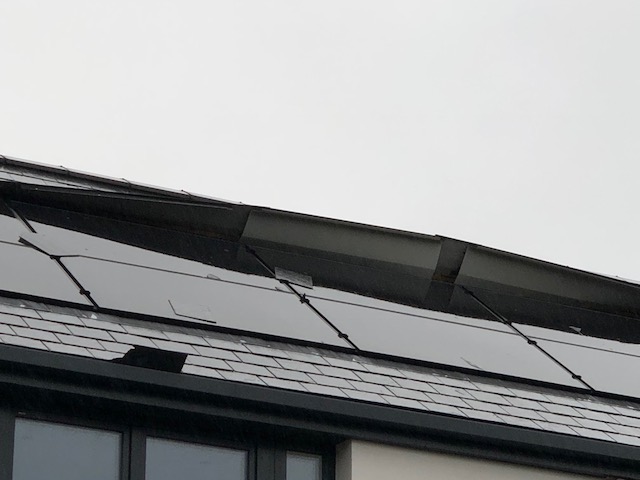

Barney12 Posted January 24, 2018 Posted January 24, 2018 I'm having a very bad day. It seems that the flashing system for the GSE in-roof panel mounts can't cope with Dartmoor winds :(. At least two rows of slates ripped off in the process. Oh feck! 5
ProDave Posted January 24, 2018 Posted January 24, 2018 Oh dear. I wonder if your site insurance will cover that?
Barney12 Posted January 24, 2018 Author Posted January 24, 2018 2 minutes ago, ProDave said: Oh dear. I wonder if your site insurance will cover that? Just completing the claim form. It was installed to the GSE specification. What is worrying me more is that the system just isn't capable of withstanding the winds in this location.
ProDave Posted January 24, 2018 Posted January 24, 2018 When it has calmed down, I would want to inspect the aftermath and see what has failed, and see what improvements you could make if you re install the same i.e. look at reinforcing or suplementing the fixings provided. Flooding is our issue today, heavy rain and melting snow. The burn is up as high as I want to see it just now and still it rains.....
Stones Posted January 24, 2018 Posted January 24, 2018 That's the system I'd considered...seeing that (and given my location) feeling quite glad I didn't have any money left to install them. Hope the claim is settled quickly. Have you been in touch with GSE to see if there is anything you can do about addressing the fixings / where it has failed?
Barney12 Posted January 24, 2018 Author Posted January 24, 2018 30 minutes ago, Stones said: That's the system I'd considered...seeing that (and given my location) feeling quite glad I didn't have any money left to install them. Hope the claim is settled quickly. Have you been in touch with GSE to see if there is anything you can do about addressing the fixings / where it has failed? I've emailed the supplier. No response yet.

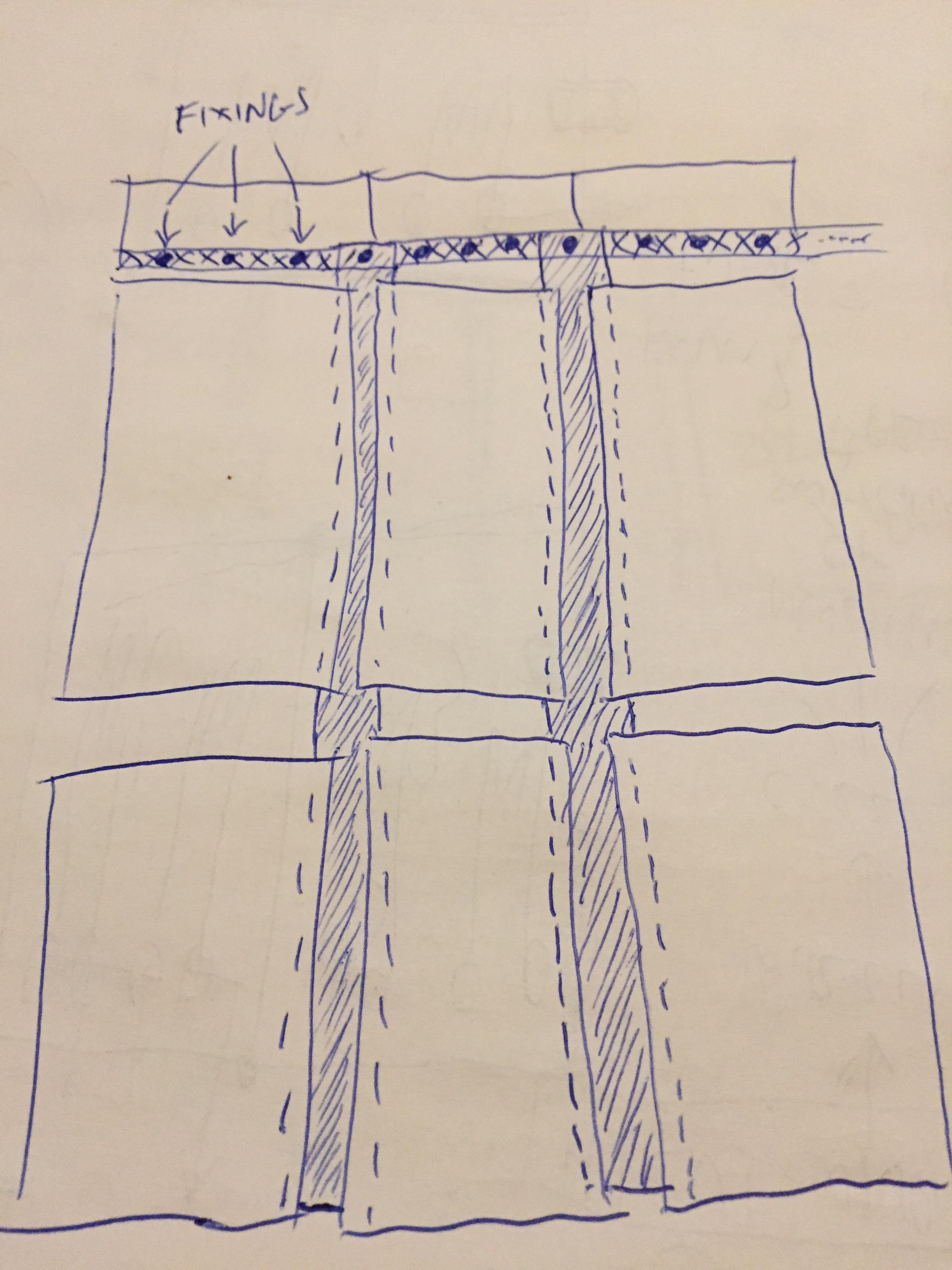

Nickfromwales Posted January 24, 2018 Posted January 24, 2018 Oh dear... @Barney12 Can you remove the panels, fit some 10mm x 75mm aluminium strips where the panel fixing holes are, running from bottom to top with a cranked detail on the end, and fix the panels back down over it. Then from left to right fit another 10mm x 40-50mm flat bar so it runs under the leading edge of the bottom of the flashings, and then fix down through the flashing skirt into the flat bar? Only pain is it'll raise the panels by the thickness of the vertical strips. Could you get something under the pv trays to fix into.......but then I suppose the design of the trays and panel retaining clips negates any through penetration......

Barney12 Posted January 24, 2018 Author Posted January 24, 2018 26 minutes ago, Moira Niedzwiecka said: Was it the flashing or the trays? Its the top flashing which is aluminium. I'm kicking myself as I replaced the lower flashing with lead. They supplied that god awful corrugated flash band type product which I have no faith in. They do say in the manual that you can use lead (or lead substitute) instead of the aluminium system. I've either got to find a way to bond the aluminium flashing down to prevent it lifting or just use lead. The aluminium top system does have a c shaped section that slots onto the top row of panels but its only c20mm deep and my suspicion is that the clips that hold the flashing down (2 per strip) on the top edge have slowly moved with the wind force of this winters storms thus allowing the channel to pop off the top of the solar panels and lift. The second annoyance is that my roofing mate that helped me put the panels in wanted to nail the top edge of the flashing to the battens but I wouldn't let him and said we should follow the manufacturers instructions and instead used the little galvanised clips which overlap the flashing and screw down. Can't help thinking a few nails along the top edge would have prevented the movement. ho hum

PeterW Posted January 24, 2018 Posted January 24, 2018 1 hour ago, Barney12 said: Its the top flashing which is aluminium. I'm kicking myself as I replaced the lower flashing with lead. They supplied that god awful corrugated flash band type product which I have no faith in. They do say in the manual that you can use lead (or lead substitute) instead of the aluminium system. I've either got to find a way to bond the aluminium flashing down to prevent it lifting or just use lead. The aluminium top system does have a c shaped section that slots onto the top row of panels but its only c20mm deep and my suspicion is that the clips that hold the flashing down (2 per strip) on the top edge have slowly moved with the wind force of this winters storms thus allowing the channel to pop off the top of the solar panels and lift. The second annoyance is that my roofing mate that helped me put the panels in wanted to nail the top edge of the flashing to the battens but I wouldn't let him and said we should follow the manufacturers instructions and instead used the little galvanised clips which overlap the flashing and screw down. Can't help thinking a few nails along the top edge would have prevented the movement. ho hum Just to be clear in a very strong wind lead will also lift unless it’s fixed down so I would look at the MIs first. Small bead of sealant may also be a plan - CT-1..?

Barney12 Posted January 24, 2018 Author Posted January 24, 2018 1 hour ago, PeterW said: Just to be clear in a very strong wind lead will also lift unless it’s fixed down so I would look at the MIs first. Small bead of sealant may also be a plan - CT-1..? Yes. CT-1 discussed today as an option. Manufacturer likes to use that sticky flashband stuff as an alternative to ali flashing but I have no confidence in the stuff up here.
Construction Channel Posted January 24, 2018 Posted January 24, 2018 19 minutes ago, Barney12 said: Yes. CT-1 discussed today as an option. Manufacturer likes to use that sticky flashband stuff as an alternative to ali flashing but I have no confidence in the stuff up here. If you put sticky flashband on your house I will never talk to you again. 1 1
Declan52 Posted January 24, 2018 Posted January 24, 2018 Can you not use the aluminium strips but use hex roof screws to give a stronger fixing. Sticky flash aint an option, just doesn't last. Can you get up into the roof to remove the loose tiles before the panels get scratched???
