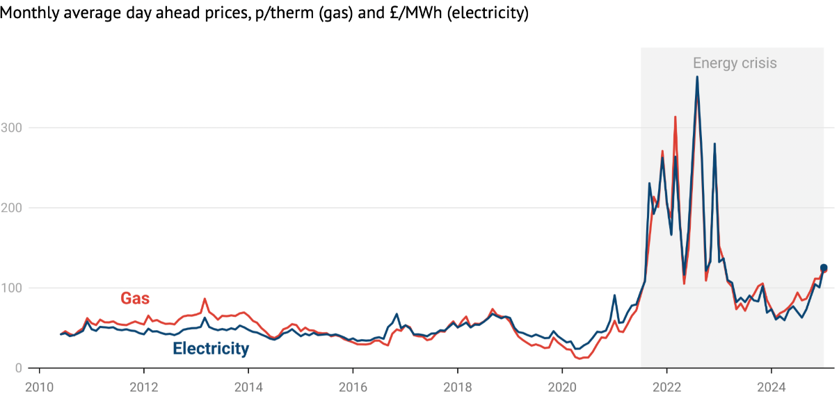

Beelbeebub Posted April 12 Author Posted April 12 2 hours ago, jack said: This is equivalent to posting a picture of an unseasonably low temperature forecast for a particular summer's day and saying "bUt cLImatE ChaNgE is waRmInG thE pLaNet!!...". A fair point except the climate example misses the fundamental difference between climate and weather. In this case I'm showing that renewables are cheap. The rise in electricity prices track the rise and fall of gas prices not the rise and rise of renewables. Renewables have steadily risen in last decade But electricity has tracked gas prices. The fact electricity is more expensive now is despite our increace in renewables not because of. 1
ProDave Posted April 12 Posted April 12 As mentioned many times, the ridiculous pricing system we have ensures we will be paying prices set by gas, until there is so much renewables that the very last gas power station has shut down. Ministers may say otherwise but that is the sad truth until someone changes the way retail electricity prices are set. 1
JohnMo Posted April 12 Posted April 12 41 minutes ago, ProDave said: As mentioned many times, the ridiculous pricing system we have ensures we will be paying prices set by gas, until there is so much renewables that the very last gas power station has shut down. Listened to podcast on electricity pricing and its way more bonkers than that. Can't recall the exact pricing mechanism, but its a bidding system. I could bid to supply electric to London although I'm in NE Scotland, be within the pricing range deemed acceptable, they would then look and say its not practical for me supply that electric to London as I am too far away, and then pay me not to generate and instead pay another supplier the highest bid to supply the electric. Until the system is simplified we are stuffed. Plus there are so many cost adders to the price we pay, it always going to expensive. Generally the policy setters and the wholesale pricing system has completely lost the plot 2
Gone West Posted April 12 Posted April 12 https://www.ofgem.gov.uk/blog/wholesale-energy-costs-and-your-bills "Currently in Great Britain, wholesale gas prices can set the price of wholesale electricity a large majority of the time because there are not enough renewables built to avoid some use of gas. As we continue to generate more renewable electricity and develop ways to store it, for example using battery storage, gas could set our electricity prices much less frequently. Based on the National Energy System Operator (NESO)'s modelling, we estimate that gas could set this price just 30% of the time by 2030. This will mean wholesale gas prices will have a much lower impact on electricity bills." 1
Beelbeebub Posted April 12 Author Posted April 12 I do get the logic behind the marginal price auction system and it should be pointed out that the CFD system of strike prices basically negates some of that by effectively fixing the price for renewables over a long period. I don't quite know how it feeds into the price we pay as consumers or if the over/under just goes the treasury. However, it would be nice if the cost savings from renewables could be passed on more. The flip side is the profits to be made from putting in renewables does encourage more to be put in. Of course it would be nice if the gov, who can borrow money nice and cheaply (relative to companies) borrowed, built and operated some windfarms and solar parks to sell the power to the grid at a low cost.

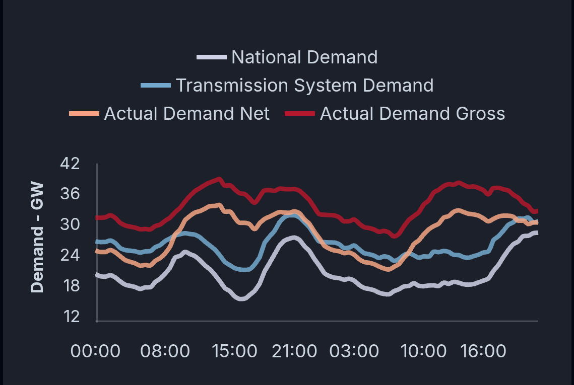

Beelbeebub Posted April 12 Author Posted April 12 You can see the difference between the red/white lines which are the demand on the transmission system vs the pink/red lines which are the actual consumption of homes and businesses (plus import /export etc) The difference is the amount of LV solar &. Wind which are the renewables that operate on the low voltage distribution network At this time of year almost all my instantaneous electrical demand is met by my solar system.
