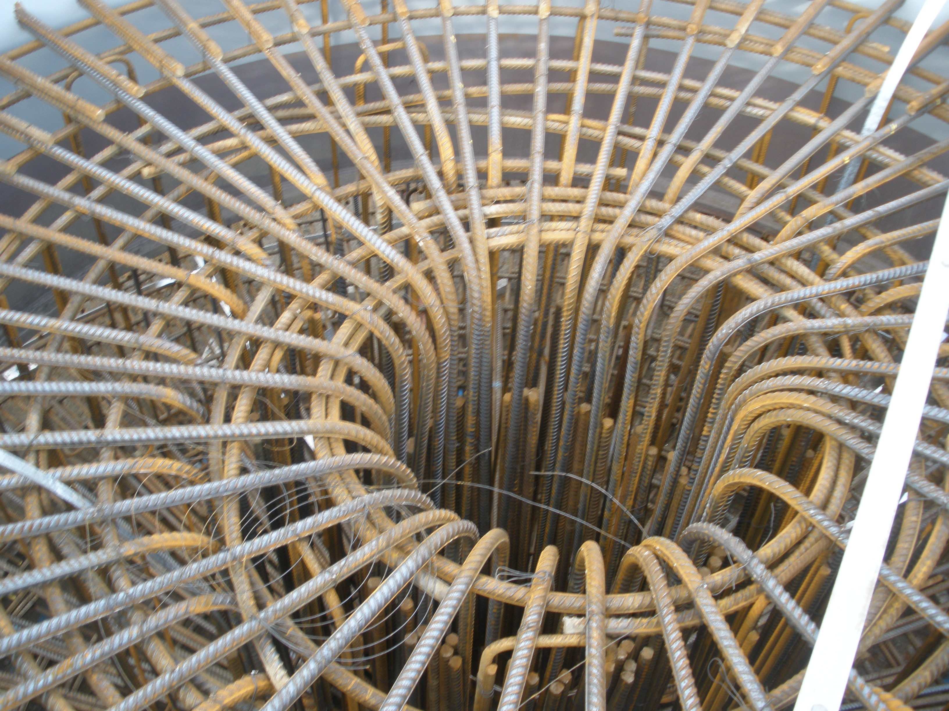

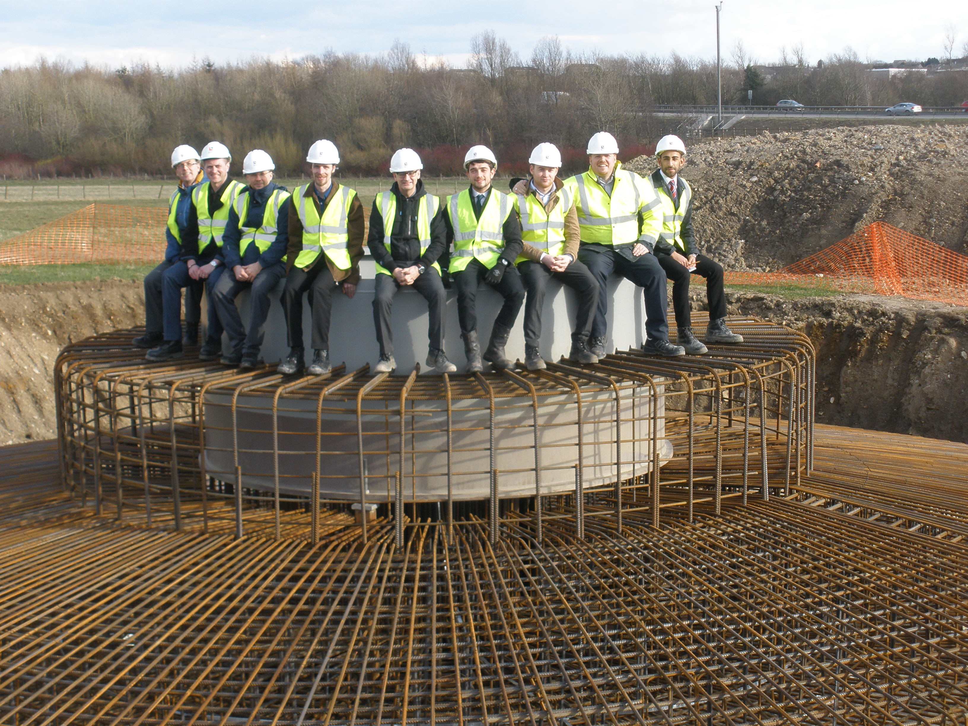

Gus Potter Posted May 12 Posted May 12 3 hours ago, SteamyTea said: Maybe @Gus Potter can give some insight as to the design. Aye and no. Below is a good photo of a small turbine base.. I'm the (expletive deleted)wit on the far left. Doing the corporate stuff but thinking.. this is not maybe that good for the enviroment and creating jobs as puported.. But I've got much better looking as I've aged, taller also! Every cloud has a silver lining. I can't remember the output of the turbine, tall from memory, but not that big, just a farmer getting some extra income. I think you can see it from the M8 motorway in Scotland. What it does show is the amount of rebar that goes into something like a modest wind turbine base. It's practically there forever pretty much. 3 hours ago, SteamyTea said: The diameter of the base will make a difference. It does as the more you increase the height the larger the base needs to be to resist the dynamic wind forces. It's not just the over turning effect it's the constant variation in dynamic loading. Mother earth does not often appreciate this kind of "vibration" and load change. We need mass concrete.. when poured it gets hot! It cracks and shrinks and curls up like fury and part of all that rebar you see is to control that cracking and curling effect. If you put a pork chop in a frying pan it often curls.. same to some extent happens with concrete. Technically concrete has two dominant forms when it is cast. One is plastic shrinkage.. that is when the chemicals in the concrete are busy creating the concrete we see.. this can apply to raft floors in self builds. The other is drying shrinkage, less dominant in turbine founds in say CLAY soil.. but in SANDS in England drying shrinkage is a consideration. Drying shrinkage is probably the dominant factor in self build rafts / screeds and so on. If you look up the construction videos of the Hoover dam this is well explained about how you need to control the heat in mass concrete. Now you don't have to be an SE to figure out that wind turbines are maybe not as eco friendly as at first glance? Below is the bit in the middle that the concrete ring sits onto.. to which the nice bit of steel turbine gets attached to. That's the bit you see above ground. Now it's almost impossible to upgrade a turbine base.. unless the tax payer is footing the bill. In that case it all hands on deck for a great design fee.. all paid for by the public of course. 2
saveasteading Posted May 13 Posted May 13 10 hours ago, scottishjohn said: stress over time on the fixings etc -so they dig it up and start again 9 hours ago, Gus Potter said: almost impossible to upgrade a turbine base.. I'd be very surprised if there isn't a way. Needs some early collaboration between the parties rather than a linear design process. Having spent a lot of time in such cages, doing qc, I'm left wondering how the steelfixers got out. And how the concrete got to the bottom... how do we know it is well compacted? Doing the site inspections was much easier than the fixers job so it breeds respect for them and the detailer (both the Engineer and their draughts- person)... and my own designing for ease (feasibility) of construction.
LnP Posted May 13 Posted May 13 9 hours ago, Gus Potter said: Now you don't have to be an SE to figure out that wind turbines are maybe not as eco friendly as at first glance? Nice post and I love the pictures but please can we kill the myth that renewables are not eco friendly because of the materials used in their construction. The data speak for themselves. See my earlier post. CO2e, per kWh of energy produced over the life of the asset for your onshore turbine is 12 g CO2e and to produce the same energy from e.g. natural gas it's 458 g. That includes the embedded carbon in the concrete. 1

sgt_woulds Posted May 13 Posted May 13 Could larger turbines fitted to existing bases not be fitted with radial anchor cable supports like communication masts? As for the blade recycling issue this is well wnown and is mainly due to the recycling facilities not being available rather than it not being possible. Some companies are experimenting with LVL blades, and the company I work for has also provided LVL and technical assistance for another experimental build with a wooden tower and nacelle too. We just need a paradigm shift in foundation design as well (for general building as well as large projects since most house foundations are vastly overspecced). But we are getting there. Of course the major plus point with renewables is that we can deal with any waste at leisure (except perhaps some solar panel components) - we don't have to carefully dismantal and lock the materials away for millions of years and trillions of quids 'World's first' wooden wind turbine blades installed in Germany 1

markc Posted May 13 Posted May 13 2 hours ago, sgt_woulds said: Could larger turbines fitted to existing bases not be fitted with radial anchor cable supports like communication masts? Simple answer - No. during high winds the blade tips sweep very close to the masts making guy wires impossible.
-rick- Posted May 13 Posted May 13 2 hours ago, sgt_woulds said: Could larger turbines fitted to existing bases not be fitted with radial anchor cable supports like communication masts? Feels like this is one of those new technology startup issues. Turbine size is still growing but I'd guess we are near the stabilisation point where its not worth going bigger. Once that happens then replacing like with like at end of life is likely something that can planned for. Not sure it's necessarily been something on the radar up to this point. 1
